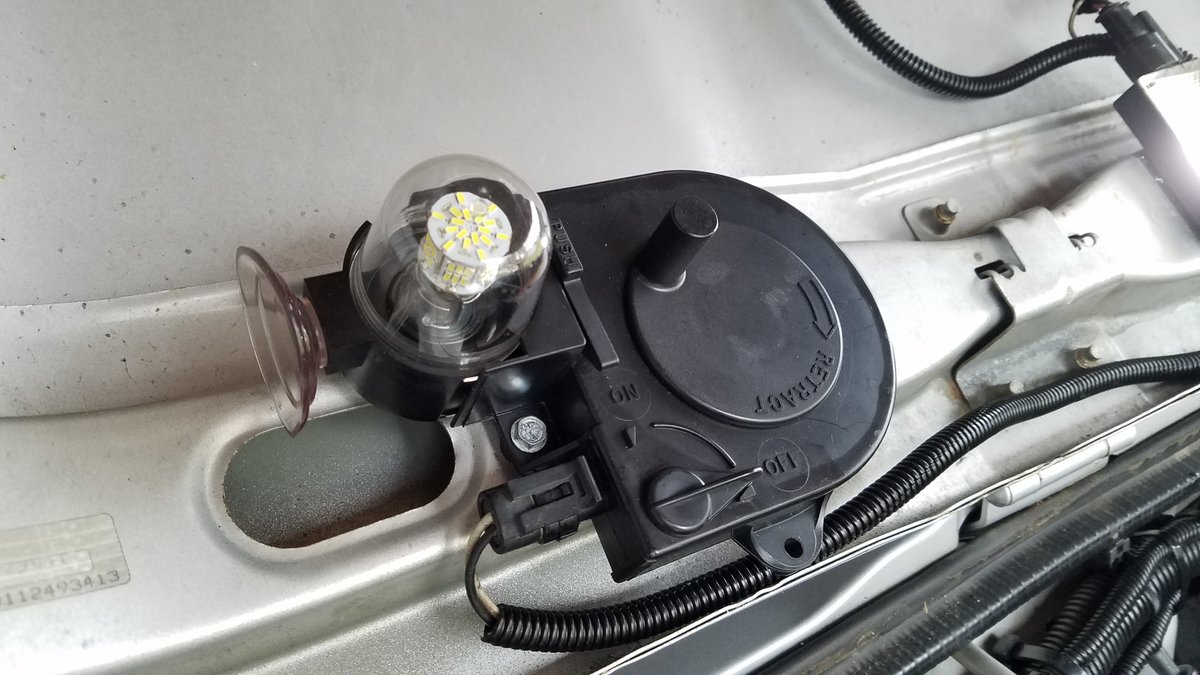

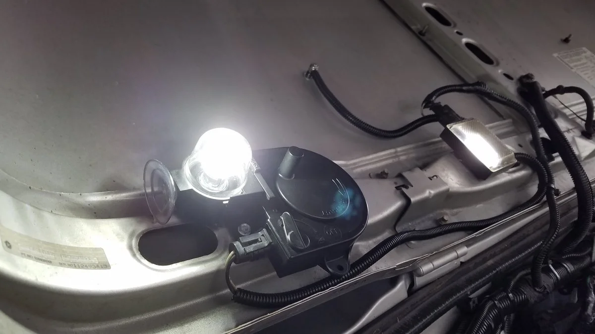

I did a writeup of these lights in 2016. There are a bunch of photos, so maybe linking here would be helpful? I don't know.
I never moved up to the LED option; mine is fine as it is. And I have actually had to use it on a rainy night in the mud when my tire was holed through the sidewall. I was afraid to use the Hi-Lift in the soft mud, so I used an 18" square of plywood and the stock bottle jack, which did surprisingly well.
The GMC Suburban under-hood light has more than enough length to go around the side of the TJ and then underneath. I placed it above and forward of the axle to help me safely place my plywood and the jack. Once it was up and stable I moved the light to the tub above the rear wheel. I pulled the spare, pulled the holed tire, swapped them, moved the light back under and removed the jack and wood, tightened everything properly, and rolled on home, soaking wet but happy that I did not have to do that crap in the pitch dark and the heavy rain. The light really made this much less crappy for me. It also works well UNDER THE HOOD since you can move it around like a small work light. I really like this mod.

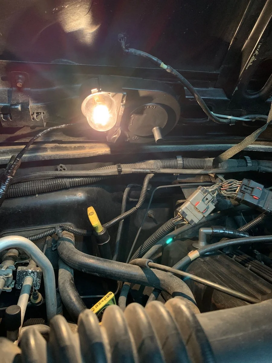

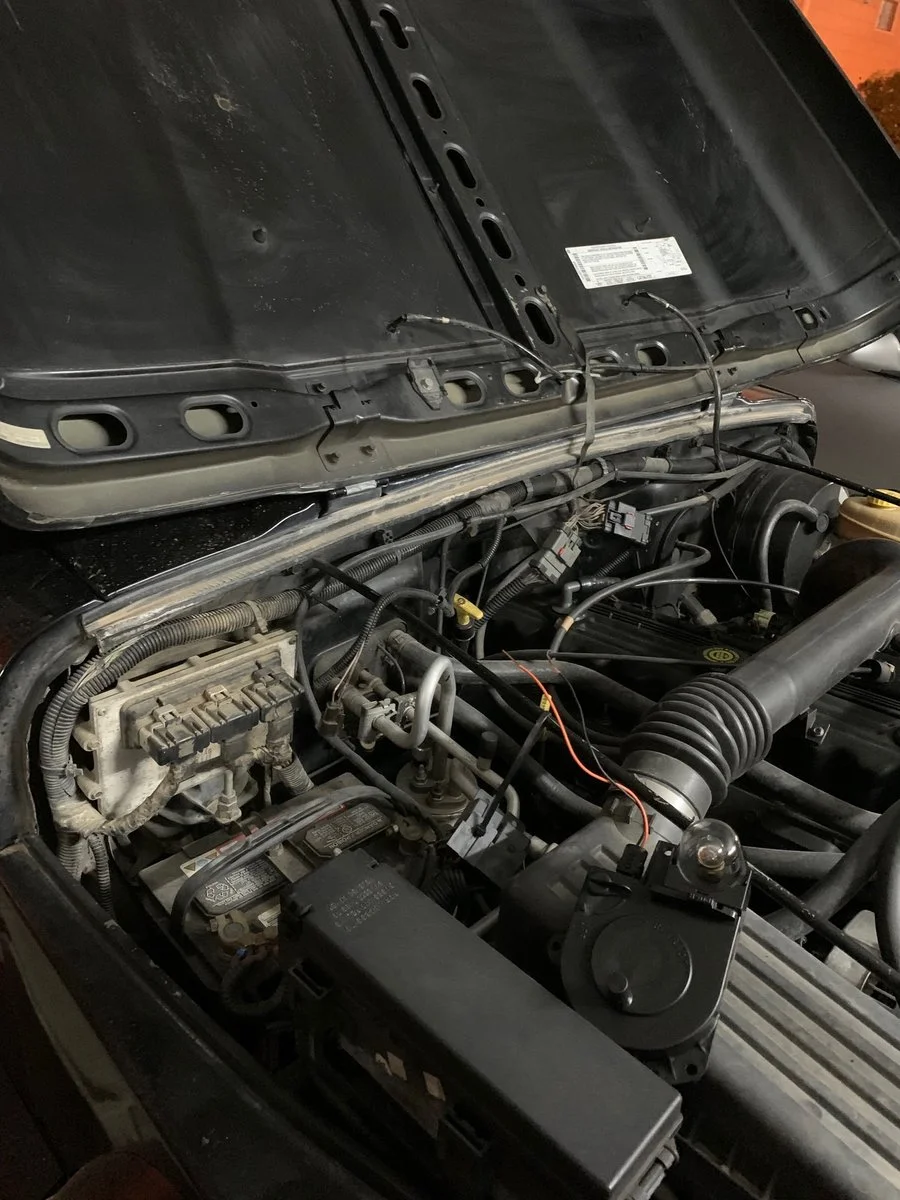

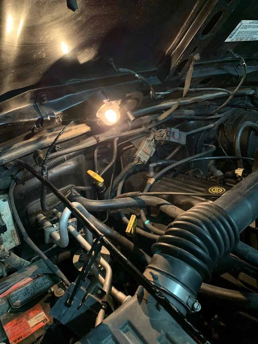

I am back, and I am truly in love with this MOD.
Tomorrow I am getting an LED lamp for this instead of the old light bulb that is using, for more light.
Thank you for sharing this.
Here are photos of mine after I got it:

I am assuming the GM light works similar to the factory light in which it only turns on when the hood is tilted up or do you need to wire in a switch to keep it from constantly running even when hood is closed?
q8ieng
Aug 20, 2019
203
USA
No it is not, check the photos in here:
It is way better than the factory's.
There is a switch, pay a close attention to the third photo and you'll see the switch on the light itself.
