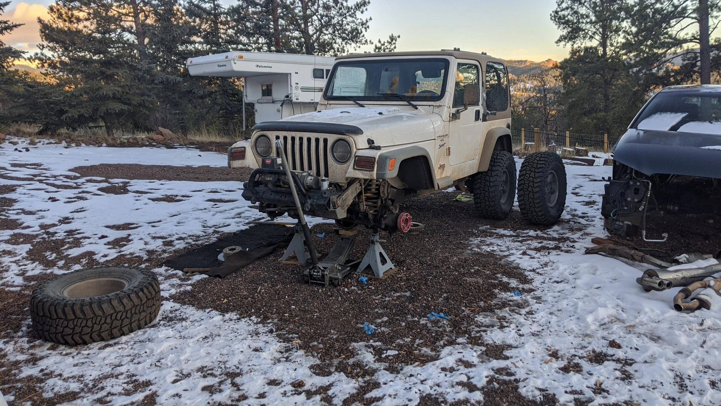

Cold couple days laying in the snow in sub32 temps

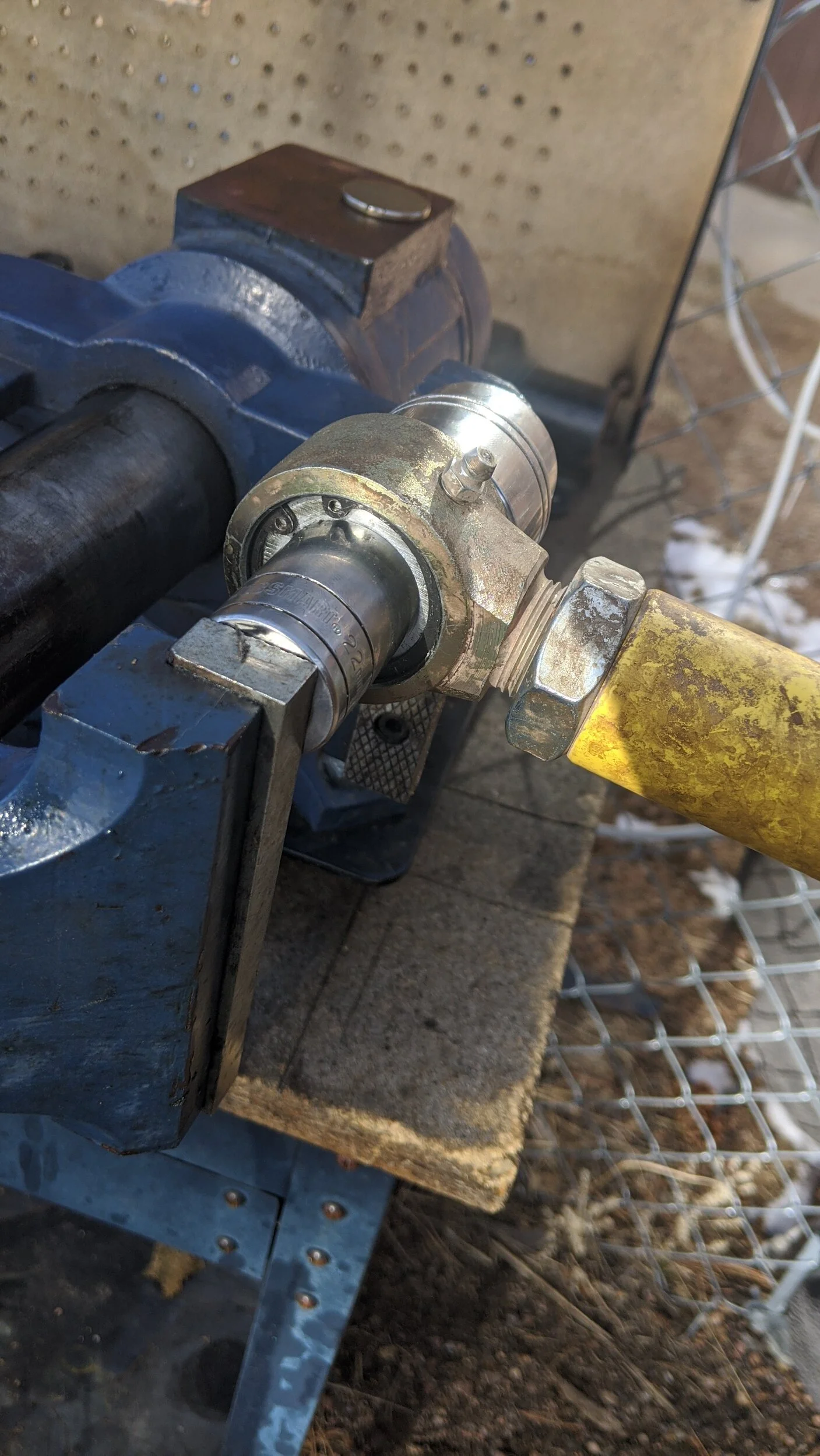

Got the Jeep back together. Pressing the JJ together with the vice wasn't too bad, but definitely a bit finicky. definitely see how the tool would make it nicer... Plus can be brought on a trail easily.
Drove about 30miles yesterday and it felt much better.

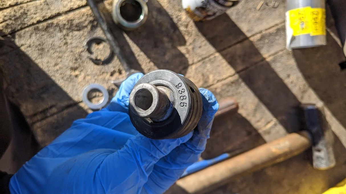

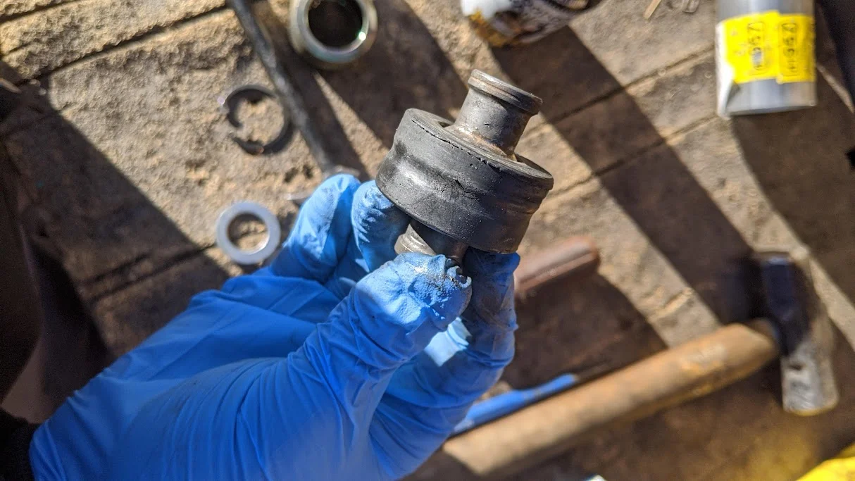

...I'm not sure what caused that in the first place.
In the picture you posted with the JJ's guts puked out, I can see the snap ring, but I can't tell what's holding it in place. Was the snap ring deformed when it came out? If not, it was likely not seated completely. If it was seated completely and popped out, I would expect to see it dished or otherwise bent.
Also, for future reference (if you weren't already aware), snap rings are stamped, and as a result, they have a sharp edge and a not-so-sharp edge. The sharp edge helps bite in and hold the assembly together. Always look at the snap ring during assembly, and place it so that the sharp edge is on the side that it would pop out to. In your case, the sharp edge should be on the outside of the JJ housing.
Seemed like the opening was just smaller than the bolt-hole section of the JJ ball, so it didn't fall off. At first I thought I was just super lucky to not have lost it but I don't think it could've fallen.

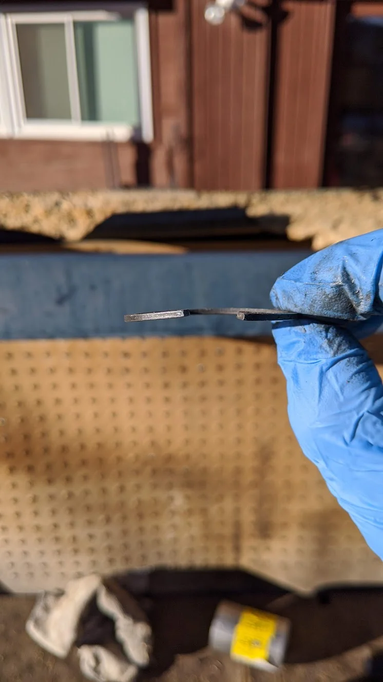

Yes it was slightly deformed, a little dish shape. Is that a problem? I figured the load of the joint after releasing the vice would flatten it (seemed like that was what happened)

Check for interference between the JJ housing and the mounting bracket within your travel range. If you have interference, it will side-load the joint, and that load will far-exceed the capacity of the snap ring. Also, don't re-use that snap ring again. Get a new one.
Yeah I was thinking that. I will probably order an entire rebuild kit for it just in case

I forgot about something to point out related to this. You have to install the snap ring with the JJ assembly under load (in the vice) because there is some compression of the rubber when it's installed. If you didn't compress it, then you didn't have the snap ring completely seated.
Yep see picture
https://wranglertjforum.com/threads/baskets-build.53940/post-1655149
I can't imagine how you'd get the snap ring in without squeezing it somehow haha
I'm thinking the snap ring wouldn't be seated at all because the groove would be hidden behind the race.
