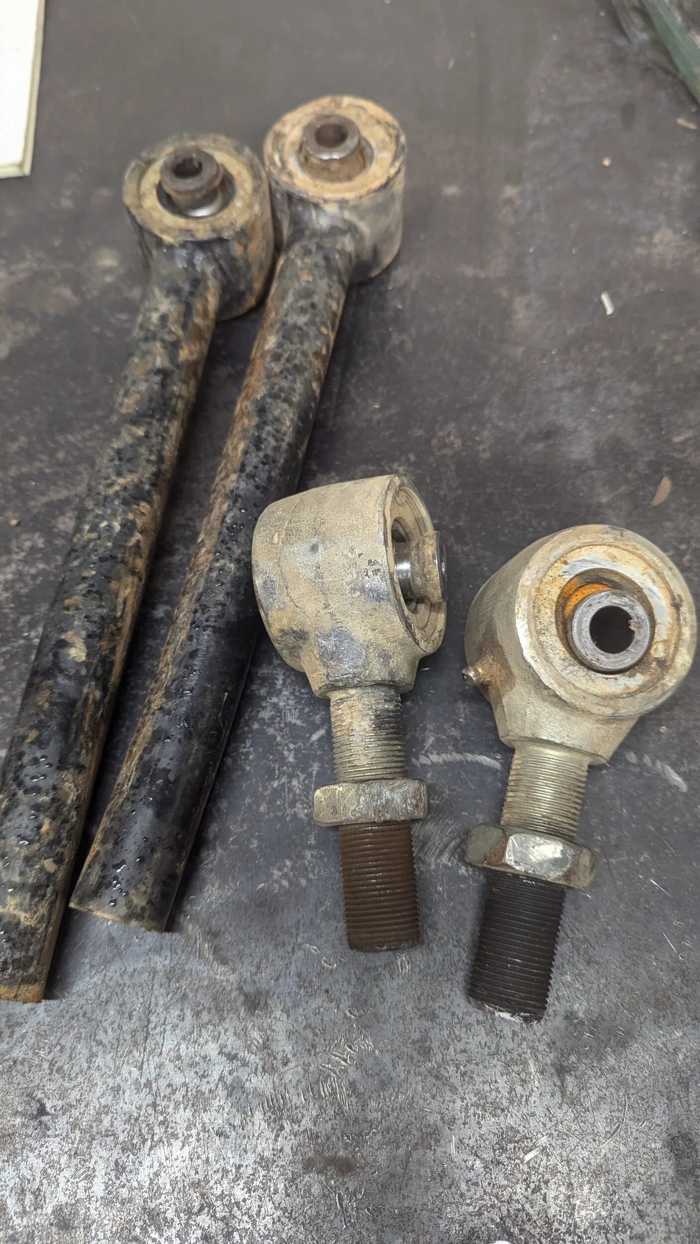

Maybe I'm just being optimistic or short sighted but it seems like it's gotta be the joint itself not something else since my OEM arms weren't completely demolished when I removed them. Just normal old rubber bushing looking.
That was quite some time ago (about a decade, I think). I read a thread on that issue on another forum at least three years ago, and it was old news then. As I recall, the cause was attributed to chipped tooling on the CNC machine that didn't get noticed. It resulted in the groove having a tapered lip, which should be easily visible, if that's the cause.
Interesting... I can look again for some kind of bevel in the lip later. I don't have many precision measuring tools but I have a set of calipers I can at least check if the housing is out of round somehow maybe.

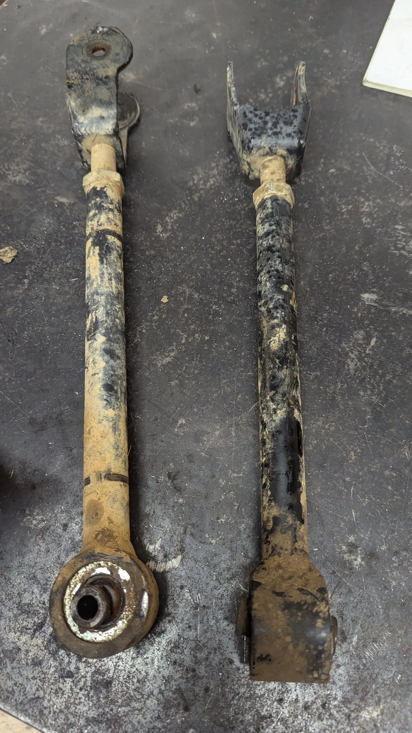

I went and got them out of the scrap pile (they were just removed Thanksgiving weekend so they haven't been sitting back there that long).
Here is the uppers (I didn't clean them off):

And the lowers have a little bend but you are welcome to them as well.
The cost would be a beer the next time I see you. I beat on my stuff so hard that I never feel right selling it for money, just a shared beer here and there.
If you need them send me a PM with your address and I will ship them out.

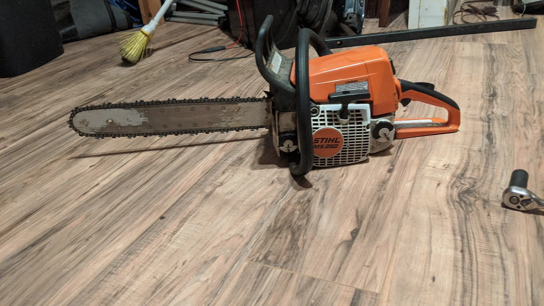

So early this week my family re-re-decided where to do Christmas, and we are back to doing it at my house. I figured if I was going to host it I wanted a real tree, not some lame plastic crap. The tree cutting area is like 12mi from my house, after all... So, I guess it was time to finally figure out that chainsaw my dad gave me.
I think I talked about this in the thread previously, but when I got it it didn't run worth shit, had a full tank of fuel, and I knew it had sat outside for at least a year while they tried to sell their old house. So early in the year I put a new carb (amazon knockoff, this will bite me in the ass later), fuel line, air filter, and spark plug in it. Couldn't get it to start, got distracted, and it sat (inside, mind you).
Time to get it running before Christmas! I had an absolute hell of a time getting it to idle & run with any power. For starters, I'm a millennial, so I don't know a damn thing about carbs. Most of the tuning videos I watched seemed to recommend a "bracketing" approach where you find out where its too lean to run well, then the same but too rich, and then find the sweet spot in between. Well, it seems like the cheapo carb isn't quite right, and I was completely unable to get the low screw to go in far enough to make it run like crap due to being too lean. I suppose I should be happy it is erring on the side of being rich so it doesn't melt down, but what a pain in the ass.

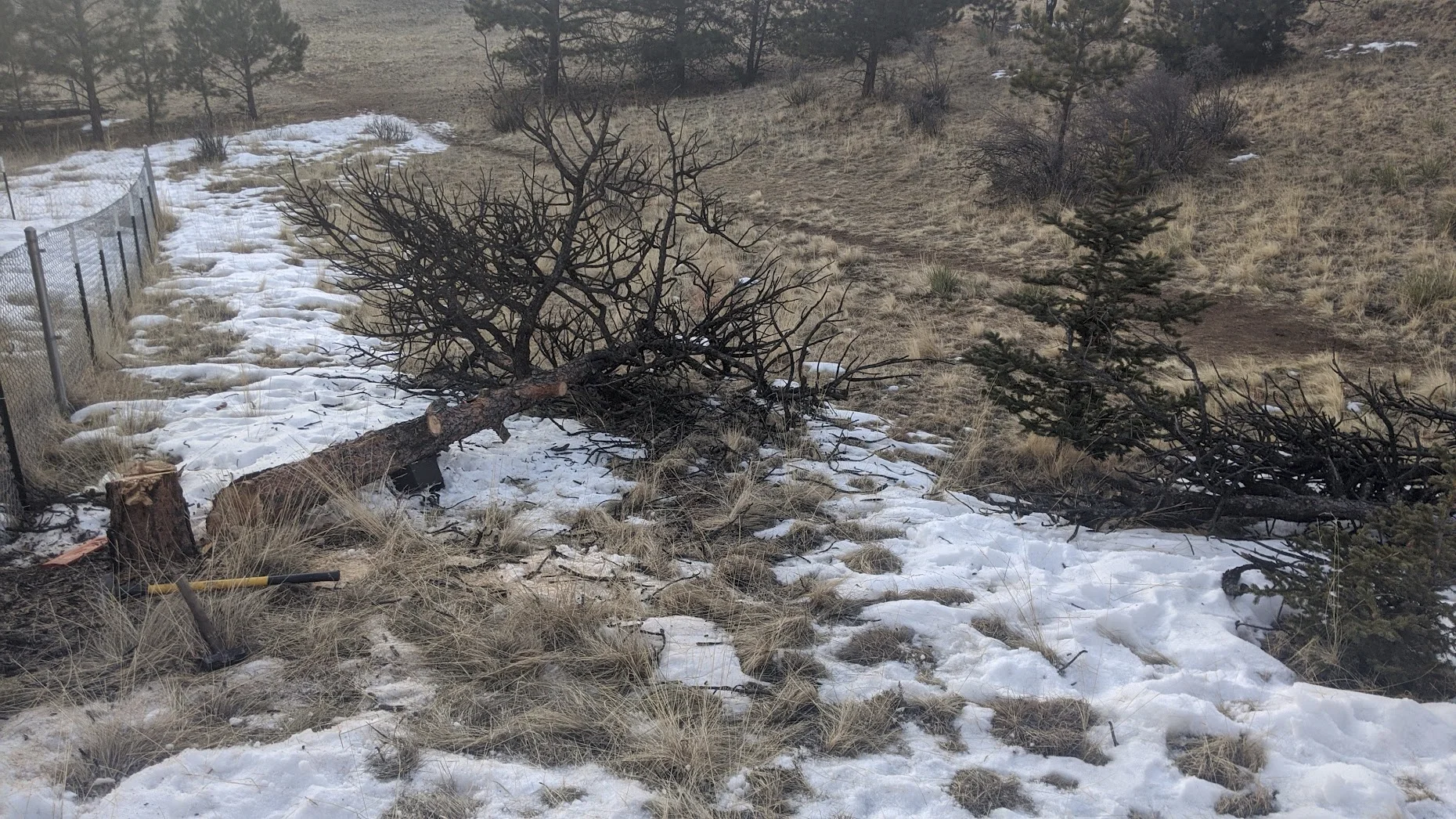

After probably 4 hours across a couple days messing with it and trying to cut stuff I have it "good enough". Not sure its exactly right, but the exhaust is smokey enough I don't think it's too lean and it idles and cuts so I'm content. Cut down my first tree in my life:

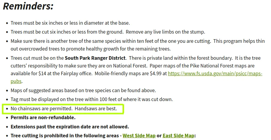

A little scary, but I didn't die so that's cool. So this morning when I was ordering my permit I noticed this little gem:
Well... whoops. Nice to have a running chainsaw, I needed one, but now wasn't the best time to fit that in if I knew better. Guess I'm cuttin my tree like my ancestor's ancestor's ancestor.
