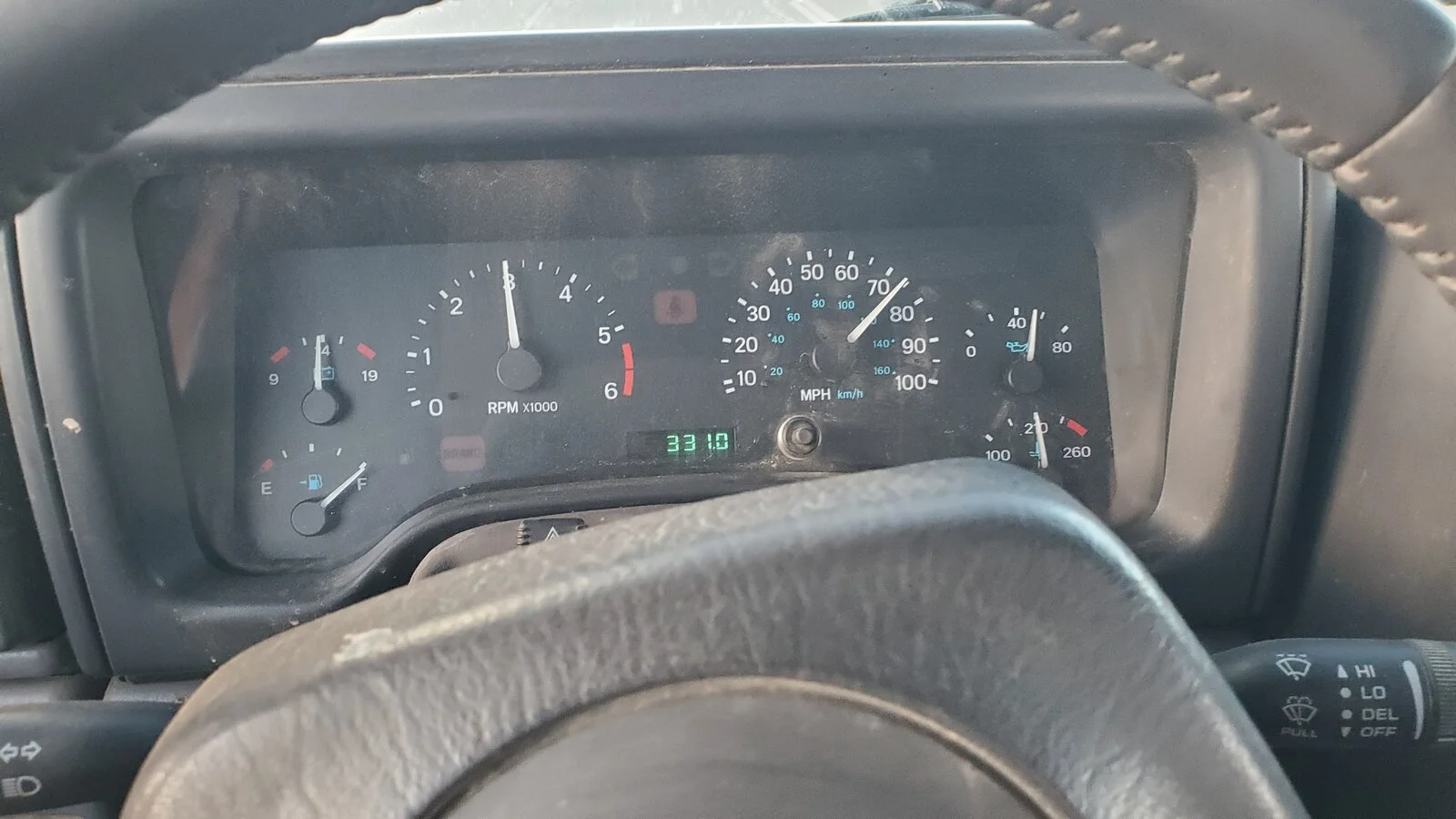

Was this pre or post?
Steering error. That throttle sounds smoov

I'm still beating the rig up and learning what I'm doing.![]()
3.73's on the 5-speed AX-15 has been one of the main weak links though.
More than once I've said to myself "I wish I would've just bought an auto..."
Excited to see how the 4.88's feel.
Hopefully it helps give me that consistent crawl speed I'm itching for, versus the 3k RPM clutch burning masterpiece I've got right now.

3k rpm at 75mph is a good goal.

According to the Grimm Jeeper Calculator, with my current transmission...
4.88's put me at 2944 rpm's @75mph.
5.13's put me at 3095 rpm's @75mph.
I do plan to go to 35's soon after the re-gear.
Opted for 4.88's just because that difference is so minimal.
