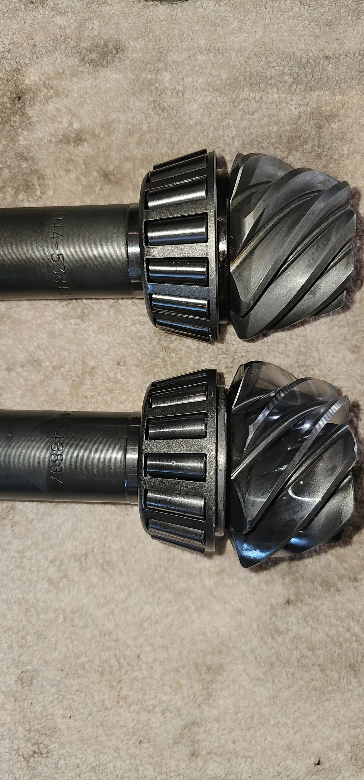

I put my hands on a set of Revolution Dana 30 5.13's that had a stripped pinion, and decided to go for the 4.88's instead.
Something about seeing it side by side with 4.88's turned me off.
Here is a Motive 4.88 pinion next to a Revolution 5.38 pinion.

That's upsetting.

5.13 and 5.38 in the Dana 30 and Dana 44 respectively has been around for quite a while. I don't know about the Dana 35.
What I do know is that the popular understanding of gear ratios, pinion sizes, engine rpms, and the heirarchy of ratios to tire sizes seems to be pushed by a lot of guys who have never once done the math and never paid attention to what Jeep did at the factory.
The early TJs with the 32rh tell us that regearing with 3k rpm at 75mph as a goal still isn't deep enough.

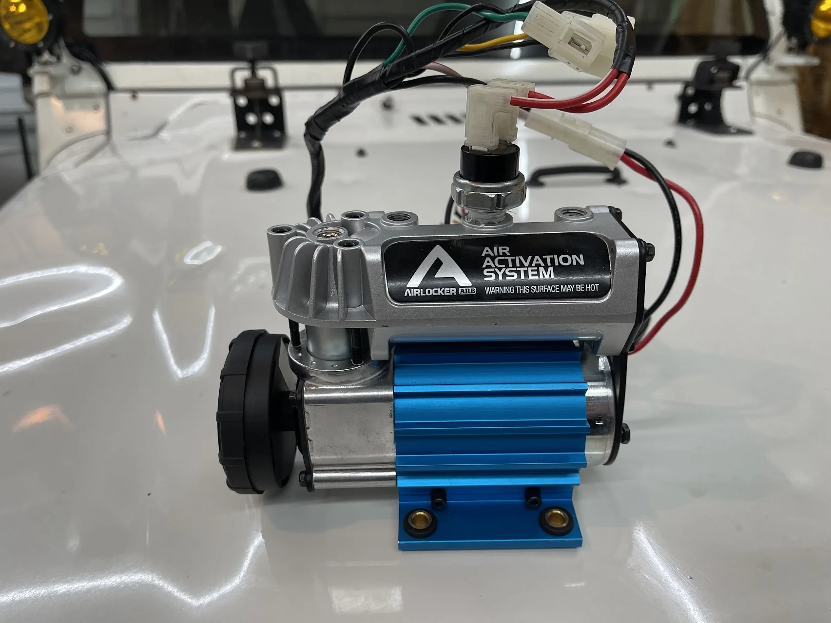

I've been procrastinating the "perfect" on-board air setup.
Found this ARB on Facebook Marketplace FOR $150.
Guy installed it onto his JK, pulled it back off, and chose to run a twin model instead.
Thing is practically brand new.
$100 cheaper than online/new pricing, and works out great for me because I was swaying the direction of running 2 compressors anyways.
(One for lockers, and a separate one for on-board air)
I know the basics of how it should be installed, but if anyone has any pointers/tricks, or anything you wish you'd done differently for the install, feel free to shoot them at me.
For now, I'm happy.
Reactions: Wildman and JMT

That's the best way to run ARB's. Solenoids mount straight to it, can't get much easier.
I've always gutted the ARB wiring as I run mine with a spod.
It's no good for anything other than lockers so you'll definitely need another compressor for OBA.
Reactions: JMT
It’s not ideal for air, but I can air up a 35” tire from 8psi to 26psi in about 2 1/2 minutes running that compressor….
