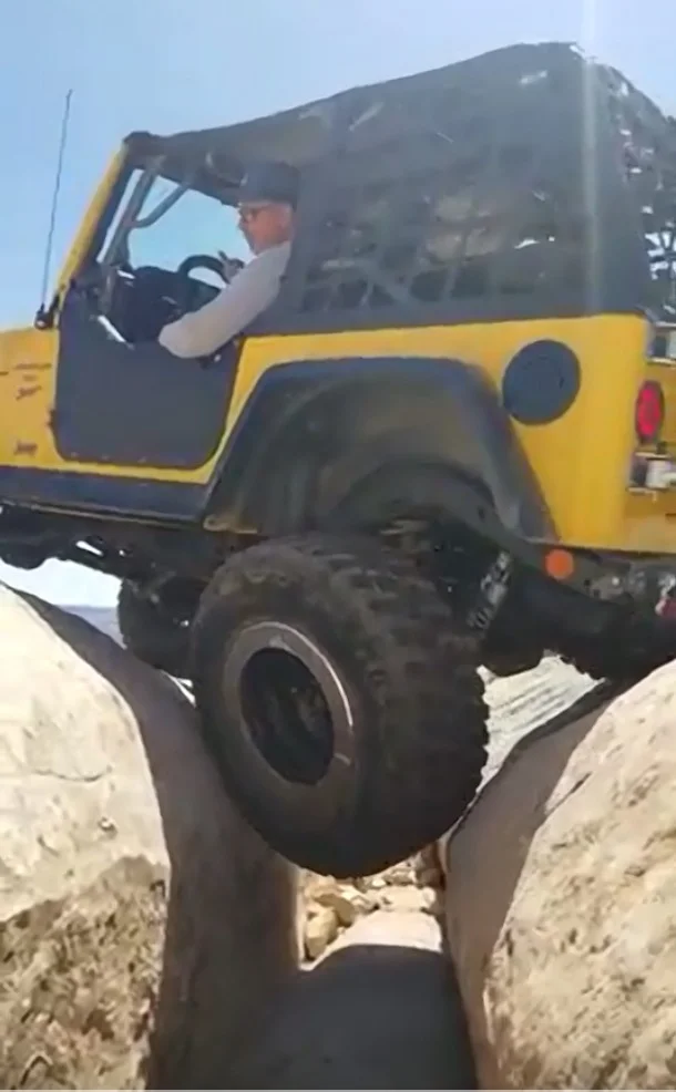

Something like this. If mine has 35s and the same bump stops after raising the shocks, the driver's side would be mashed hard into the rear wall.

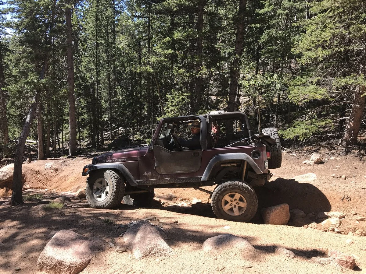

Wheels turned from the opposite side, but this shows the tire is very well stuffed.
I’ve done similar obstacles with no rubbing, you’ll have to take my word on it and I’ll shoot you some pictures of my inner fenders.
This is an obstacle called the golden crack as your drivers rear starts to climb the other side you turn full lock driver to avoid grounding your tub on the right rear.

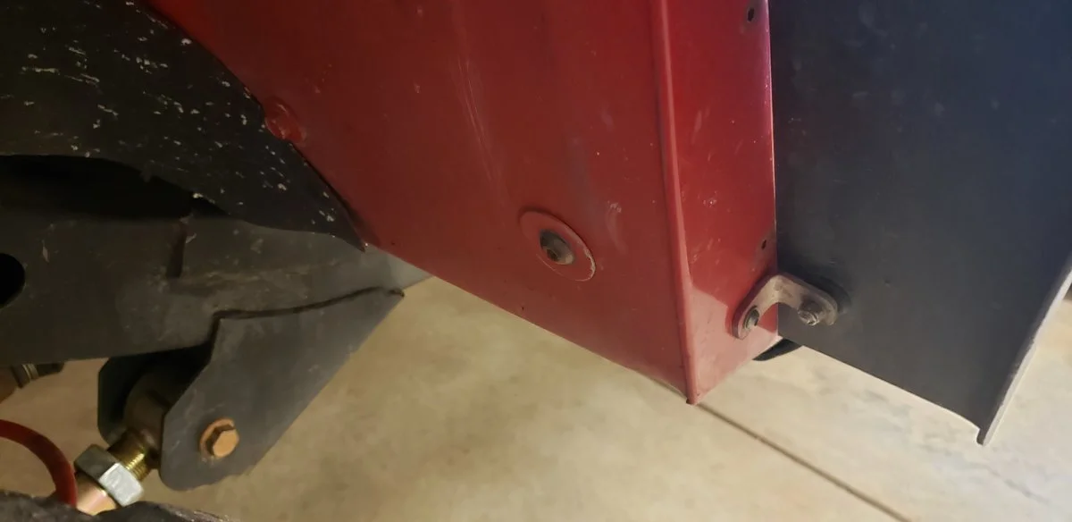

I run MCE'S and have 35's I also have the same front shock combo as @jjvw. With 3.5" of back space. But I rub the rear of my fender at full lock and full bump pretty hard and that's with an extra 1/2" of bumpstop over what he runs. The larger issue isn't so much the sheet metal as the bolt head that holds the inner fender to the abs tray. I removed that bolt and replaced it with a button head Allen so it wouldn't tear up the tire in that situation
