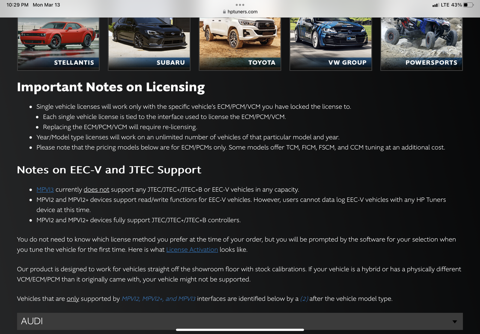

Folks, caution on HPTuners MPVI3! The below is an update from their website—JTEC PCMs are not supported (middle of vehicle support page). There have been Jeep guys with locked up PCMs since MPVI3 came out in about October ‘22–check the forum page on “Dodge Tuning-Gas”. They had an Alpha release for JTEC but have since published JTEC is not supported. MPVI2+ still supports JTEC but they are discontinued. I have been waiting on this to get my new stroker tuned since September and am about to punt and go with SCT. Please let me know if you find out differently. TJBUD

It lists 97-04 Wrangler 4.0 as well as 05-06 Wranglers 2.4 & 4.0. I don't see the part of the page you took your screenshot from there at all any longer. Maybe the problem was resolved?
