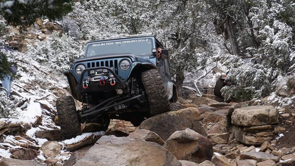

It’s plenty capable but it’s on a bit more than 33”s now. But did just fine when it was that way.
Hp44 front, rockjock 60 rear, atlas 4speed, lockers and 5.13’s, 37”s and 4” lift and 1.25” body lift. These are from the Liberty trail in Penrose Colorado

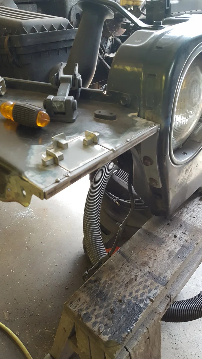

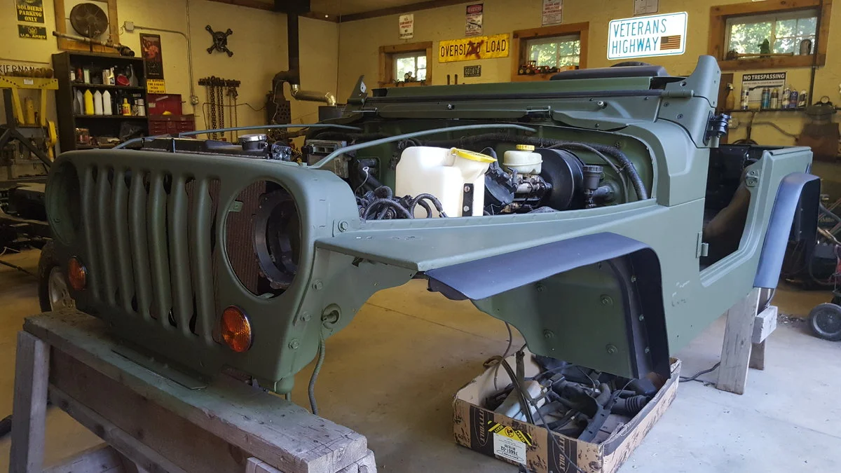

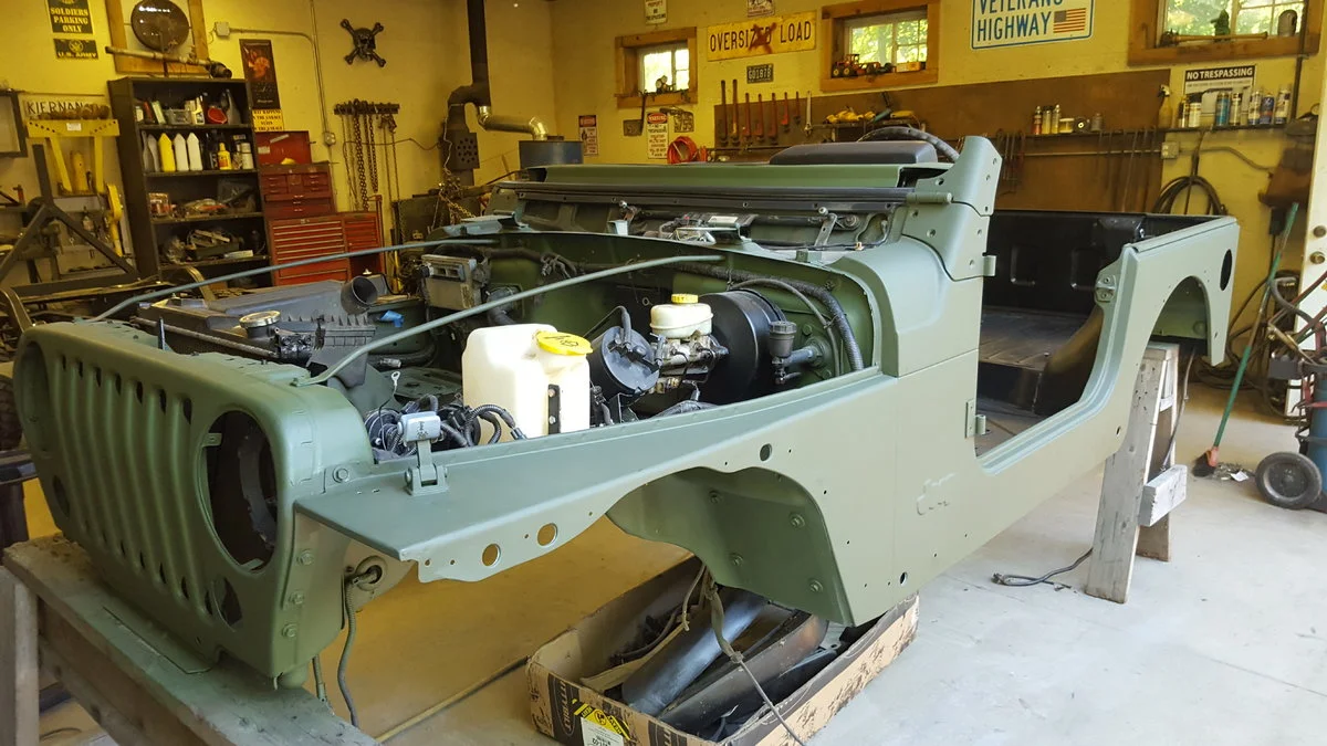

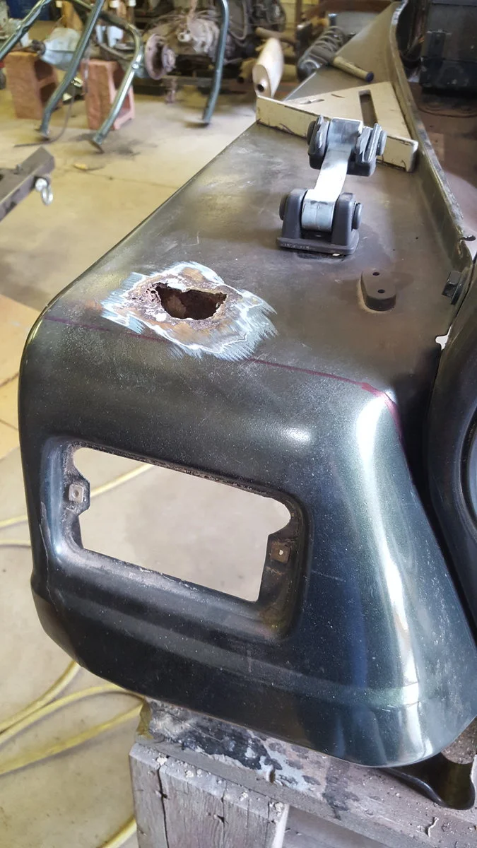

I'm running "mike" fenders... I had rot on both, and the drivers side was pushed in where it curves down and houses the front directional... it was a win win to cut them. If they came out like crap, I'd just get new ones... if they looked goid than i saved X amount not buying new ones. Wasn't very hard to do.
Where can I find more details on this mod? interested in doing this.
If you are going through all that work, why not do a highline mod at that point iita a nice few inches of uptravel, shouldn't be to hard to mod it
I'm sure their a many mods and ways to do things... I like trying "save" things and use what i have. Some times all I have is time and ability. With that said, their are several vids on YouTube that show how to do something similar.
I get that because the limiting factor is the vertical surface that the plastics mount to. I'm just not crazy about the stock fender look but don't have the $$$ for a fender kit currently.
