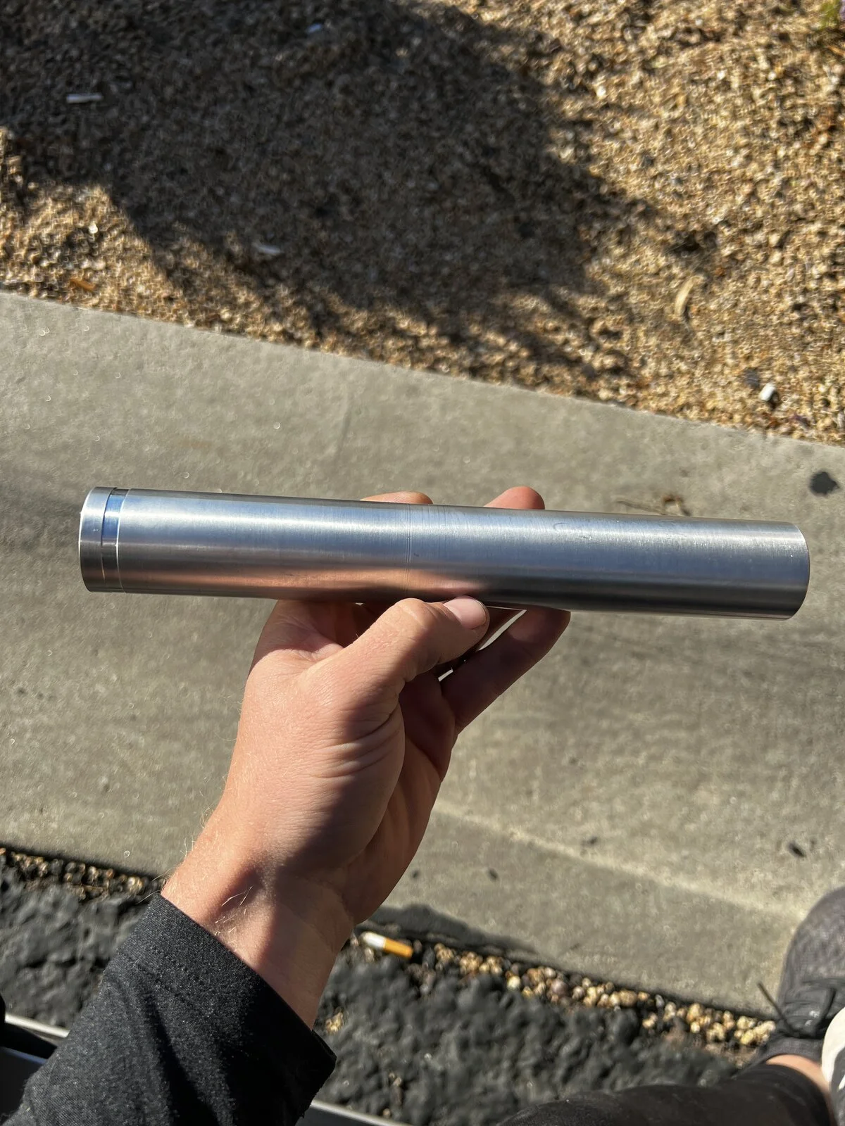

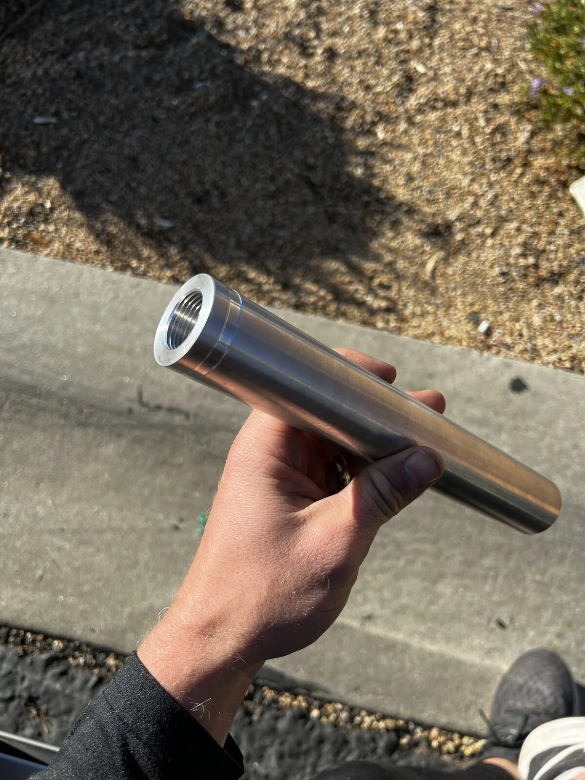

Im getting aluminum links made for my 4 link I’m doing in the rear, and it was significantly cheaper to find a local shop that machines their own links than it was to order online. I was quoted about $300 for the 4 links from a local shop and $450 from wideopendesign. A 3 link would be even less than that.
