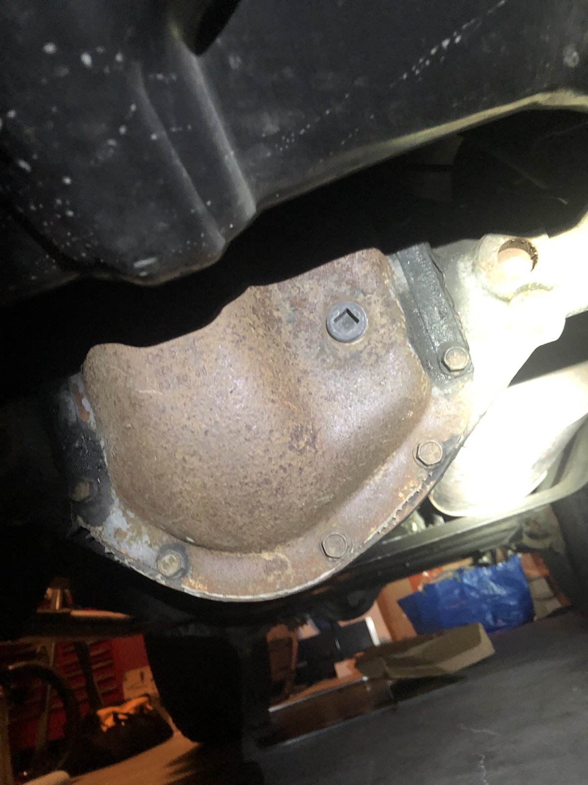

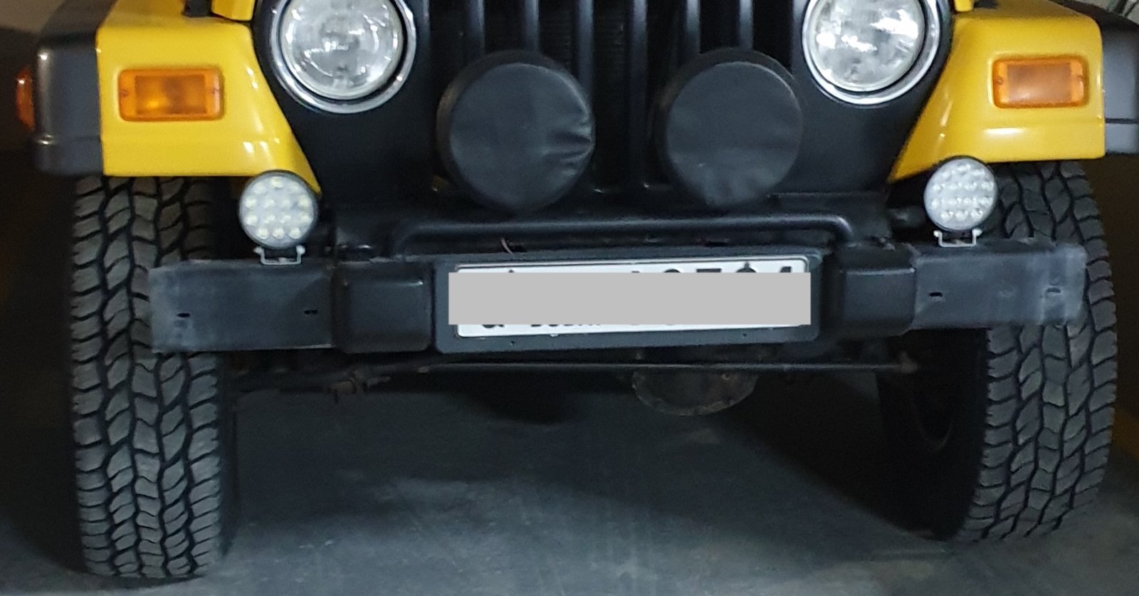

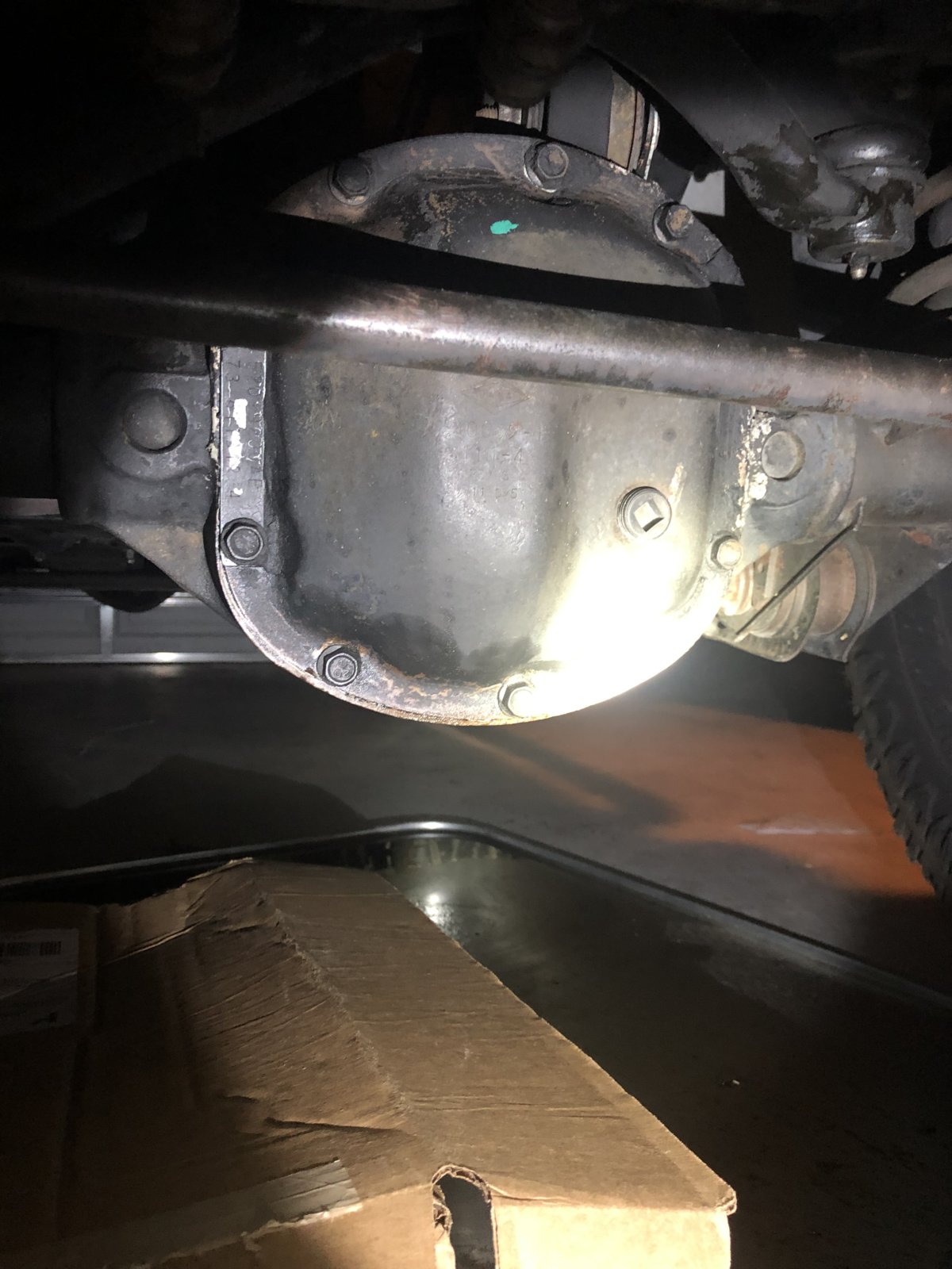

Can anyone help me? I’m having difficulty identifying my diff. Thank you so much in advance! With this diff, should I expect any issues with 33” tires off roading ? Thanks again!
Additionally, it appears to me that you have 3.73 gears, based on what I see on the tag that's on your Dana 30. The left tag on your Dana 44 (rear axle) should have the same gear ratio showing (look for a 3.73 on the bottom line of the stampings). Also, if I'm not mistaken, the tag that's on the right side of the differential cover (rear axle) should say something about Trac-lok, or LSD (Limited Slip Differential), and using the proper gear oil. If so, that means you have an LSD...a "posi", as us old timers called 'em. Also a plus.
Unless the person you bought it from told you they had upgraded the front or rear diff (likely a selling point) they are most likely stock. That said, one way to determine what you have is to download your build sheet. It will also list whether it came with trac-loc etc.

Thank you ! According to my build sheet.
I have a Dana 30/186MM front axle and a heavy duty Dana 40 with trak-lok on rear.
