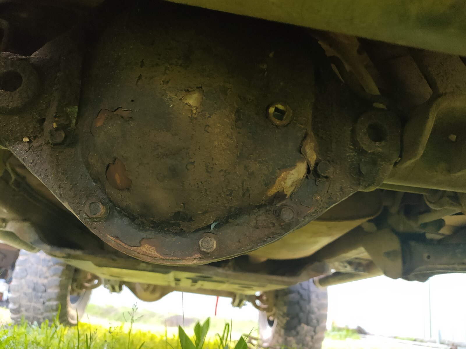

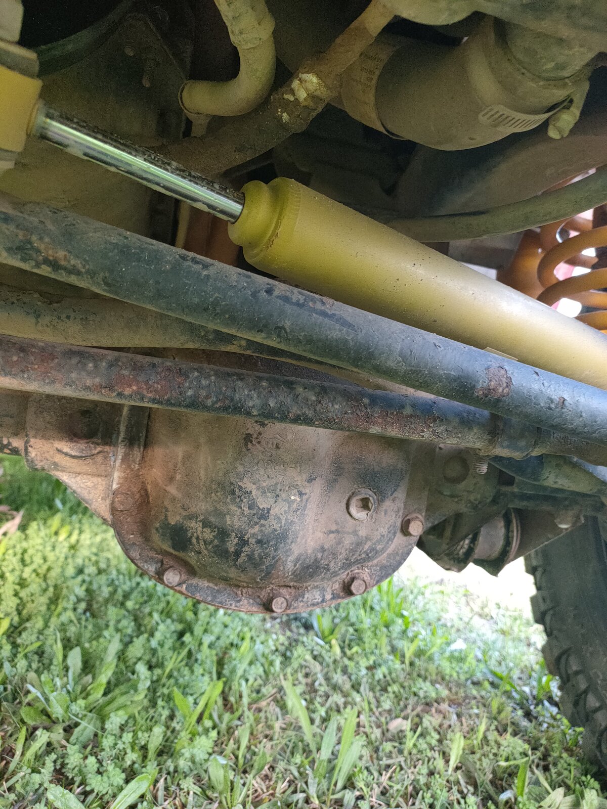

So I just picked up a 2006 LJ and I’m trying to figure out what it has for a lift maybe 3”?
Front 30 and back 44’s?
This looks like a Dana 30 front and ford 8.8 rear? I’m assuming the brake line has the valve in it to reduce brake pressure to the rear due to the disk brakes on the ford axle? I wonder how I would identify what ford the rear axle came from, sooner or later I’ll need parts like brakes or gears etc.

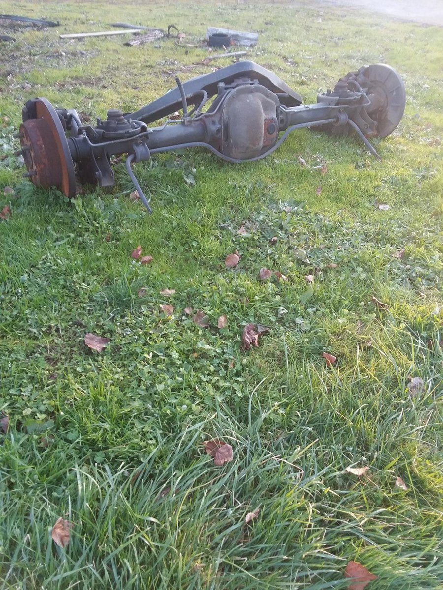

Sorry to bring up an old thread but I need help and I'm knew to the forum. I've had a dana 35 in my jeep since I got it 12 years ago when I was 15. I'm fiscally in the ball Park for a Dana 44! Woot! A guy is selling one about an hour away that he says came from a 99 wrangler. But it has a rubber plug and this weird thing that looks like it bolts onto the to of the housing. What is it?! Btw, he wants $325. It also has a limited slip in it.

Jeep Liberty? Definitely not from a TJ. None of the brackets are correct.
Reactions: Zach97wrangler
cover doesn't look quite right to me. and rear disks makes it newer, looks more like it's an aluminum center from a newer JGC. but they didn't have that gizmo up top.
i could be wrong
Thank you! I was so confused! Will it still work in my tj? Probably not without a lot of work right?
None of the brackets are in the right places, except maybe the spring seats. Maybe. Beyond that, I don't know anything else about that axle.
