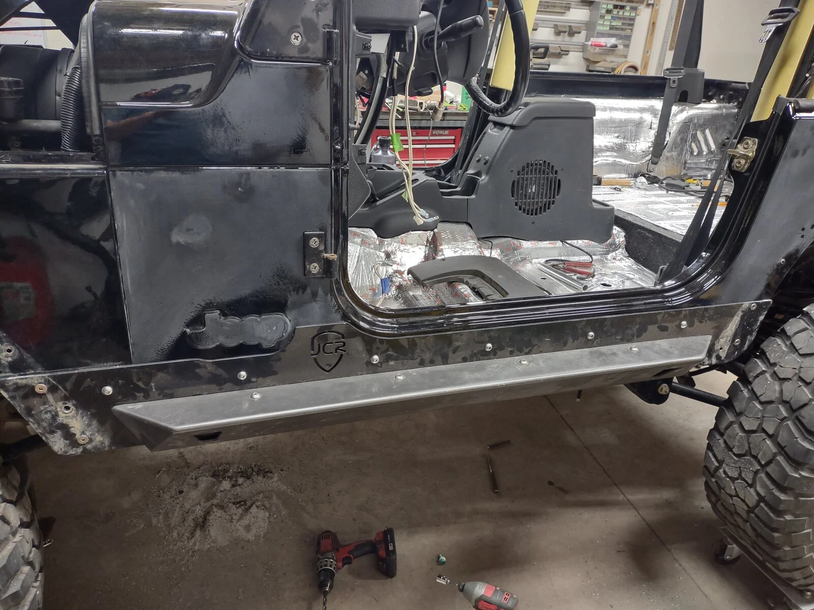

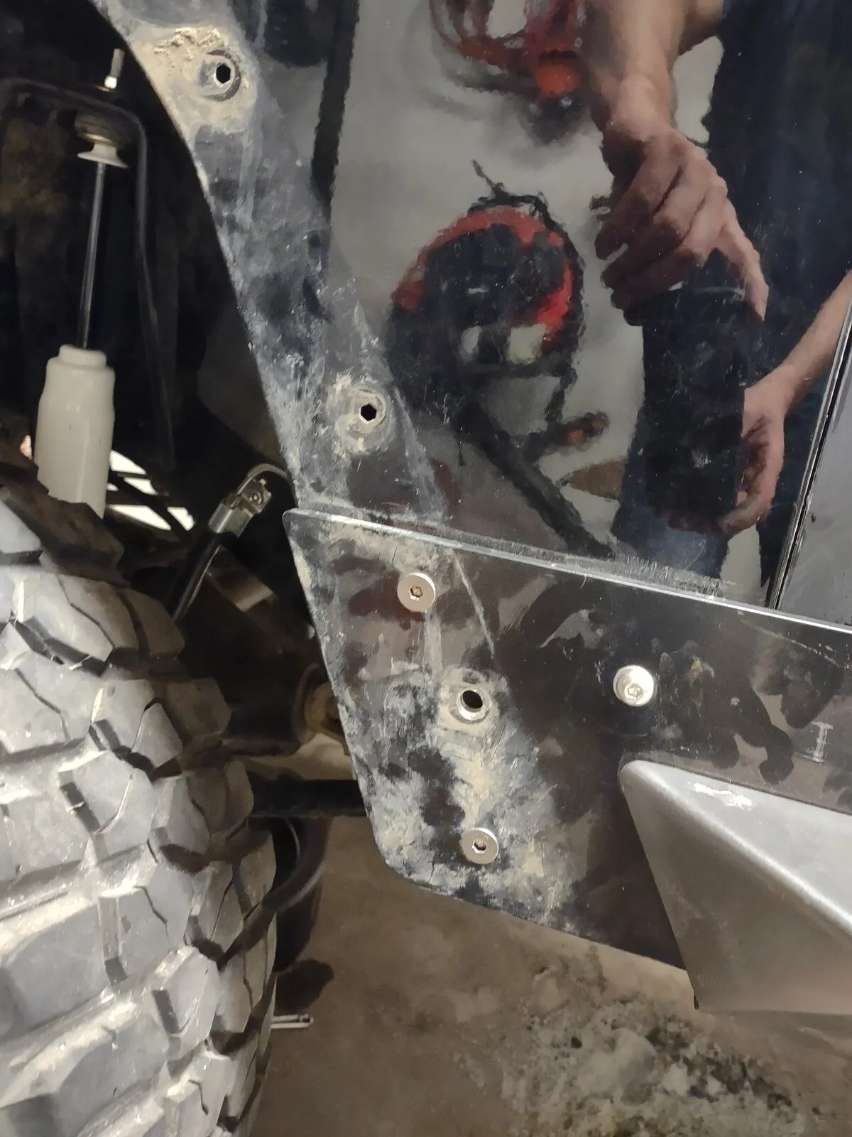

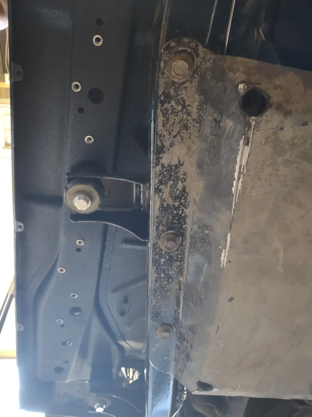

The last of my fab work was figuring out how to attach these dumb JCR sliders. At the time I bought them, I didn't really know better and thought they were comparable to savvy. But I got them for about 200 dollars cheaper because of a good sale at 4wp.com, so I went JCR.
Well... They kinda suck. I mean, they'll do the job. They are plenty strong. They just aren't designed all that well. The backer is a flat piece that sits against the tub and the slider portion is a "step" that is boat-sided and wraps underneath to the torque boxes. JCRs installation calls for drilling 4, 1/2" holes through the torque boxes and the floor, and 5 through the sides of the tub. Three under the doors, and one through each through the flares (front and rear). I was never really happy with this arrangement, and having a brand new tub gave me an opportunity to "fix" it.
I started by preloading the sliders, like you would with a savvy slider. They don't have any over bend built in, but I wanted it to be tight when I started drilling a bunch of holes.
This was the first time I noticed a BIG issue with these sliders. The torque boxes raise up about 3/8" after the middle body mount. My sliders only have a 3/16" spacer welded on. So, pressing them tight to the tub meant the sliders didn't fit parallel to the door. That's just not acceptable. So, I added some spacers to get the fit right.

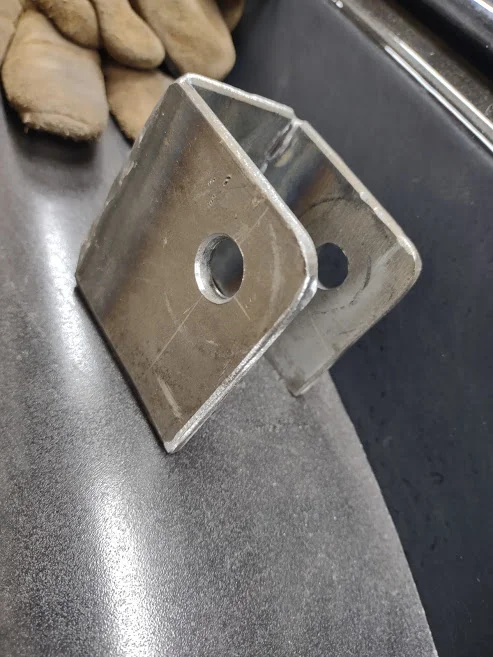

Then I started drilling holes...I added a few to the sides of the tub. Two each at the front and rear, under the flares. I didn't want a chance of the fender or slider tearing away from each other. I made sure I have a 5/16" bolt every 6" minimum.
Along the bottom, I added 10 nutserts to the bottom torque box. Again, every 6 inches and staggered.
Finally, I had to add some material to space out the slider from the tub. I found some old 3/8" bar stick at work that I liberated, and welded it in place.
Quick shot of paint, and ready to install.
This was a ton of work. In short, just buy Savvy sliders. These will work, they are mounted securely, and will protect my tub. But... So much extra work.

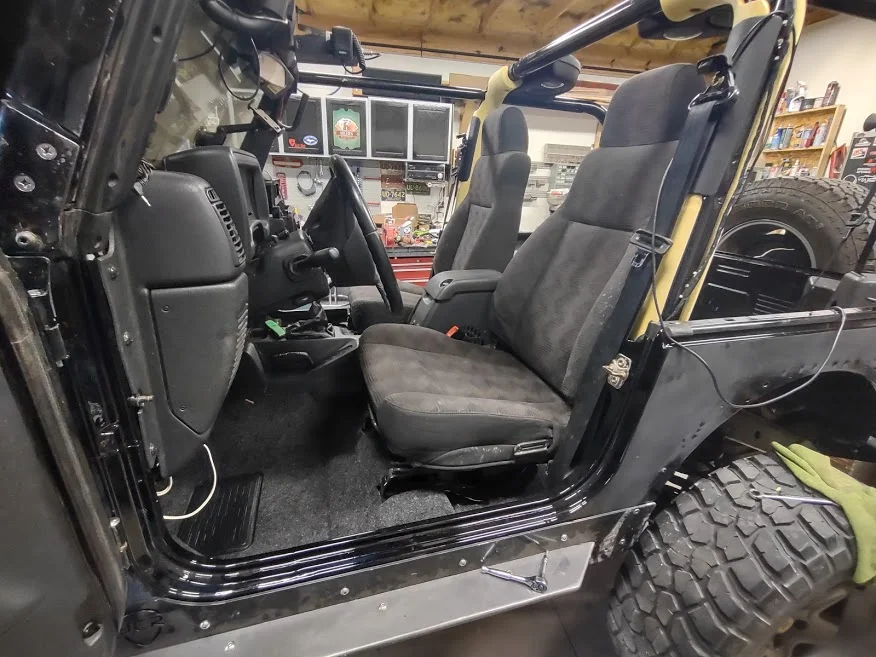

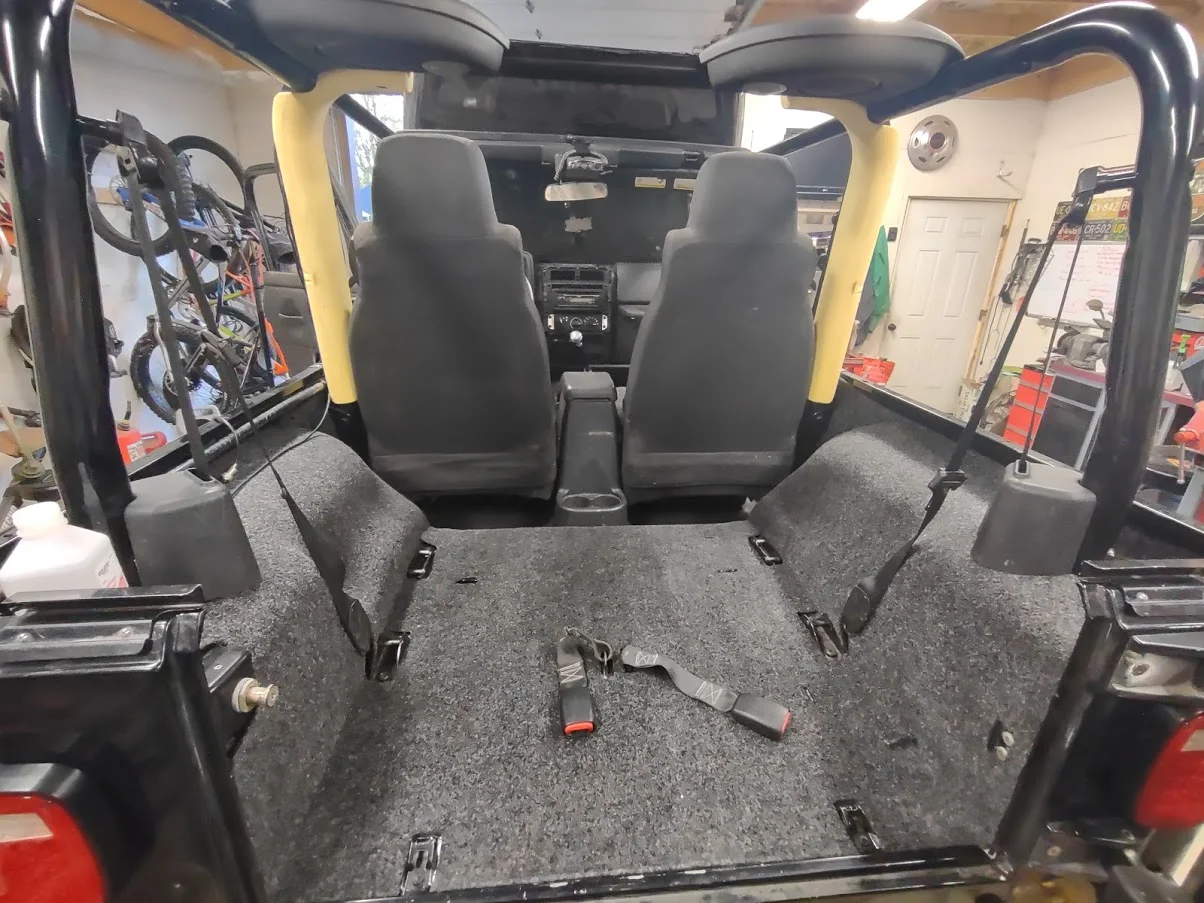

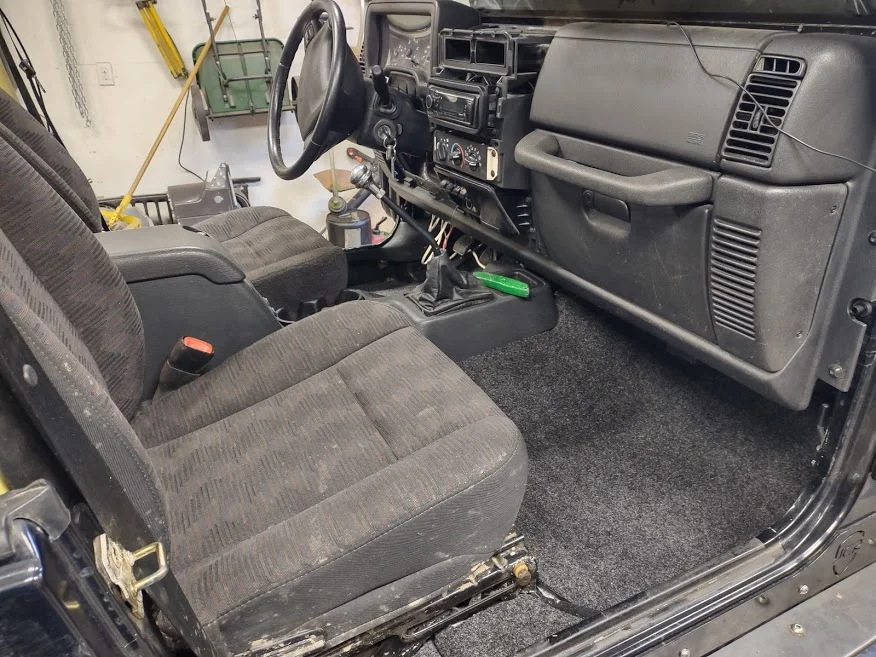

Got most of the interior back together over the last couple days. I still have to finish my stereo. I'm waiting on a crimp and ferrule set to make my install a little cleaner. I also have to finish routing wires for my CB radio and the antenna for Sat radio.
But, I got the bedrug installed. That stuff is really nice. Well, Its really nice compared to the crap I pulled out. Its a lot softer than I expected too...I was expecting something more like indoor outdoor carpet (very plasticy feeling) but this stuff feels like honest to goodness carpet. Its not quite as molded as I expected, so it looks just a little sloppy in a couple corners, but overall, it looks really nice and I'm happy with it.
I also finished installing the roll bar padding and covers. I think I've installed and taken off the seatbelts 3-5 times now!

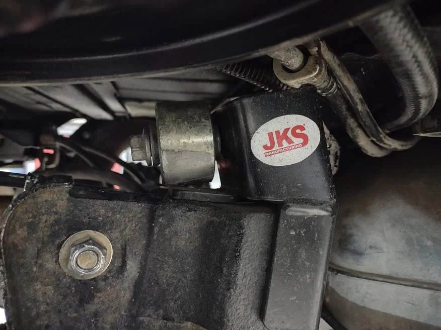

well, I have been thrashing the last couple days. Everything is assembled. Doors are lined up, winch is installed, fluids are topped up and the battery is charged. Started cycling the suspension today and took a major left turn. When I tried to compress the axle, I had a MAJOR collision between the track bar and the Savvy skid flange. I think others have as well. I think @JMT struggled. Here is where I started with my interference. Pretty Major. Leaving it here would have require something like 4.5" of bumpstop. On an 8" travel shock...that just isn't going to work.

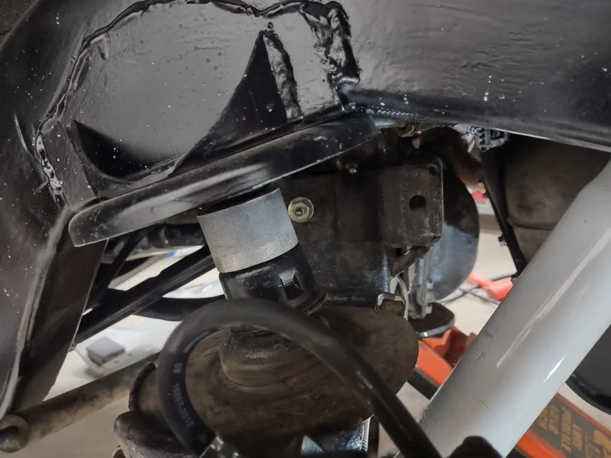

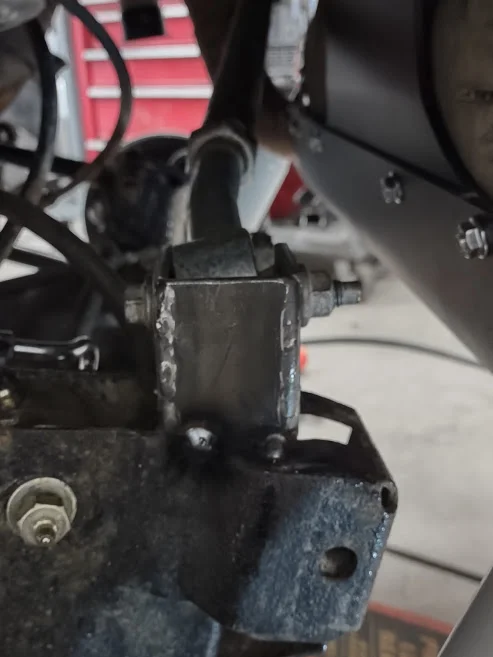

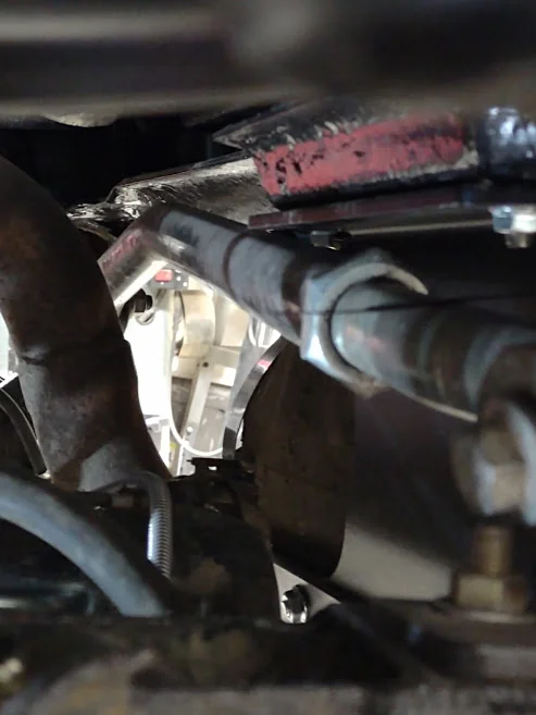

I was freaking out a little bit. I have a big deadline looming over me and I did NOT need this. I spun my wheels a little bit but then I tried something a bit unorthadox. I unbolted my axle side of the trackbar and re-bolted to the back side of the relocation bracket. Then I cycled the suspension...and it cleared!
Obviously, I can't run the trackbar like this. So...what to do. I didn't really want to sacrifice the JKS bracket, just in case. That is plan B. So, I made a new bracket...I thought I was done with Fab work, but apparently not.

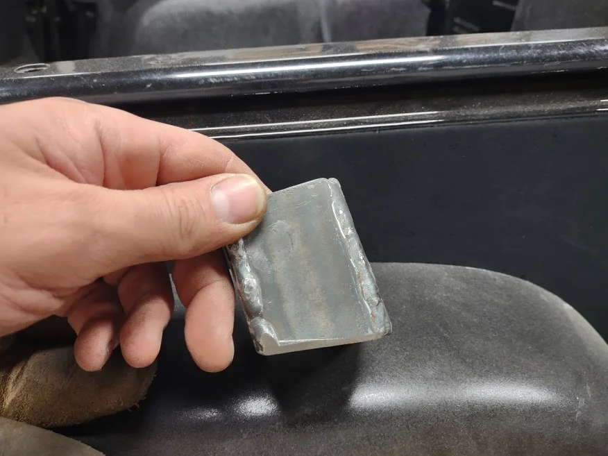

Patterning the JKS piece, I got some 3/16 flat stock that was leftover from my bumper project. I cut a strip the width of the tallest section of the JKS bracket, then put two "score" lines in it with my cut-off wheel to work as a fold line. I folded the bracket up and welded the corners in and Voila! A new bracket
I tacked it in position and cycled the suspension.
Plenty of clearance now! I might even be able to slide my axle back a half inch or so...
I have about an inch of shock shaft still showing, so I may re-install my bar pin eliminators and gain that inch back in droop...we'll see. A buddy of mine, who is a weldor by trade, is coming over tomorrow to help with some yardwork...he's gonna do some welding for me too...I don't want to be the guy permanently burning in a trackbar bracket. Too Risky for my blood. I'm getting better with the welder...but I'm not confident in my ability for that yet.

That was exactly my problem. Keen solution. Very smart, I think!
I think it will work. I do want to mention, I have a now out of production Currie bracket reinforcement on my factory bracket that is welded to the axle tube. I don't know that I'd try this if I didn't have that reinforcement.

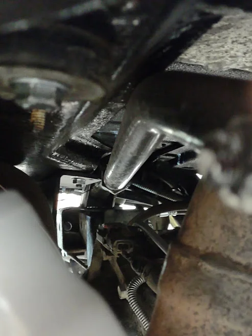

Last night I installed my engine skid and found out I had not secured the transmission mount to the transmission skid...ooops number 1.

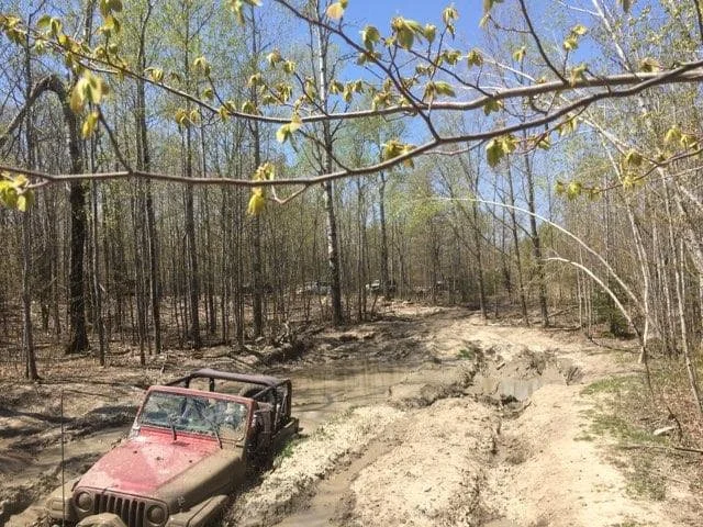

Oh, we played in the tank traps one day too...Have I mentioned I hate mud? Yeah, we had a couple rigs overheating on the way home because the radiators are plugged. I'm not ashamed to just say NO so I didn't get stuck this trip...but I still ended up with crap in my grill. Not as bad, but I still have to clean.
This is a so called "tank trap" Its a relatively shallow one too. Not sure what the story behind these are....I don't know if they are actual military tank pits left over from some exercise, or if they are just dug out holes in the trail from years of wheeling. I know that its all fine shale clay and it is sticky, nasty, slippery and ridiculous. I will not be going to the SE side of the island, ever again.
We even got to practice our recovery. This poor guy had a rough day. @mrblaine has talked about not angering the "rock Gods" Well, my buddy Steve must have. He trashed his CJ this trip. He lost the rear DS on a dirt road. He decided to continue on in FWD and "take it easy". Then he had electrical problems. We got those sorted and he wanted to keep going. He finally broke his front axle, trying a climb. It was "one last try" before we started stacking rocks. He blew up his passenger side U-joint. It was captured on video too. Its kinda awesome. Anyway, we had to side pull and pull him up the hill simultaneously to get him past the rocks....

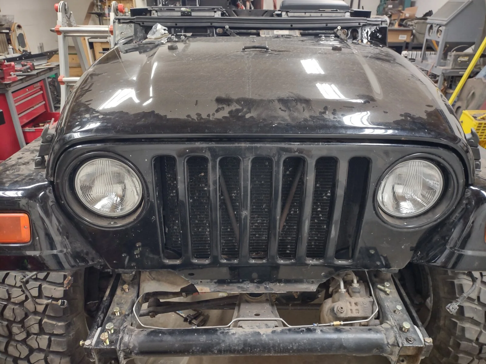

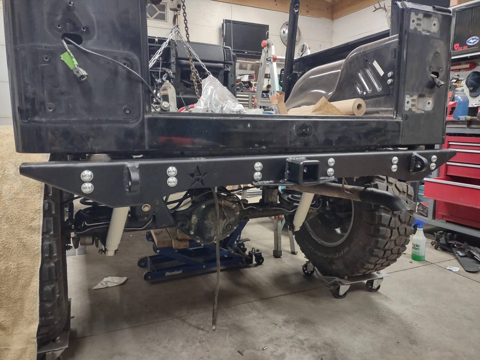

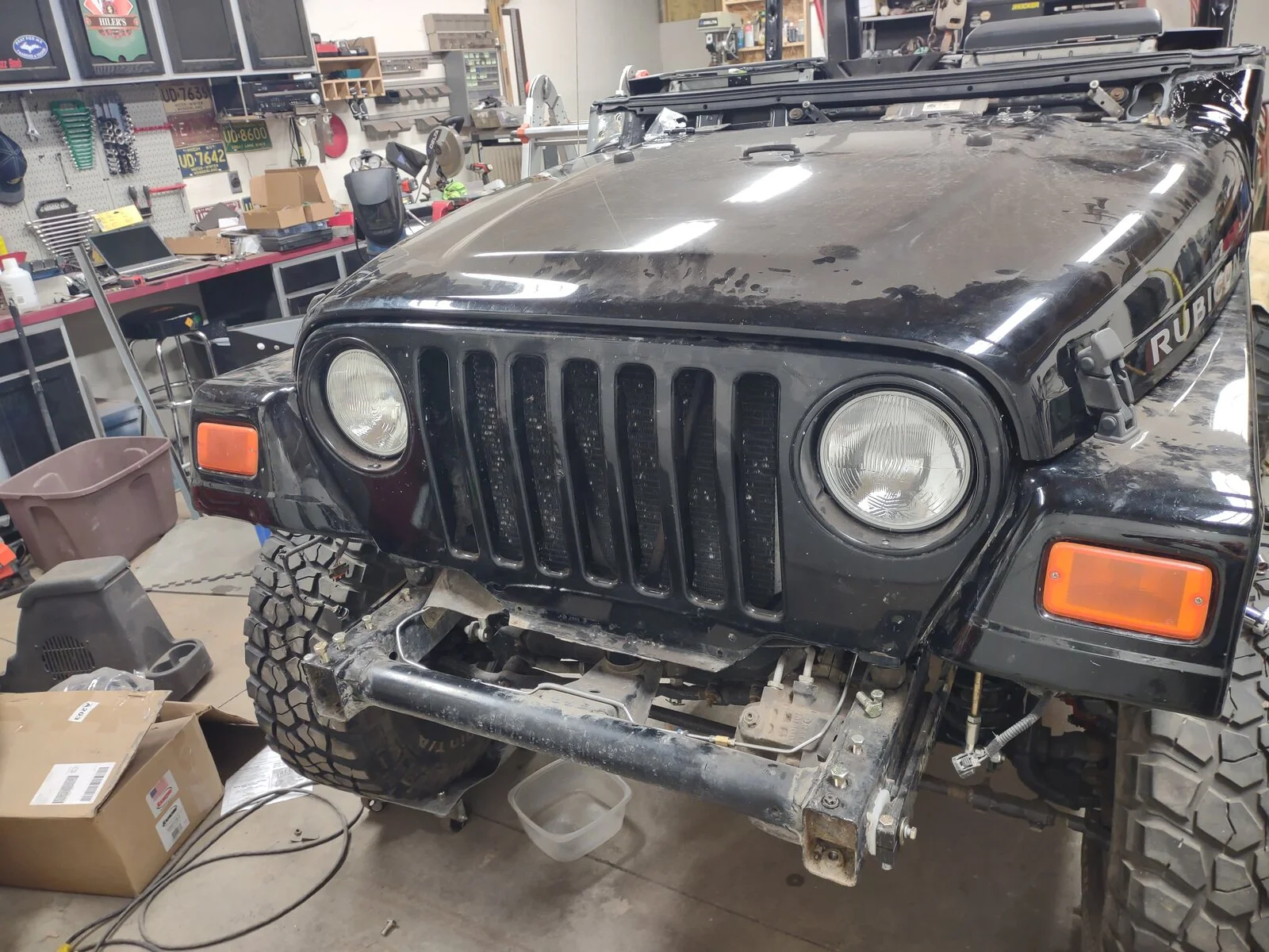

Working on installing the body panel today. Got my rear bumper installed too.
Front end went on too. Both fenders were installed, and, since I had some help, decided to tackle the hood. What a pain in the ass. We went back and forth with it. It's like the front fenders are set up out of square. We got it to drop down and not crash into either side of the grill. It will work, but if like to make it better.
Also got my brakes leak free and bled. I replaced all the hard and soft lines.
The dash is about 80 percent done too, so I'm getting close to trying this thing out!
Its going to look great when you're finished!

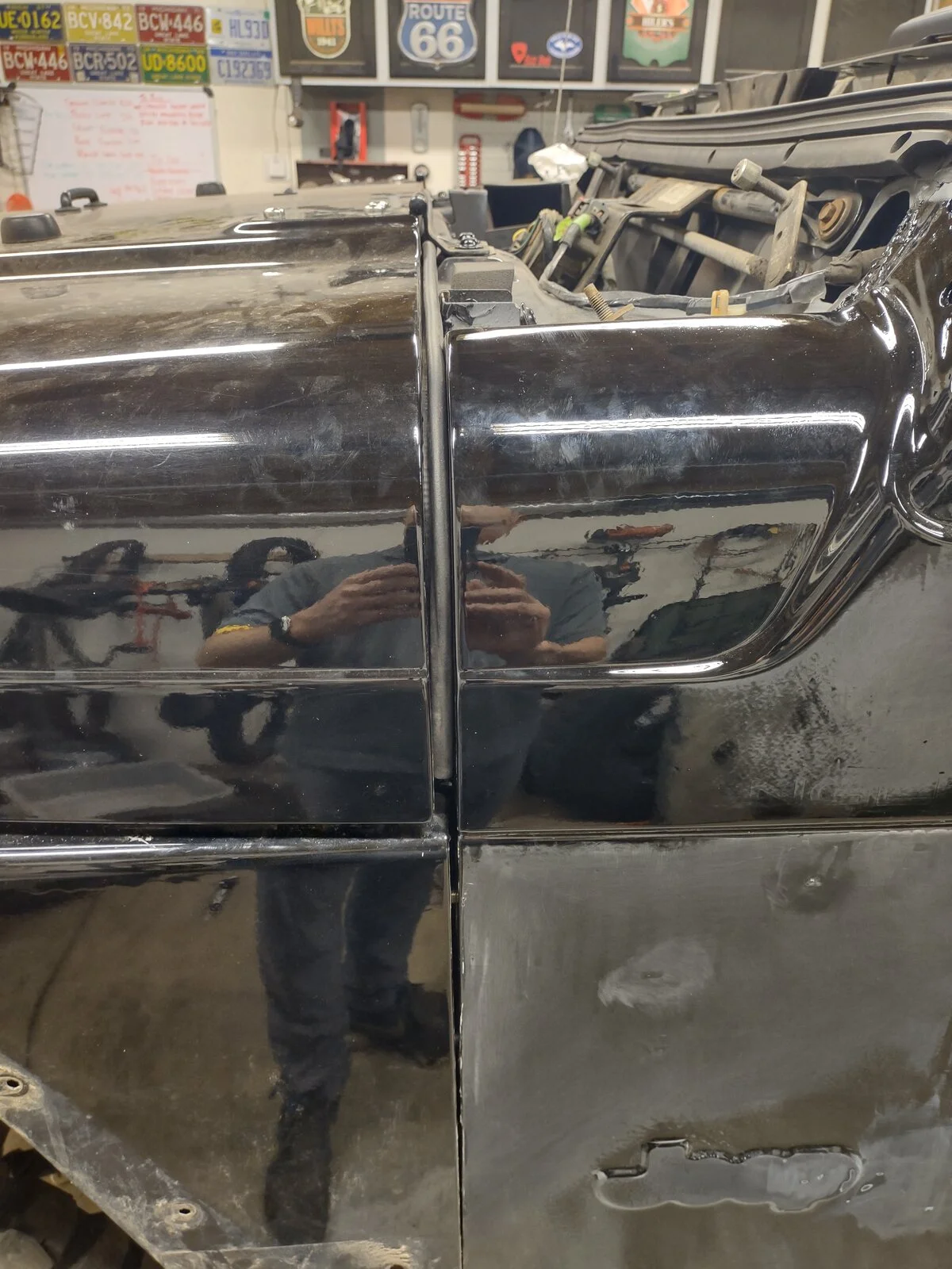

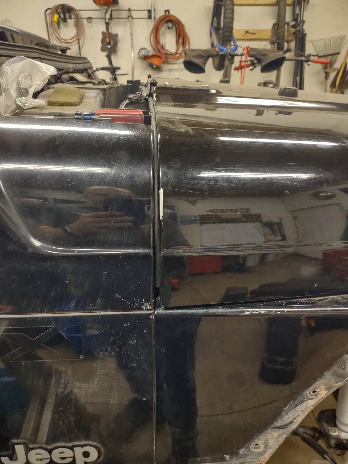

When I installed my new fenders the hood was hitting/rubbing at either side. Turns out that the hood is supper easy to flex out of square due to being just stamped sheet metal. Its pretty easily to "tweek" it by pushing/pulling on opposite corners or sides to force it to line up more evenly....If that makes sense.
edit:tweek
