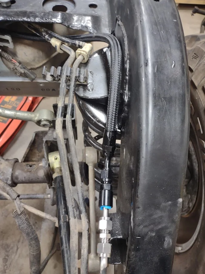

I spent most of my time dicking with the fuel line. With the coil perch relocation, the hard line doesn't really fit correctly. So I bent it around to fit, but I'm not happy with the result.
I posted a thread about it Here. Any input is appreciated!
Figured out my fuel line tonight. Full details over here —->>>CLICK<<<—- but here are the cliff notes:
Some -6 AN line, a couple 45° swivels and a couple QD fittings, and I'm back in business. The key is that stainless union at the bottom of the photo. I shortened my stainless factory hardline up and cut all the kinky re-bends out that I made. It's not perfect...I probably should have made a bracket to screw to the frame and used a bulkhead fitting, but, it'll do, Pig. It'll do.

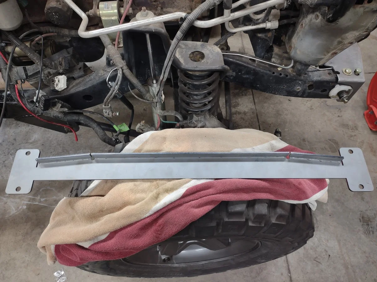

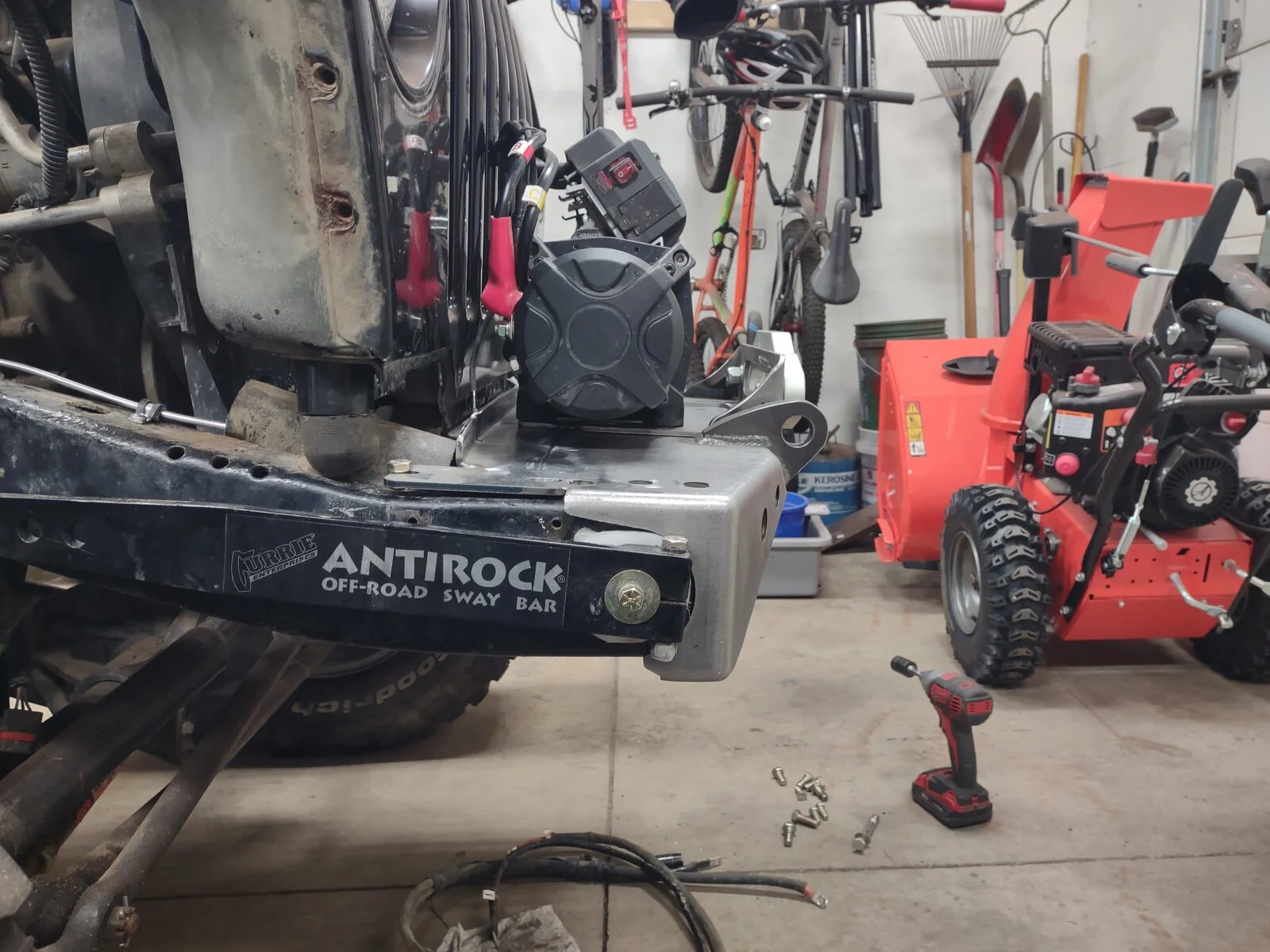

In other areas...My new front bumper design is done. For a refresher, I bought a motobilt stubby and again, patterning @jjvw's build, I designed up an addition to the bumper.
This will allow me to slide the winch back at least two inches toward the grill...helps protect it without a big hoop on the end. I will trim the 1" stiffening flange on the motobilt design, taper the butt edges, and weld this fabricated piece in...
Cost me 75 bucks to have this made, but its WAY better than I would have done with the tools I have. I just sent a print to my uncle's shop and then picked it up. With the time crunch I feel I'm under, the more parallel paths I can have, the better. My goal for the weekend is get the front bumper done, then send everything steel off to powdercoat Monday. "Everything Steel" will be my front bumper, rear bumper, a tire mount tag bracket, the supports for a Savvy Gas Tank skid, and anything else I can think of (like the grill support struts).

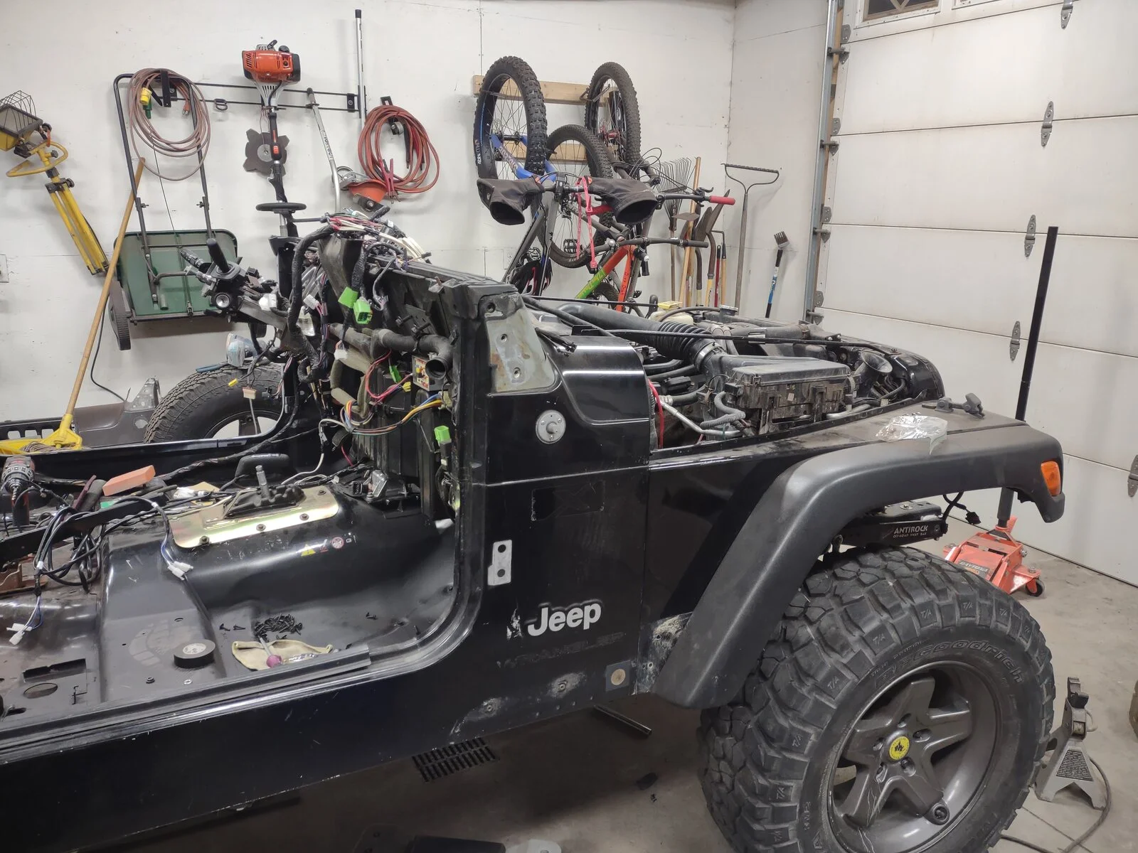

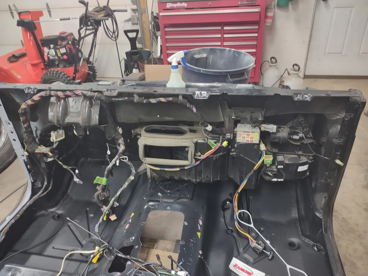

Then I gotta thrash like a madman to get the tub reassembled. I have a headstart...got the HVAC and main wire harness mounted last night.
I hope I did enough labeling, taking of pictures, and making drawings to be able to slam it back together. Once the tub is on and complete, I still need to cycle the suspension, install new shocks and set bumpstops!

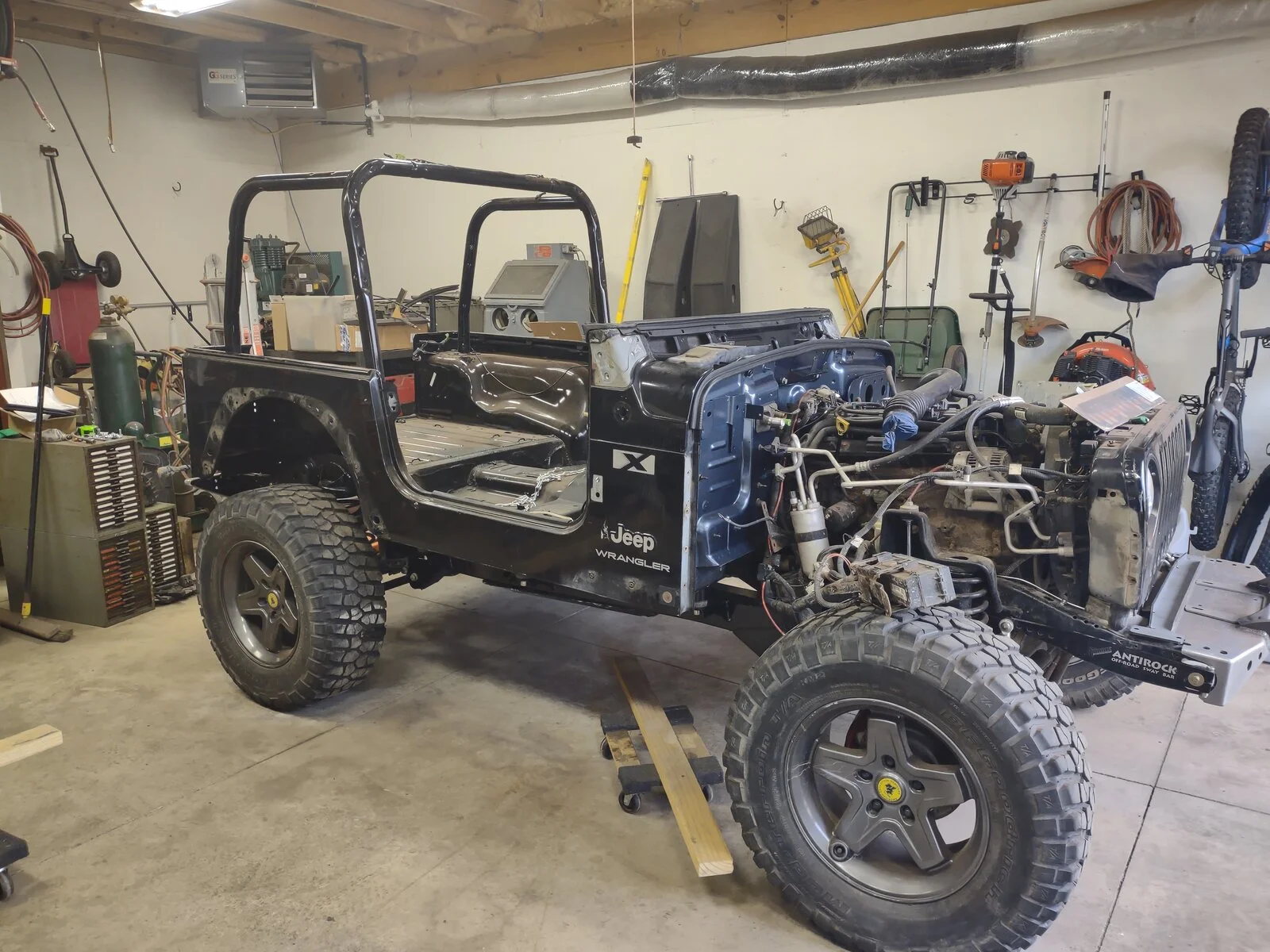

The tub has been mounted for the final time.... Until I need a new frame. Had a couple buddies over this morning to help out. It's on, all my bolt holes line up, and the squishy JKS body lift has been replaced with a firm Savvy body lift.
Now, it's nap time. Got my second Covid-19 vaccination shot last nite, and I'm feeling a bit whipped.

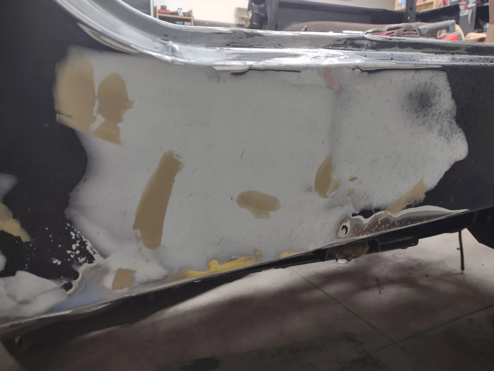

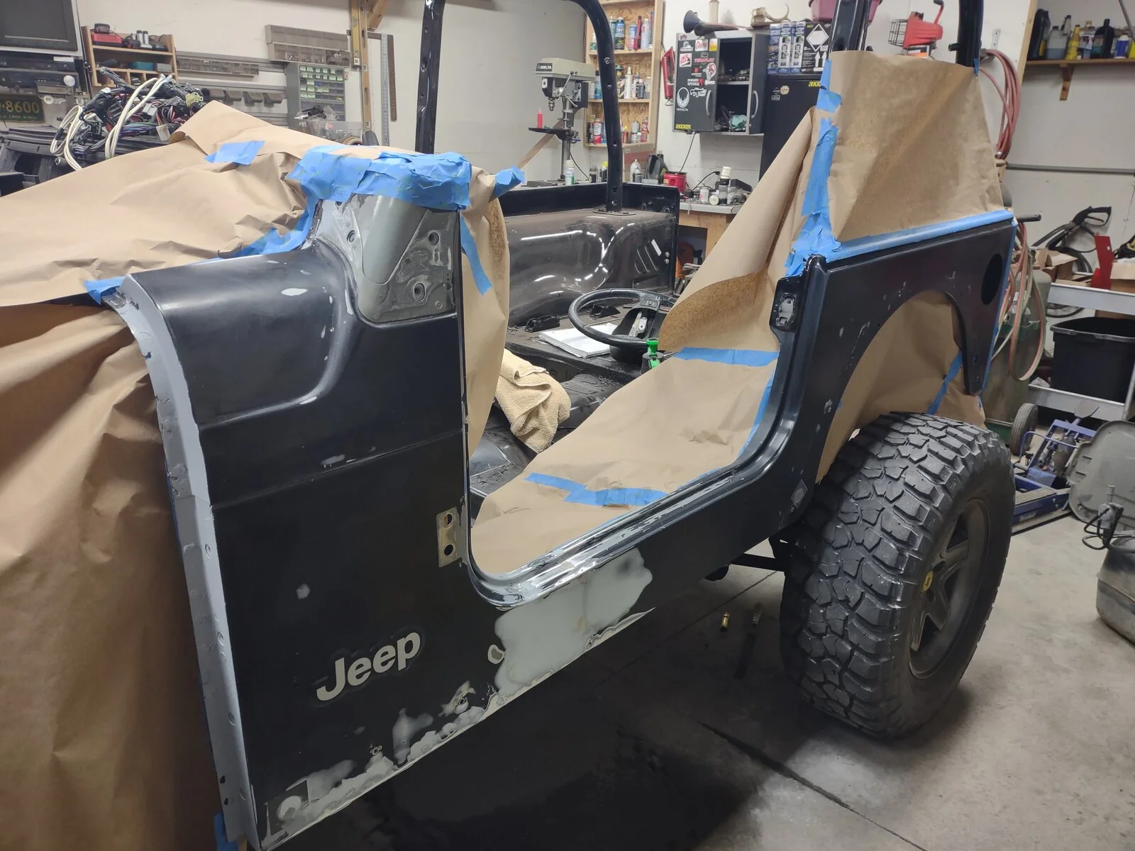

I installed the passenger fender tonight too. Starting to look like a Jeep again. I'm basically to the point where I have to paint the tub where I repaired it before I can go further. So, I worked on some prep for that. I slapped a couple layers of filler on. Ran out of sandpaper though, so tomorrow is all about body work (yuck).

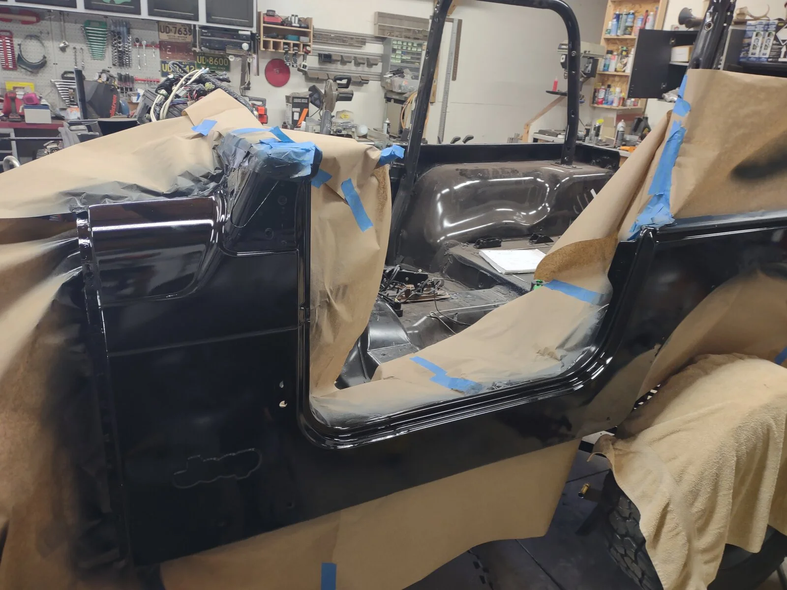

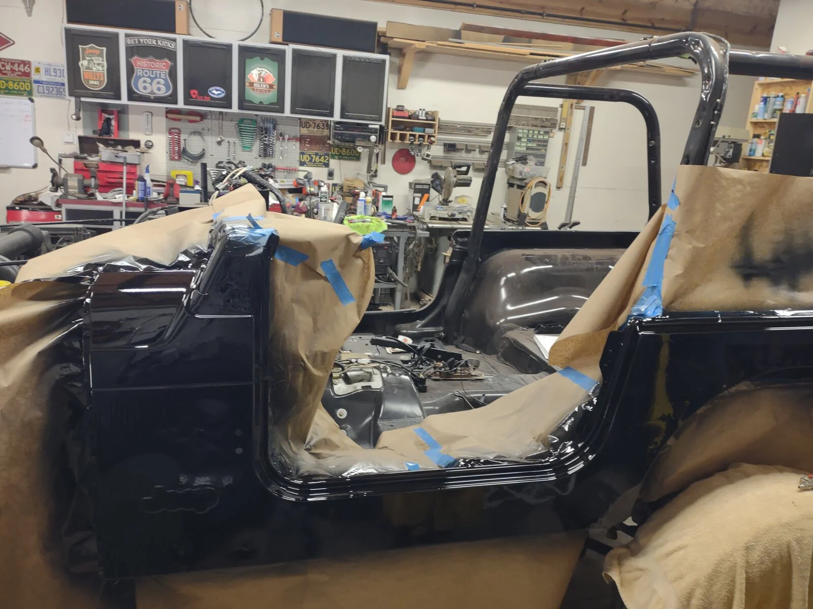

My tub is painted! I'll have to do some sanding, but overall, for what I'm trying to accomplish this go round, it's pretty good. First, some filler for the welded repair.
Color coat on
Then clear. Little history on me and clear coat. I have a hard time with it. Not sure why, but I always get orange peel. I've deduced that I don't put it on heavy enough. This time, I was bound and determined to put it on heavier.

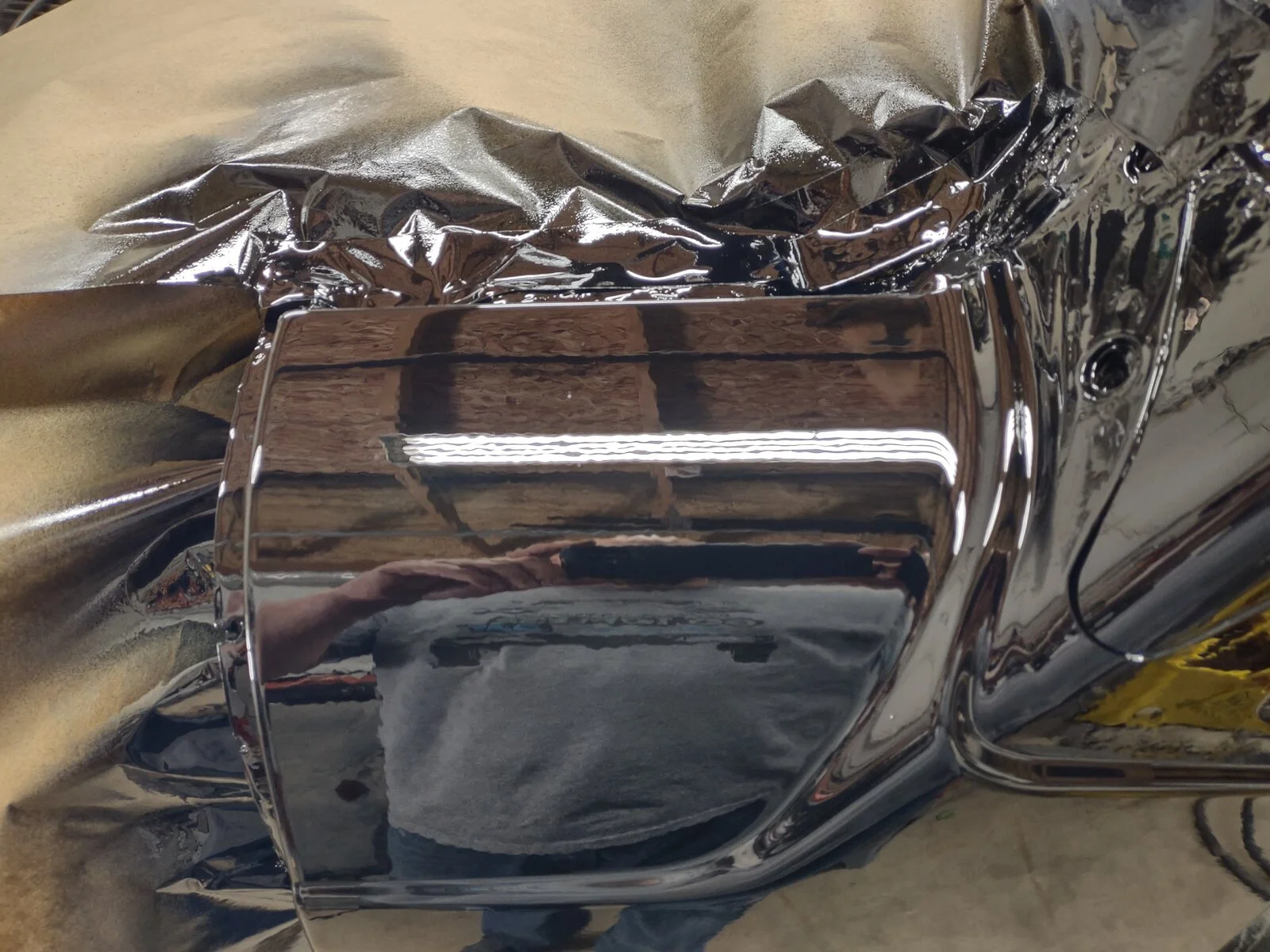

And I did. Most of the work looks great. Some is damn near perfect.

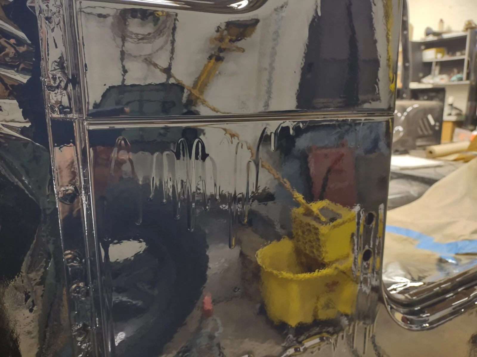

And then... There are areas to sand.
Oops. At least I can sand and polish it out. Maybe @bobthetj03 can give me a couple pointers. This is a temporary fix until I do a color change next year... Or sooner. Depends how busy I am this summer.
Holy water falls Batman! You'll need a razor blade and some patience for that panel, but doable.
Yeah, the razor blade thing scares me! I'm going to start with 800 and see how that goes. I watched a vid where a guy was scraping the high spots...I'm sure to have to re-clear it if I get a razor blade anywhere near this thing.
Assuming I do need to do it, how long should I let it sit before scraping? Its it better to work soft or wait a week for it to fully cure?
