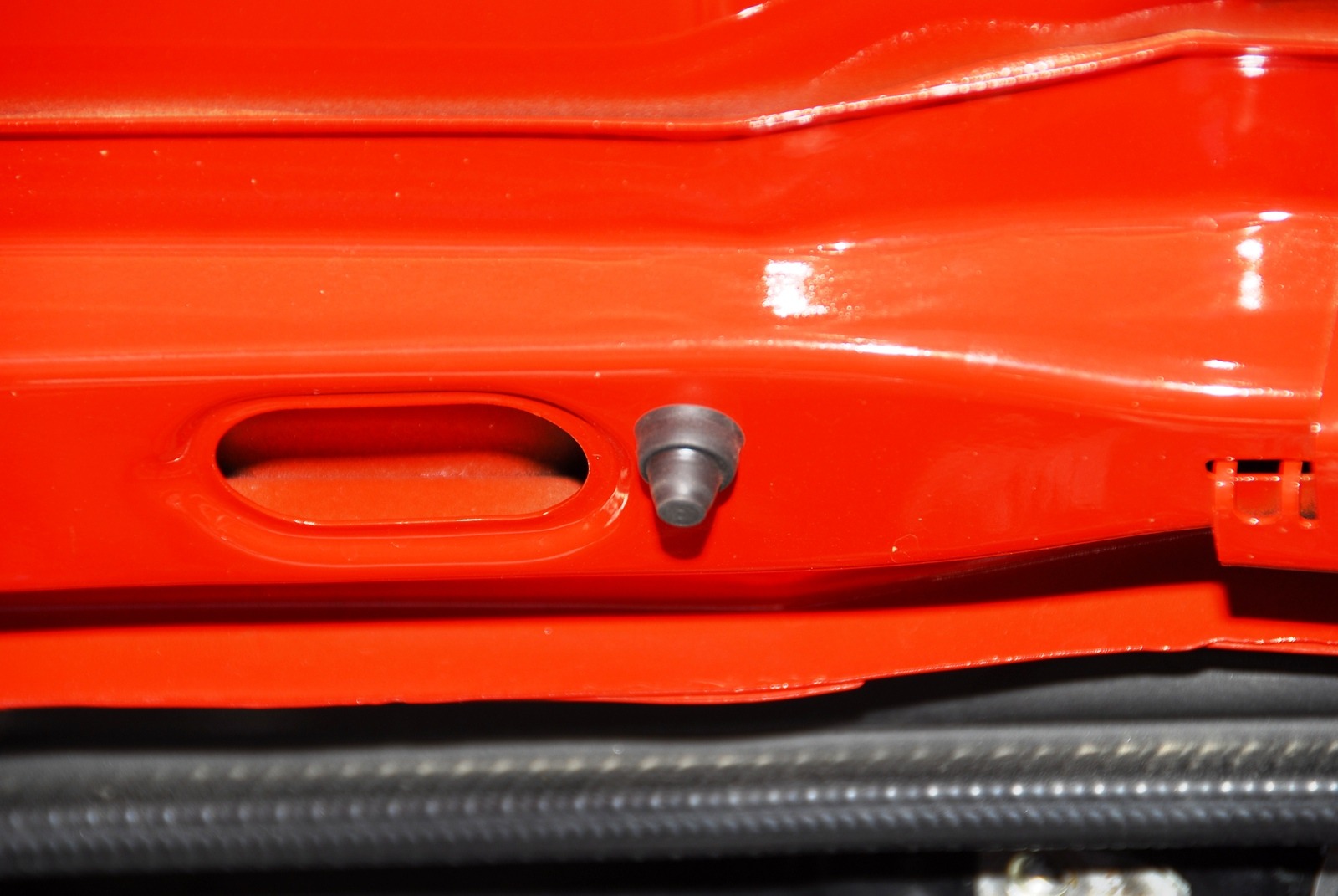

The switch you can see in the above pic is a waterproof K4 push on push off switch picking up power from the original underhood light harness.
Sorry to bring this one back up but what exactly actuates this switch? Can i assume that you have to push it to turn the light on? At first I thought it was a pin switch that turned the light on when the hood was up but then I realized that there really isn't anything that makes contact with that location.
Your finger.

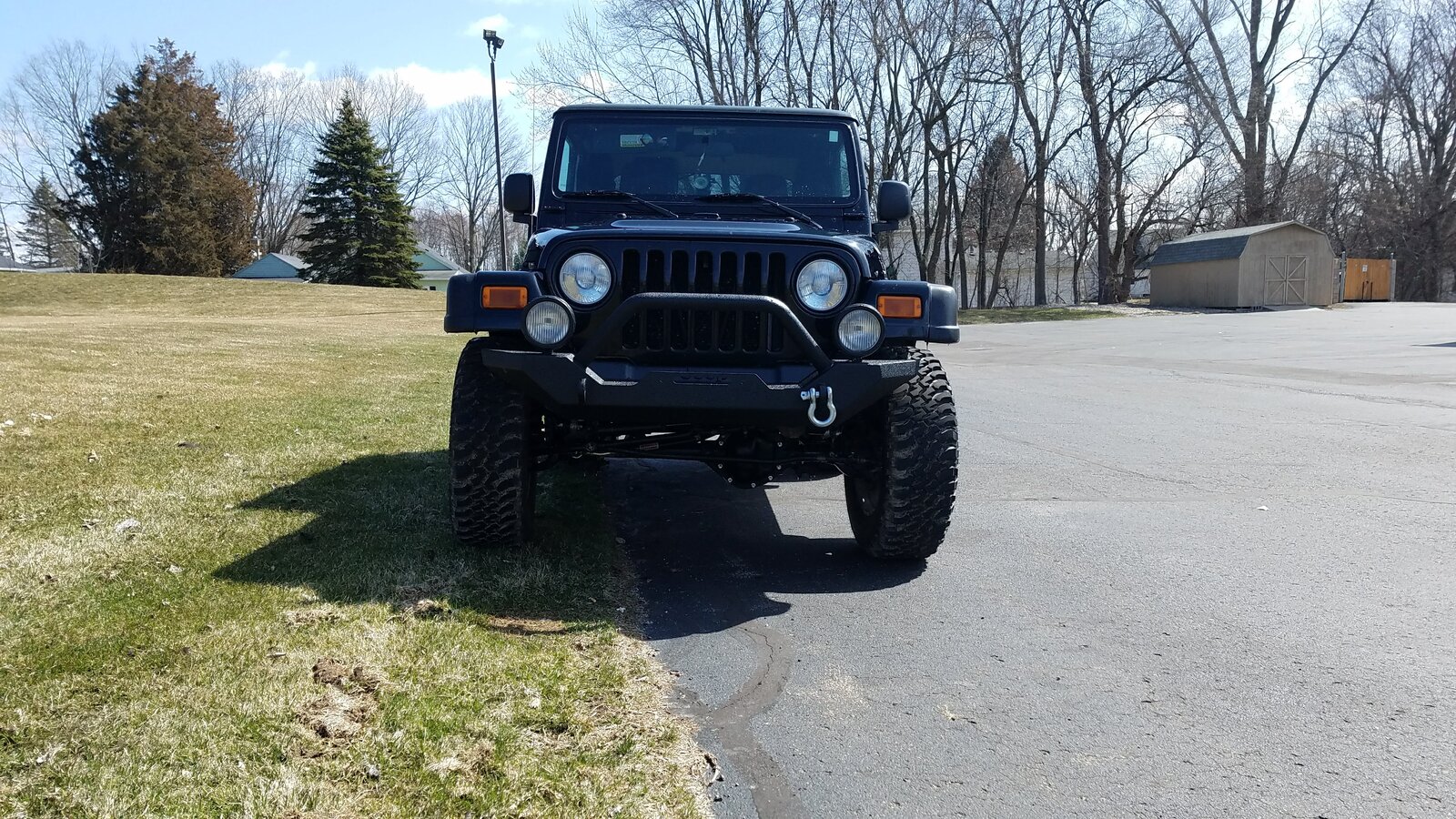

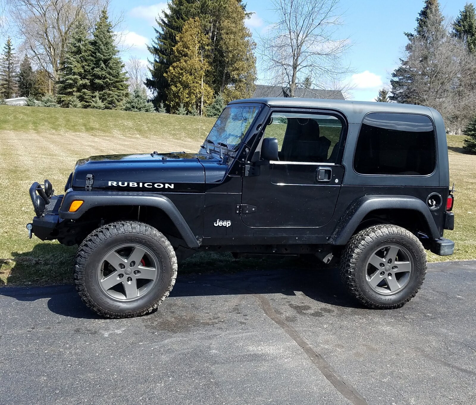

Love this build. Something I'm curious about though on the wheels. Somewhere near the beginning, the owner mentions that they are JK Moab wheels with 5.2" backspacing and that with a 1.25" spacer, it puts the effective backspacing right around 4". Upon doing a bit of research, I've found that the OEM JK Moab wheels are 17x7.5 with a 44.45mm offset which gives you exactly 6" of backspacing. Factor in the 1.25" spacer and the effective backspacing becomes 4.75".
Now Quadratec sells an aftermarket JK Moab that is 17x8.5 and has 5.2" of backspacing. @mrblaine seemed to indicate that these were OEM JK wheels. I like the look here and if clearance with a 315/70r17 isn't an issue, I may go down the same road.
The OEM JK moabs I ran were definitely 6" of backspacing... I changed em mostly because they were to close to the frame and tub.
If you want to use em, they are a good option... Just make sure you get 2" adapters.
