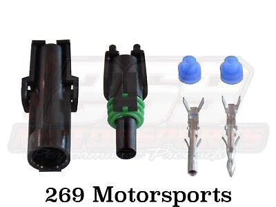

Personally, and it is just my preference, I'd run a 5th wire from a keyed circuit and just tape or ziptie it to the flat 4 and use a connector like the one below. That way you don't have to have your parking lights in for the brakes to work.
https://www.ebay.com/itm/1541120813...d=link&campid=5337789113&toolid=20001&mkevt=1

Yeah, I watched the video and he did mention just using the parking lights for power. A 5th wire would be preferable for me since it doesn’t require I turn them on. Safer. My wife may drive, or one of my kids, and they may not know or forget.
