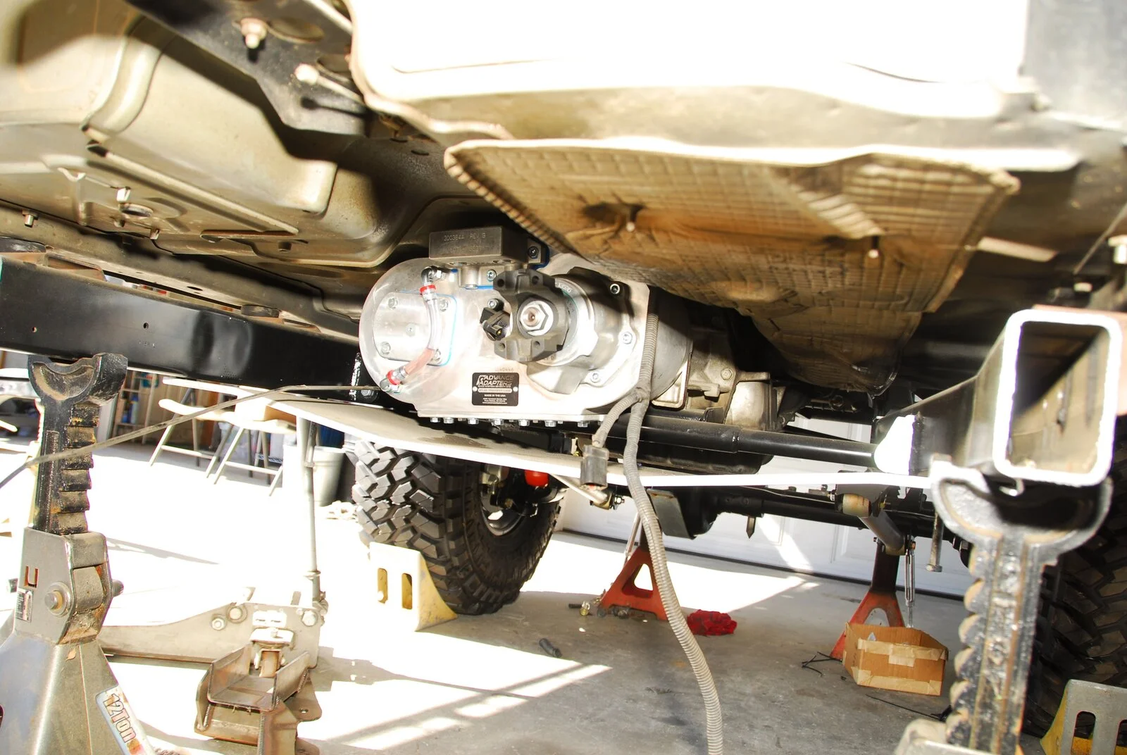

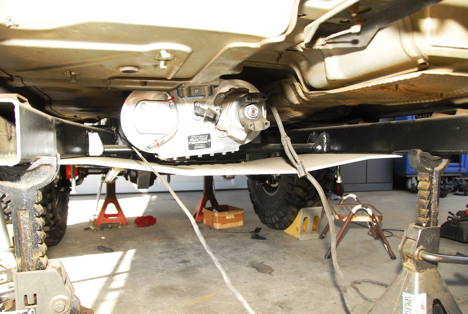

Do you design your own skid/cross member for atlas installs or do you just avoid them completely?
Going off-topic further but which transfer case are you putting in the J6?
It already had a 241 and since I have a spare, I'll leave it for now. This is how we do an Atlas install. We build a stiffener across the back to finish it off.
