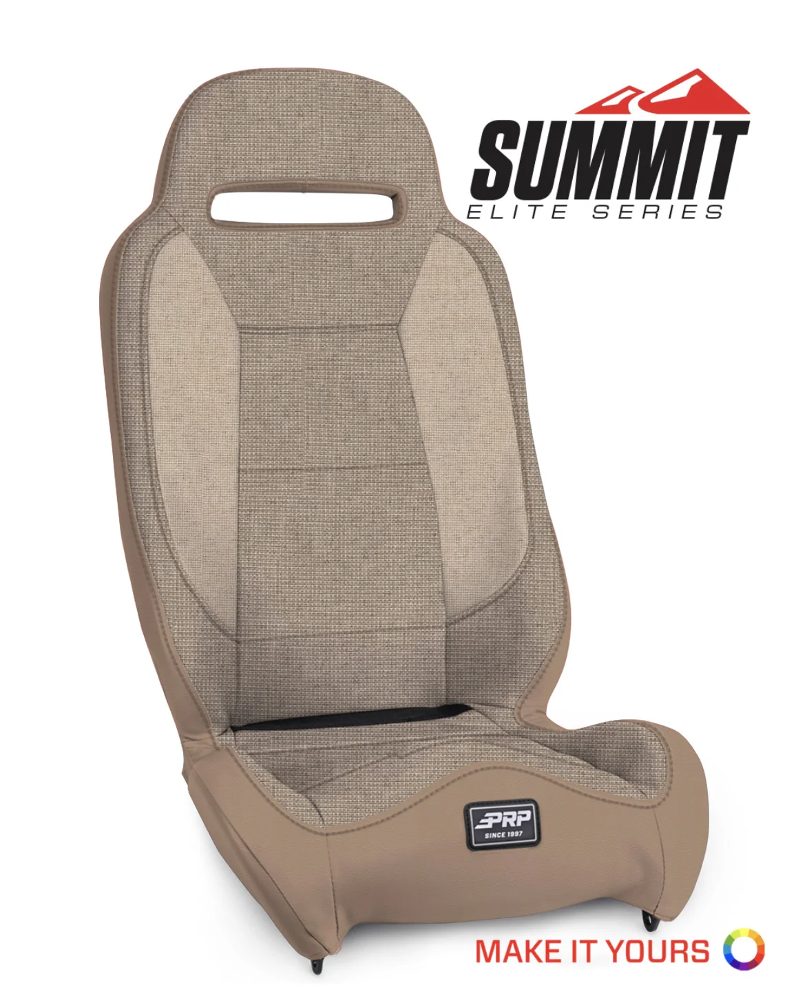

I realized I never posted photos of my PRP seats I ordered. Still waiting on them to be done, but here's what they'll look like:
I went with the Summit because I didn't see the need for a reclining seat. I never recline my factory seats, I'll have a harness bar behind me, and I don't daily drive it. The kids also climb in through the back window, so there's that too. I also wanted the extra support that the Summit provided over the Enduro.

Color matched bumpers would make those seats pop !
