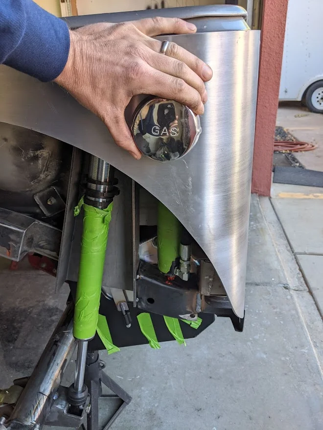

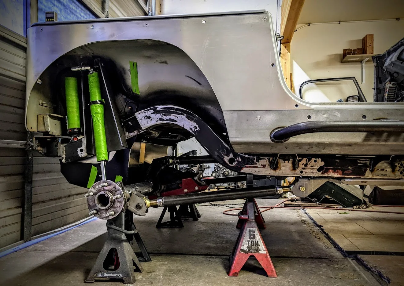

I'm thinking I'm going to be tucking the reservoirs behind the towers. Plenty of room passenger side, but a little cramped with the fuel filler driver side. I would go above the frame arch but I'm concerned the antirock, and air bump might get a little tight.

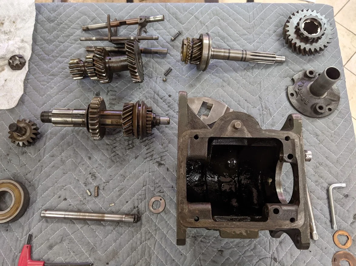

and the internals of a T84 transmission. (for the GPW)
Looking good. Don't want to guess so I'll ask, are you mounting the AR in front of the axle? If you are what length arms are you going to use? Planning to have the arm attach to the axle in front or behind the axle? Sorry just curious to see what others are doing.
That T-84 looks rather like a T-90 except mine was missing a FEW teeth on more than one gear.
Until I have the antirock in my hands, it's hard to say. But its my hope to mount the AR in front of the axle, with the attachment points also being on the front of the axle. I am unsure of the length of the arms yet.

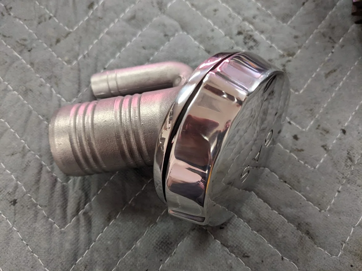

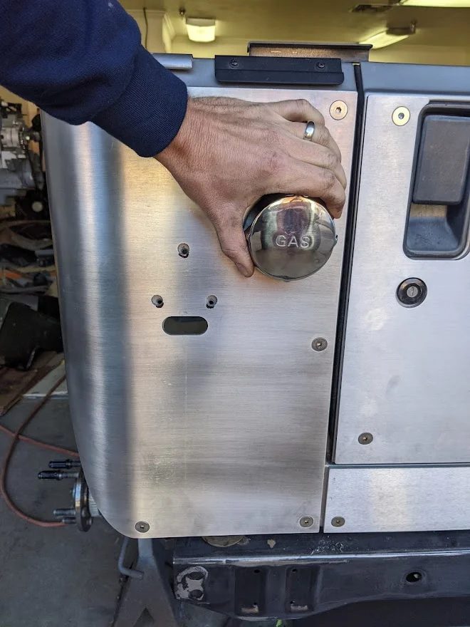

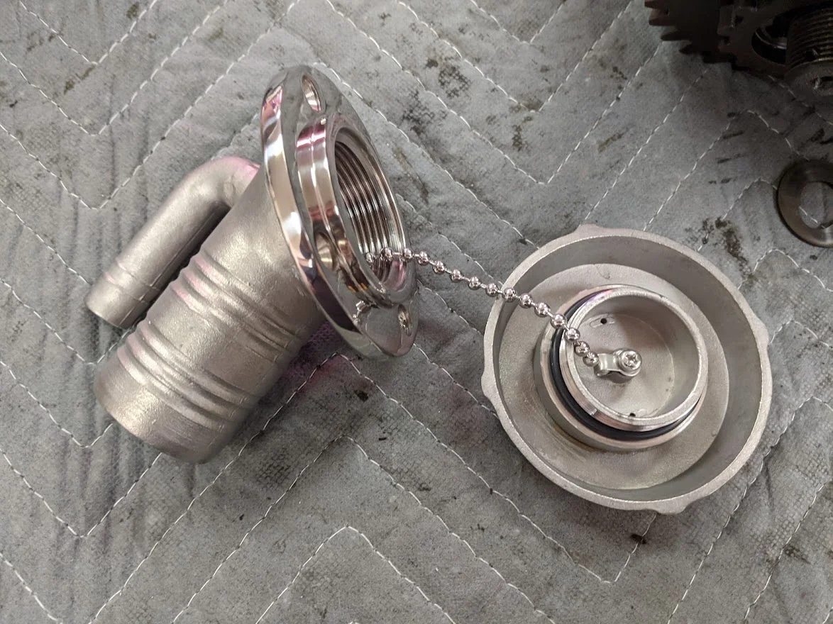

The filler neck showed up. Vented and angled like factory. I may blast it and paint it black.
Two options on mounting...

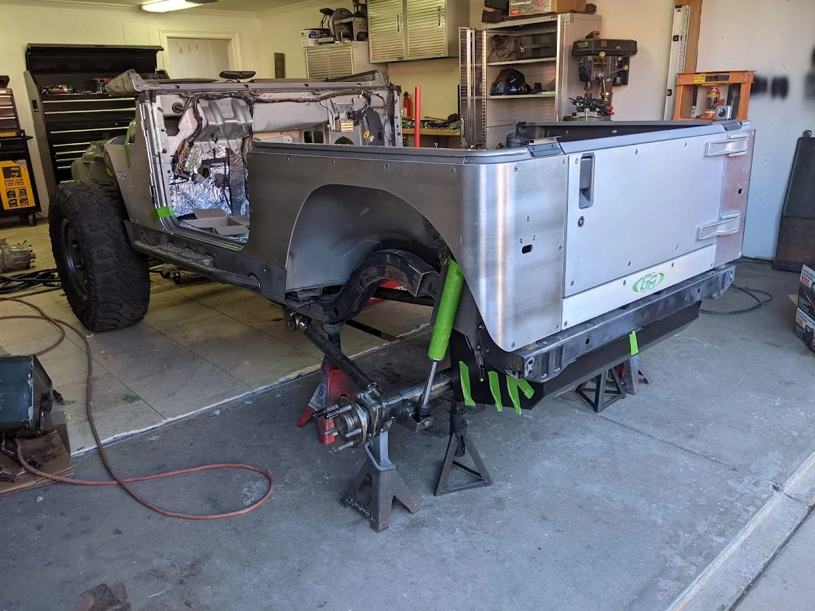

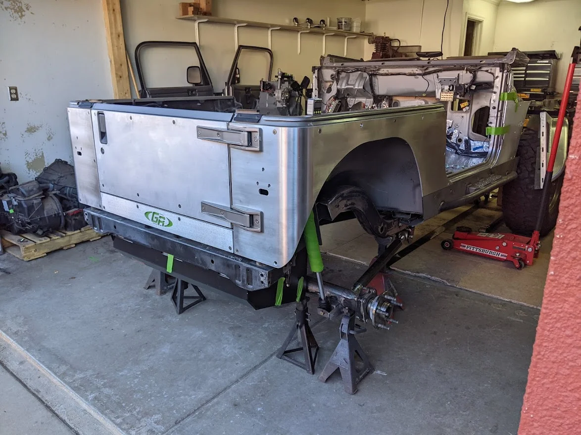

And a few pics of the rear armor. I spent a ton of time getting all of the gaps aligned and equal, but I'm loving the look.

I haven't tackled mine yet but as I'm sure you know there ain't anyway it can go behind the axle. I'd bought the bolt on version before I'd decided to cut my frame for the stretch. So I had the bent arms and needed the straight ones so ended up ordering their 17" arms. I'd clamped the stock brackets on with it in front of the axle and unless I shorten the arms the links will end up behind the axle.
I've seen it done both ways so that was why I was asking. Once I get my axle rebuilt I can get a tire mounted and flex it a ton and figure out what will work on mine.
Good luck with yours. And the gas cap looks good. Since I've had CJ's & a YJ before I kind of like it mounted in the rear.
I ordered the bolt-on too, but since my frame hasn't been modified before the arch, I think it will work, but mounted to the front side of the axle. I wanted the bent arms (in aluminum) so there will not be interference with the bump cans. I won't know for sure till its in my hands and I can mock it up

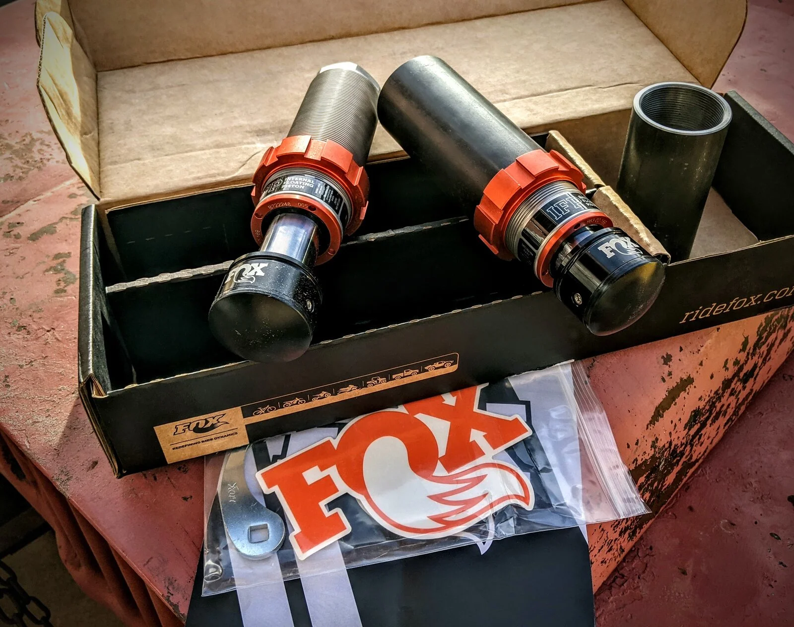

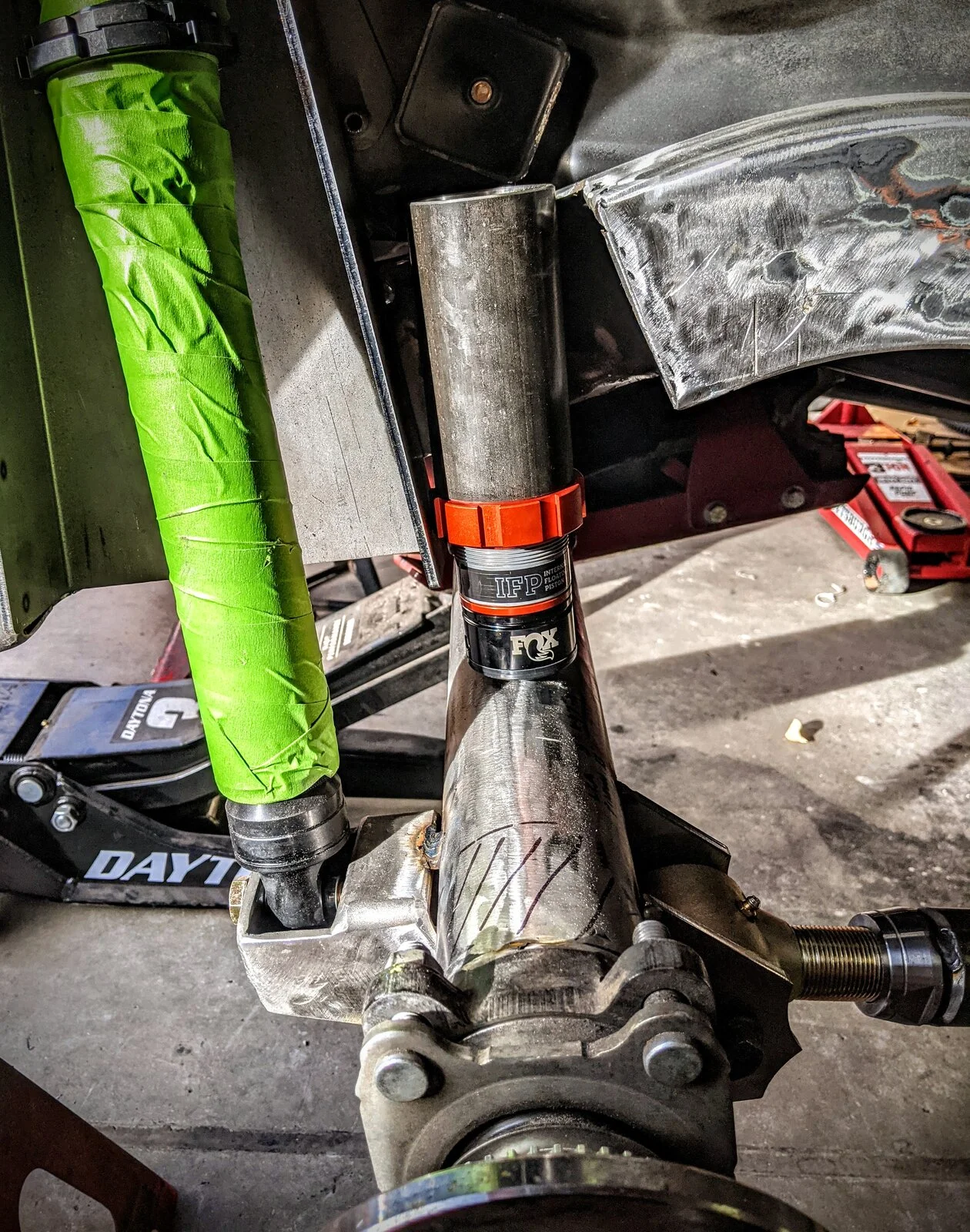

And these showed up today too.
Fox IFP 2" hydraulic bump stops.
This kit is actually intended for the rear of a gladiator, but I really liked the 2.5" threaded mounting sleeves that can be frenched into the frame. With the threaded section I can dial them into exactly the length I want. If they don't work I'll just install them on the Gladiator.

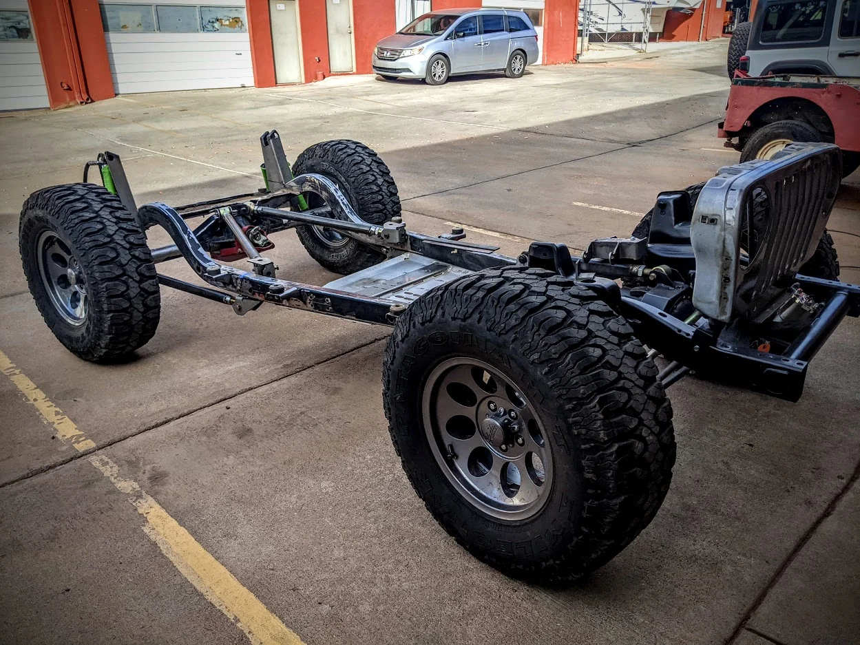

The body is off again.
It's time to cut the factory cross member out, finalize mounting points for the stretch tank, air bumps, and new cross member. I need to also plate and rebuild the rear of the frame where the original shock towers were.
