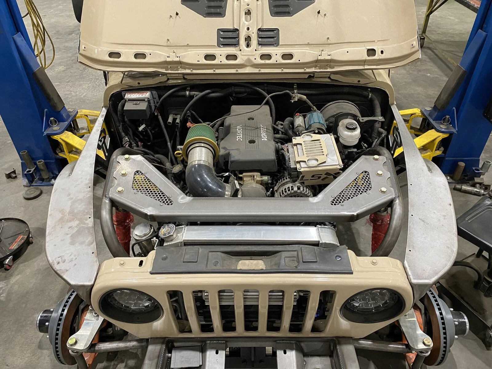

With all of the Black Friday sales going on, I am considering pulling the trigger on Motobilts Coilover hoops and cross brace. I'm just a little concerned about its size. It looks like it's pretty tight against the radiator, and the intake for the LS. Also, it looks like it locates the upper Coilover mounts which may or may not work for my stretch. Like everything, I'm sure I can modify it to make it work but not sure I want to spend that kinda money for some bling.
But yeah, it does look pretty fucking awesome
I chose not to get the motobilt stuff and ordered another set of poly towers instead. To many variables.

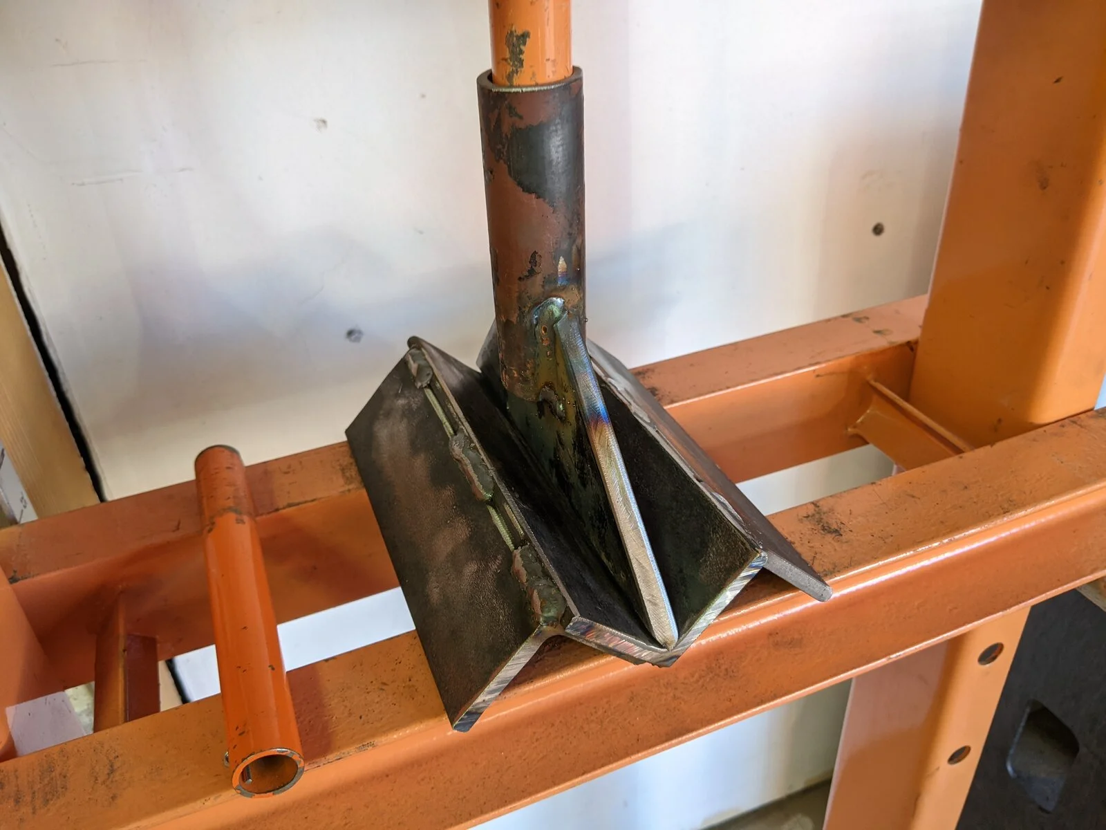

I made a small bender for the press.

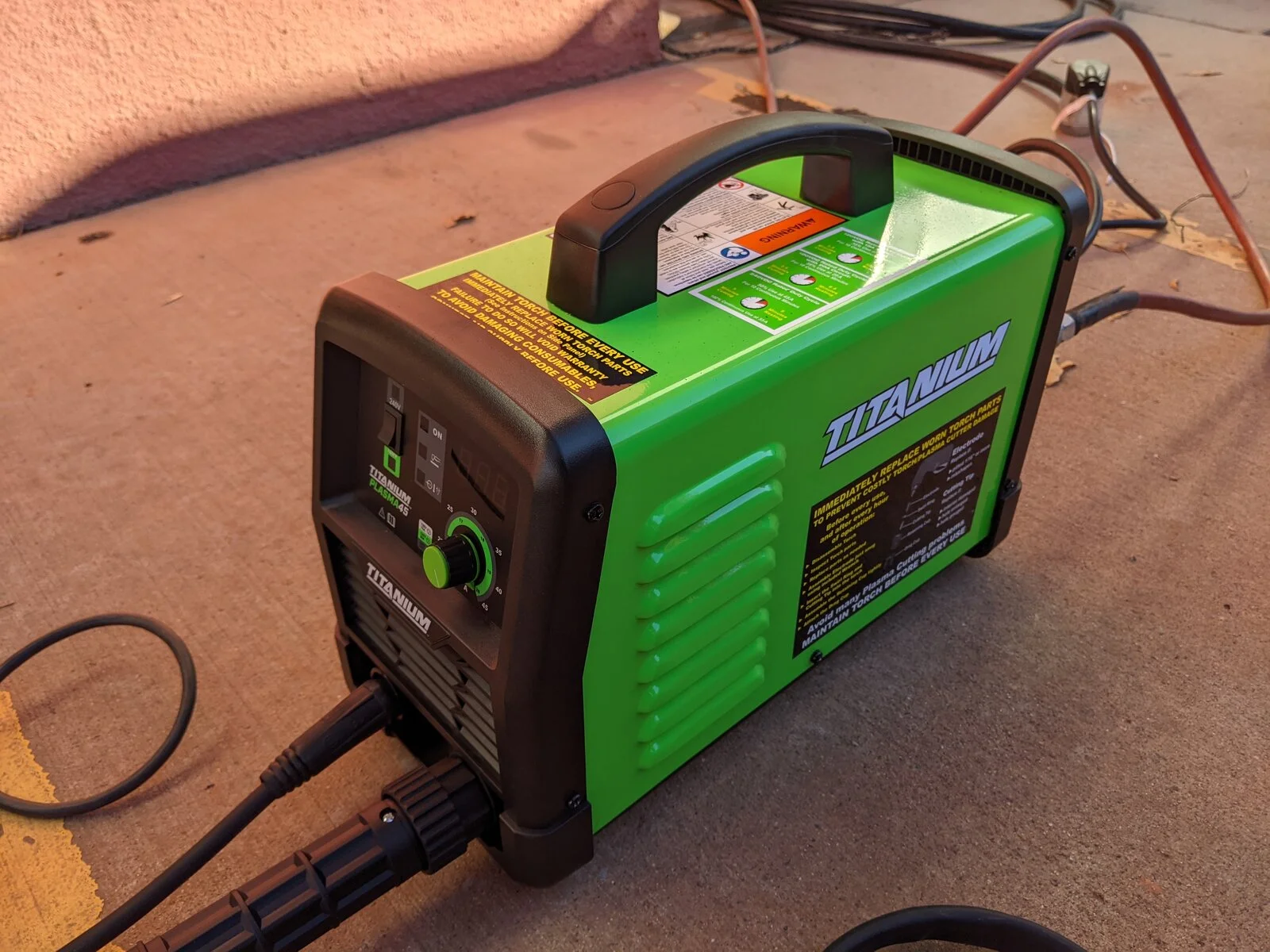

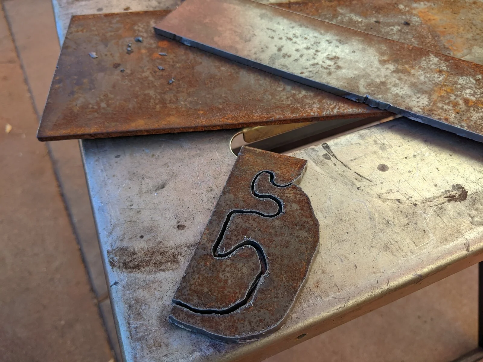

And picked up a plasma cutter. I've never used one before, so I watched a few u tube vids and got to cutting. This thing burned through 3/16" like styrofoam

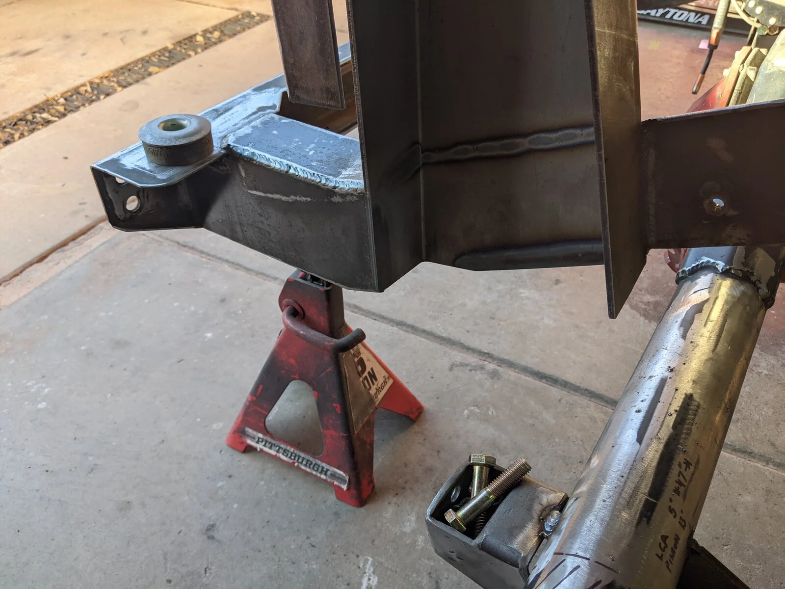

And then I fabricated up some plates for the rear frame section that had been raised
The rear is wrapping up to be about 7". I'm going to stretch the front as much as I can without going full hydro. Hopefully 3" or so
Weld the assembly to a flat plate as a base. Otherwise it will flatten out, and perhaps break, when you try to bend any thicker stock.
And welcome to the plasma club. Those things are a game changer in metal fab.

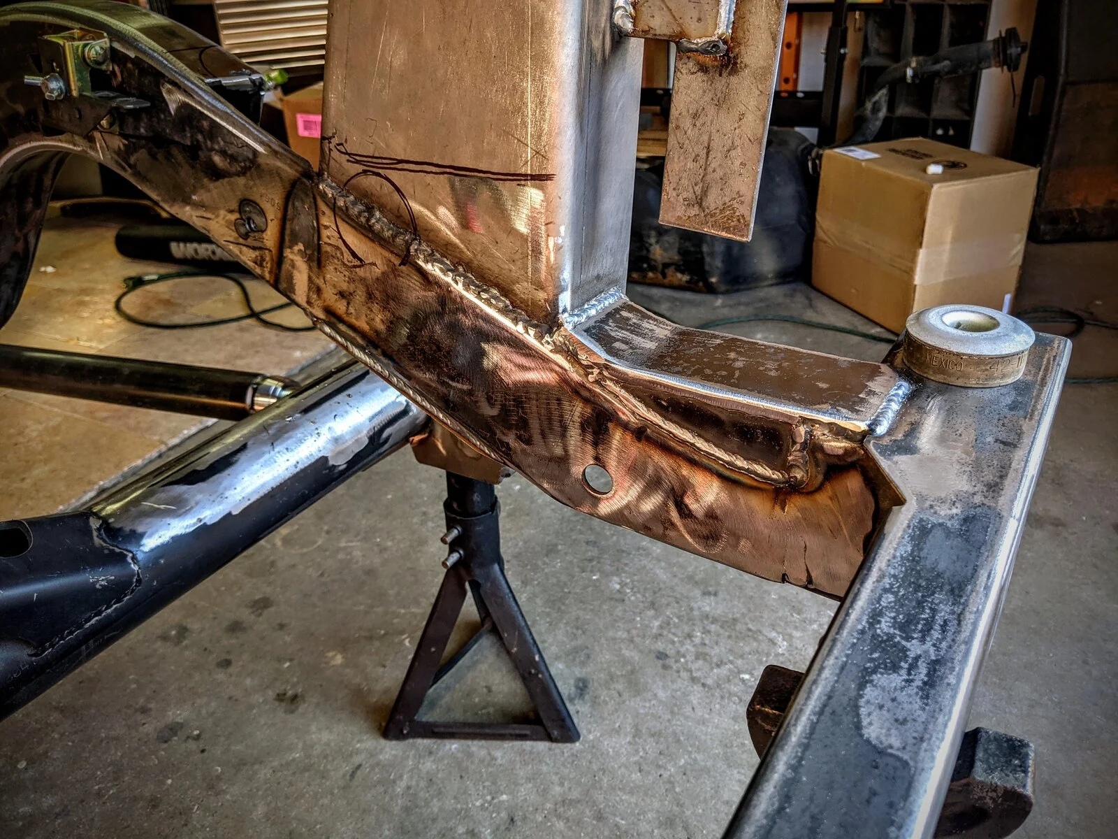

And burned it in...

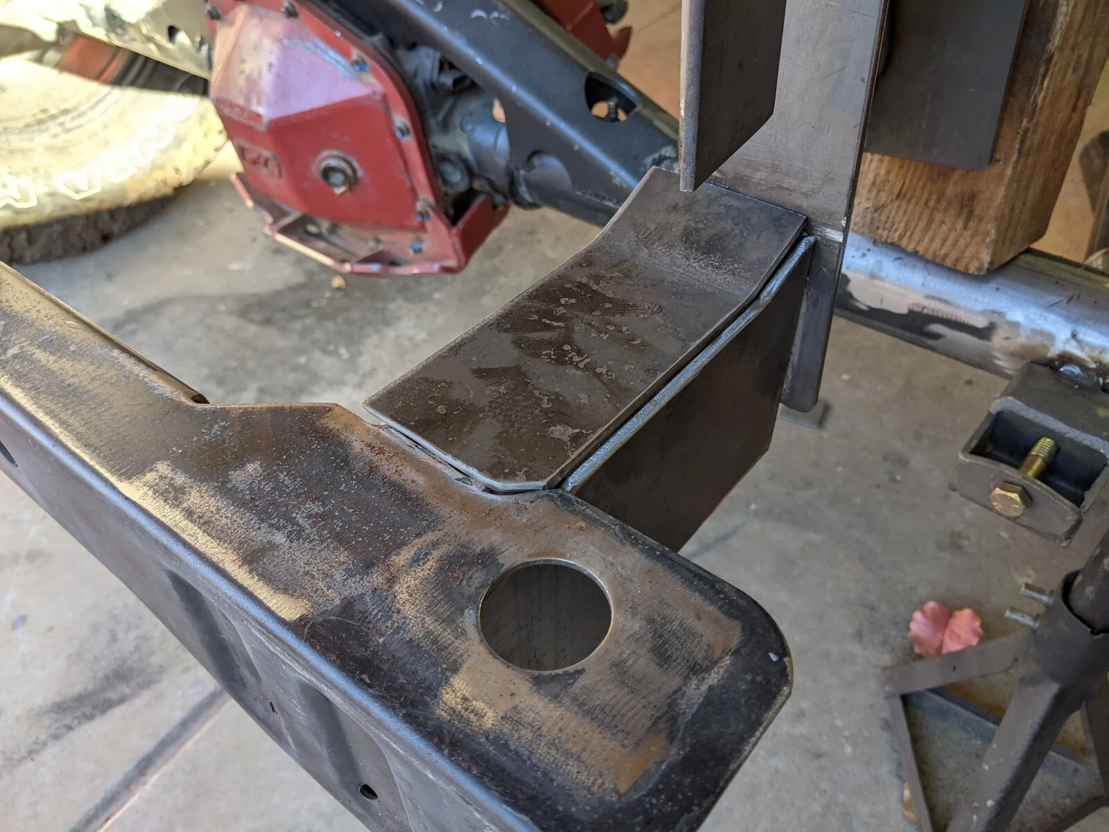

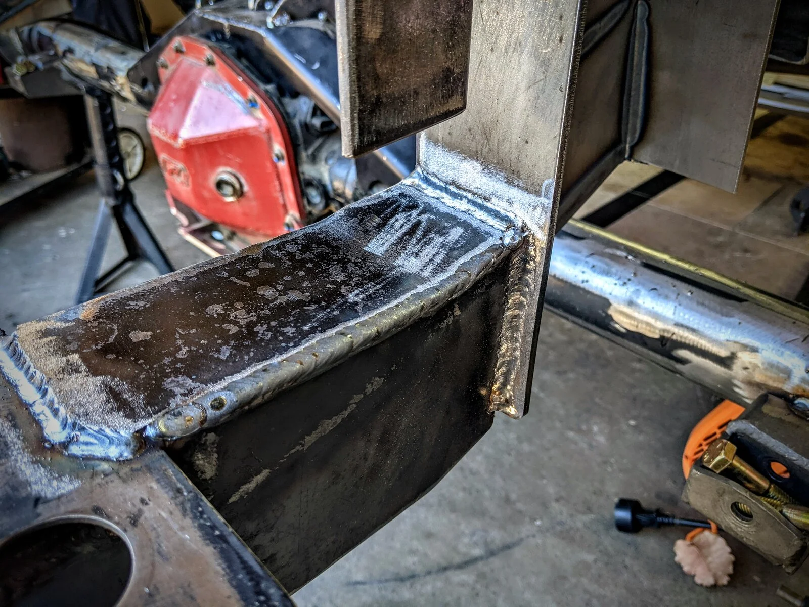

Inside. You can see the bullseye where the cross-member will go.
You can also see the little pie shaped discoloration from welding the plate to the existing frame bits, kinda link an internal brace. I sanded it so the heat marks are gone, but the mill scale is flaking off.
Duplicate the other side and the butt crack is gone forever. I kinda like the blocky-ness of the boxed frame

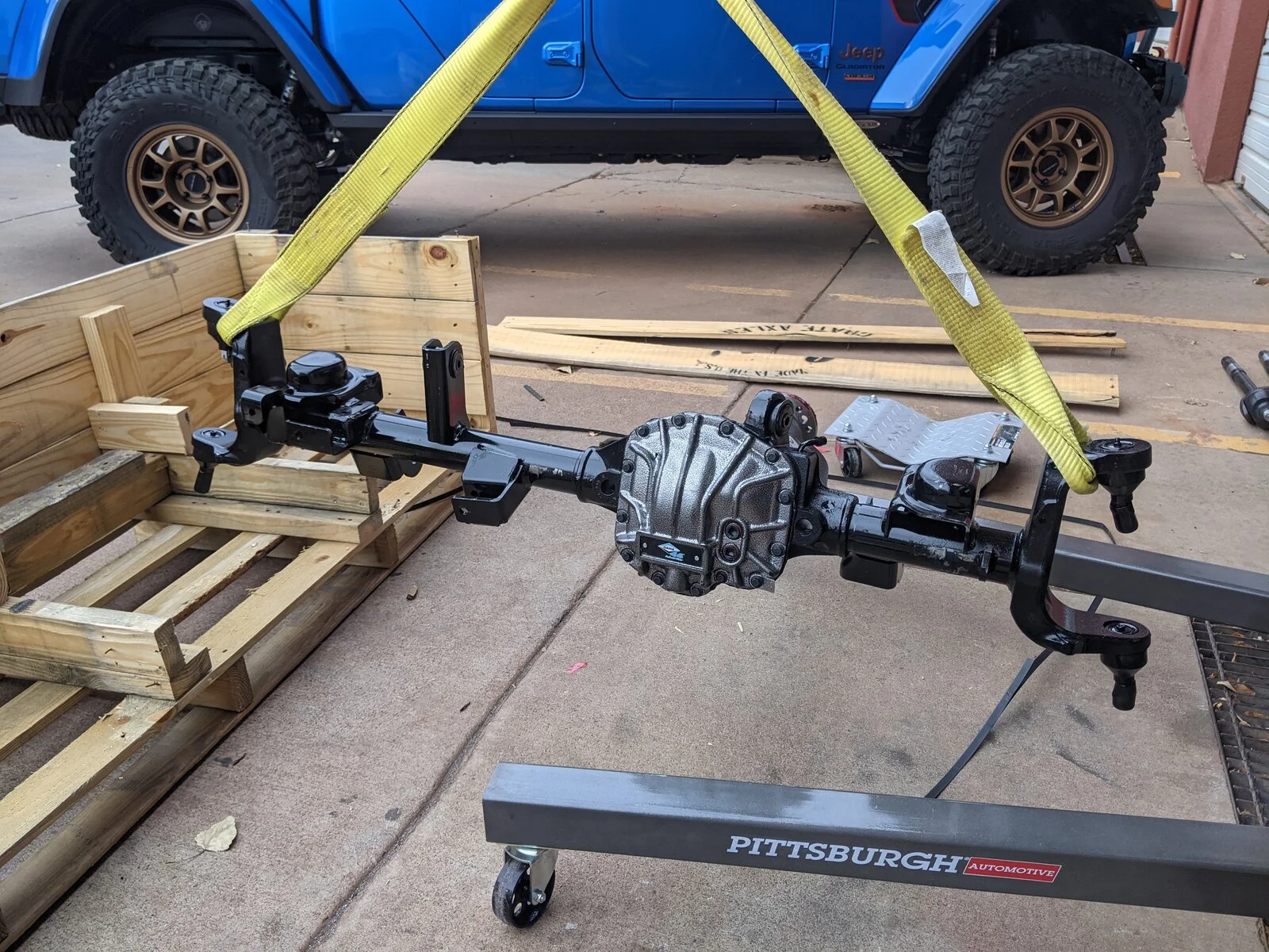

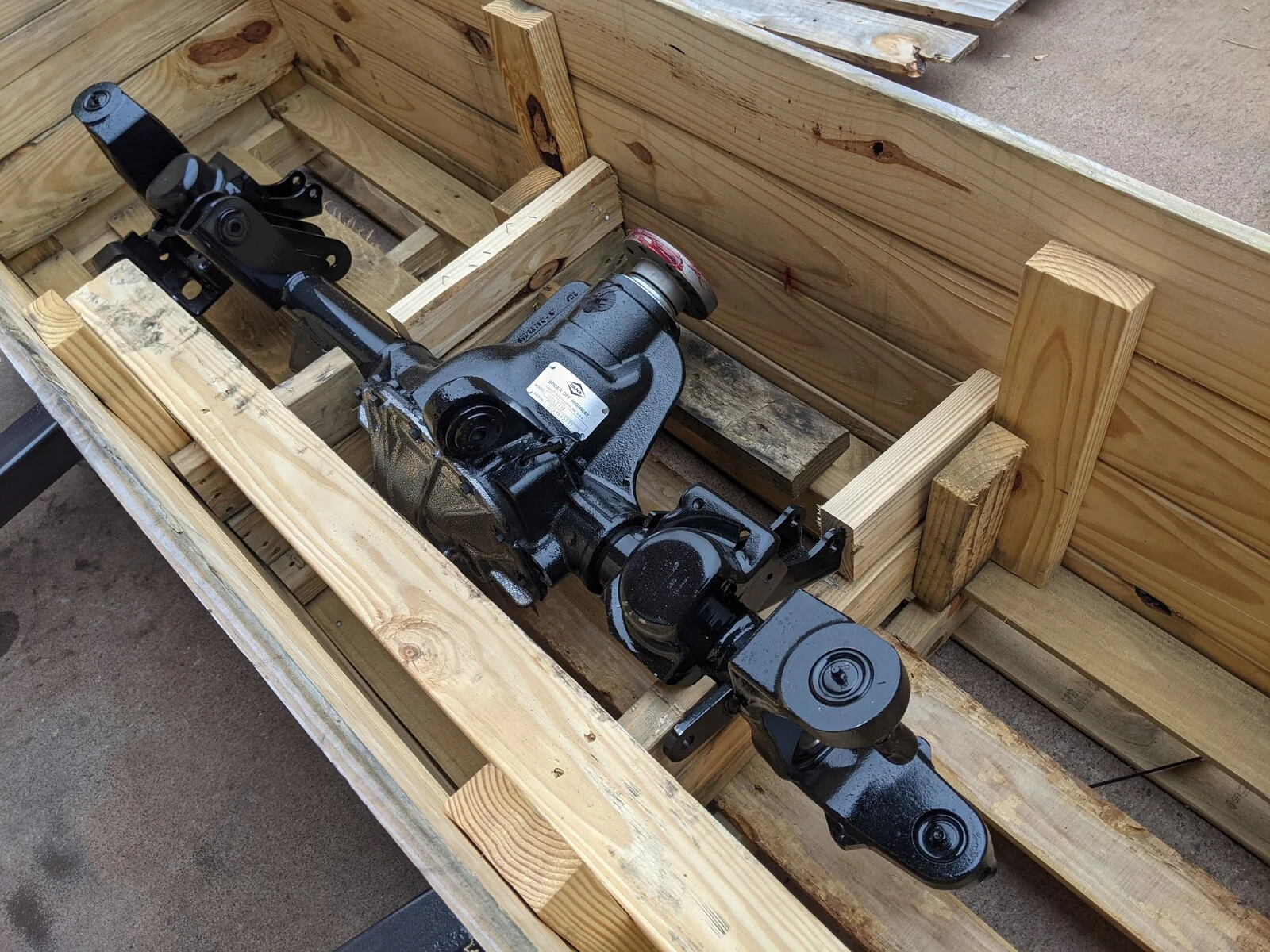

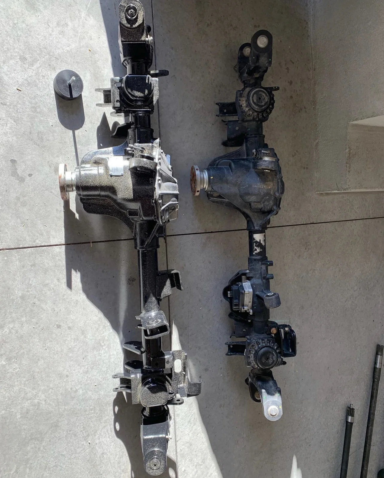

Are both of those housings the Dana 44 Advantek center, or is the one on the left a JK 44 center?
The one of the left is a Ultimate Dana 44 complete axle housing. It uses a Dana/Spicer Ultimate Dana 44 center section.
The one on the right is a factory JL Rubicon Dana 44 with FAD

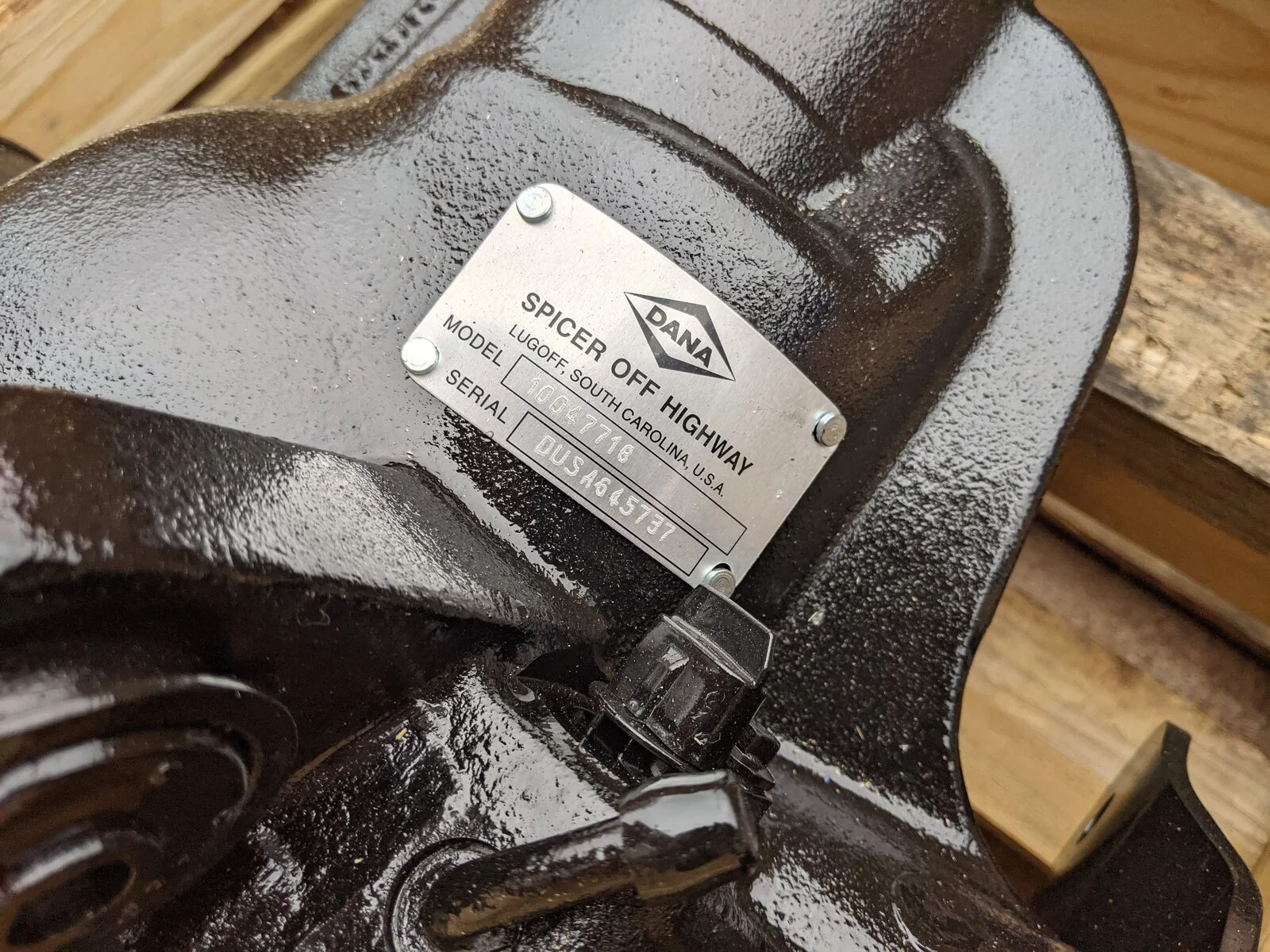

But is it the ultimate Dana 44 from the JK era, or the newer ultimate Dana 44 Advantek for the JK's?
Just curious since there looks to be a big difference in the casting for the center. When I picked up my JL 44 rear I was surprised by how thin the casting was in some places on the bottom. I looked for a while trying to find a place selling just a Dana 44 Advantek center section, but never found one. If it's possible to get just an Advantek center and have it be a beefier casting that would be Sweet
