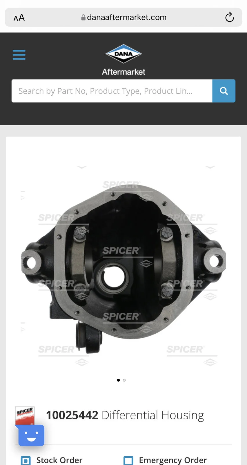

A quick search and I was able to find the factory JK 44 front center section.
https://www.danaaftermarket.com/spi...4&cat2=693&cp=0&catalog=PIMS_NA&partType=PART
I’m not sure they sell the centers for the UD44. Prob isnt a lot of folks asking for it.
But it def has a p/n, whether we could find that is another story.

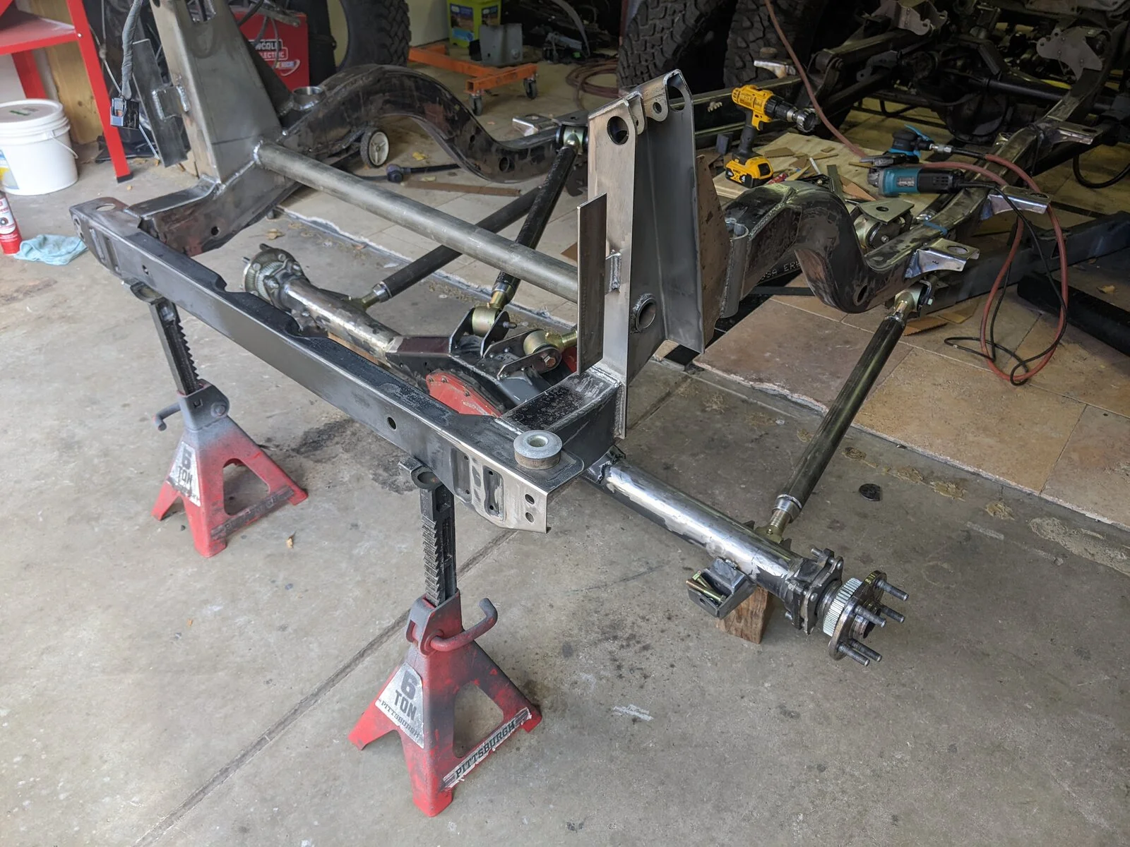

From all of the fab work to the rear corner wheel well cut, I am really enjoying this build. Everything is exceptionally clean and so well thought out. I'm looking forward to seeing more of it come together!
Thanks I'm having fun and I'm in no rush. I used cardboard aided drafting and scraped the design a few times until I settled on this

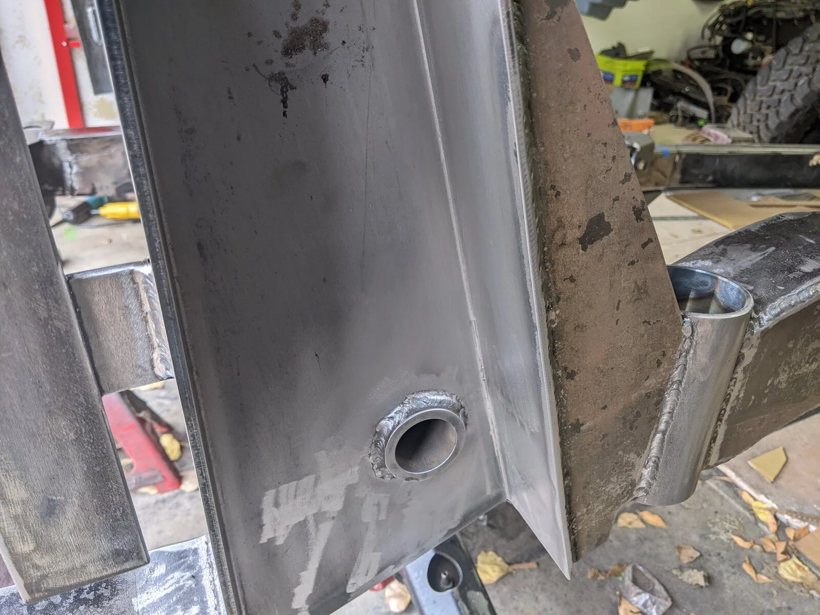

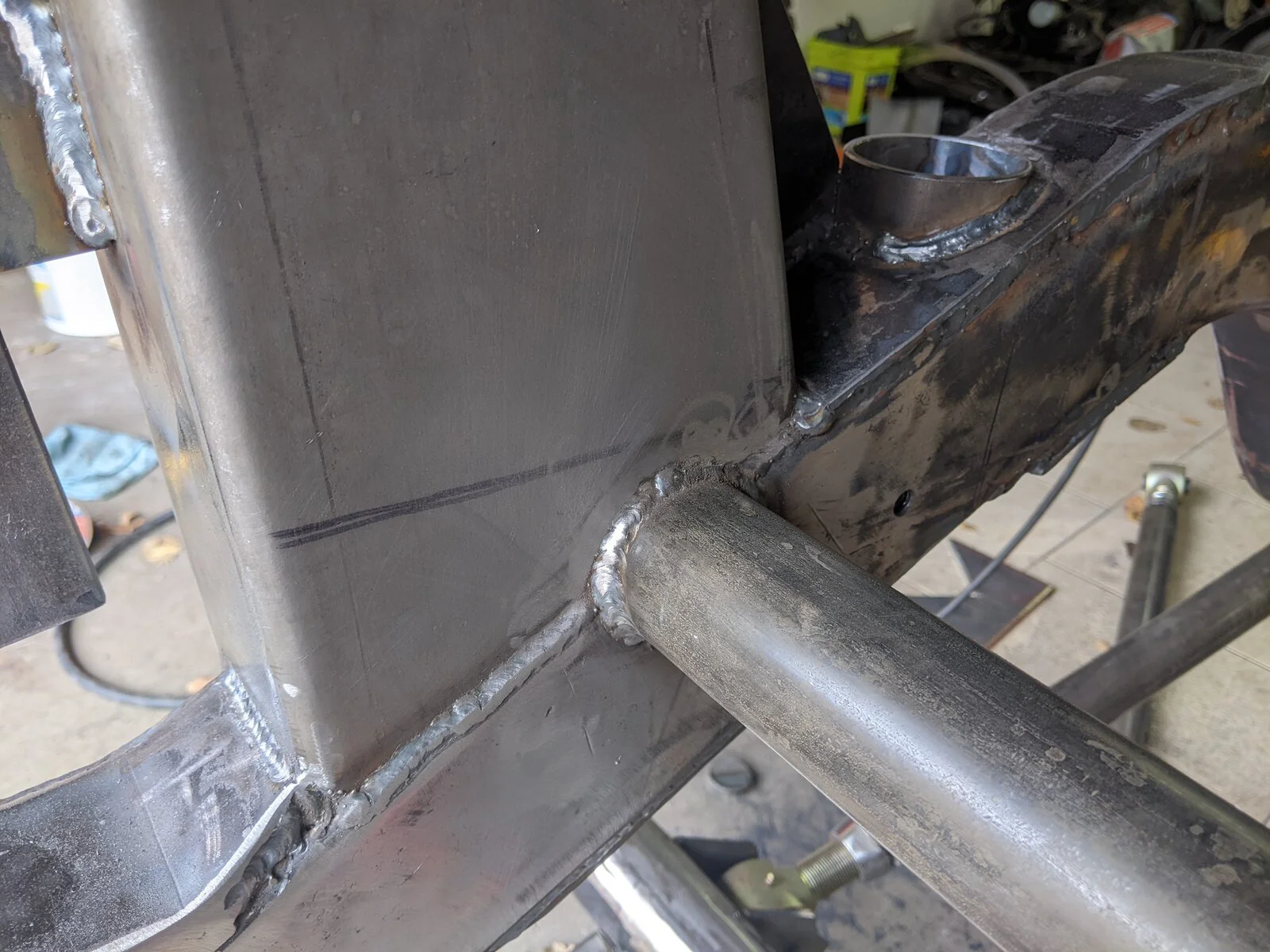

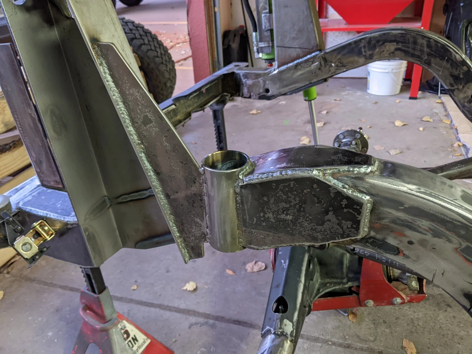

I used the holiday and the weather to get some work done on Punk'nStein. Since the factory cargo area cross-member had been removed, I need to replace it with something. I'm using 0.25 wall 2" DOM tube. So I drilled a hole through the frame where it intersects the shock towers on each side, ran the tube across and welded it from both sides.

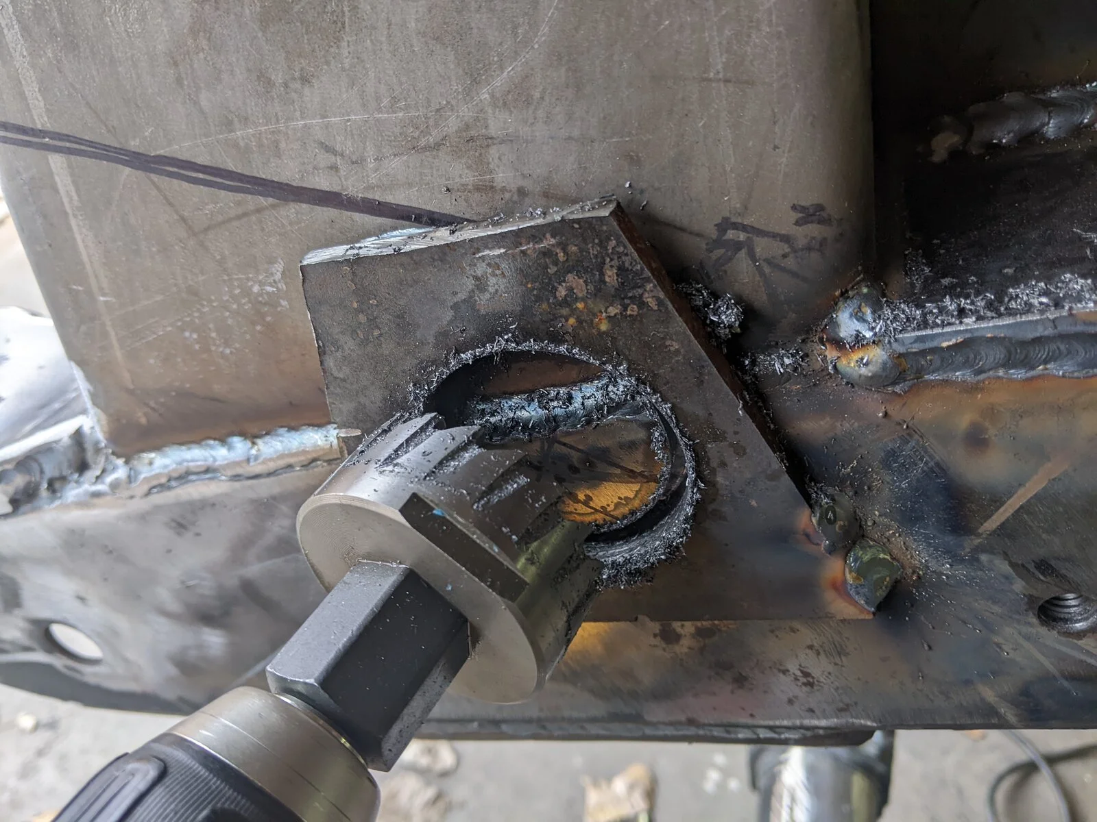

There is a small space between the gas tank and tub that the new cross member fits in nicely. But of course the weld is in the way, so instead of risking the pilot bit walking off and putting the hole on the wrong spot, I drilled a 2" hole through some scrap, welded that scrap to the frame to act as a guide. I love roto broach bits. The big ones work just as good as the little ones.
The fit of the tube is so tight I had to hammer it through, then I welded the outside
And the inside...
I've seen this trick used many times by OEM and It's probably over kill, but I know this cross member isn't going to fail. I'll add some gussets to regain shearing resistance, but that's probably overkill too.
My new cross member
Nice fab work, Dude. Good approach on using the guide for the rotobroach.
