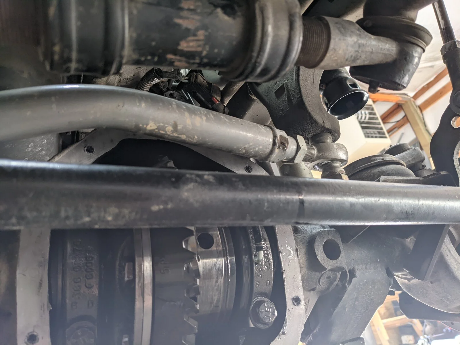

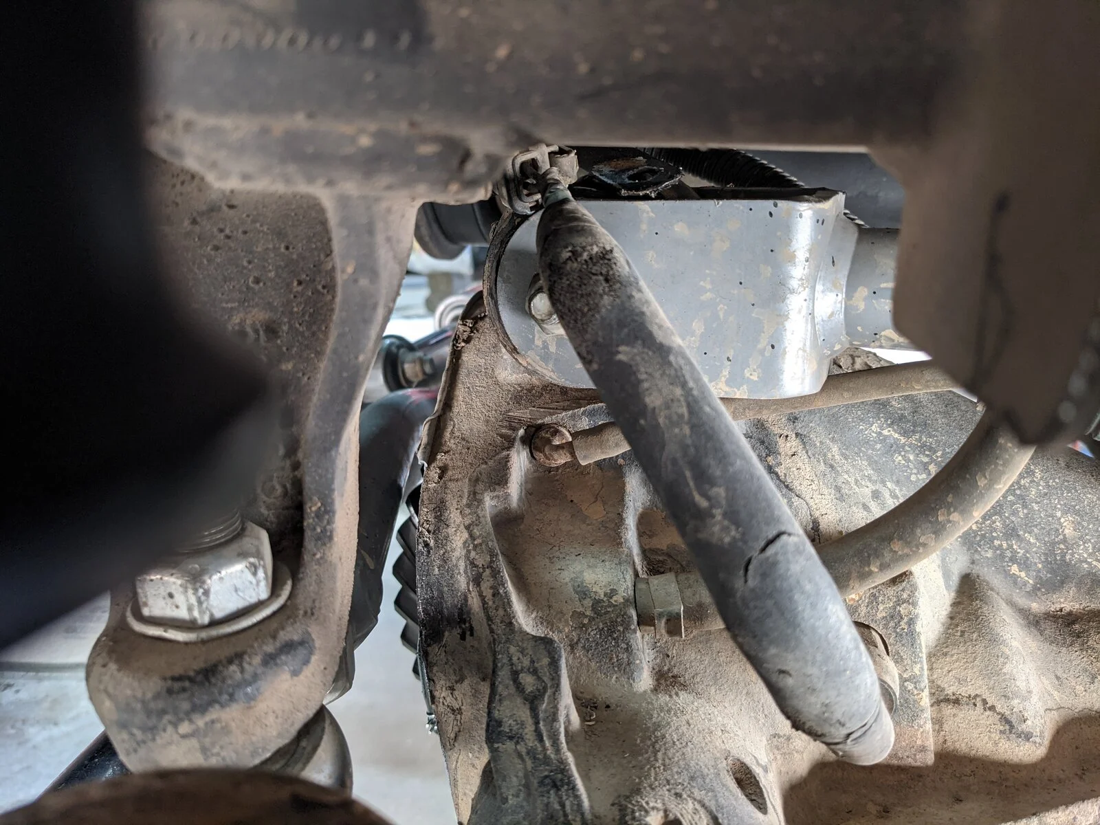

Whelp, time for a new trackbar. OEM cover doesn't clear the current TB. Assuming it's RE TB.
Hitting the OEM diff cover, not the housing. Took the pic with the cover off.
Were the shocks installed?
If not, and the diff cover interference occurs above where the shocks reach full compression, then the diff cover doesn't matter.
Nearly hitting the ring gear with cover off. Hope the RJ TB will alleviate this.
Shocks in place and driver side has 1.5 - 2" left to full stuff.

As for the trackbar hitting the diff, the rockjock trackbar has more bend than the rubicon express one. We just replaced a rubicon express trackbar with a rockjock on my dads rig and it helped clear the diff

Ballpark how much clearance you gained or how much bend I the RJ TB? Not sure how much I need.
Will my current mount work?
The mount is fine. RJ will get you the most usable clearance in a bolt on application. If the cover is still a problem, then the axle needs to be adjusted.

Yeah the rockjock will work and if it doesn’t then pull the axle back a little
Reactions: notnsuv
Yup. Fingers crossed.
