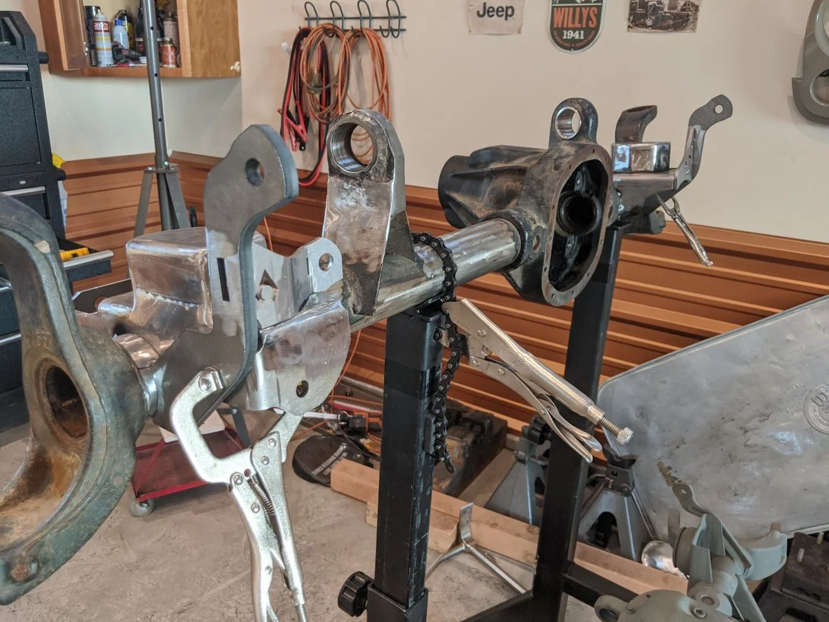

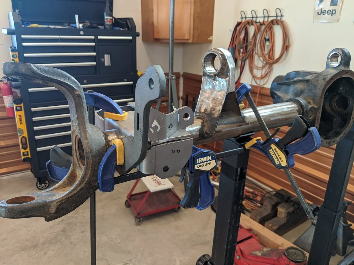

My buddy sent me this, just a mockup
The plan is to burn everything on next weekend, then take it to the stripper/media blaster that same week. One step closer to the hpd30. The 5.13 regear should be complete by end of January I'm hoping

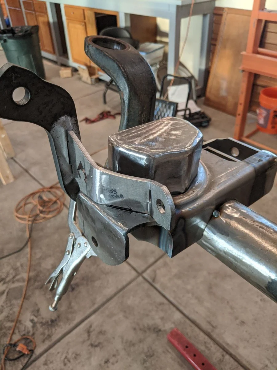

More axle shots🤘
Perches are currently tacked in place but will be burned in tonight. Control arm mounts next. We debated placement on the arms for awhile, but aside from cutting and moving the inner C we decided against it and the work wasn't worth the payout. Should be wrapped up by Saturday and off to media blast next week if no hiccups occur😃

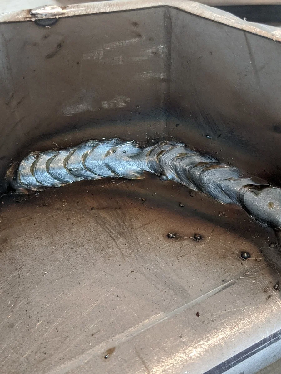

take the flat end of a hardened file to that spatter, it'll chip it right away
Everything attached to the spring pad is 3/16" thick. The control arm mounts are 1/4" thick. I'll have to modify the antirock links but thatll be easy. We'll definitely get it all cleaned up before the blasting.

those sway link brackets aren't 1/4"? they look think.
and i have no doubt you'll clean it up, just meant to offer a tip.
a hard file works better than any chisel or chipping hammer.

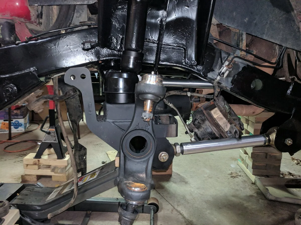

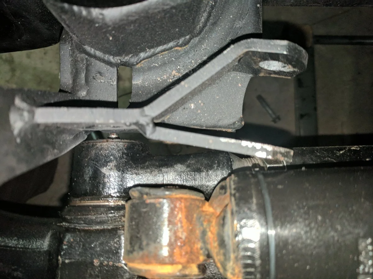

The axle was from ECGS. I did not do the fab on it. Iirc the tube diameter was slightly larger than TJ so that may have caused more offset since ECGS didn't understand that they had to account for the offset. It's part of my old build thread: https://www.jeepforum.com/forum/f22/red-lj-2485961/index5.html#post39860025

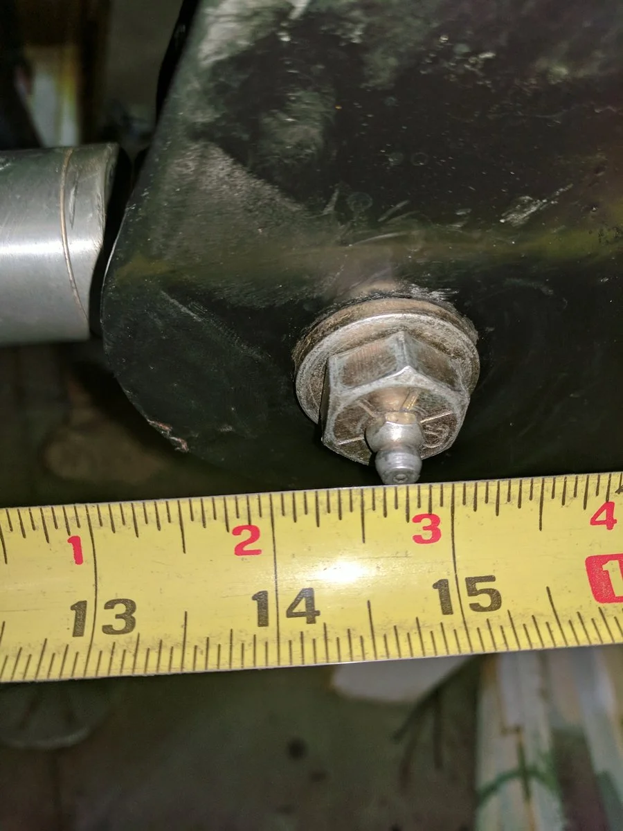

The antisway bar mount made contact wit the frame at full flex.

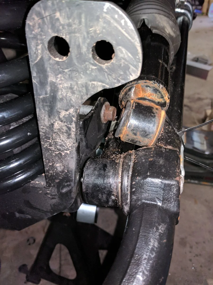

Here I shaved the driver's side antisway bar mount to clear the steering linkage:

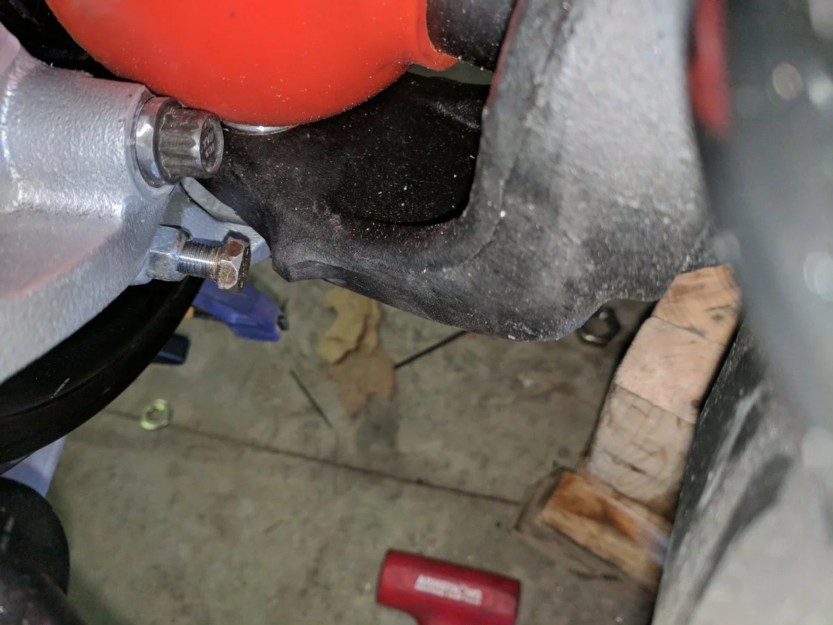

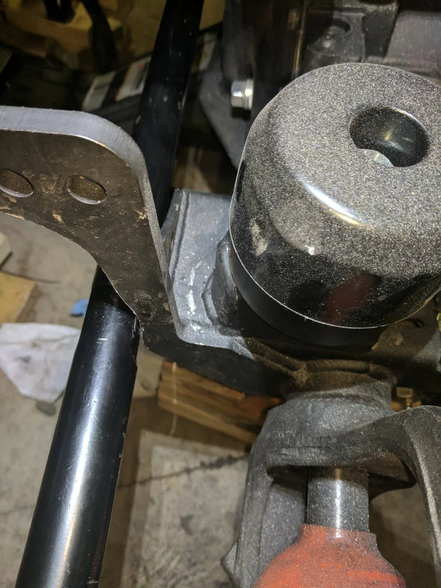

Unfortunately that only allowed the other side to hit:
The stabilizer is tied out of the way for simplicity.
Here's how much steering stop would have to be added for things to not touch (what I have there plus another 1/4"):
This much had to be shaved away to get to that point:

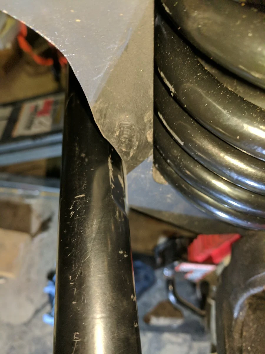

The control arms are now the length of unicorn arms because arms that short don't exist:
Basically all kinds of wrong had to happen to even get it to sorta kinda fit.
