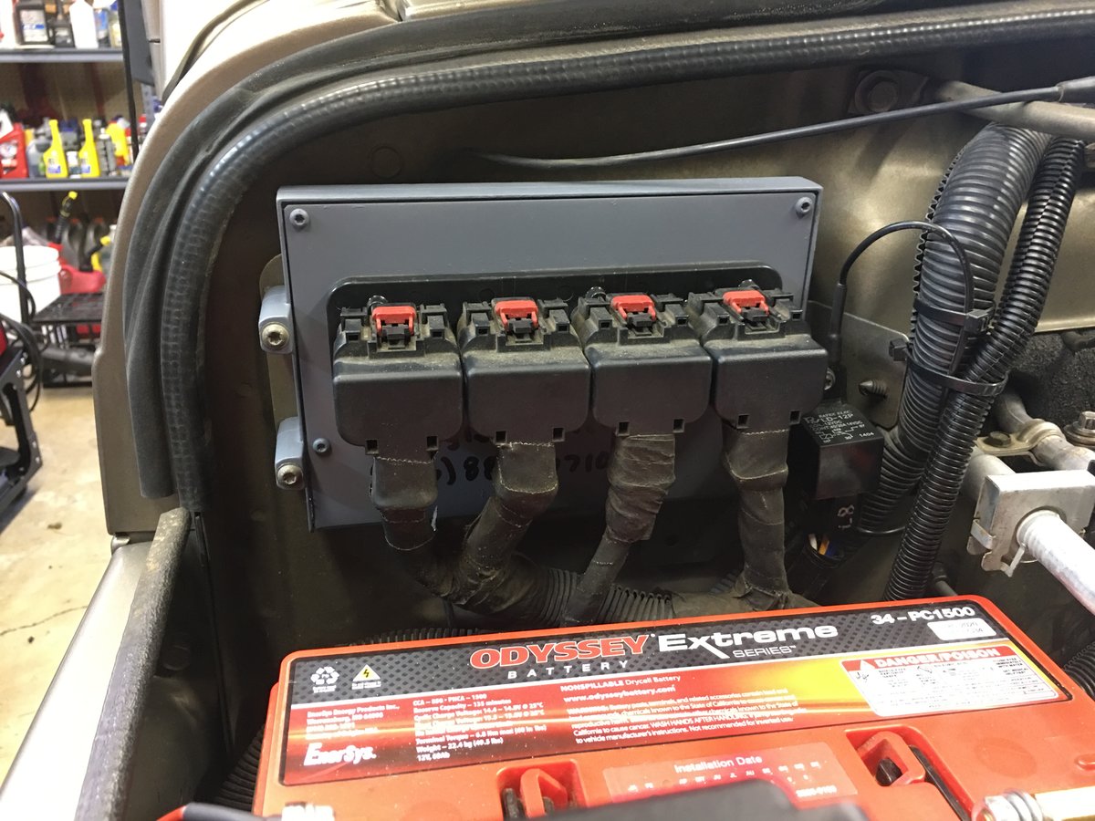

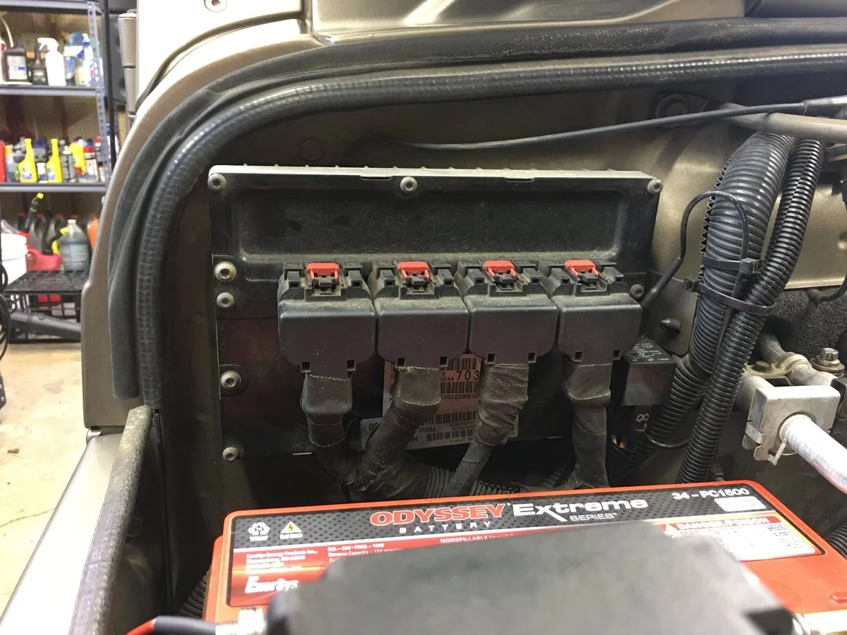

My PCM was ordered on Thursday late afternoon, and I had it in hand by Saturday (though I'm not far from them). Got it put in yesterday, and after replacing an also bad fuel pump, I'm back in business. Shifts seemed to be very clean, though my LJ did not yet exhibit the hard shifts so it's hard to compare that issue. I will try to periodically post updates as the mileage/time goes on, since I DD it I should rack up the miles and on/off cycles quickly. Currently installed mileage is ~118,730.
