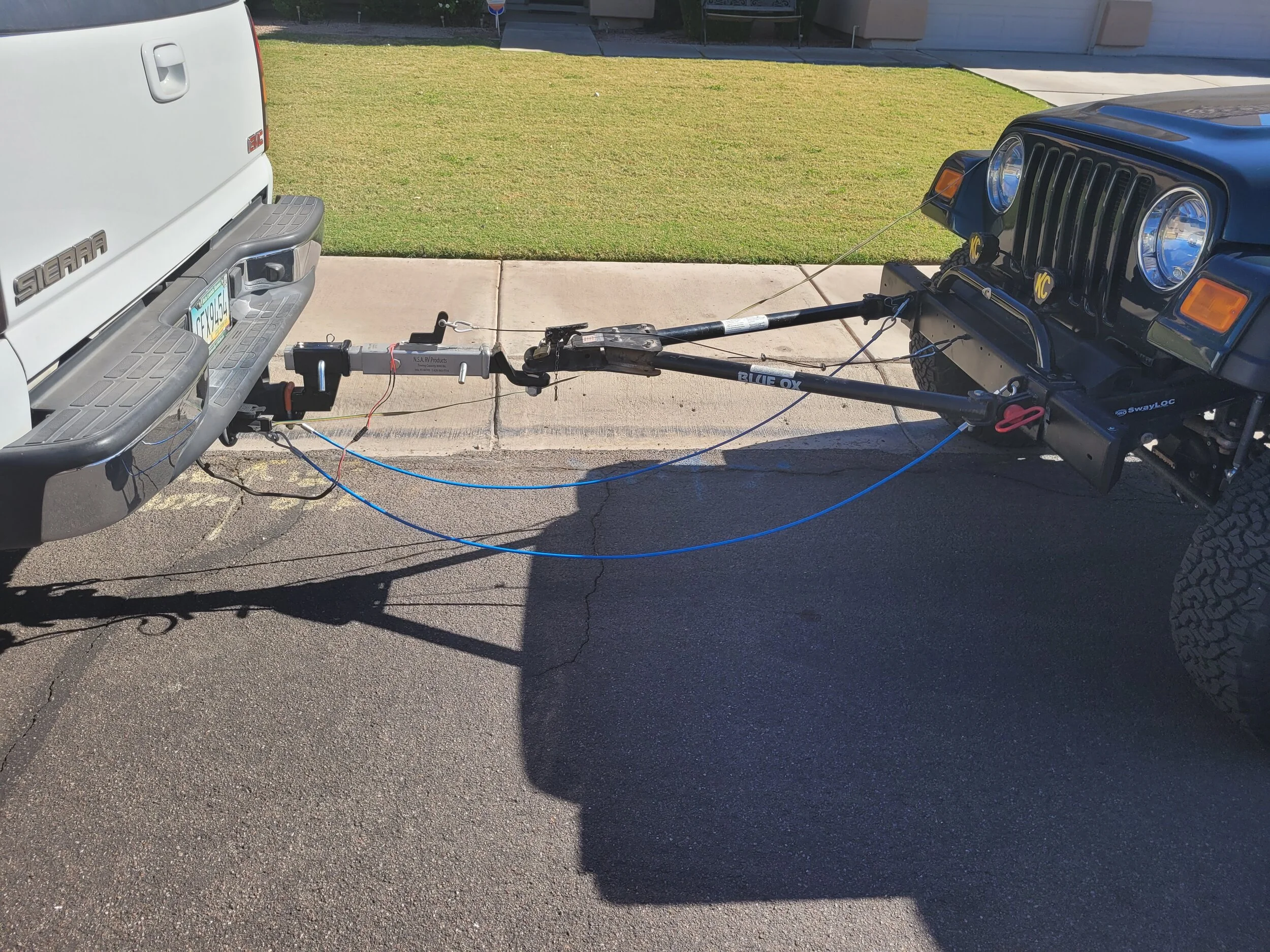

The guys at Tractor Supply told me it would be extremely unsafe to try to flat tow a vehicle much taller than the tow rig. Is this true?
The tow bar is resting on the mounting points in the pic, not in them, so it's maybe 1" or so higher on the jeep side in this pic than it would be when actually mounted.
They are correct. You need a stinger that will raise your ball to about the same height as your TJ.

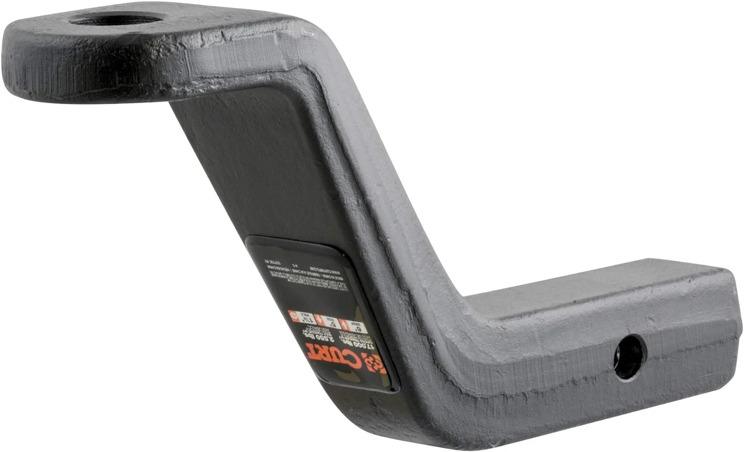

I was asking them about whether it was better to get a receiver adapter like this:

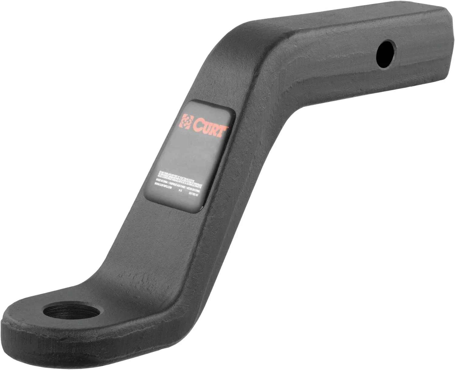

Or a ball like this:

What you have pictured are called stingers or hitches to depend on who you talk with. The second one would be my first choice of the two but IMO I'd measure things and find one that just offers the exact amount of height your are needing.
Like this. But make sure it's rated for the weight your are towing.

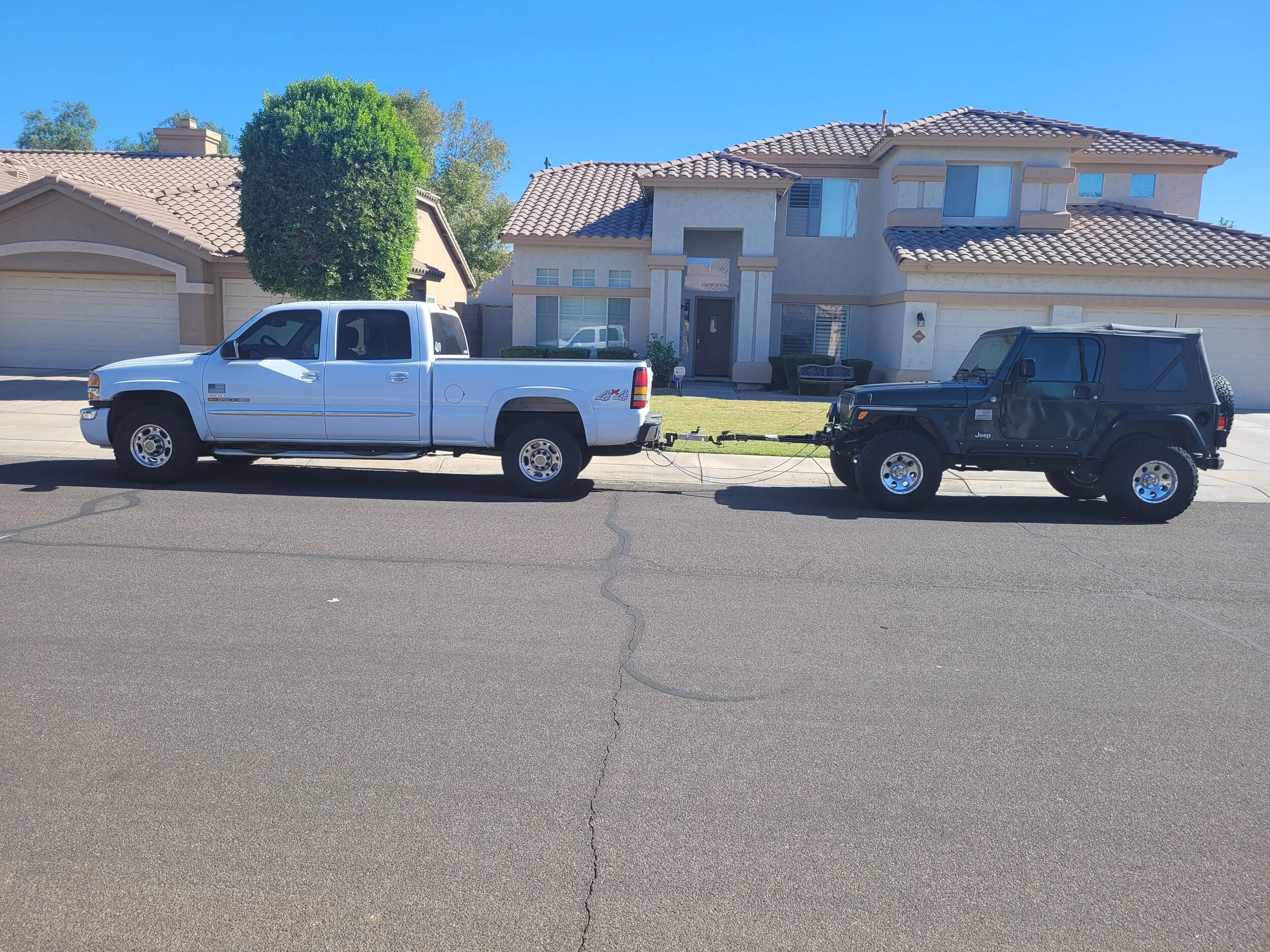

You want your tow bar to be as close to level as possible, no more than 2' above or below level to ensure everything stays attached, as well as to maintain proper tongue weight.
I had to raise the ball for my setup. If you zoom in, you can see I'm running an adapter much like one of the ones you showed.
This has worked well for me. If you go with this type of setup, I'd suggest also adding a stabilizer bracket to take out any additional wiggle the added connector creates. Can't really see it well, but it's one like what's pictured here.
I do nothing,e the extension on the truck. I would also flip a drop hitch to get the tow bar level. The way it is now if you went out a steep driveway it could pop off the ball due to the front of the hitch exceeding the working angle and hitting the ball.

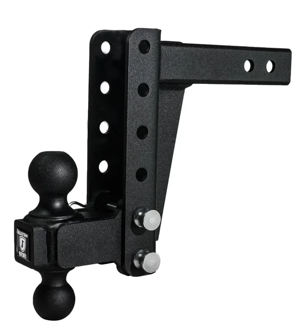

I think if there is a safe & easy way to mount the towbar under the bumper that is the better option. If there isn't a way to do this then I'd get the correct sized hitch to get the bar as level as possible.

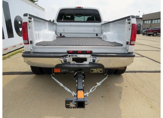

I've never been a big fan of hitch extensions. This is what Super Hitch does with their extensions.
