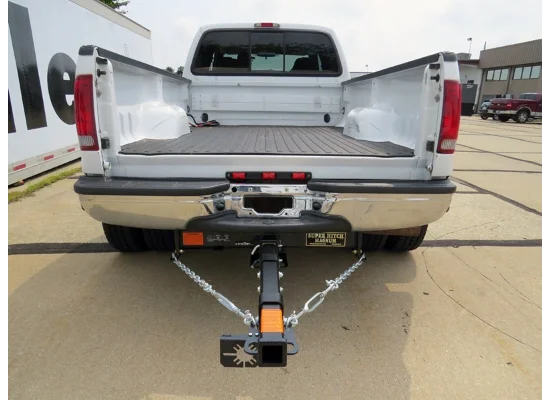

I've never been a big fan of hitch extensions. This is what Super Hitch does with their extensions.

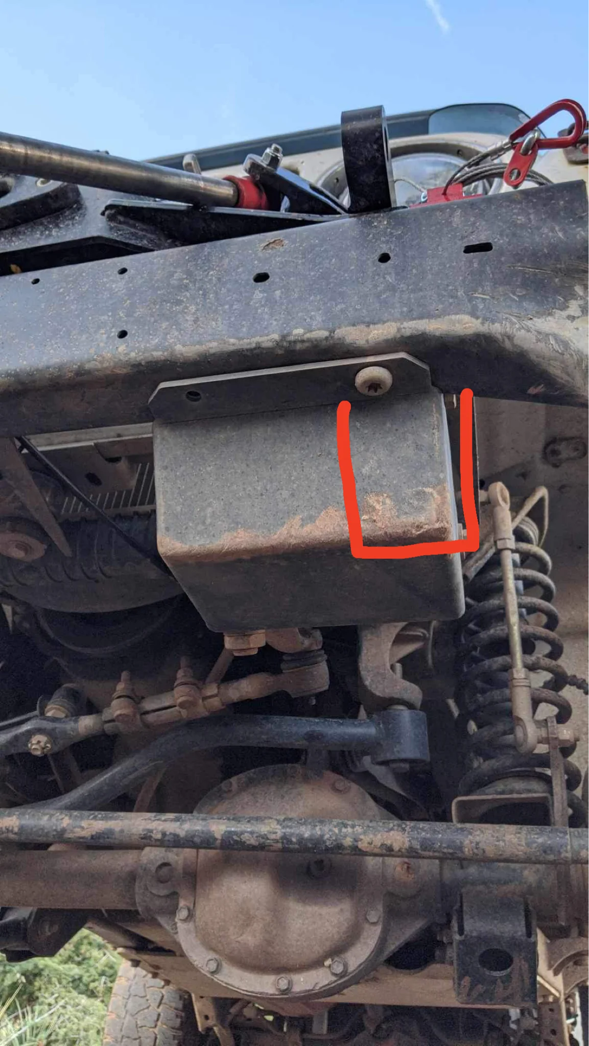

Yeah, I might be able to mount those D-ring mounts under the bumper by cutting my steering gear skid and drilling and tapping second holes
Based on the scratches in that area though it's pretty obvious they're gonna be majorly in the way sticking forward and down.

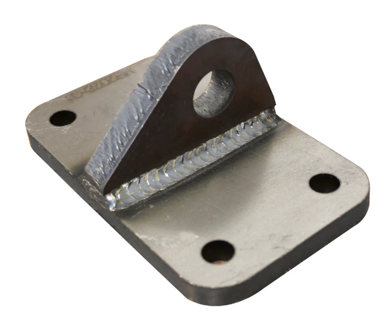

I'm also looking back at these:
Maybe if I put a backer plate behind the bumper I could have these just inboard of the frame rails?

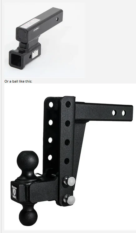

One thing to remember, if you buy a ball adapter (stinger) that is made for rise and drop, the drop and rise will NOT be the same number.
  • Wow
Reactions: Wildman and lBasket
One thing to remember, if you buy a ball adapter (stinger) that is made for rise and drop, the drop and rise will NOT be the same number. Rise will always be higher # than the drop.
Good to know.... is there a meaningful difference between a the sleeve rise/drops and the ones with the ball?
Hmmm... I guess the sleeve ones are more likely to add more overall length to the entire setup since you still need to add the ball.
