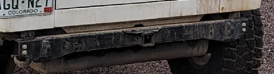

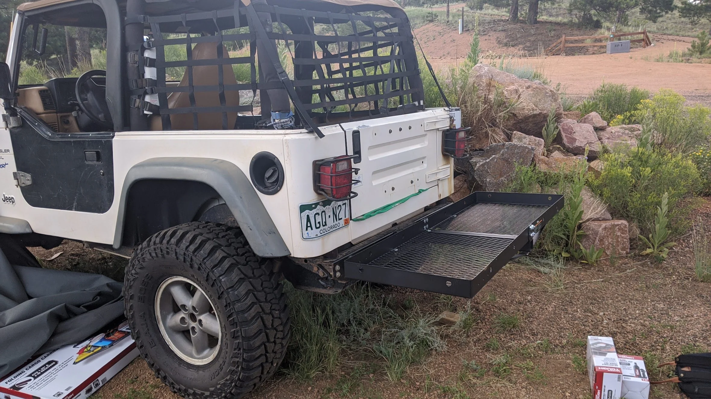

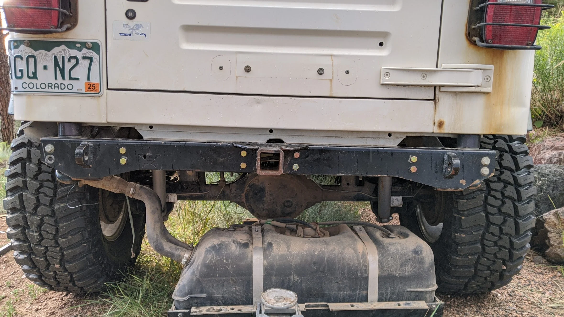

In preparation for the trip next week I picked up a hitch receiver cargo basket. We will be on easy trails the entire time so I figured the extra space would make the trip more comfortable. It actually came with a fold-up section, but I figured that won't do me any good and the less bolted connections the better, so I didn't use it. That keeps it tucked nice and close to the bumper. Supposedly it had a 500lb capacity, but...
It was very bouncy as the bumper twisted and flexed. I had added a receiver, but then gotten lazy about making the rest of the bumper adequate to handle using it. See how it was mounted with only the 4 bolts:

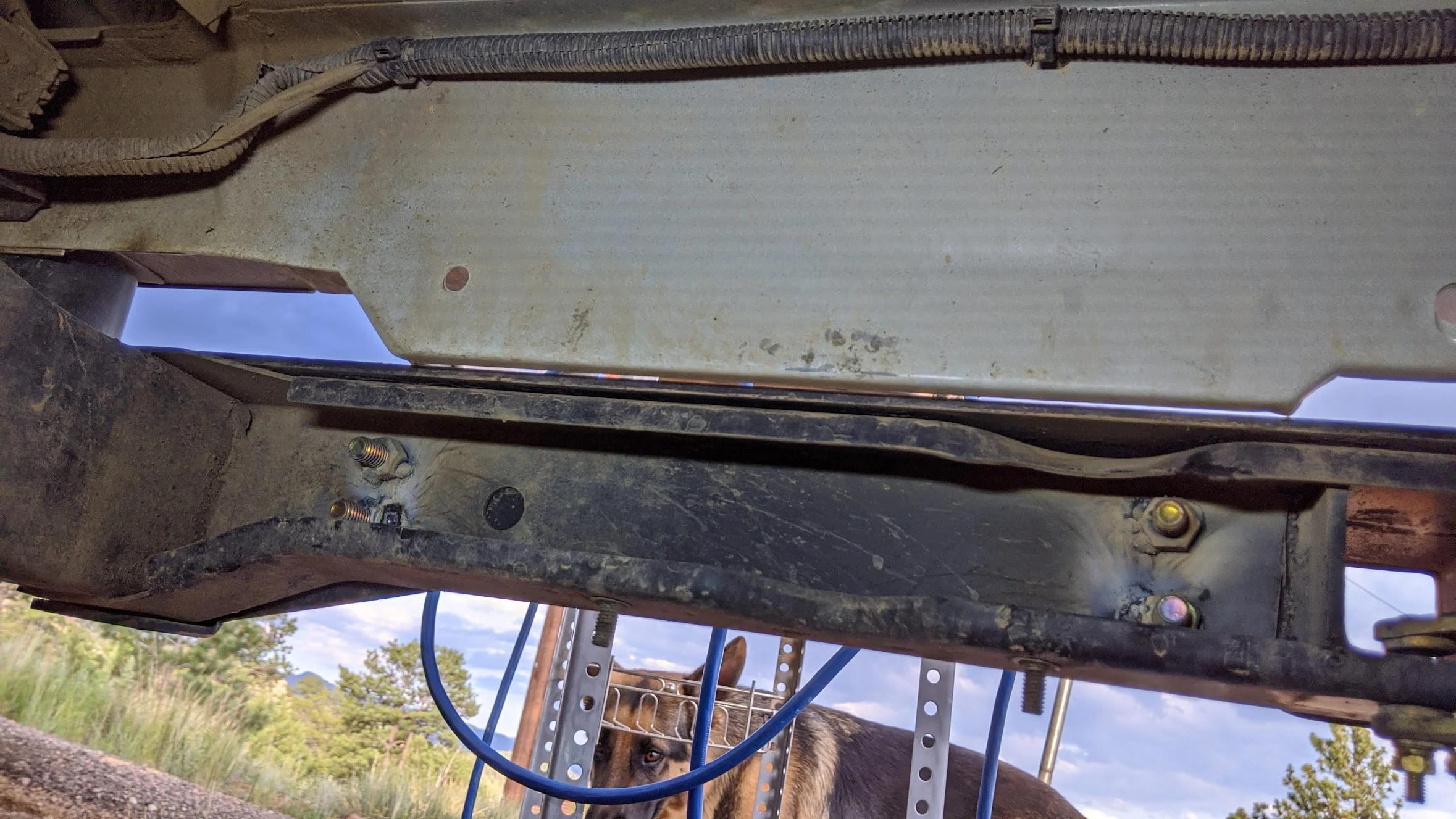

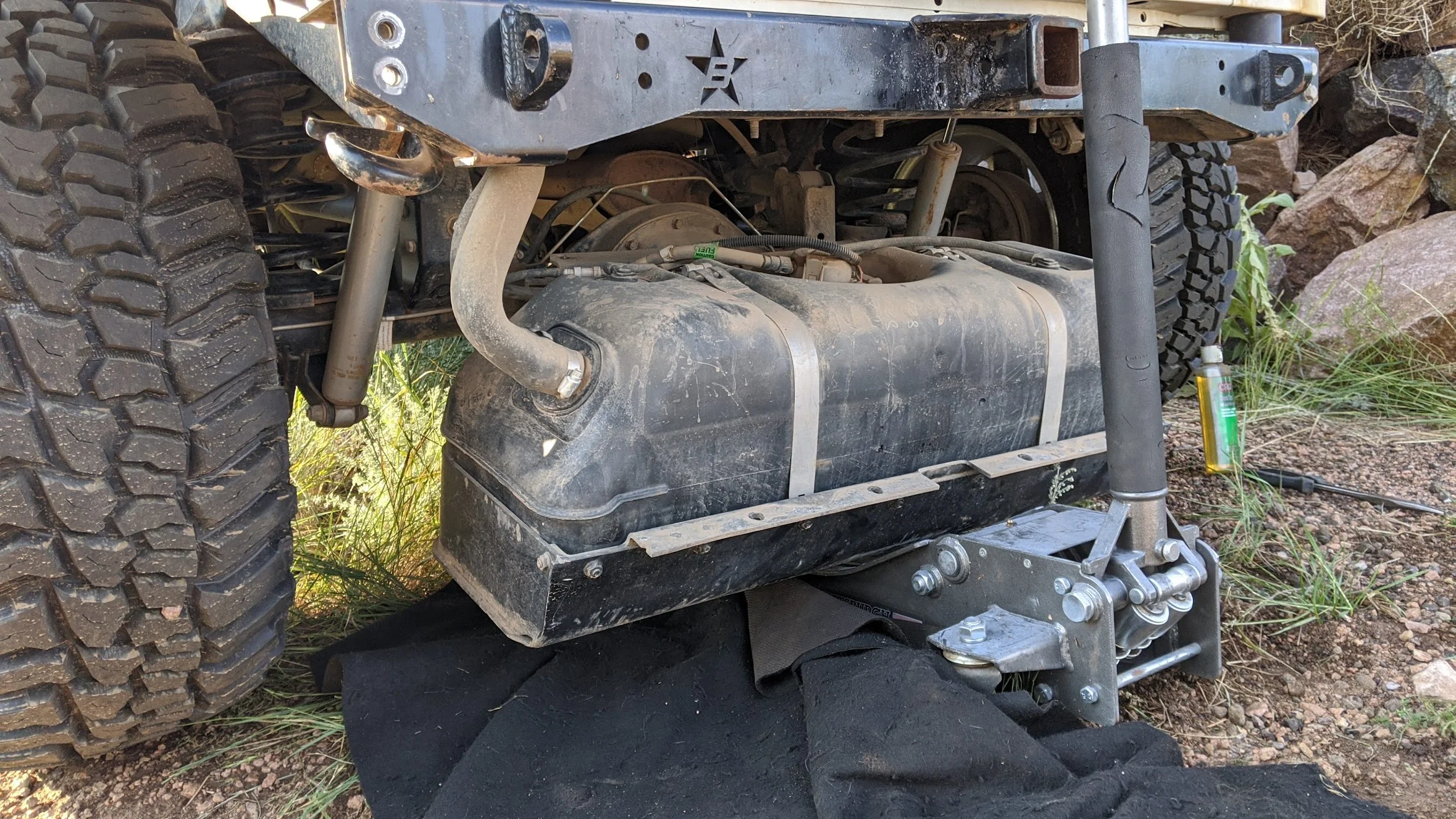

There are 4 unused holes in the bumper already, and I needed to add some near the receiver too. To get behind the crossmember near the receiver, the gas tank had to come out.
Since I have like 3/4 of a tank right now, this was good fun. So... nice little win. There are carriage bolts used to bolt the gas tank skid to the front crossmember. Installing it last time, I had lost one inside the crossmember and couldn't find it so I had to use a normal bolt, which is more difficult needing two wrenches up there. Well haha! I found it again removing the skid this time!
I drilled 4 new holes near the receiver through the bumper and crossmember, added bolts to those and the existing 4 holes.
It always bugs me how off-center the receiver is. I am pretty sure it is centered and it is the tailgate that is not centered on the frame... but maybe I'm wrong.

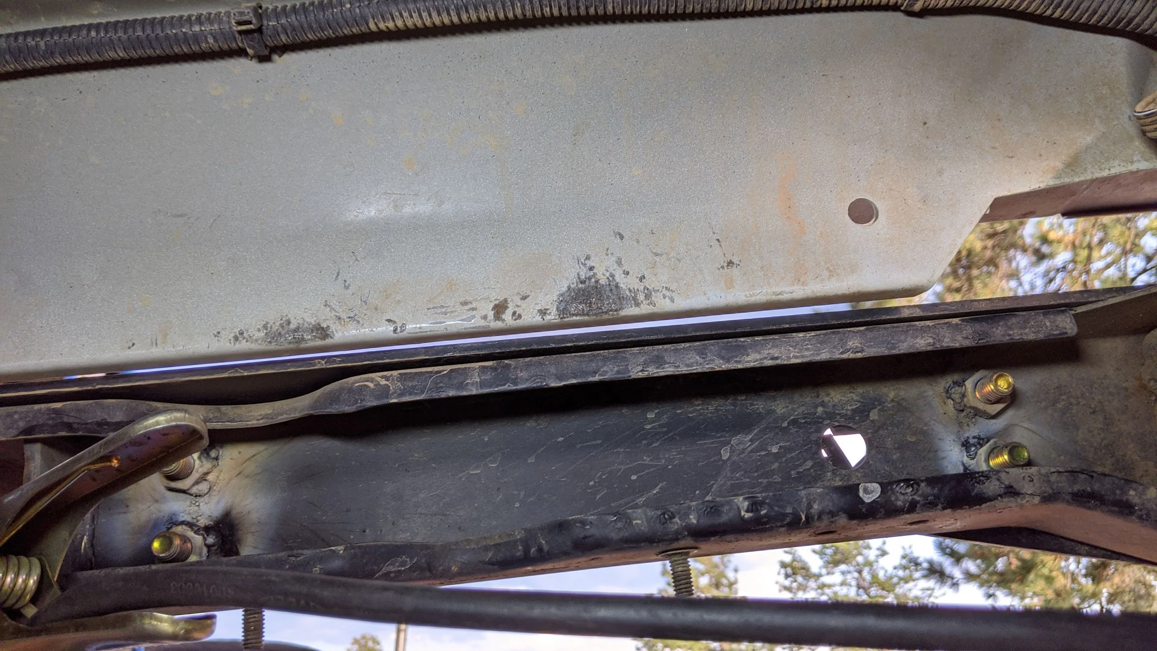

And now so that I don't have to remove the gas tank again to remove the bumper, I threw some boogers down on the nuts on the backside of the crossmember.

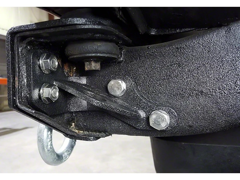

Do you not have frame ties for your bumper? They make a huge difference in supporting/stopping twist.
Reactions: lBasket
I do not, but with the entire width of the bumper being unsupported other than the far edges, it allowed the center to twist. The frame tie-ins are on the outside of the frame rails, right? I do need some of those, but not sure they'd have helped for this particular problem?
I did take a video: https://photos.app.goo.gl/P9cCc2KvdSji9gzn8
All the ones I've seen are made for the outside. I'm not sure if they make any for the inside or not?
Reactions: lBasket
My bumper is just like a "skin" for the crossmember so sending bolts through both gets it nice and secure. I totally stole this idea from JJ lol
Reactions: reddvltj
With the tie-ins you could "confidently" use the bow shackle points.... maybe? :oops:
Theoretically, I think you're right. The tie-ins are probably a better use of the space. The way the bumper is shaped plus just how it goes I'm much more likely to slam down on the corner I think than the center of the bumper.

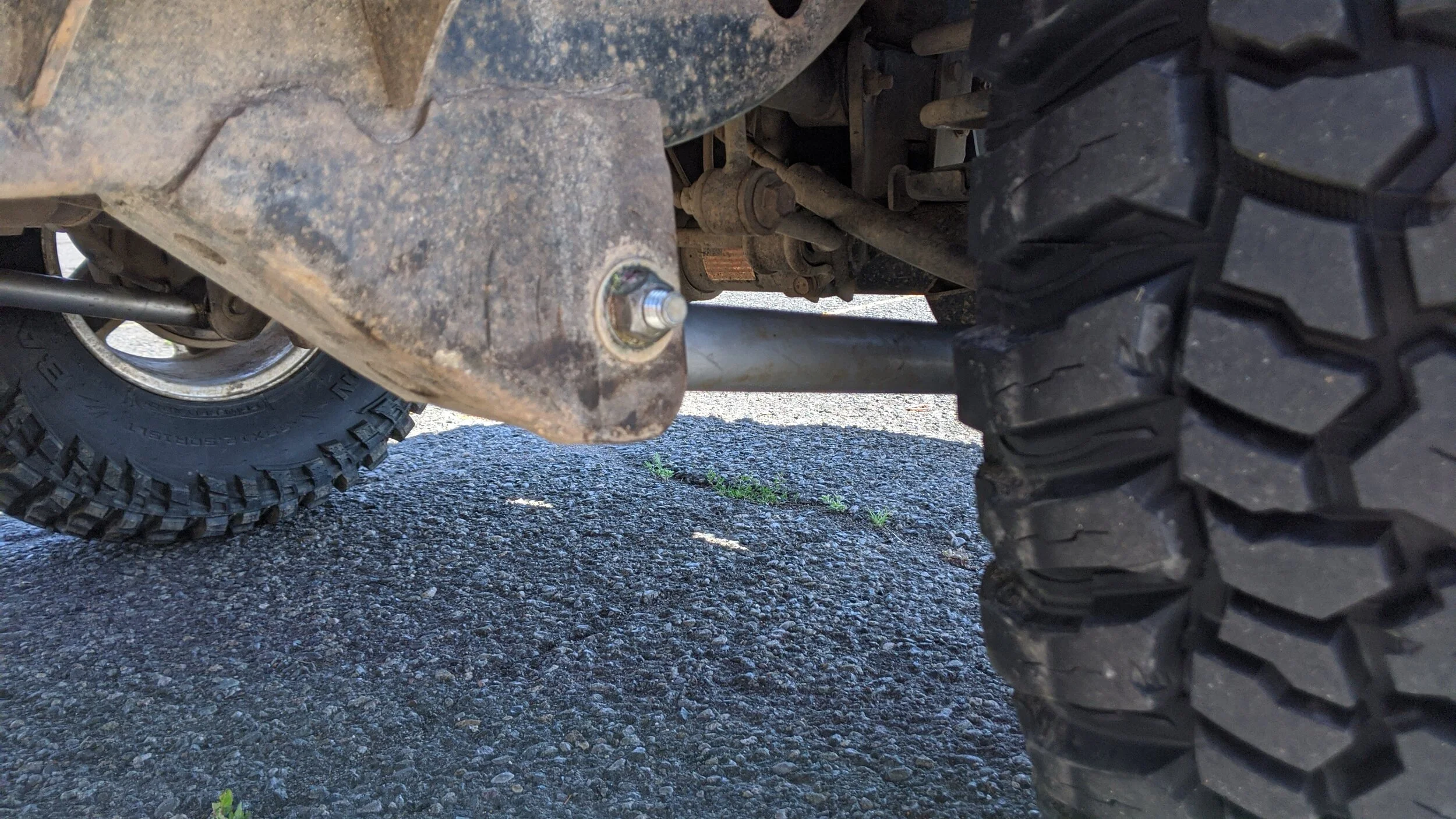

Looks like a control arm failure, driver rear lower. So weird, all the threads on this arm are completely gone on both sides of the arm.
https://photos.app.goo.gl/7NN6UAHnqfDyGQhc7
I'm going to see if I can get a mobile welder to weld the two pieces together so at least it doesn't flop around on me to get home.
Hopefully core 4x4 will warranty it? It's a strange failure
Currently in a hotel in Alamosa.
Measure the other side for a length to set it to and don't tell the welder its for a vehicle. Make up a lie about a tractor link or something so they aren't scared away by liability
I ended up finding a 4x4 shop in Monte Vista, Colorado 4x4, really cool owner there. He had a set of skyjacker TJ/XJ arms he installed in 15mins. Very cool guy and the Jeep drives awesome again!
Seems like the other one failed because the jam nut came loose and allowed it to wallow out the threads and eventually pull them out, the inner threads and shank threads are just completely gone. Whoops! Tighten your jam nuts, folks.

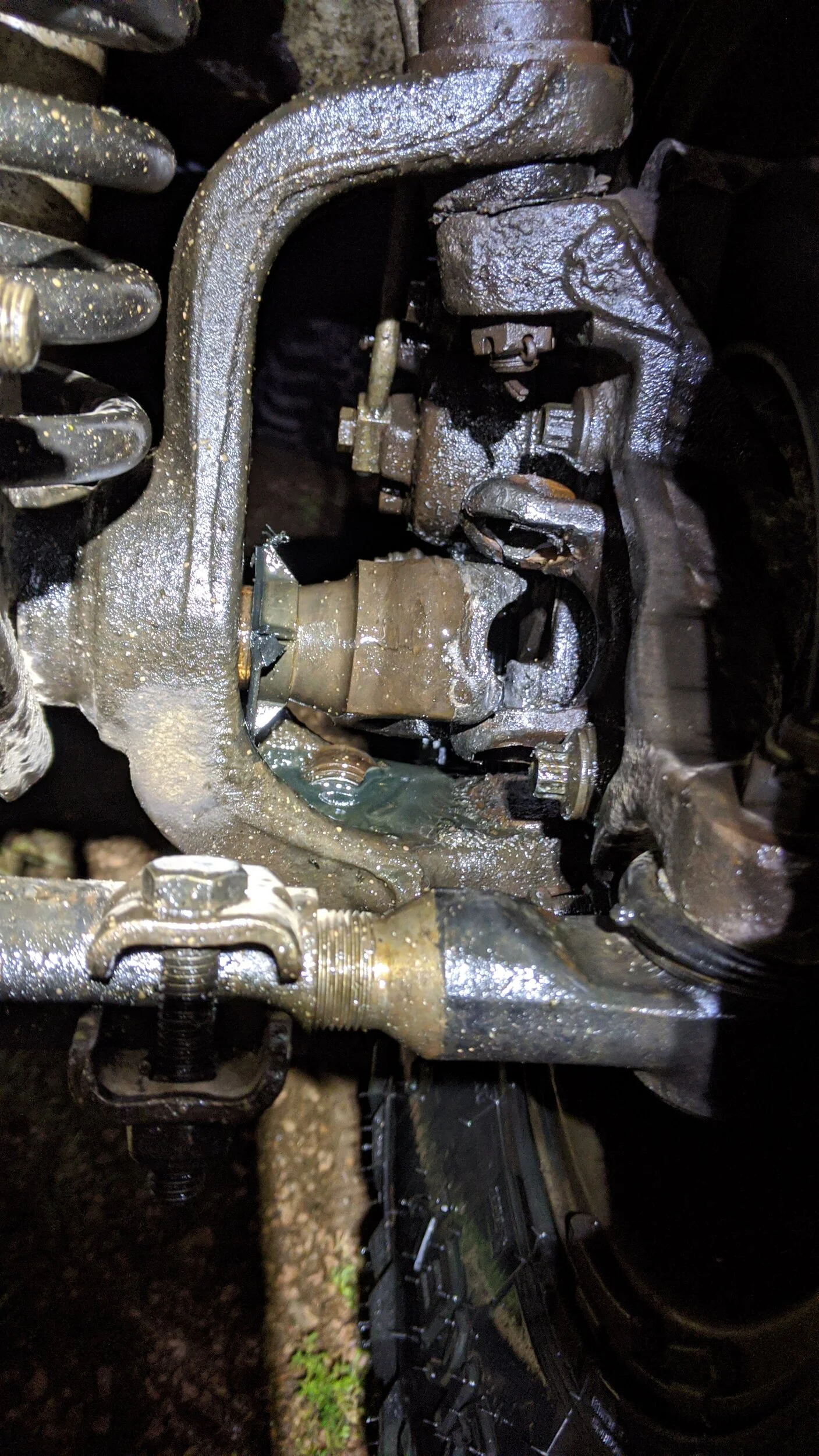

More broken parts!! U joint failed on the last switchback down cinnamon pass. Literally the last switchback before the dirt road to the highway. I was so mad.
The ujoint originally blew and took out the ears in the diff-side of the shaft.
Couldn't find a mechanic to help me in lake City and I didn't have an axle nut socket. So I decided to drive it to Gunnison to get some tools.
It had already done a lot of self-cleancing on the trail, so by the time I made that trip it was basically driving normally. In gunnison I decided to risk it and drive home - I just picked up some diff lube since it was leaking pretty bad. Stopped and filled it up every 30mins, ended up losing about 1/3q every 30mins on the highway.
Ended up being a nicer drive out with a known bad ujoint than my drive out with an unknown bad control arm lol. It honestly drove mostly normal.
