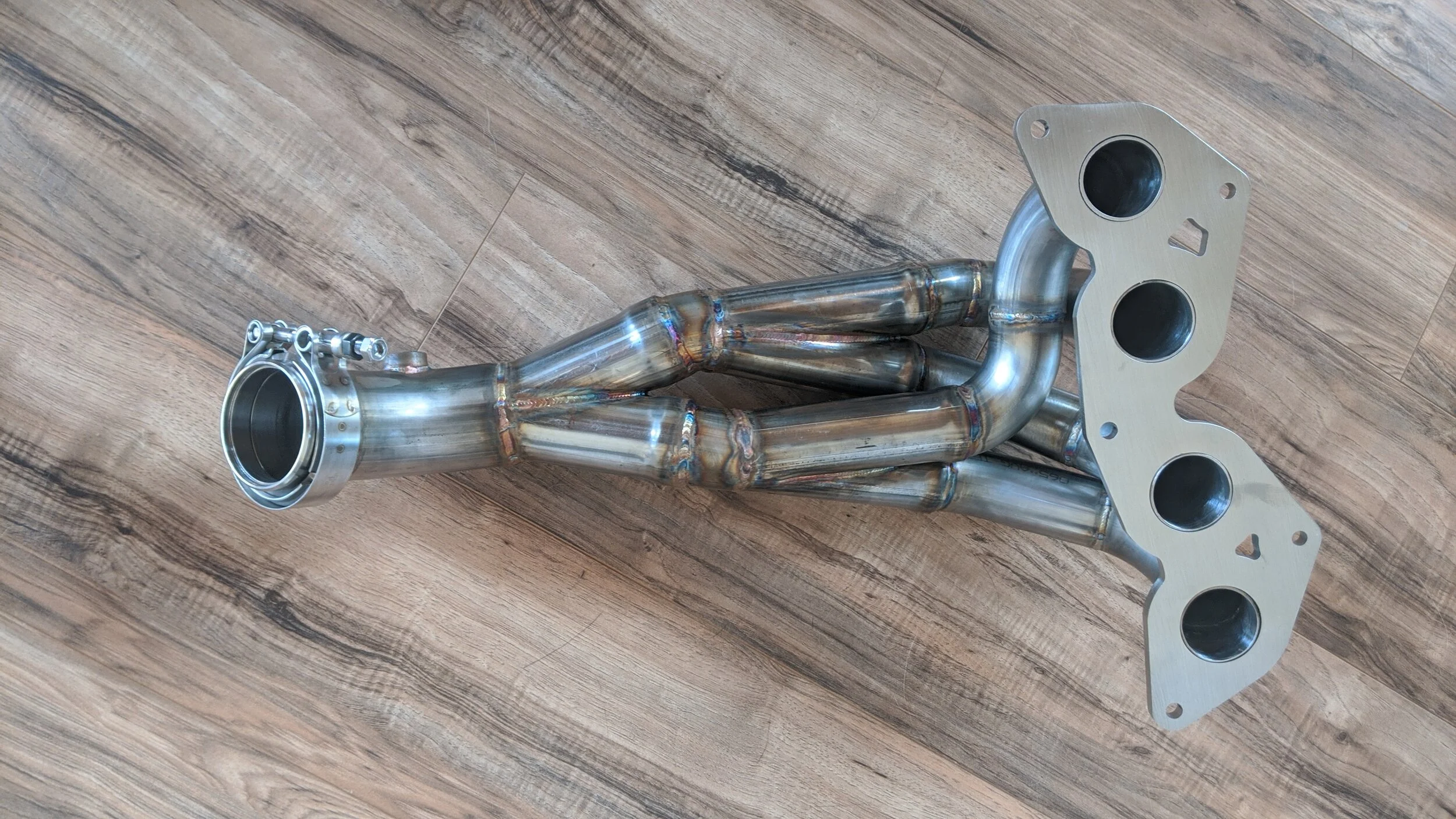

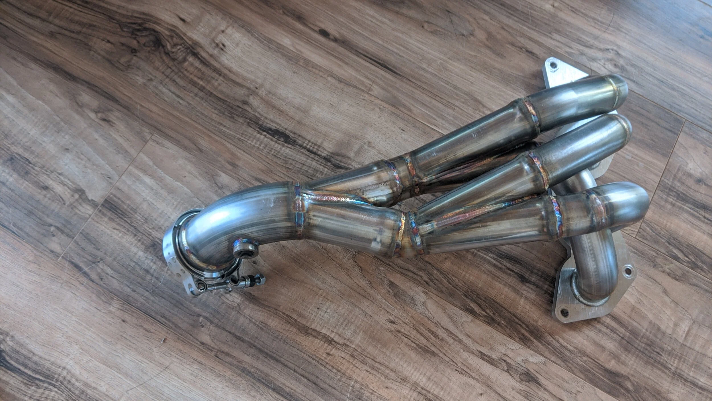

That is a nice looking Tri-Y header. I can't say on your Toyota but the one I had on my Suzuki Samurai made a HELL of a difference. Are you going to leave it raw or paint it? Or get it ceramic coated?
I don't know if it actually adds power vs the OEM header, it is more of a packaging necessity as I'm sure you understand....
I'm going to leave it raw for now. I didn't really want to have to pay for this in the first place and it was expensive lol. It looks cool like that anyways and you'll hardly be able to see it. Hopefully I don't cook

Guy that makes this header also has a custom thermostat housing/molded rubber hoses that I bought and couldn't use with the old header. So between that and the extra room for my shifter cables I'm hoping it makes things smoother.
I'd at least paint it with some high temp paint or ceramic paint. I'd do it more it more to keep it from rusting than for the heat thing. I didn't want to have to buy headers either and the ones I needed were $$$$$ so I get it.

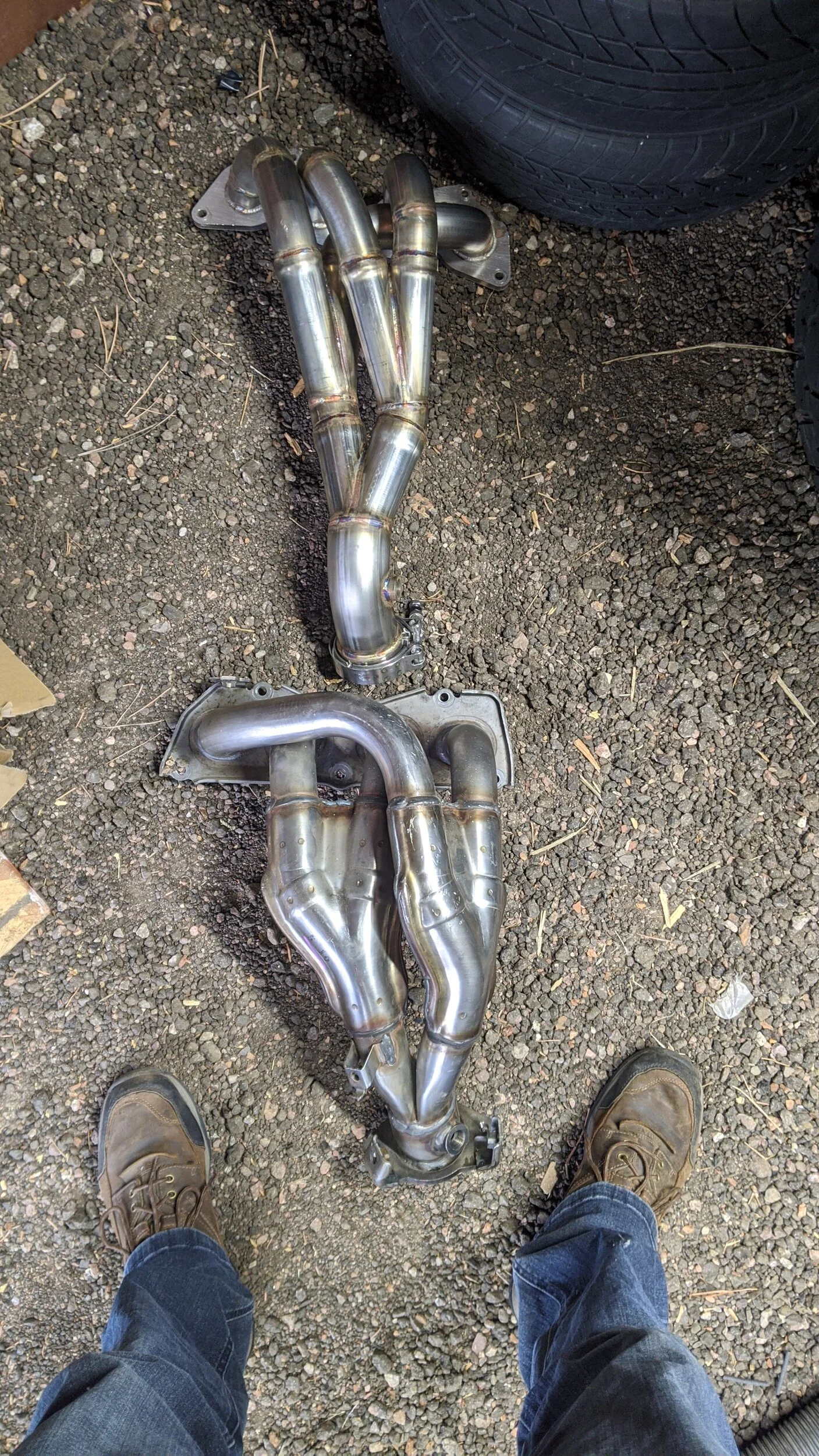

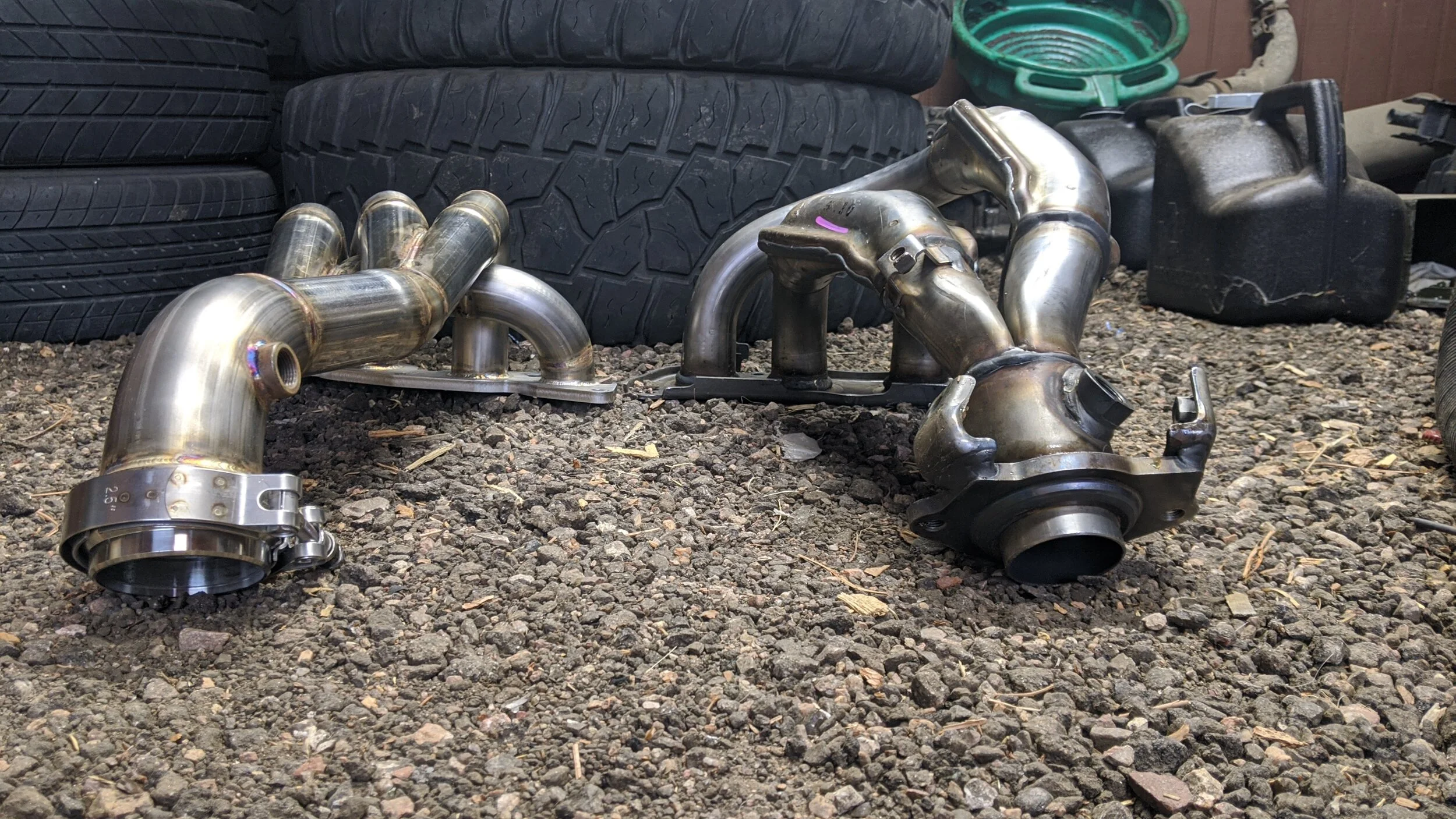

Yeah you have to drop it from the bottom. I just managed to finagle it with the drivetrain partially dropped so I don't need to navigate it back around the suspension at least. Pain in the ass though lol.
Here's some comparison pics
My main problem was needing space underneath the car right exhaust port (in these pics) so I'm optimistic this will help
Doesn't sound like a lot of fun. Even when having all the right tools and a lift.

I don't know if the v-band clamp is easier I'm than the bolt on flange the OEM had? I'll have to figure an exhaust out eventually so I'll find out I guess

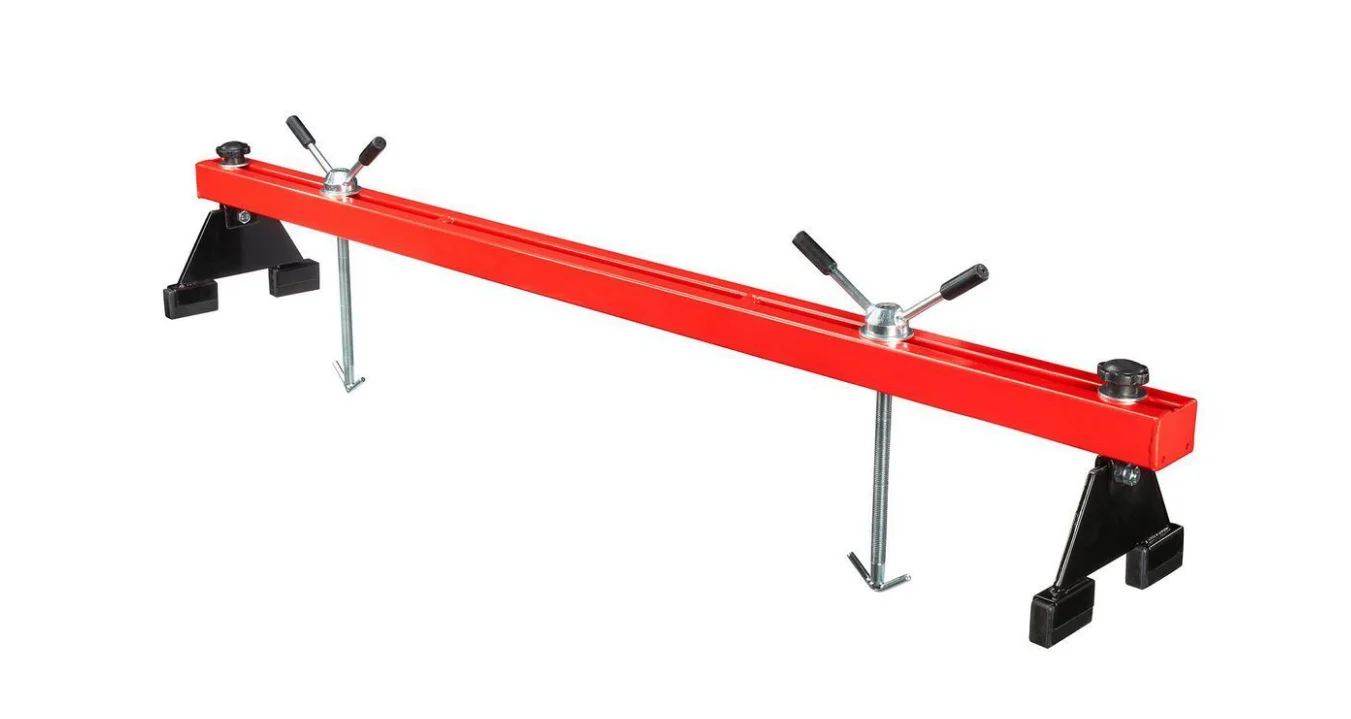

When I did cars where I dropped out the bottom we had a frame that sat on the fenders and would hold the engine as you pulled out the drivetrain. I don't know if the MR2 is like that our not.
I'm a big fan of V-band clamps on the exhaust. They are a lot easier to work with than a flange and you can get things lined up prior to getting everything tightened down. Just don't forget to tighten down the V-band like I did the other day. I had to wait for it all to cool back off before I could get things lined back up and then tightened down.
Were these RWD? I dont know if I've ever seen anything like that... I suppose if you held the engine at an angle like I did today you could maybe pull the transaxle off, not sure there's enough horizontal space to do so without an angle though.
What I wish I had was a longer hoist arm. You have to reach over the trunk to get to the engine bay lol and it's like an inch too short.
Okay cool good to know. That does sound easier. I can't wait to lay down some atrocious booger welds making an exhaust
FWD cars or transaxle rigs like the MR2. It was a frame that sat on the finders and had hooks & chains that would hold the engine as you pulled the drivetrain.
This is from Harbor Freight. The one I used had a second arm that could go to the front or rear.
https://www.harborfreight.com/1000-lb-capacity-engine-support-bar-96524.html
I have the larger hoist form HF and when doing the Hemi swap it was about 1-2" too short too at times. But my front crossmember is moved forward too.
Ohh this is interesting. Yeah that looks really useful. I wonder if the fenders could support the weight that looks really nice.
I'd guess your fenders would. These are spreading the weight too so don't forget that.

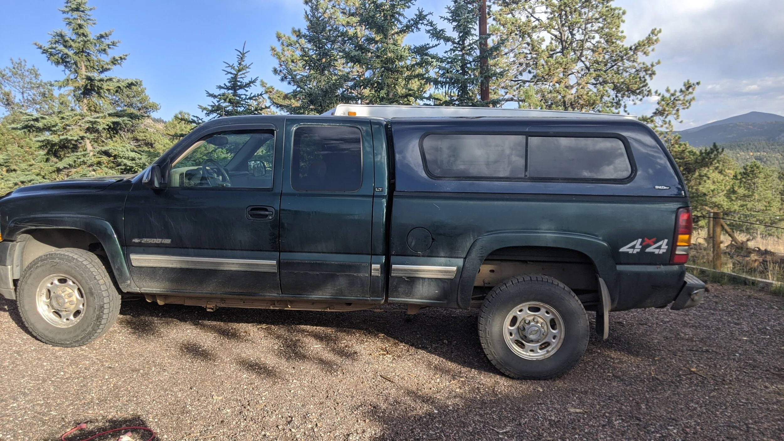

In other positive news... I did manage to pick this topper up for my truck last night:
150$ and 10mi from my house and looks like it's made for this model, I think I got lucky. Needs a back glass.
Let's see if I can come up with something in there that is better than tent camping but isn't a pain in the ass like a bed camper.
