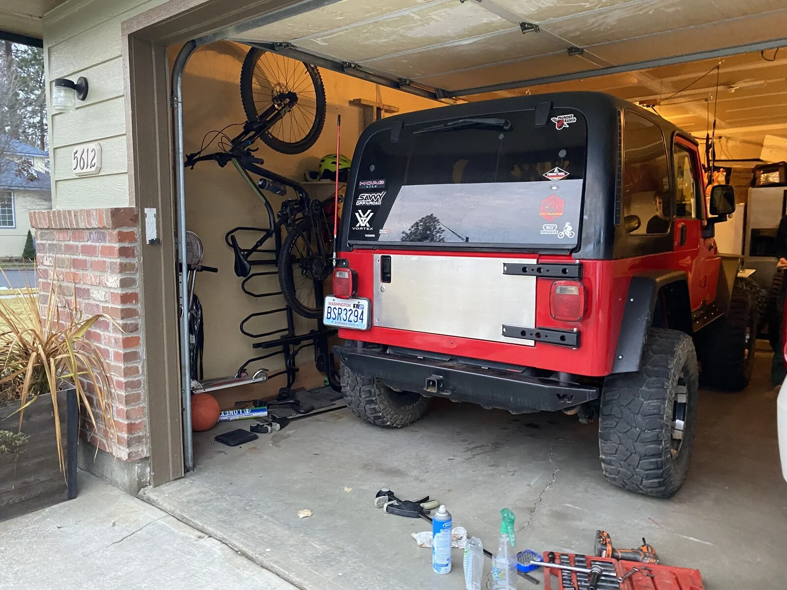

I don't mind the spare delete, but I'm convinced there are little demons that drive around my commute and throw chunks of metal and old screws into the road for fun with the number of flats I've gotten in the last 2 years. I once had a 3" lag bolt in the tire of my XJ.

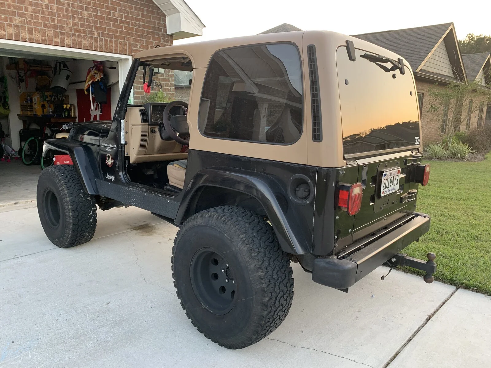

These were my previous, non center cap, rattle can, dry rotted wheels 😂
Also, this is the only picture I have of the rear of my Jeep. I know not many are a fan of a spare delete but I sure am!

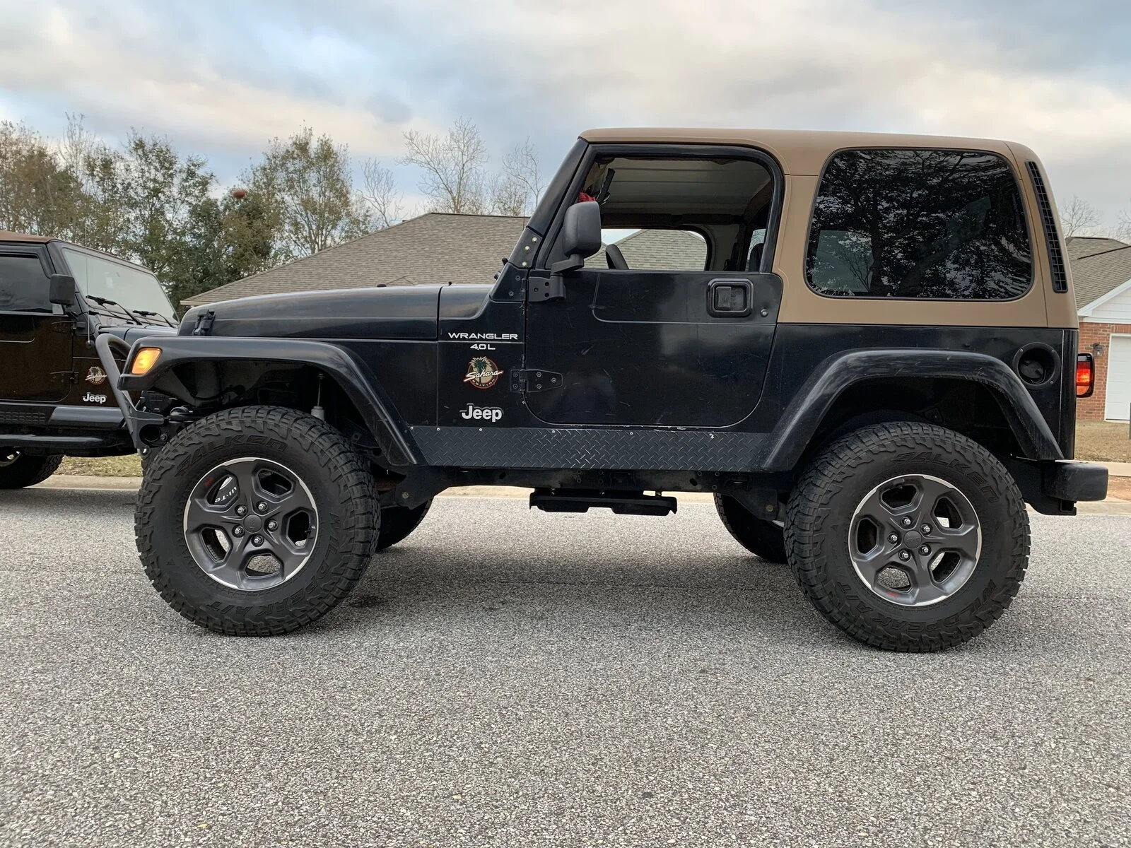

I finalized my spare delete yesterday. I love the look, and I don't have that giant tire back there weighing me down, and I won't scrape it anymore when I climb out of steep gulches. So many benefits and just carry a plug kit and valve stem tool for the rare occasion. A sidewall cut, well, there are risks, but I consider them rare.
Big improvement on the wheels, I noticed in your profile your running 4" lift, looks to be all suspension. I like the stance. I just installed 2.5 suspension but mine still looks a little low in my eyes, on 33's .
Get the 1.25" Savvy BL and it will be perfect! 😉

That's what I've been looking into, and maybe a spacer for the front since I just added a winch. Thanks
Yeah, your winch will add ~60 pounds. I did a spacer up front too. At one time I had a 10mm (0.397"), at another time a 10mm plus a 0.75" (totaled about 1.1"), and now I have a 1.5" billet aluminum. I'm still only getting ~3" up front, which means my OME 2933 HD springs are giving closer to 1.5" of lift. Up front I have a Warn Rock Crawler Bumper (39lbs), a Superwinch 9500SR (60lbs), and MCE Fenders (which saves me 10lbs), an Anti-Rock rather than the stock swaybar. IDK why my OME's are only giving me 1.5" There's literally nothing else that has changed.

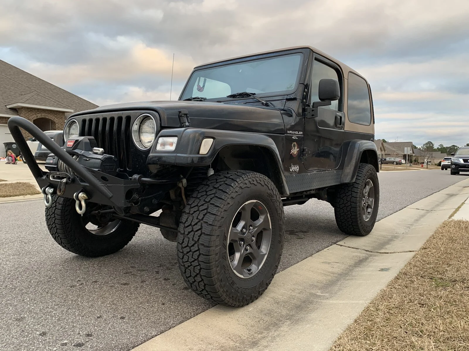

Just wanted to share for anyone considering this. I’ve been eye-ing these wheels ever since the gladiator was released (funny enough, I’m not a huge fan of the gladiator, though).
The swap was pretty straight forward. I will say gladiator/JT lug nuts are NOT the same thread pitch. The look is definitely an upgrade, IMO. The 17” rims seem to add more stability. Feels like, at least. Grateful for the endless resource this forum is. Cheers!

So what wheel adapter did you go with?
