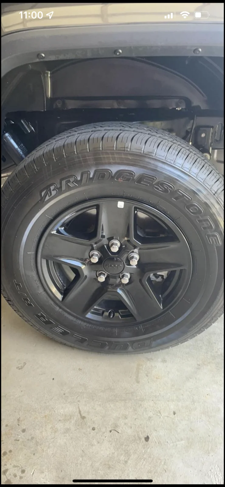

I just this past weekend bought a set of 5 JL wheels and tires (like new tread)
for $500 with lug nuts and tpms..not that they matter on our jeeps
put them on today replacing my 75th anniversary wheels in bronze that i had four of and they needed tires replaced

@TCBrown did you get new lug nuts when you did the swap? I’d like to go with black but wasn’t sure the exact specs and shape. I’ve got the same wheel and tire combo and picked up the adapters you linked on amazon. I’ve seen others mention using locktite with the adapters.

I used my extended thread** (very imp) lug nuts that are standard TJ thread. Gladiator lug nuts won’t fit. At least they didn’t for me.
They didn't fit for me either. I had spacers on with ravines before putting the gladiator wheels. Used spidertrax adapters and the gladiator lugs feel like they'll thread on by hand and when you go to torque them down you'll feel it slip. Used the same lugs from the spacers I had on the ravines.
i had to use my lug nuts from the Jk wheels as well the JL where like 1/16 larger diameter.

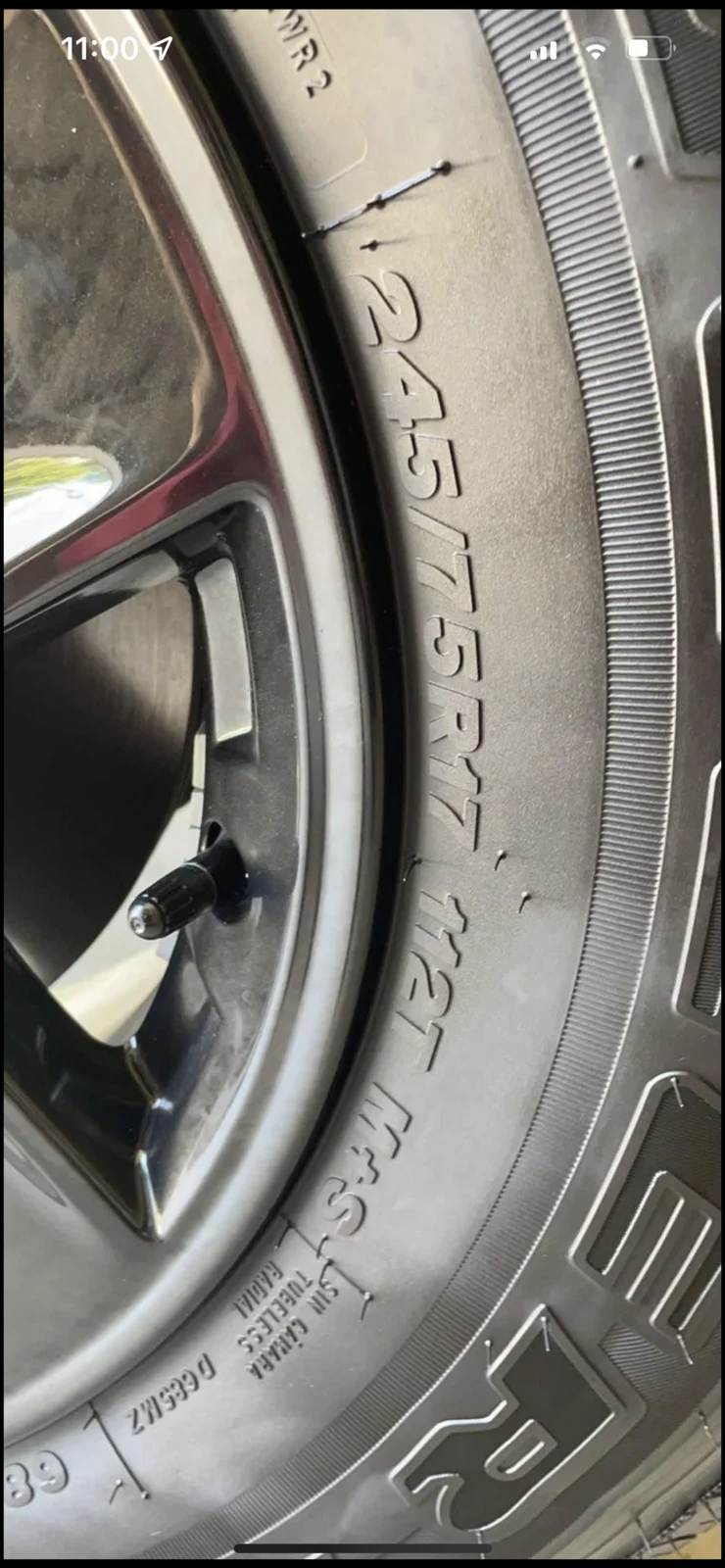

I’m working on the 2in procomp/rancho lift. Any reason I couldn’t use these wheels/tires. Guy on Facebook is selling the set for $400.
Take offs Aluminum 2021 Gladiator 245/75/17 4000 miles. With TPMS and will fit JK/JL also.
I know I’ll need wheel adapters and would be getting these.
ECCPP 4X 1.25 inch 5 lug Wheel Adapters Hubcentric 5x4.5 to 5x5 Wheel Spacer Adapter Fits for Wrangler JK RIMS on A TJ OR YJ https://www.amazon.com/dp/B01IVKIZW0/?tag=wranglerorg-20

No reason you can’t use those wheels and tires.

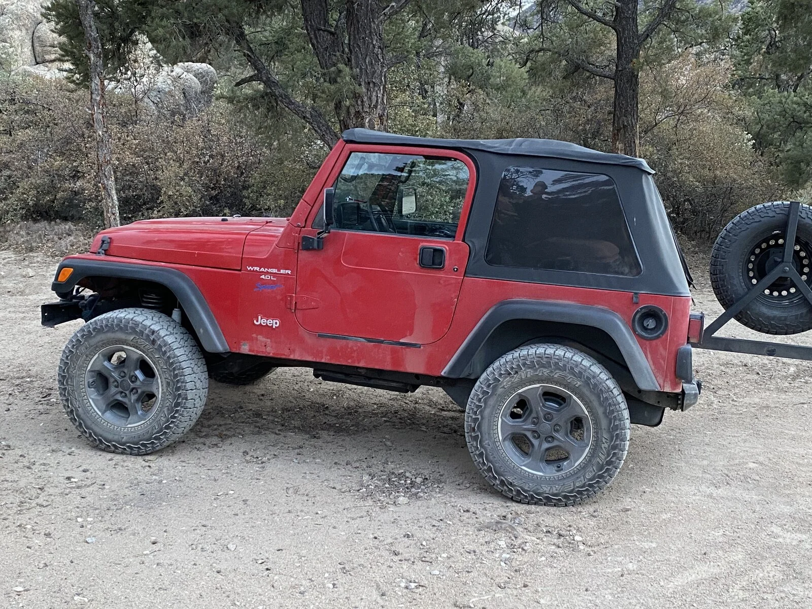

Those would work and look good on a red Jeep. Mine, not yours. ;)
