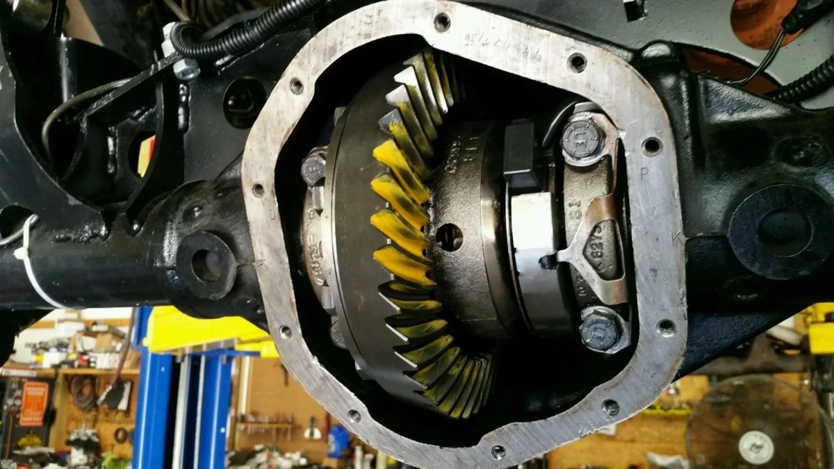

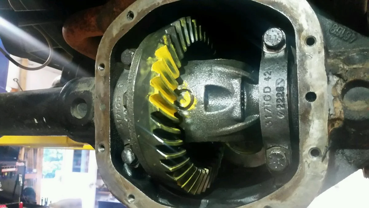

Did you set the gears up yourself?
Wish I could say I did, but it's not something I'm going to touch. The guy that did them builds a bunch of race car and custom axles locally. He even did touring bus axles. Cost me $800 to re-gear but it took 2 weeks. He was pretty backed up with work. I couldn't find anyone to give me a straight answer other than him, so I looked at 100 of his pictures and figured he knew what he was doing.
He has never used Revolution parts and was extremely impressed by the quality of the gear sets. Also mentioned that they setup very easily and he had no issue with the overhaul parts.
After talking to him for 30min, I found out he lives on the next road over from me and just had his new shop built, good news for me if I need some more work done.
