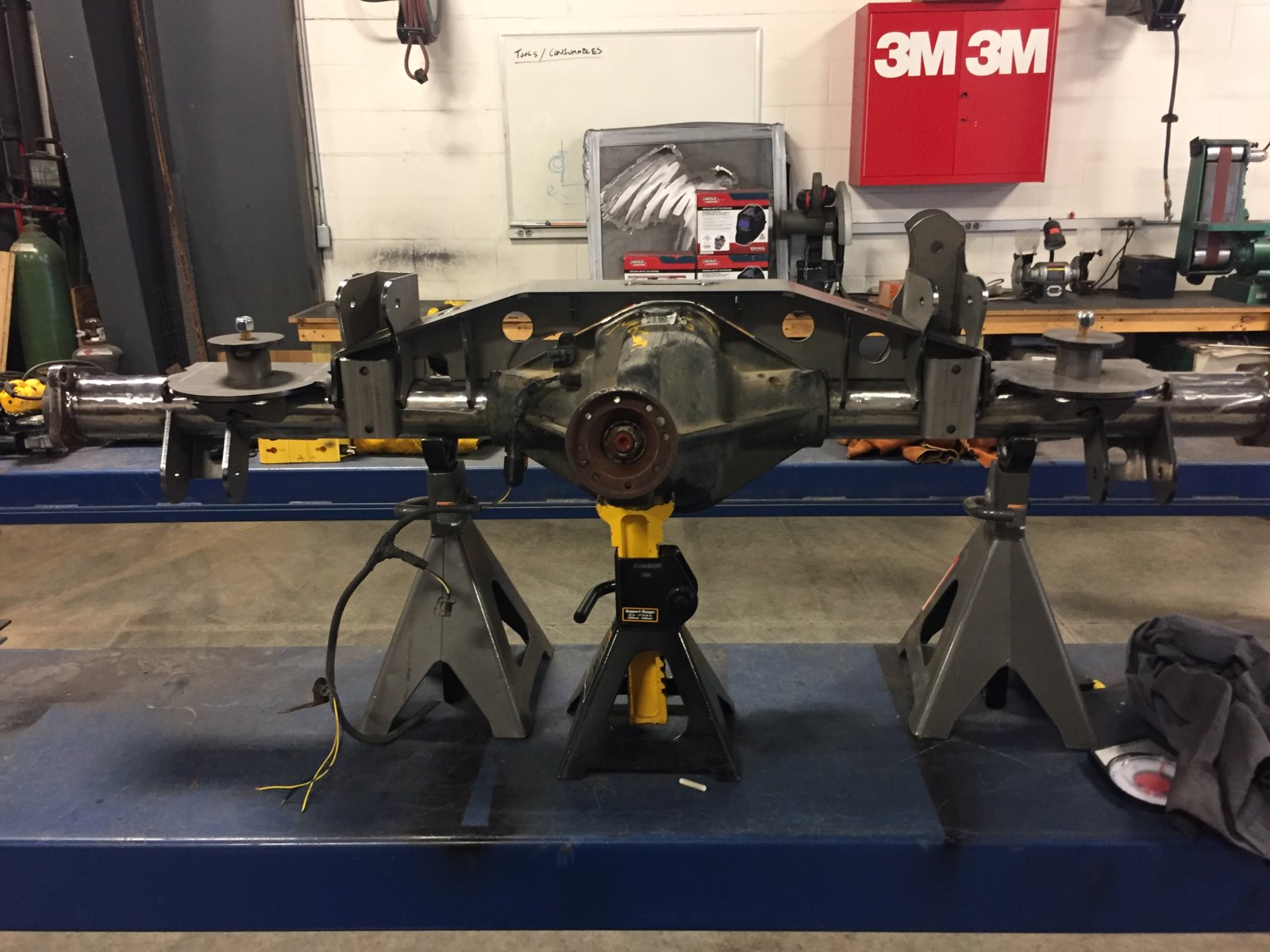

Anyways, the axle looks great so far. That's going to be quite the stout axle from the looks of it.

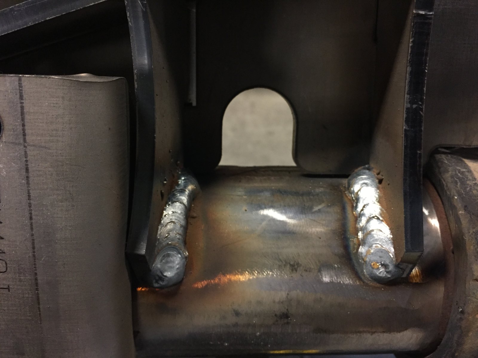

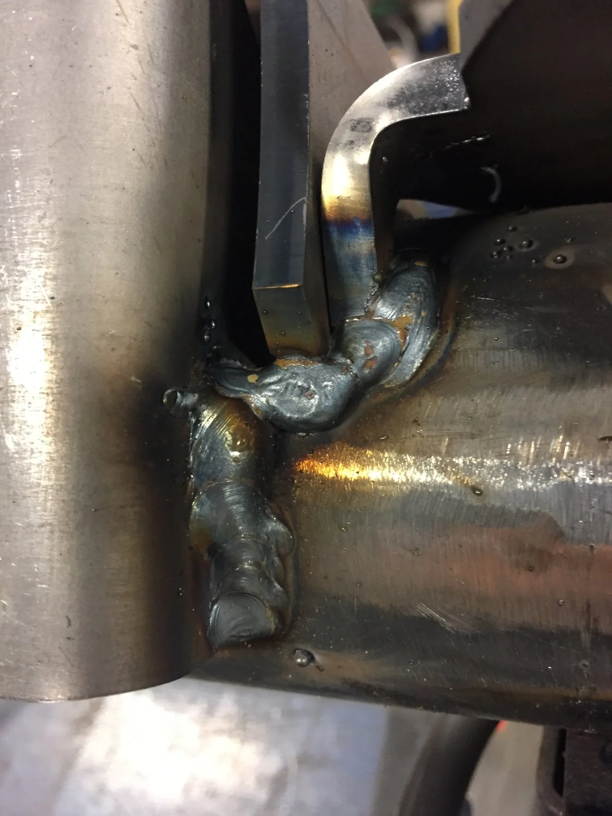

Not bad for a guy who just learned to weld this week.
And I spoke too soon...
Welding is fun and frustrating at the same time. I’ll make a good bead and then completely make a booger. Guess I’ll be cleaning some welds.

Had you spent a few minutes posting up some test welds, we could have walked you through some ways to improve. You're moving the electrode way too much and you are running way too cold. Turn the wire speed down if you can, that will slow down the deposition rate and heat the weld up some, then slow way down on the tip movement and concentrate on letting the weld build up to the height and width you are after with deposition, not tip movement as in side to side washing.

The problem with stick welding is you need clear vision and a lot of practice to distinguish between the puddle of flux and the actual weld puddle. It looks like you are laying down a lot of material and after the flux is chipped off, you have thin stringy booger bead that walks back and forth between the two weldment faces.

Everything you said was the feedback I was getting here. I just finished welding the truss, I have improved quite a bit yet there are still some issues. Overall, I'd call it a success, I need a butt load of practice. If I was trying to act like I knew what I was doing, I wouldn't have posted those welds and acted like an internet hero.

You might want to redo some of those welds. It doesn't look like you have enough penetration into the axle tube. It can end up brittle and those welds will crack right out of the tube and take your control arms with it...
Practice on some scrap and use a hammer to make it fail. Ideally your welds fail after the material.
It took me about a month putting in 8 hour days to have welds that I was happy with.
