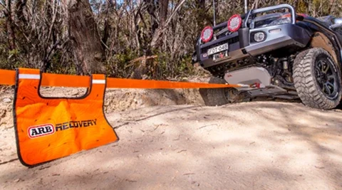

Aldo demonstrates why draping something on a winch line might not be the best idea.
