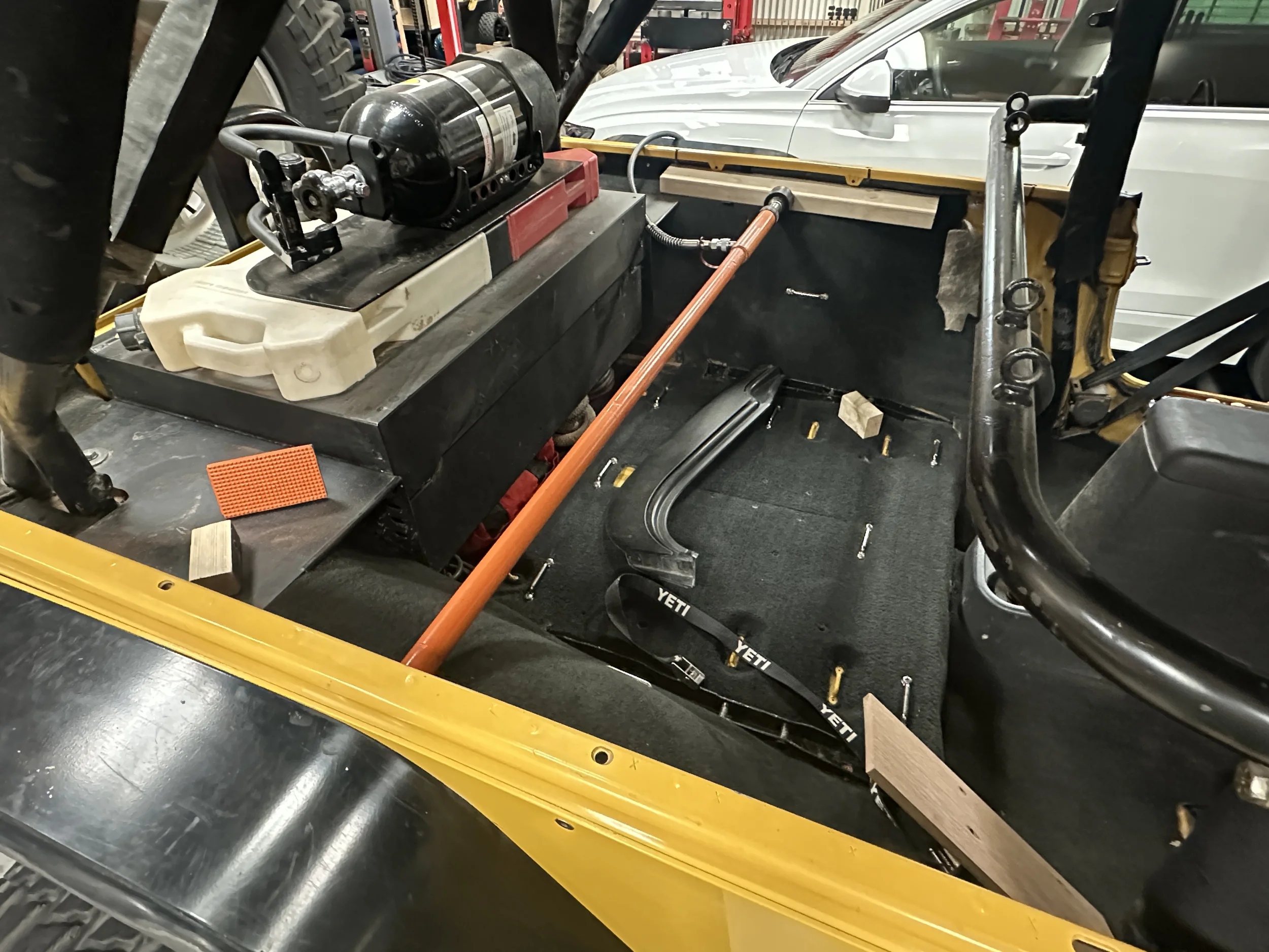

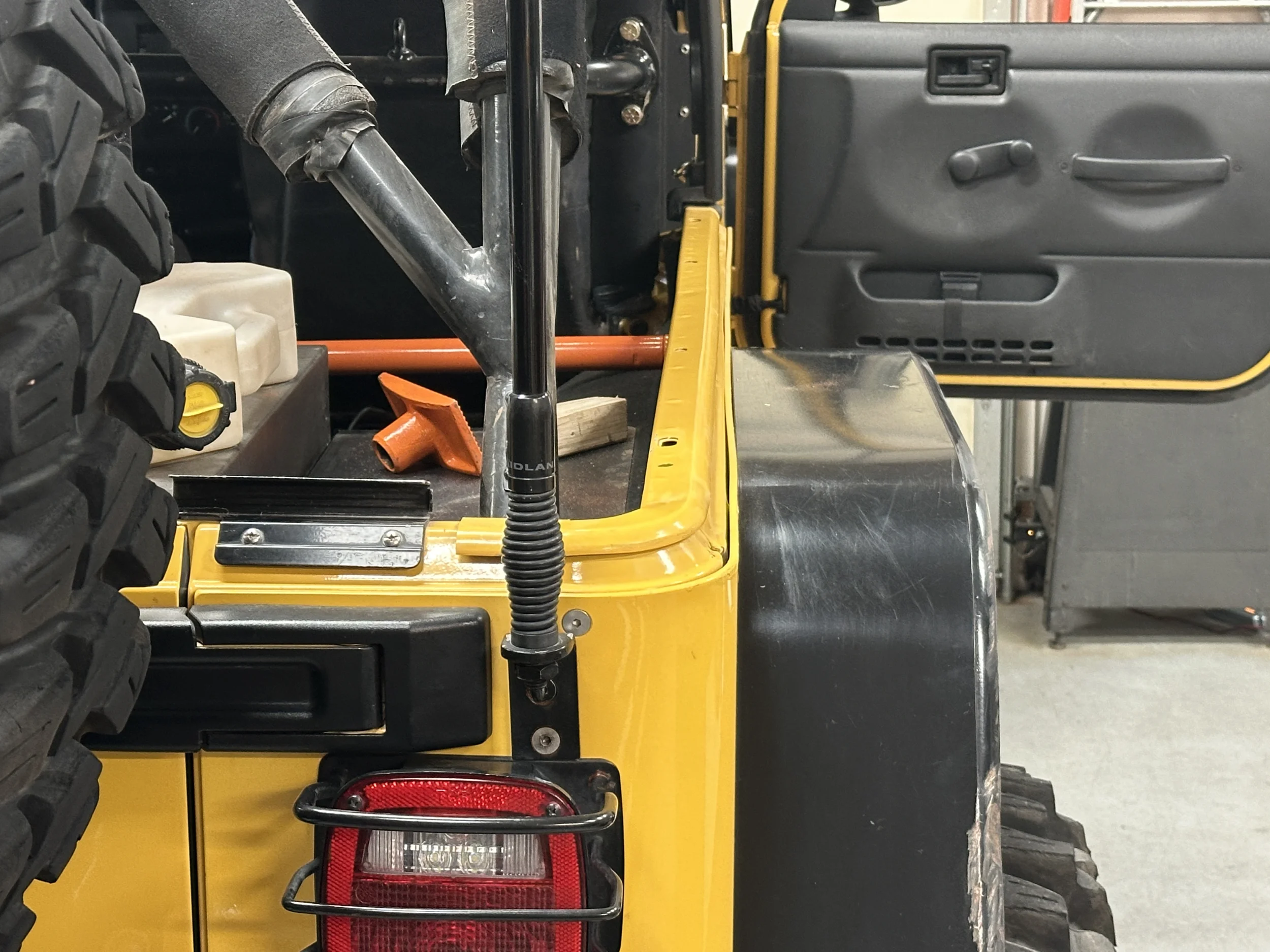

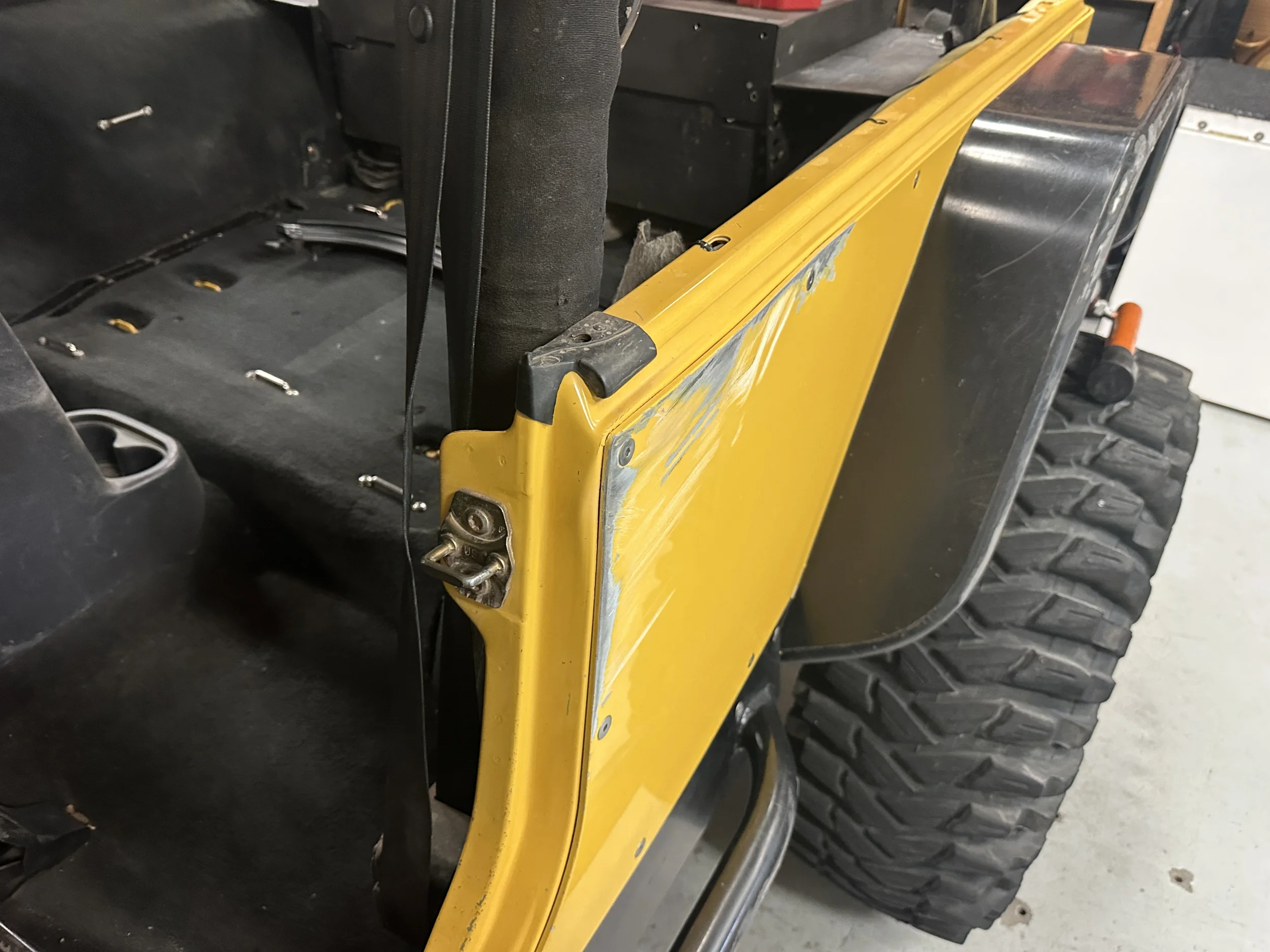

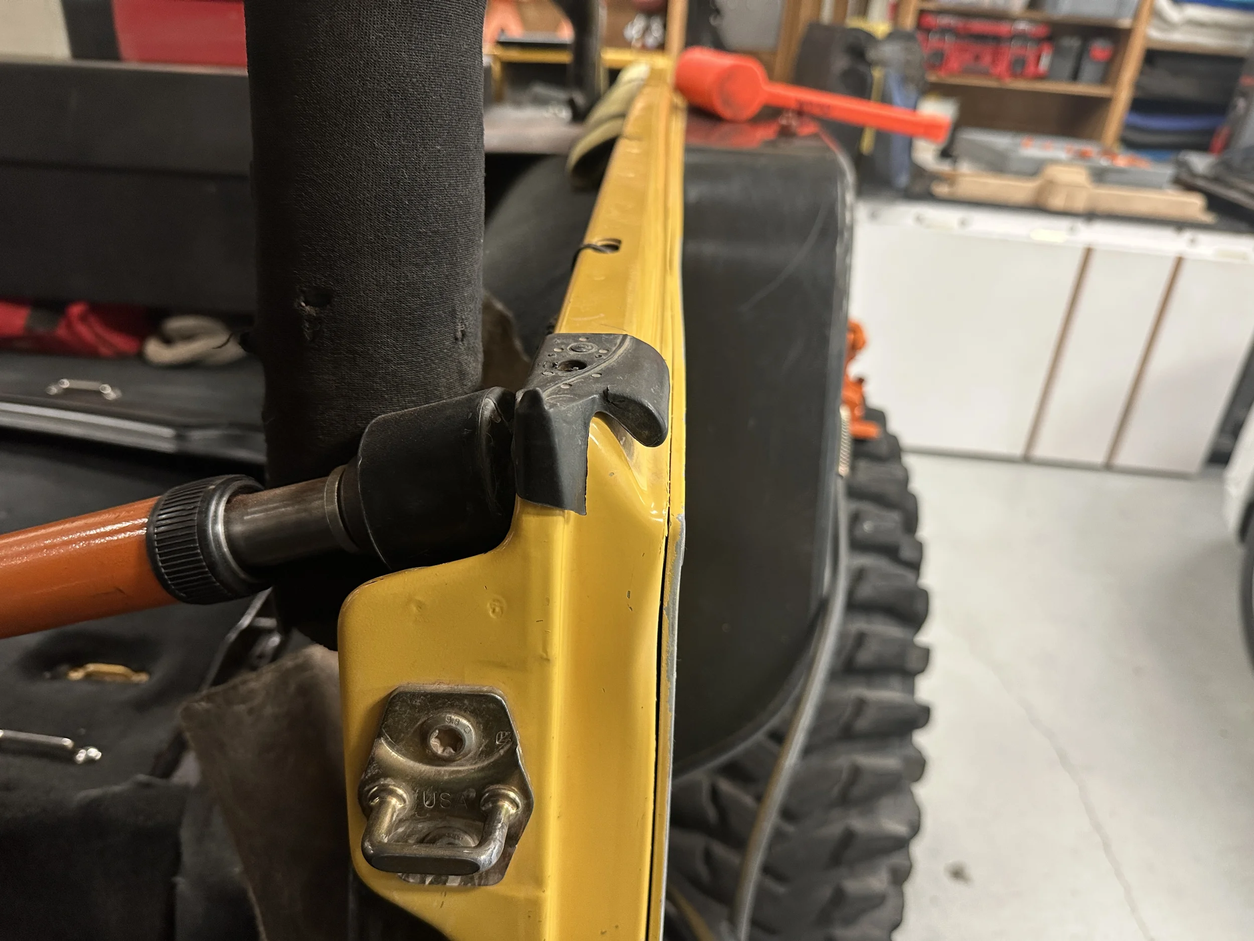

Now that the half doors are in process, I did a bit of "straightening" on the rig today.
First up, true-up the tub at the door jamb. Once again, here it is

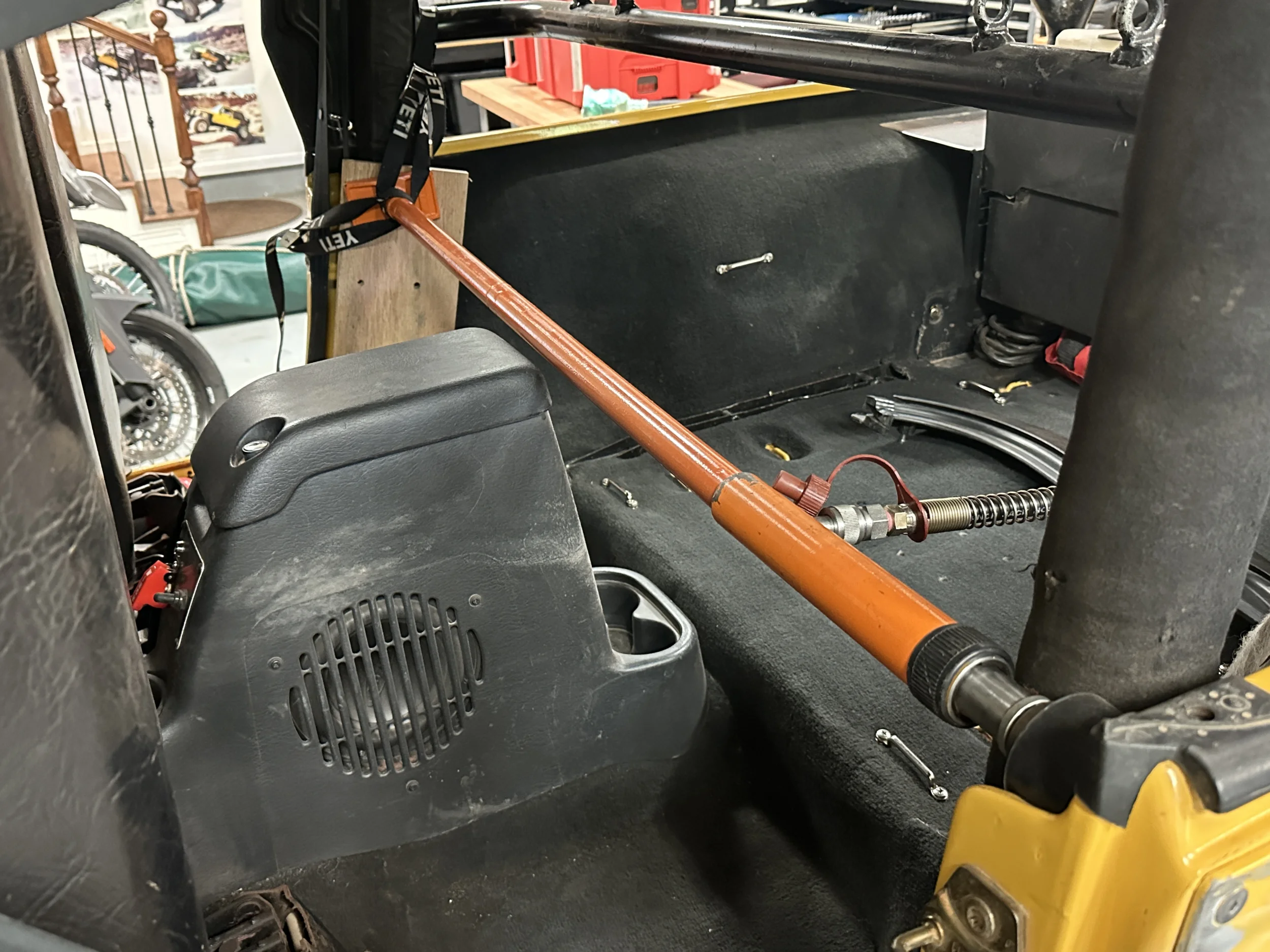

I braced my hydraulic ram against the cage on the opposite side. This works because the tub is bolted to the back side of the cage.

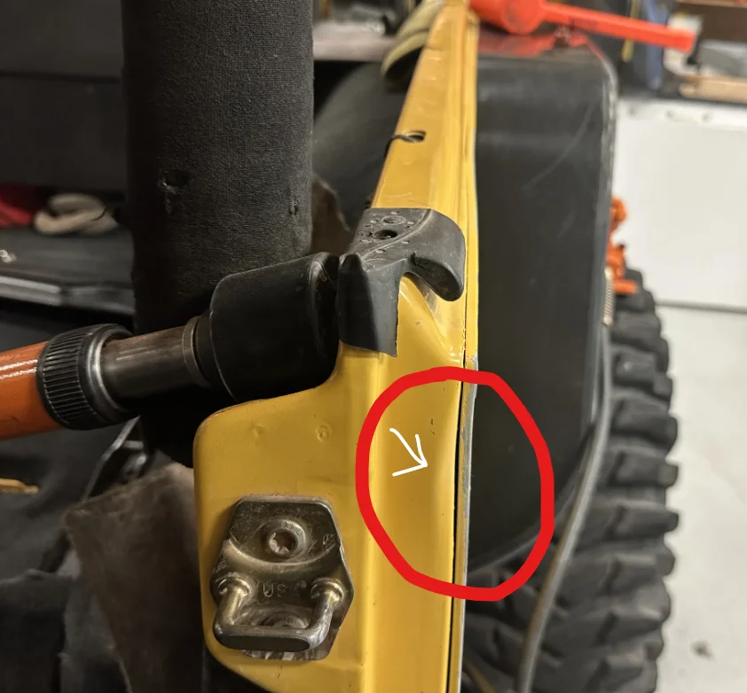

In conjunction with my big dead blow, not perfect, but pretty close:
Given the damage, I'm pretty happy with how it came out. The door closes and seals perfectly.

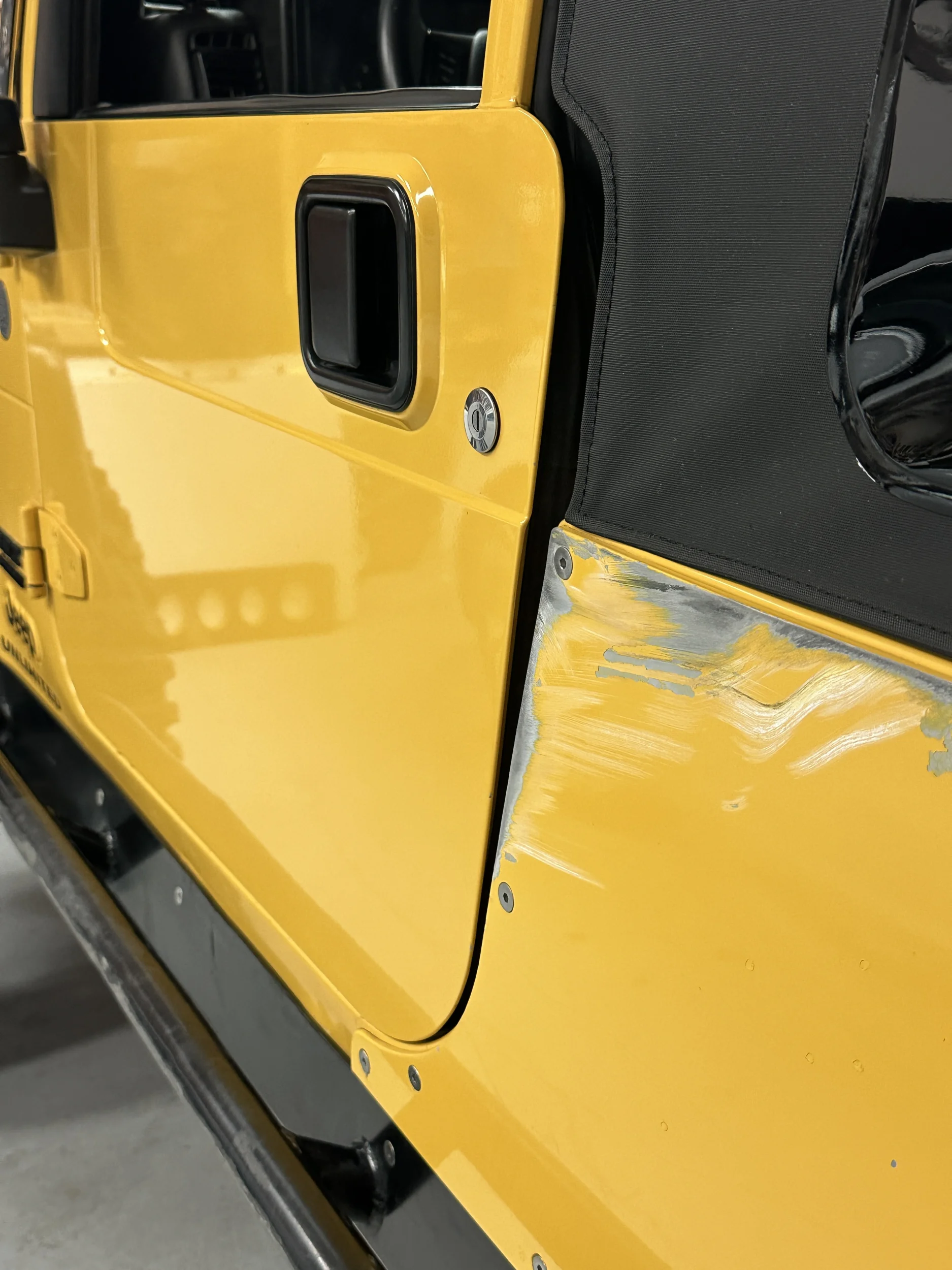

I'm also giving thought to how I will address the paint in that area, but I'm in no hurry now that is it straight again. The armor is aluminum, so no worries about rust while I decide what to do.

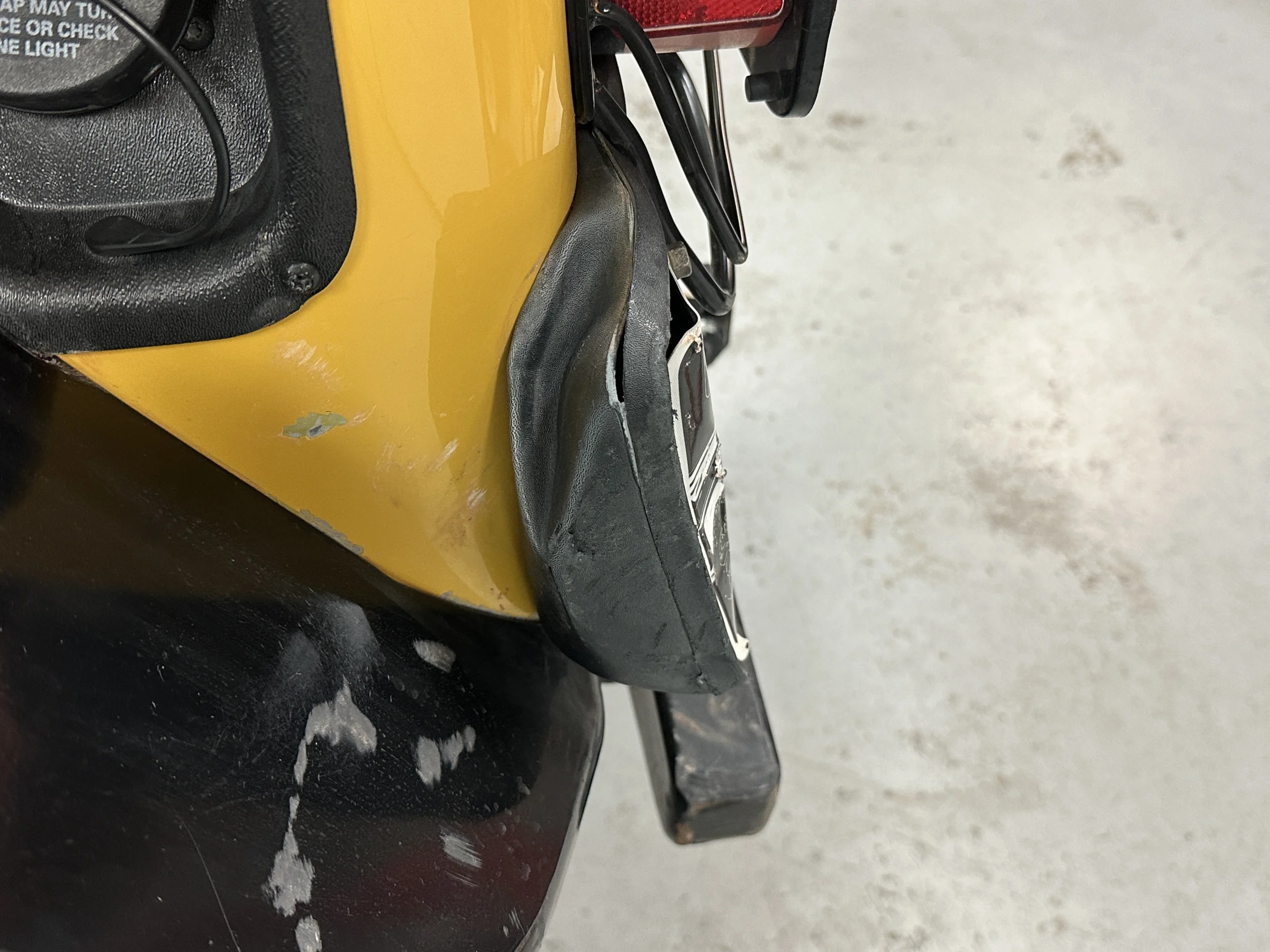

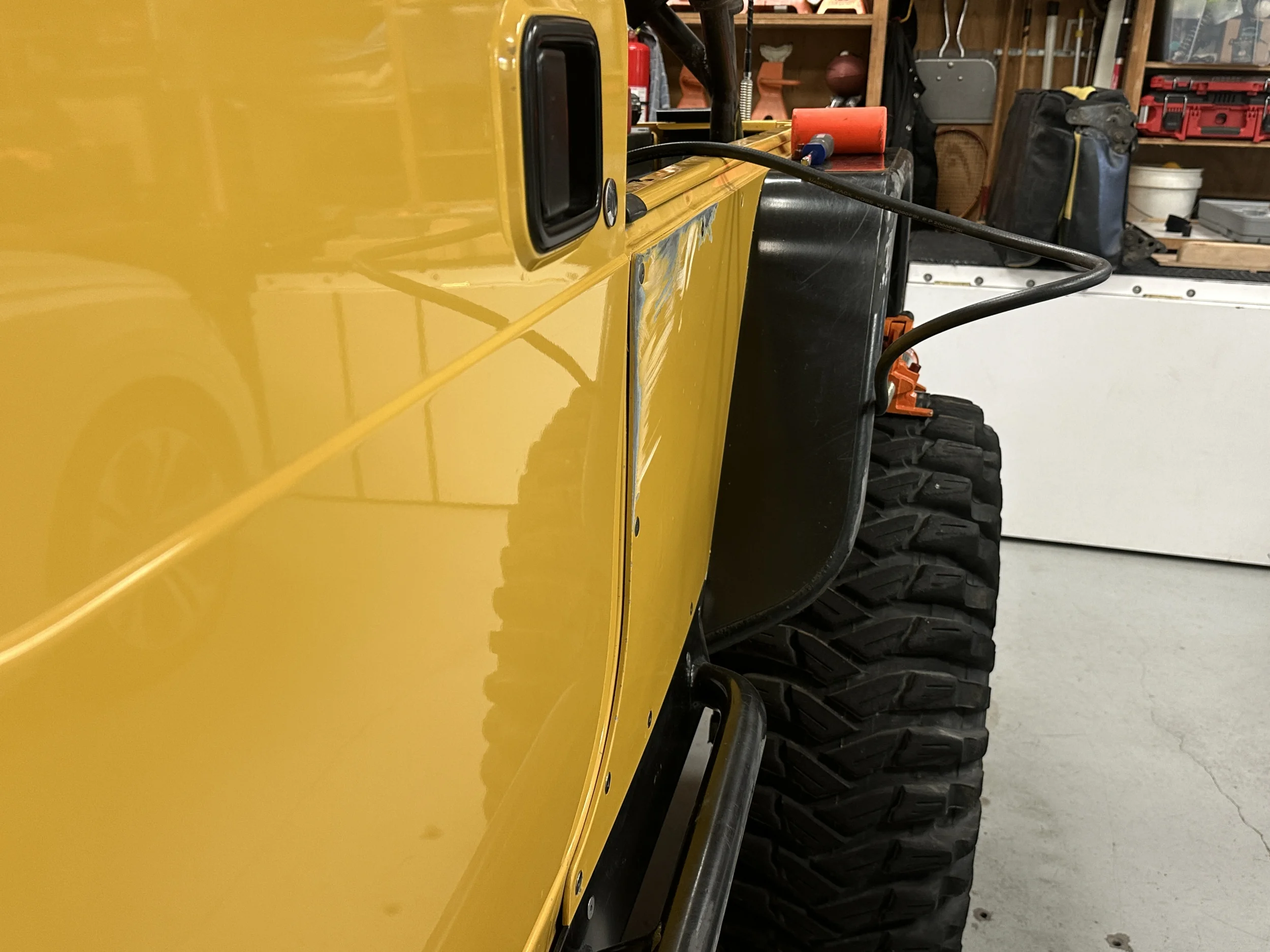

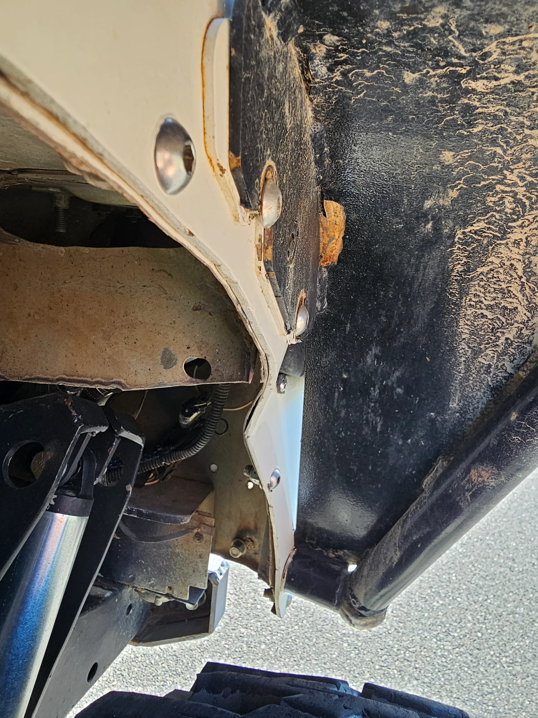

My rear fenders really do protect the body, but sometimes, well, at the expense of the body... :rolleyes:
Several very, very hard hits in Sand Hollow produced this:

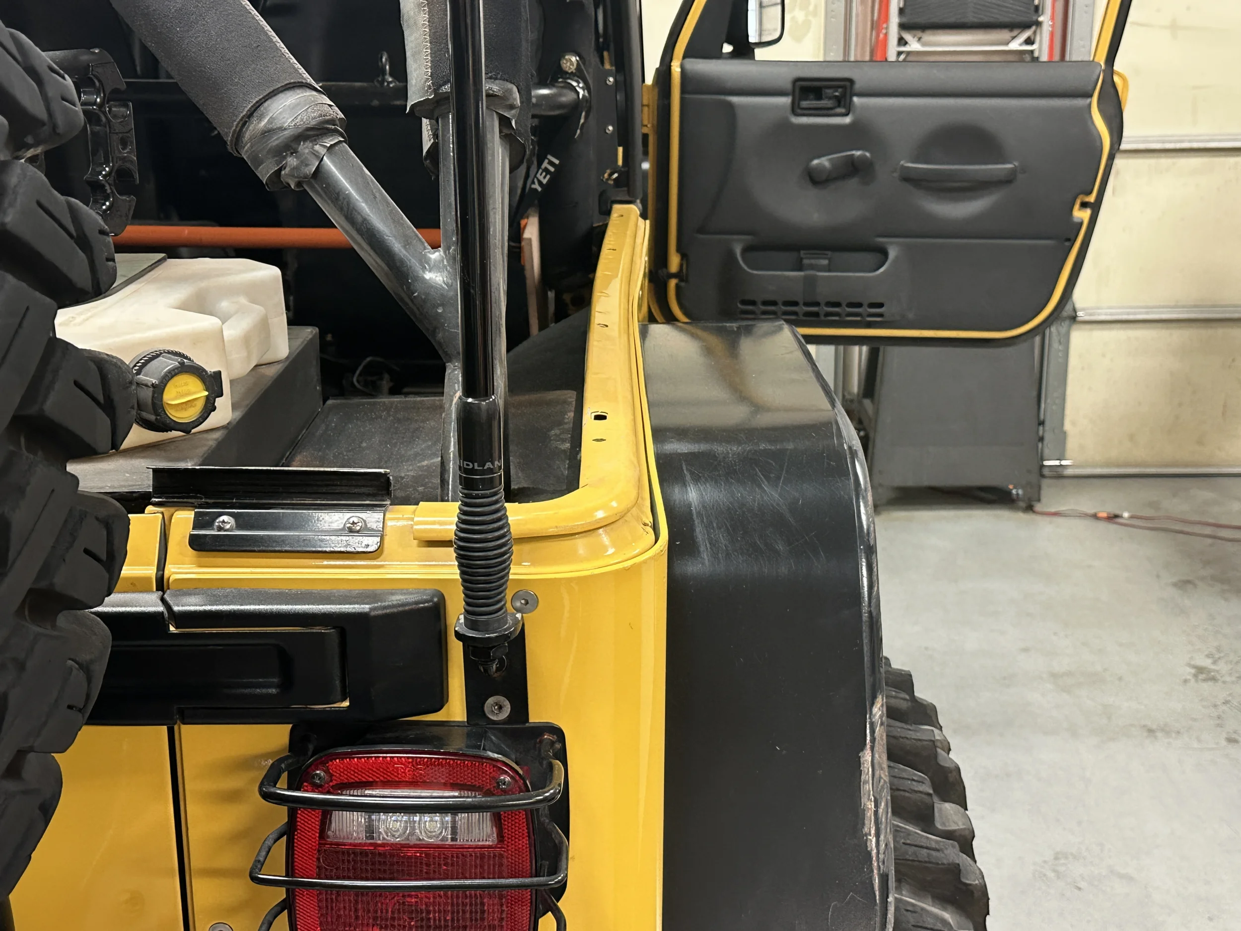

Back to the ram...
In this pic the ram is still sitting there, but under no tension. It straightened out pretty well.
This is definitely a consequence of how these fenders are mounted (and how much I beat on this thing, I guess), but on balance I absolutely like how these fenders work. They really do provide a lot of protection. I've dragged these things over many a rock over the years, taking the full weight of the rig on may occasions, and this is the first time this has occurred. I've got a few ideas on extending the cage, connecting the B and C pillars, to add some reinforcement in this area. A good project for future me.

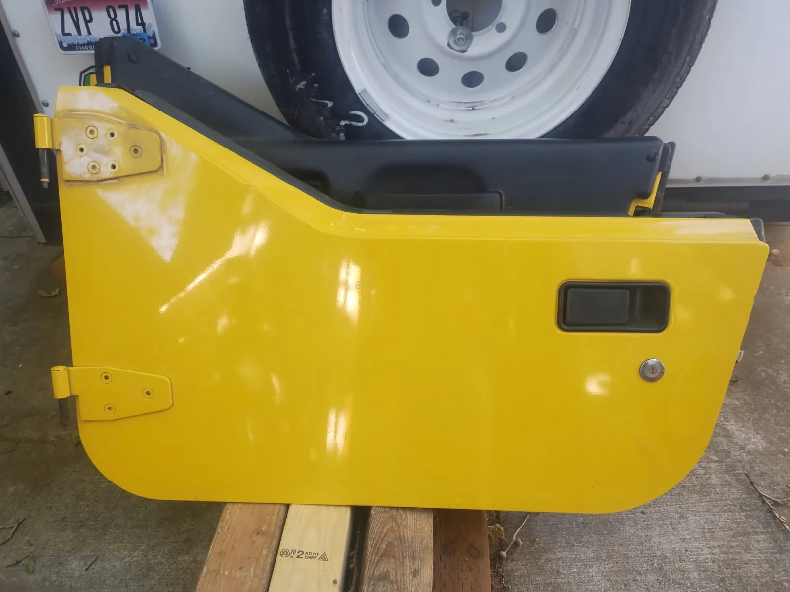

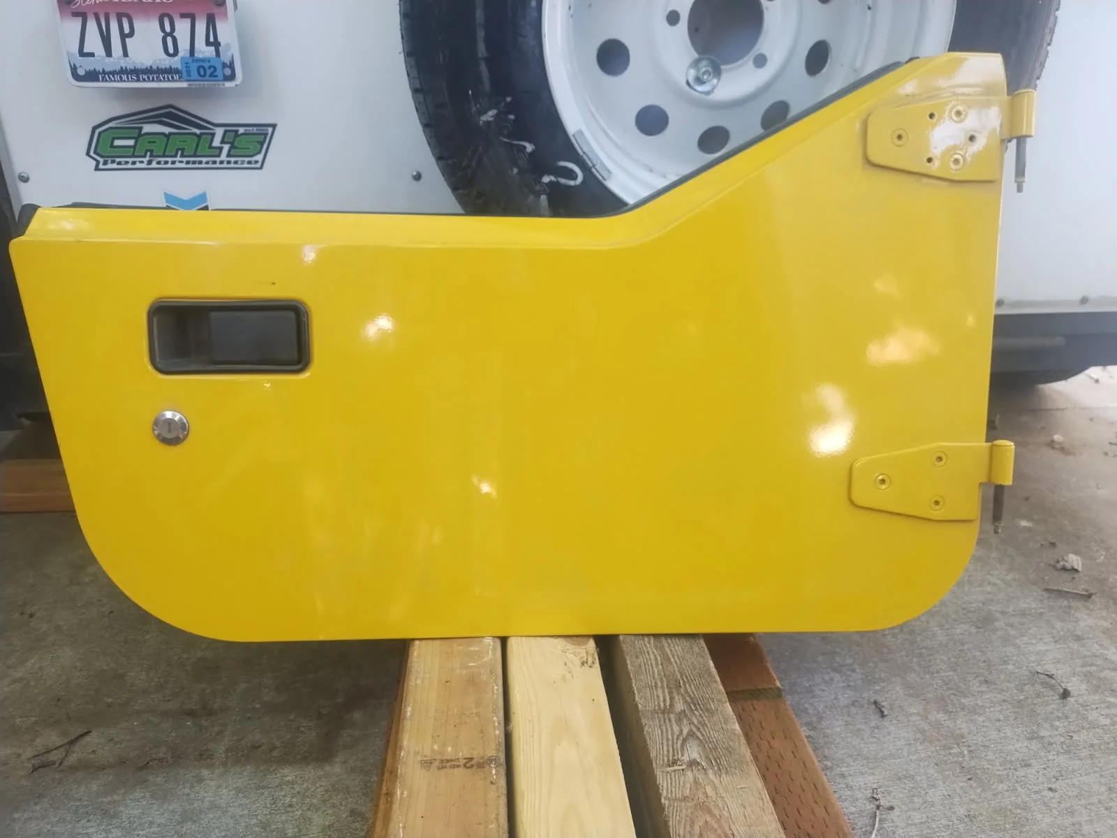

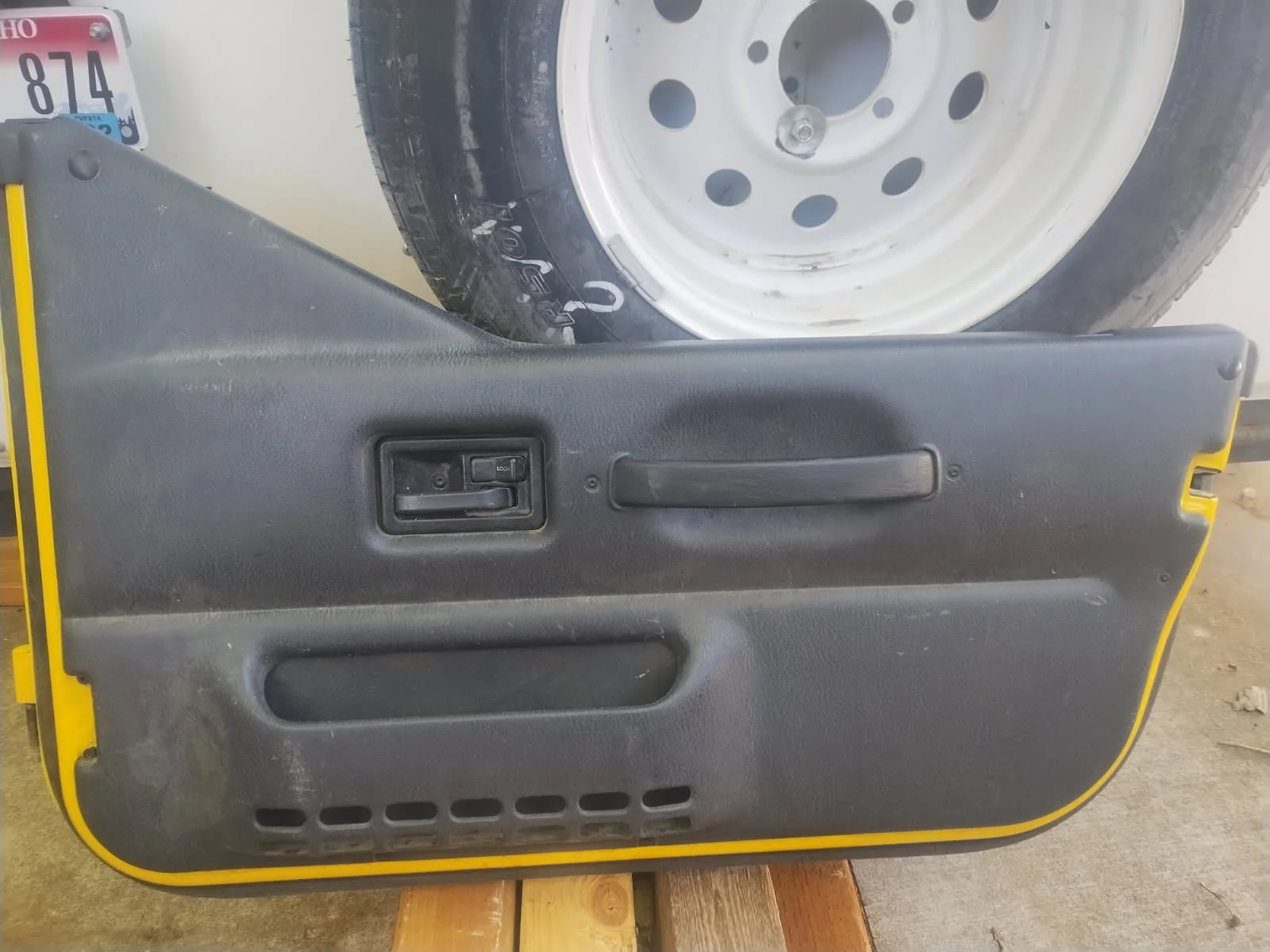

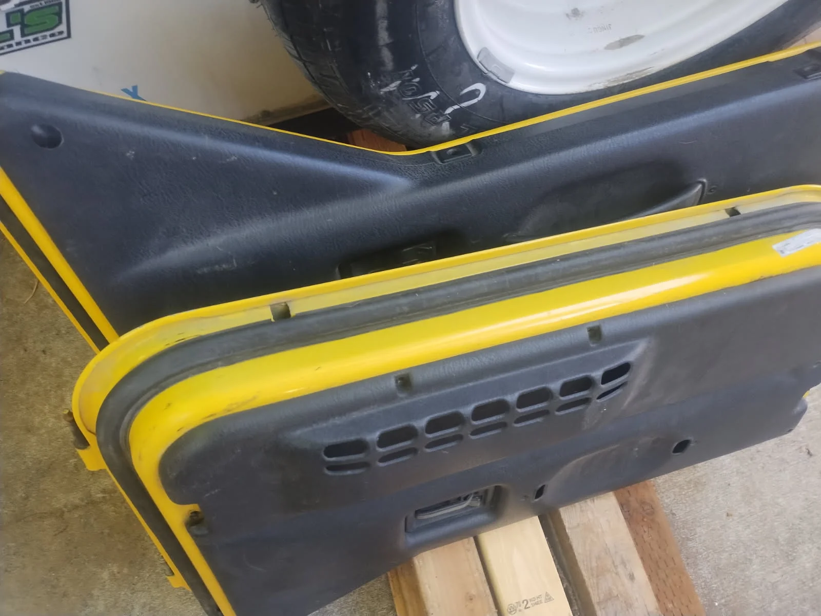

Here are a few pics of the half doors I received from the seller. These things are in really good shape:
Not having to paint these is a huge deal. I did not really expect to find a set in Yellow. But, thanks to Hugh, I'm in high cotton.

Do you think the "rub rails" would have helped protect against this or would they have bent too? I've only lightly scraped mine over the last few years, never leaned on them too hard yet.

Did you try to fix this? or just figure it wasn't bad enough to risk the paint?
Do you think the "rub rails" would have helped protect against this or would they have bent too? I only lightly scraped mine over the last few years, never leaned on them too hard yet.
Wouldn't his flares stick out more than the rub rails? So unless the rails are making contact with the rocks are they doing anything?
