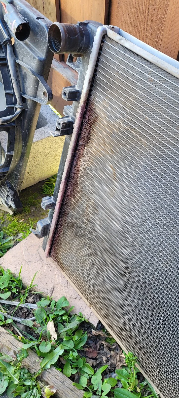

Looks like it is leaking in the bottom corner where the plastic tubes meet the radiator. It would be material failure as radiator has managed to avoid any hits. I currently struggle with higher than i like temps in the summer when on the trail or a good climb on the freeway which makes me want to go to a higher capacity aluminum. Reviews for oem or aftermarket all complain about leaks.

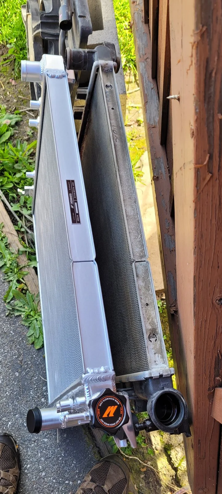

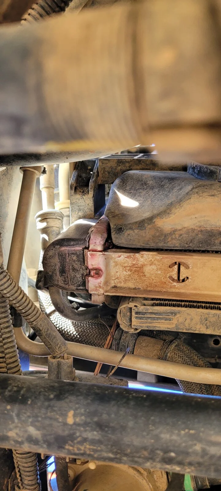

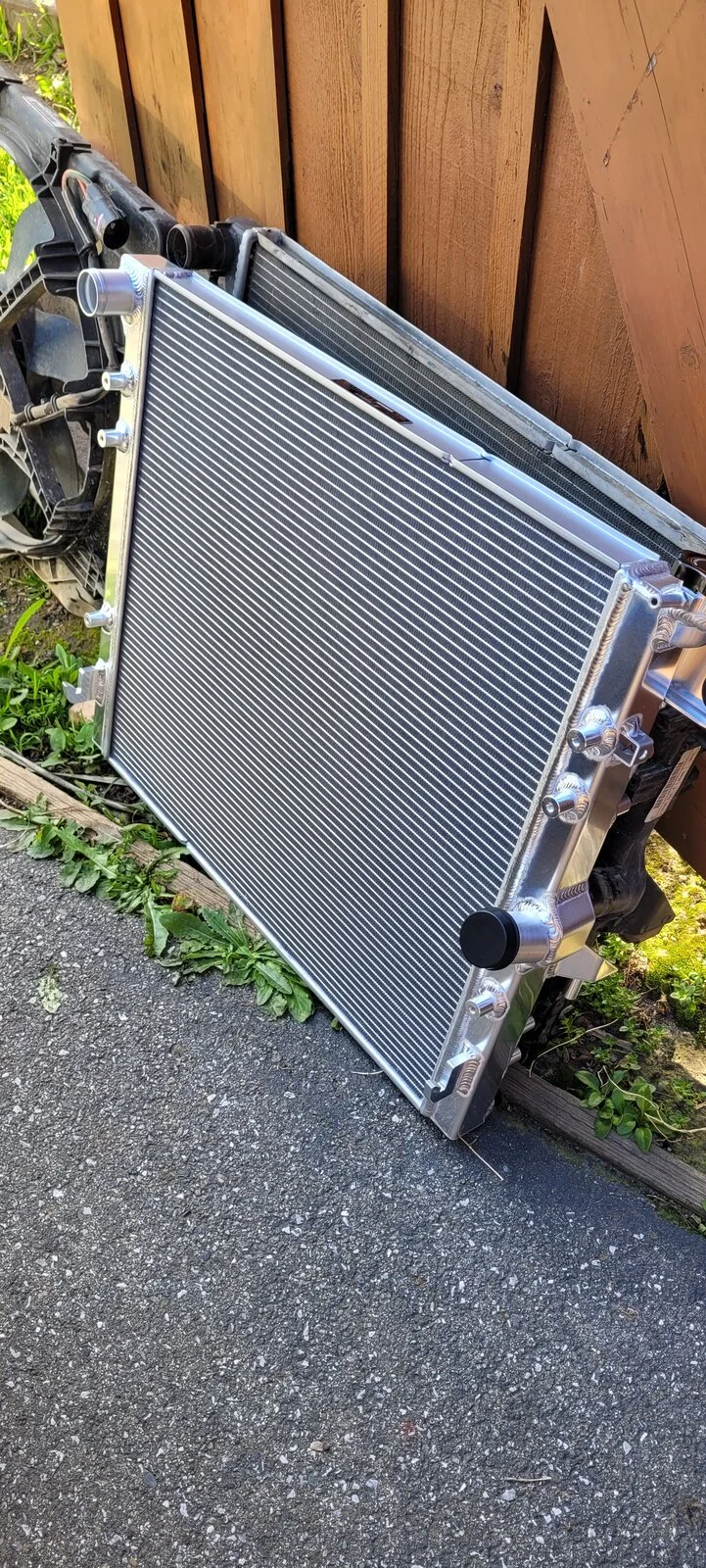

So went aluminum on the radiator ended up going with the mishimoto radiator (feel like i am breaking some unwritten rule putting Japanese parts on a jeep) install went smooth and i didn't end up with any air pockets in the cooling system this time. I highly recommend a radiator vacuum fill tool if you are swapping radiators. It worked well. Radiator dumps way more heat. Temps dropped 4-6 degrees keeping me right around 206-208 running at freeway speeds. Cool for a JK. Happy with the upgrade so far
what was hiding behind the fan shroud
New vs old
What could be seenView attachment 304309
New vs old
View attachment 304311View attachment 304312

That stock radiator was in real crappy shape! And judging by all that crust, it’s a good thing you didn’t get an OEM replacement.
That mishimoto’s pretty sweet! And it looks like it has more tubes too.
