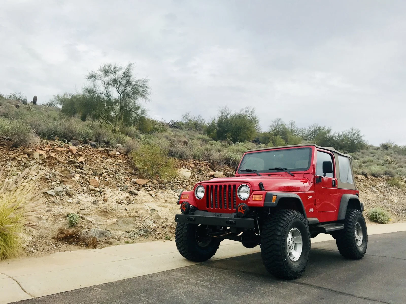

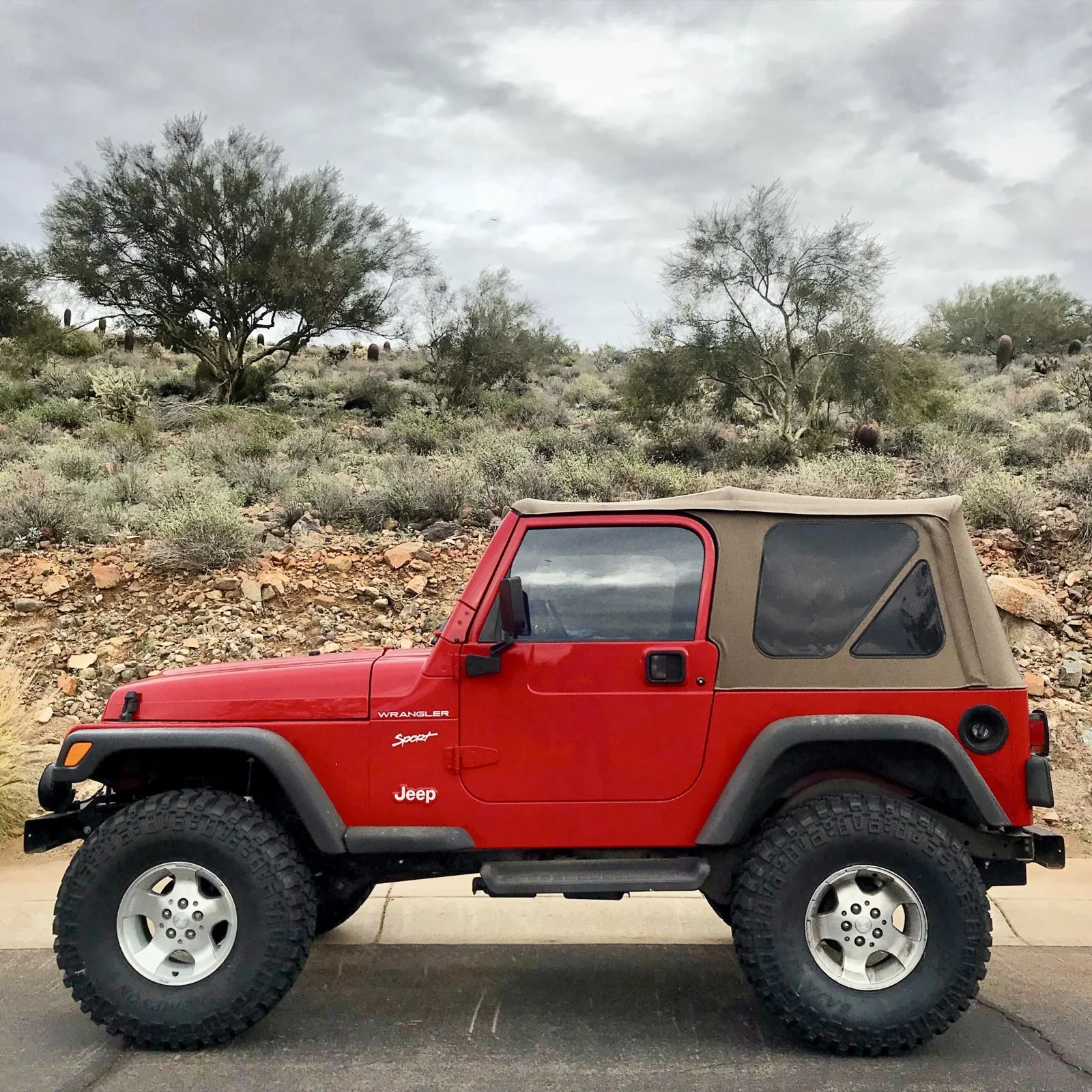

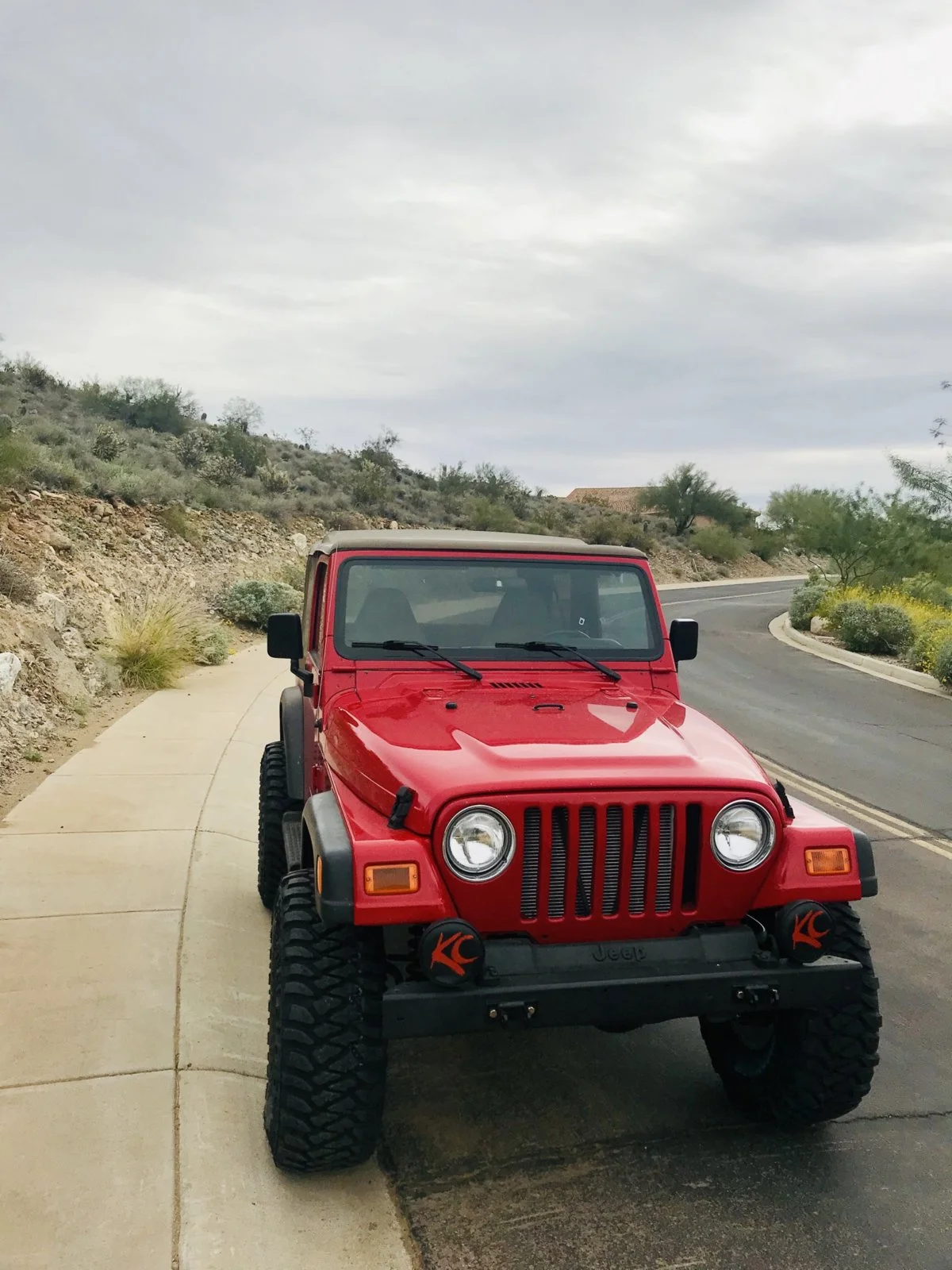

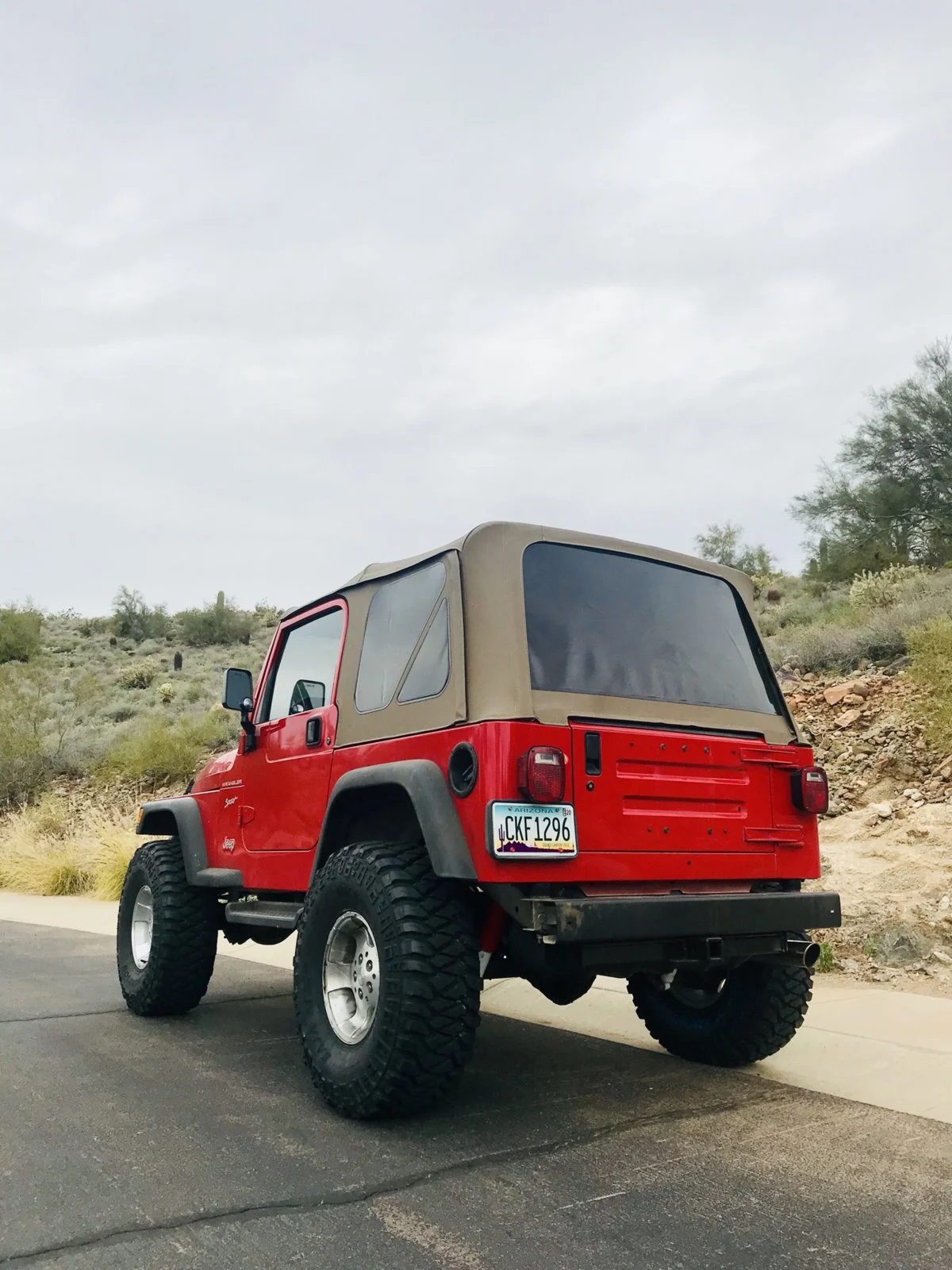

35s mounted up! I was able to find someone to snag my old set of 5 31s from me for a good chunk of money. It helped offset almost 50% of my new 35s cost! I also deleted my rear tire carrier and spare when I sold my old 31s, until I can afford a better carrier to carry a full size spare with :)
Some quick shots right after they were mounted.
79316
79317
79318
79319
And again, this is on 3” BDS suspension lift and 1.25” body lift. :)
This further cements my belief that red IS the best color on a Wrangler! I absolutely love it.
