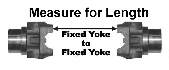

I’m back in the game for a TT. Here’s my question. When you get your SYE and DC, you have to measure from yoke to yoke and give those measurements to the folks making your DC. But how do you know what that measurement should be if you haven’t pushed your TCase up closer to the tub yet? I’m confused on the order at this juncture in the process. Also, you haven’t rotated your pinion yet, so how do you know exactly where it will be so you can get the right measurement? This one might be close enough to not make a difference, but the other one.???

You measure from fixed yoke to fixed yoke, as mentioned here (under the TJ section):
http://www.4xshaft.com
Don't order the driveshaft until the transferase is tucked, and the vehicle is on the ground (without the rear driveshaft installed). Then take your measurements and you should be good to go.

What do you do when you already have a SYE and DCDS and haven't tucked yet? Is there enough length in your current DS that you can still use it after the TT? How much of a TT is acceptable before you're buying a new drive shaft. Good Q's @JMT .

So you go ahead and tuck, pull the rear cv and then just drive in 4H till you measure and get it on order?

When I spoke to Tom Wood about that on the phone when I was doing mine, he said that if I was tucking the transfer case I should be fine with the DC driveshaft I already have. The slip joint on the driveshaft should be dead center when the vehicle is sitting on the ground, but he had mentioned it it was a little off center, that would be fine. If it's near the end of it's travel though, then you have issues.
I haven't done a tummy tuck yet though, so I don't know what will happen when I end up doing one! Hopefully I can still reuse my DC driveshaft.
