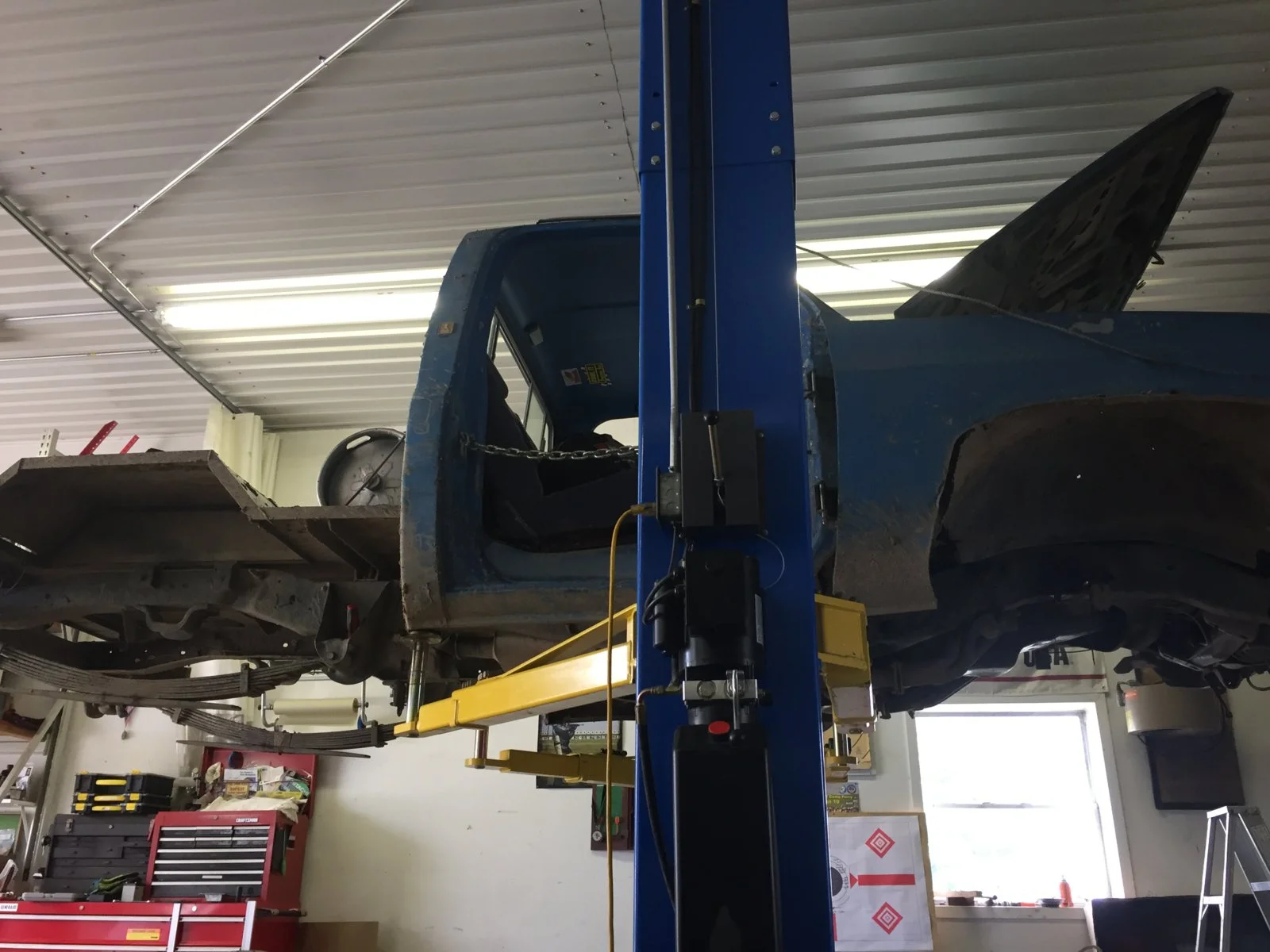

My son has the hoist tied up with his mud truck axle swap for the time being.
