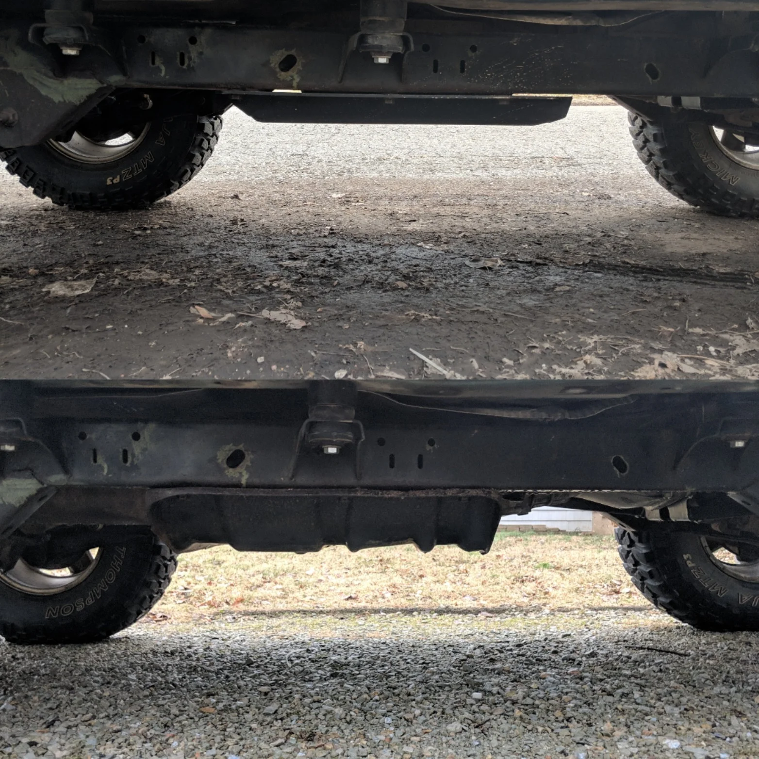

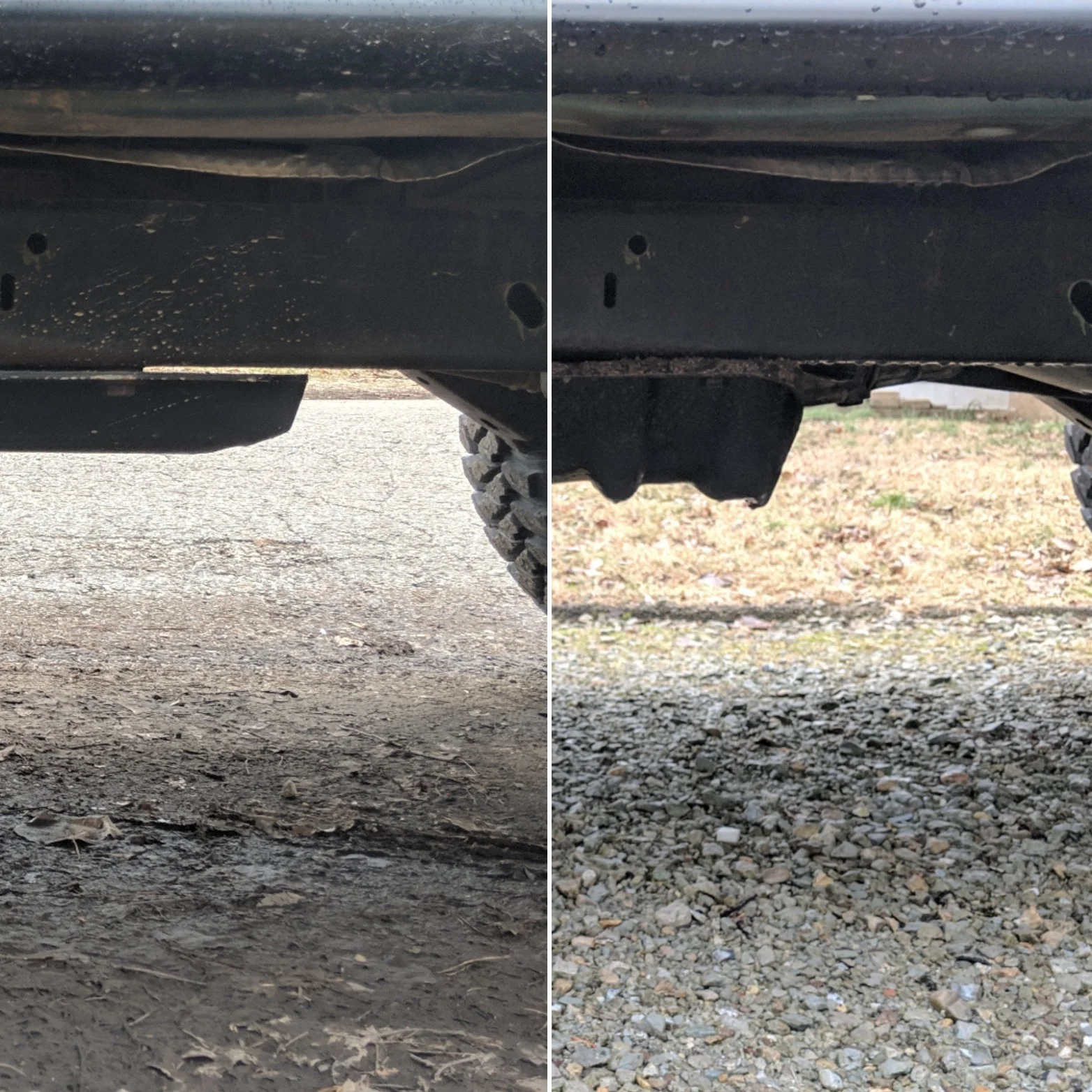

Got the tummy tuck installed on the Rubicon. No major hiccups with this set up that we found. Didn't have to do any tub clearancing. Figured I'd share for those looking for a semi-cost friendly TT. Already had a 1" MML & 1.25 BL installed on the TJ.
-UCF steel extra clearance skid
-Tom Woods Drive shaft
-Savvy Cable Shifter
-Core 4x4 Tier 2 upper rear control arms
78892
A few notes, added a washer for cleaning ease and give a space for moisture to clear. Trimmed the rear lower spring perches due to interference with the shock, also gives a place to drain; the perches were caked with mud.
78893
Real happy that the shovel has been removed and with the clearance gained. Also got the Savvy gas tank skid installed at the same time, significant clearance increase from the OEM, that skid is awesome.
