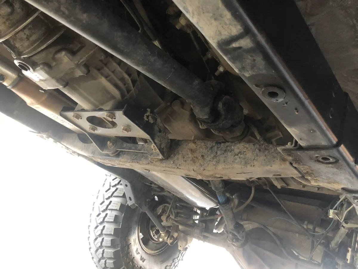

As I was reading back through this I was wondering if anyone makes the TC "cross member support" as a bolt on. Seems like removing the skid plate would be easier. I saw someone mention creating their own but thought they might be a production item now.
Do you mean something similar to the Savvy solution? Having the skid plate as a removable piece as opposed to a necessary transmission mount has been invaluable to me recently. I think genright makes something similar but it isn’t bolt on like savvy IIRC.
I thought the Savvy was only a skid I didn't realize it was a 2 piece. Thanks

It is a cross member and skid system. It allows for you to take the skid off and still drive around for as long as you’d like. I’ve had mine off for over a week as I haven’t felt the need to bolt the skid back up yet. Really convenient for cleaning and for working on the exhaust or anything else up there.
Perfect, exactly what I am looking for. I must be on the wrong place on the Savvy site. I was looking at this one and it is out of stock.

That’s the correct thing to order if you have a 97-02. It takes some time for savvy to get things shipping out to you, but it is well worth the wait. My underarmor is awesome. Great clearance and an easy to install design.
