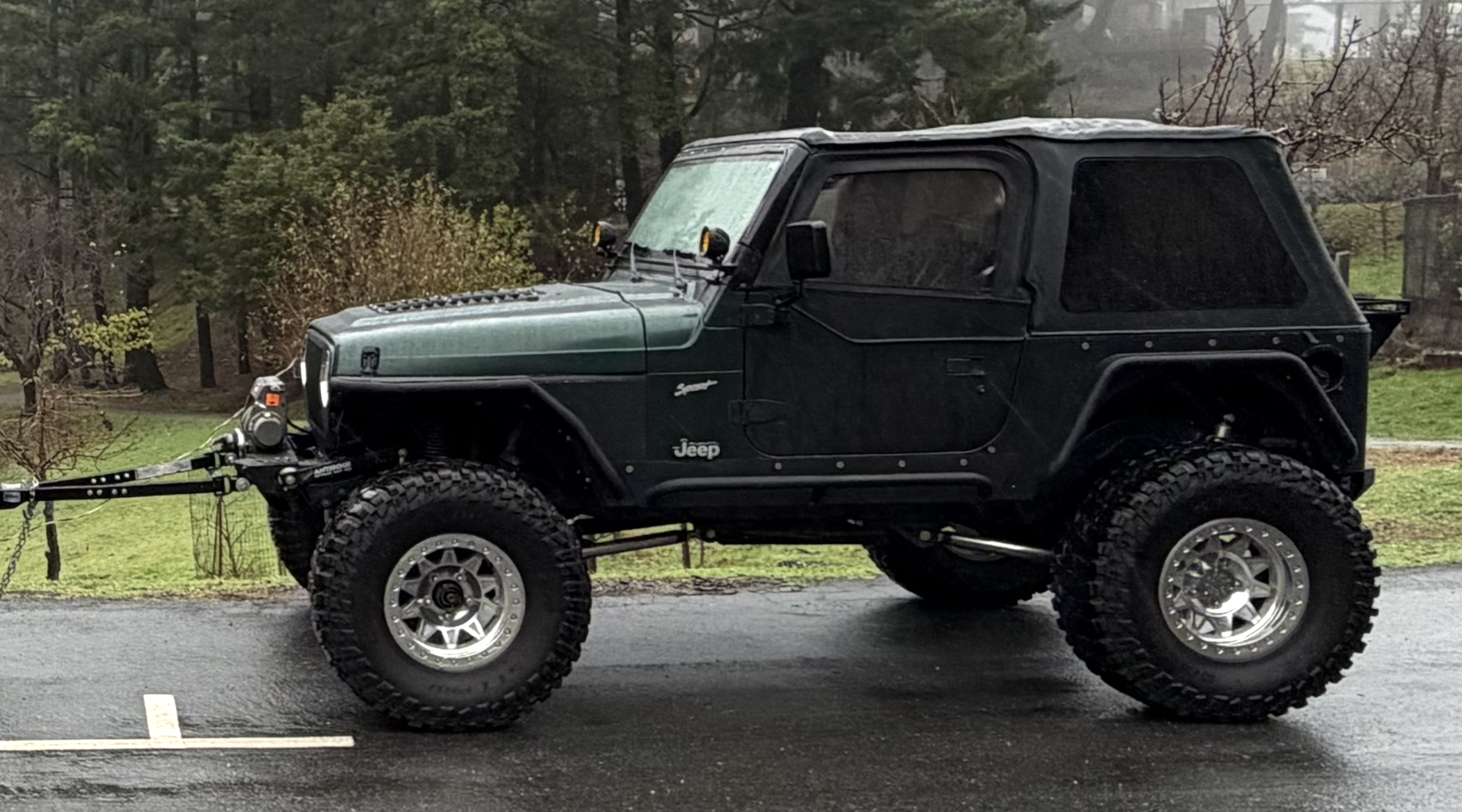

Is that Jerry b?
I thought he was on short arms?
This is the one he has now.

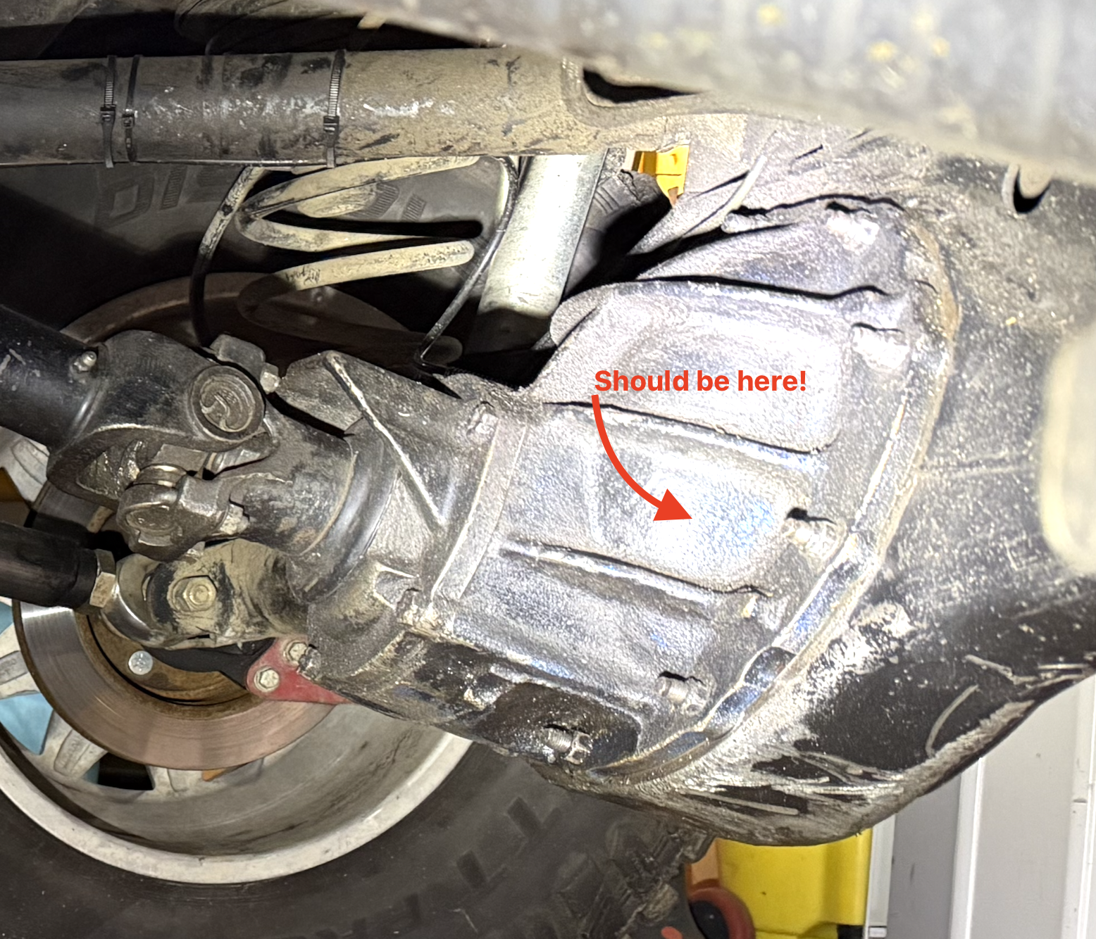

Well catching back up here! Had a chat with Del at PartsMike and managed to get a list together and he spent a bunch of time on the phone with me going over the axles and making sure we identified the set up correctly - so a huge thanks and shout out there. Spindles, Hubs, Stub Shafts, Bearings, Seals - all hopefully arrive tomorrow and I can start the rebuild. Has been a fun time so far getting this thing apart and getting familiar with how it all functions. Looking forward to some trail time soon! Got a bonus bit of news that I'm not crazy... there really is no fill port on my Ford 9" rear diff... Thought I was going crazy. If anyone knows a solid way to check diff fluid levels easily, without a fill port, I'd love to hear it!

I’ve only seen a few 9” rears this close but they all have had fill ports.

Google tells me that no fill plug is because Ford moved the fill hole from the housing to the center section in the late 60s, so if you put an early center section in a later housing, you end up with no fill hole. That sucks. 🤷‍♂️

OK so if there isn't a fill port on the drop out section is there something on the axle housing itself? If not how are you supposed to fill your axle? As Sab said from what I found also it was dropped on some housings... You're supposed to fill it by pulling an axle... Which sound weird to me.
Also found that a lot of people suggest drilling and taping a fill hole on center sections that don't have one.
Yep - that's what I saw, too. How convenient!
Saw that, too. Along with welding a bung on, but that's not so easy if it's a cast iron.
