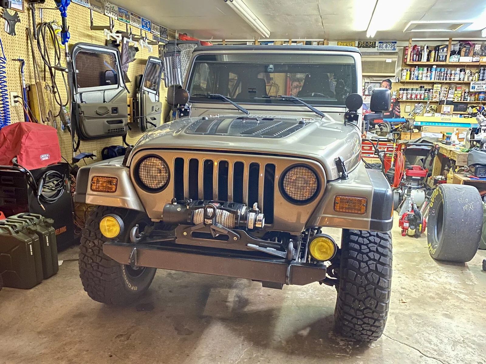

hello,
what company is your front bumper made by? I am looking to replace my heavy body armor bumper with something more minimal and this one looks perfect. Thanks.
It’s made by LoD. No idea what that stands for though.

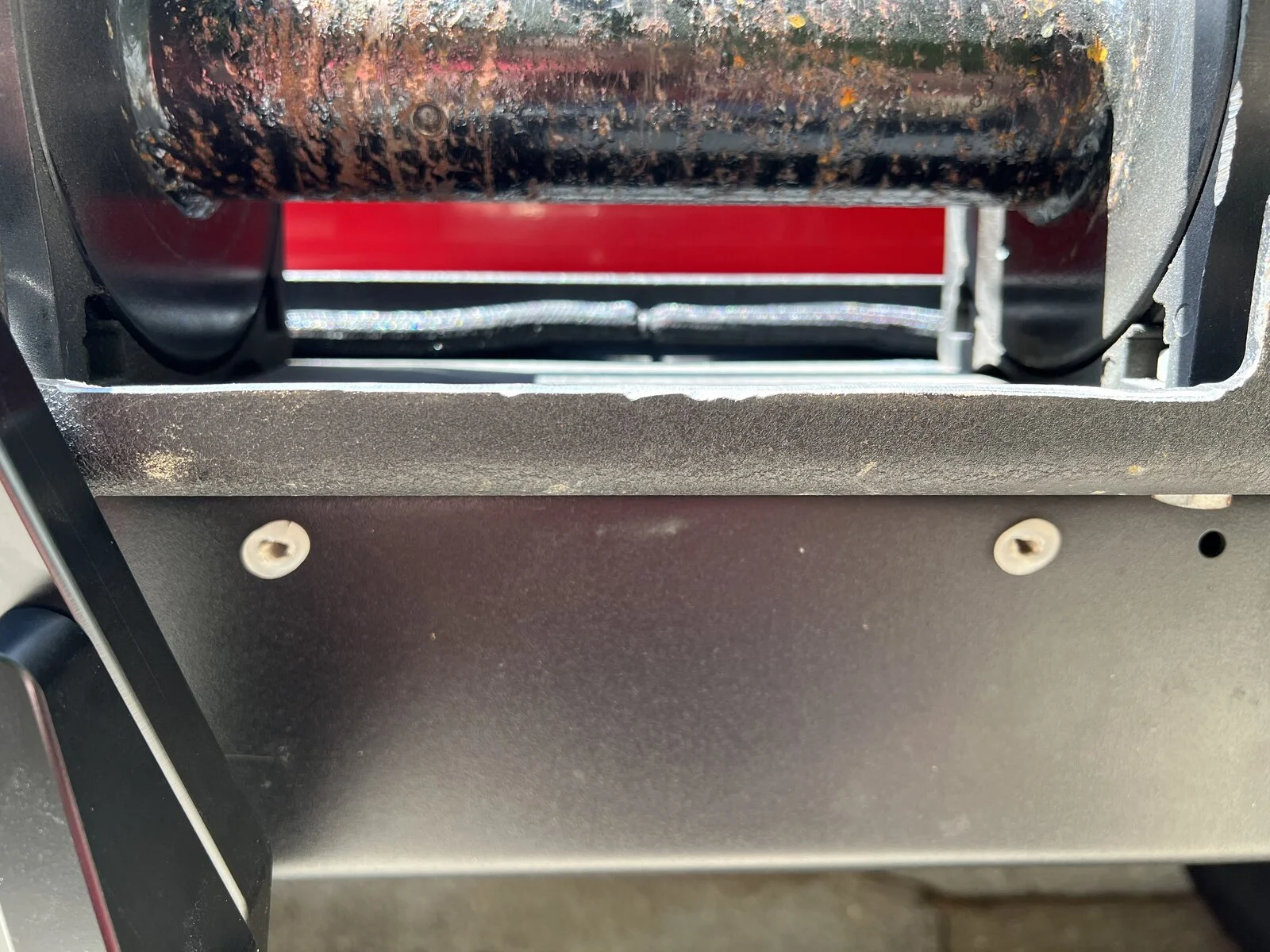

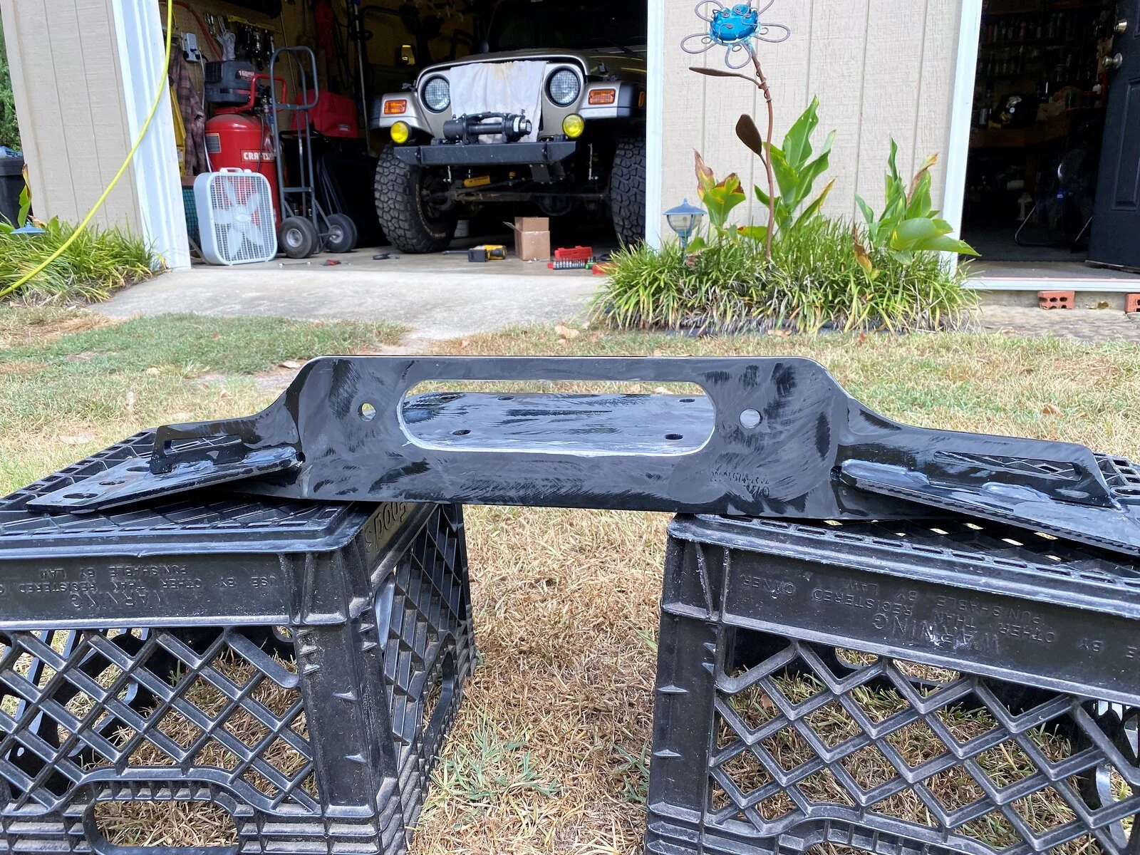

After test fitting yesterday, I realized the bottom of my winchplate is too high and its over the inside score marks. Any suggestions for a new winchplate? I gave it s few passes with the angle grinder but that didn’t seem to be the best choice.
Do you have room to take more off? If you can, I would. I had to enlarge the entire opening on my smittybilt winch plate when I first put my regular TRE fairlead on a year of two ago and it worked well. Blaine's ST fairlead cleared everything also.
Looks like I need ~9mm of clearance and I’ve got 20mm more I can take off. My main concern was I don’t think my little Ryobi angle grinder is the right tool for the job. I’m gonna call the local Jeep shop and see if they can do it for me.
Reactions: MountaineerTom
I used my Dewalt 20v grinder with a cutting disk to get the bulk of it, then used some flap disc's to smooth it all out. Mine was enclosed all around and was a little bit of a headache, especially the corners, but didn't cost me much more than time and some cutting disc/flap disc's.
