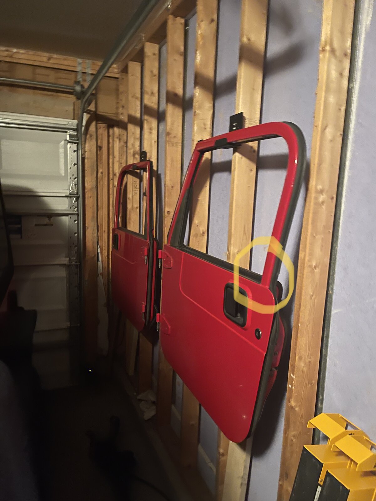

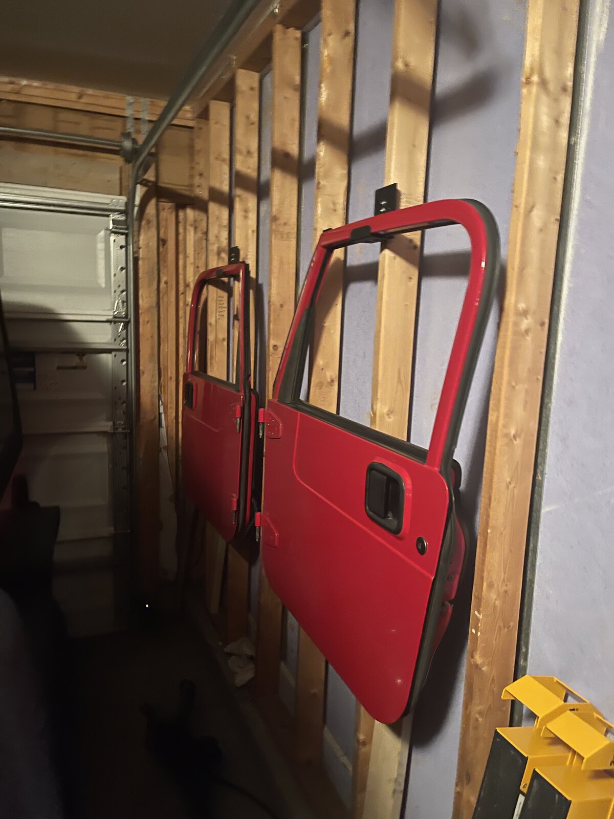

Got some mounts for my full doors in the mail today. Its 98 degrees here and the doors were just sitting in garage. Got them off the ground this morning and freed up a bit more space.

Which wall mounts did you go with? I need to find a patch of wall for mine as well.
Door Hanger Removable Wall-Mounted Door storage Rack Bracket for All Jeep Wrangler CJ YJ TJ LJ JK JKU JL 2 Pack https://www.amazon.com/dp/B087P6KV29/?tag=wranglerorg-20
I drilled 2 new holes in since I only had vertical studs to mount too.

Be careful hanging your doors like that. Full doors are heavy and like to crack at the weld where the upper frame ties in to the lower door. Preferably you want to hang by the hinges.
Is that real? How common is this? I specifically went with these over building mounts for door hinges.
I can redo if I absolutely need to. Damn it. I want list of projects to get smaller not longer
In my experience, yes. And I’ve read about others as well. Maybe some others will chime in if I’m being alarmist or not. I do know the doors are weak in that area and will crack from repeated shutting the door without door surrounds on. I would err on the side of caution.
Well I shut the door every day without surrounds on. I’m doing everything wrong lol
