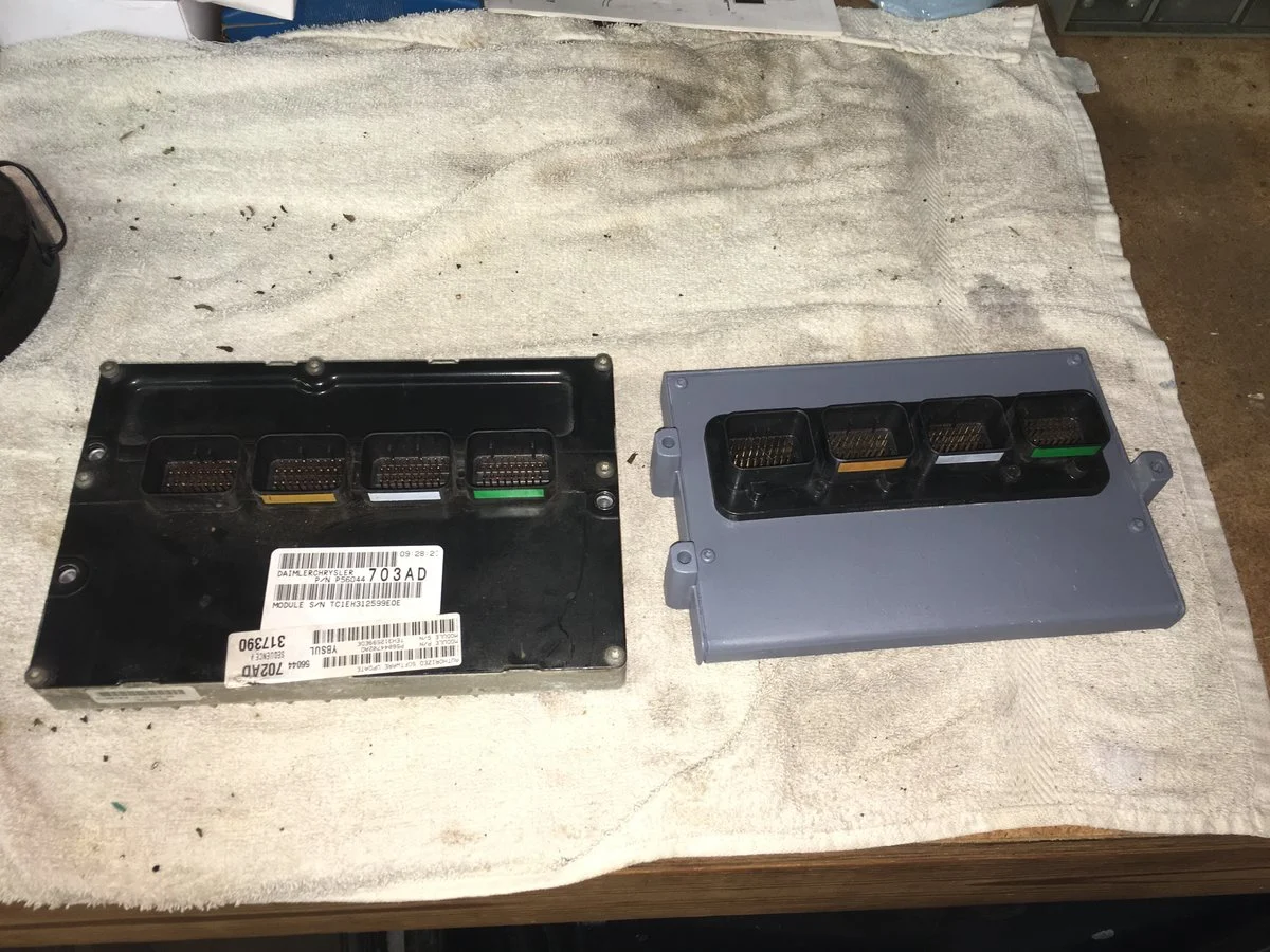

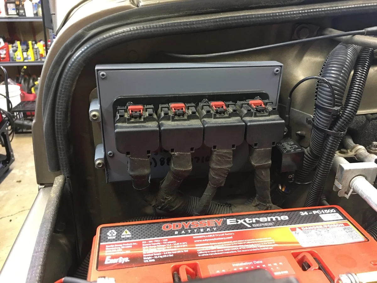

Ordered from @Wranglerfix (Mark) on Tuesday and received on Thursday. Installed it today. I’ve only put 15 miles on it so far just running out to get some oil and filter for an oil change and got some lunch.
So far, so good. Smooth shifting. No codes.
Thank you.Add another satisfied customer of Mark and Wranglerfix for a 2005 automatic LJ.
