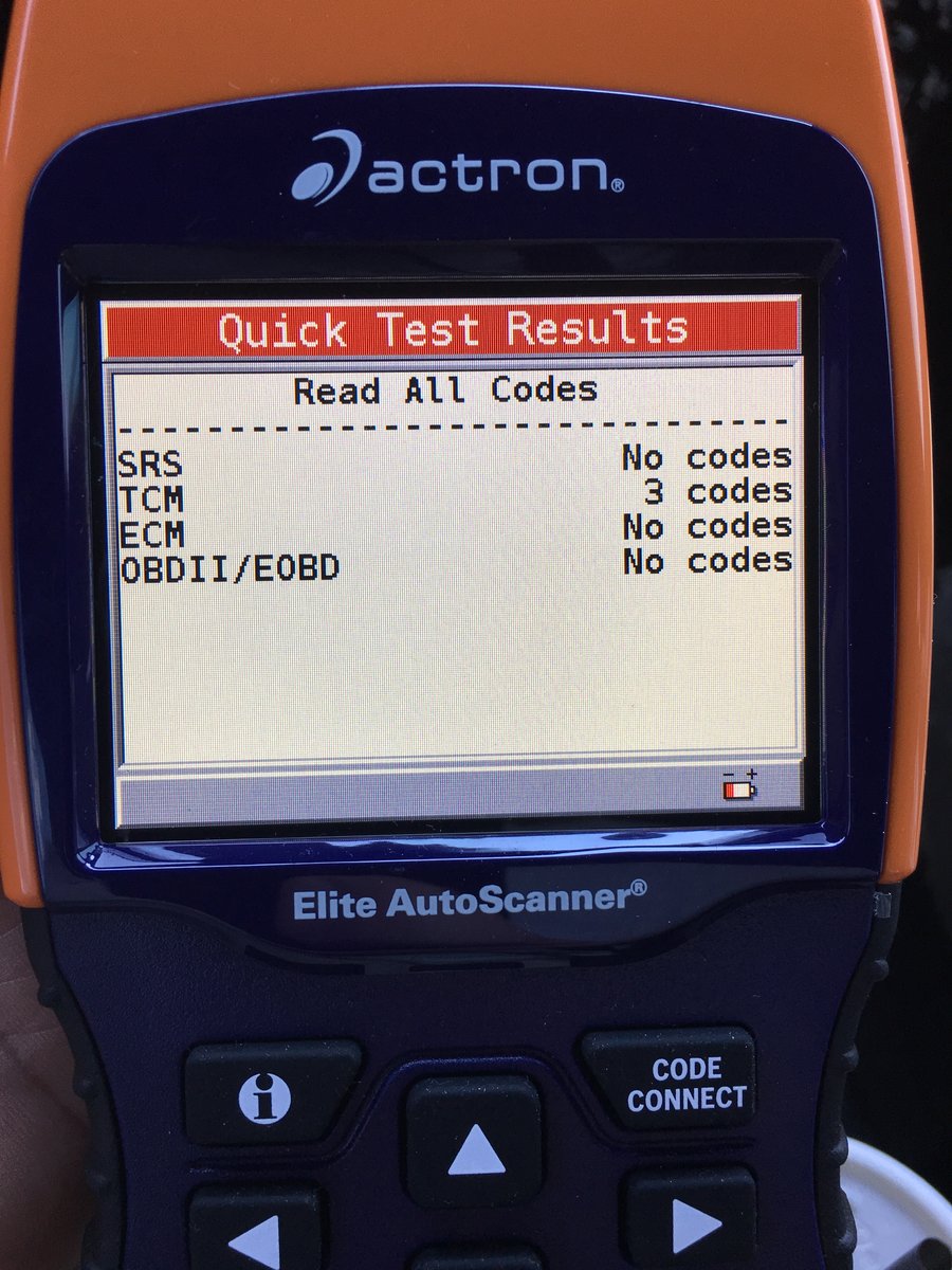

Check for error codes before you buy. You’ll need a scanner that reads transmission codes. If you see P0218 or P0714, the PCM needs to be replaced.I know I've just joined, am potentially purchasing an 05 wrangler with an auto trans, and am wary about this PCM issue surfacing in the Jeep...
