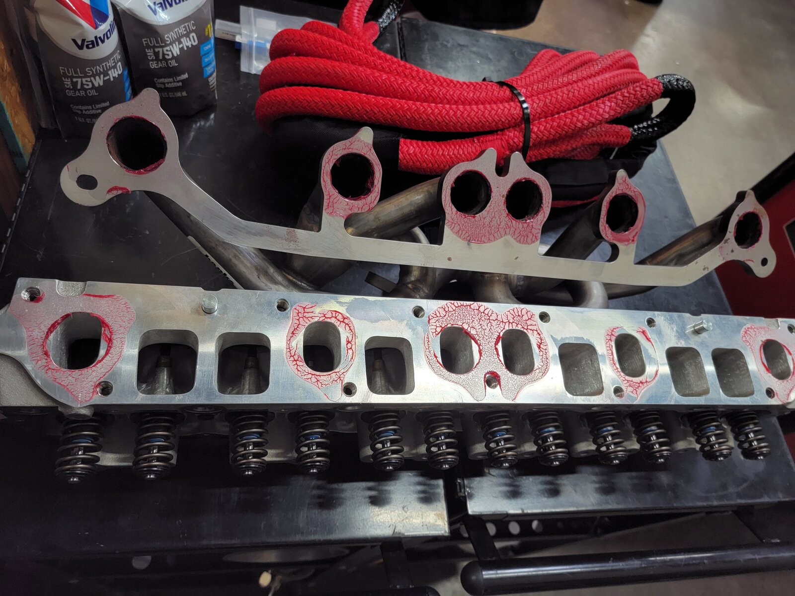

Are you going to be porting the intake and exhaust?
The head is already ported. I bought the Banks 51306 Torque Tube header system for the exhaust. The intake manifold I may just clean up a bit and port match a little. Honestly not really huge gains to be had on the intake side of a turbo engine.

He's got an aftermarket header.
On the intake though, did you get a port matched intake from Russ?
I did not get an intake done. I figured I will probably just port match it and slap it on. The design is pretty crap already. I'm not convinced that smoothing and blending it is going to result in any significant gains with the turbo. Have you seen that Newcomer video where he changes all the intakes and throttle bodies?
On the intake, yeah, just port matching was all I was talking about. He did one up for me for not much to go with the head. I don't think there's much to be gained opening up the runners. I did have him open up the throttle body opening though to match my 68mm TB. Not much of a concern on a turbo setup though.
