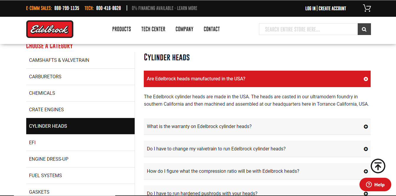

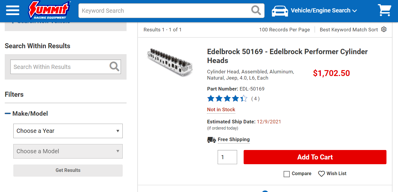

Ah okay, I couldn't remember what issues you had. I agree the issues with cams is probably not related to it being a stroker. My main concerns are the pistons and rods. Mostly pistons. I can hear a bit of top end noise when it's cold already. It sounds like piston slap, and goes away when warm, but I wonder if I may have cracked a skirt at some point. Really I just want it to be overbuilt as I want to be able to take it on some longer trips and have it be reliable. I looked at the Edelbrock head, and almost bought one. Having to change the exhaust manifolds turned me off a bit as I don't want to remake all those parts for the up-pipe. Then I went to buy one about a year ago and they are out of stock everywhere. I emailed Edelbrock and they don't know when or if more will be released.

I think so, yeah. Gonna call Edelbrock one of these days and ask too. I'd really like a bare head to send to Russ Pottenger to P&P.
Please do, maybe if a few of us keep contacting them they will move them up the list.

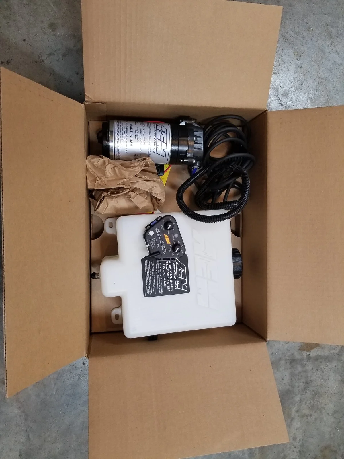

Methanol kit showed up today. It should be a good way to get a little more out of it without pushing too much harder. I'm going to run some 30% methanol washer fluid. Then I can tee off for the washer pump and nozzles. I bought an inline washer pump to tee off with.
