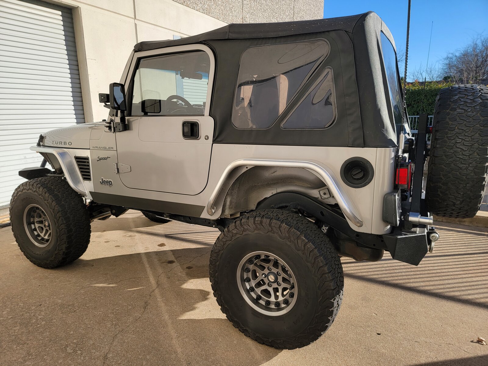

I picked up a set of Hutchinson Rock Monster wheels this weekend. A local guy had them on marketplace and they were priced very reasonably. I really wanted the 17s but the 15s have better backspacing imo and are lighter. They came with some half tread 35" KO2s that actually ride pretty nice. Much better than the load range E Radar road wobblers I had on there before. Now I just need to pick out some new rubber. I didn't really notice any loss of power or acceleration going from those 17" XDs with the 33" Radars to the 15" Rock Monsters with the 35" KO2s. Must be that 360ftlb of torque working.

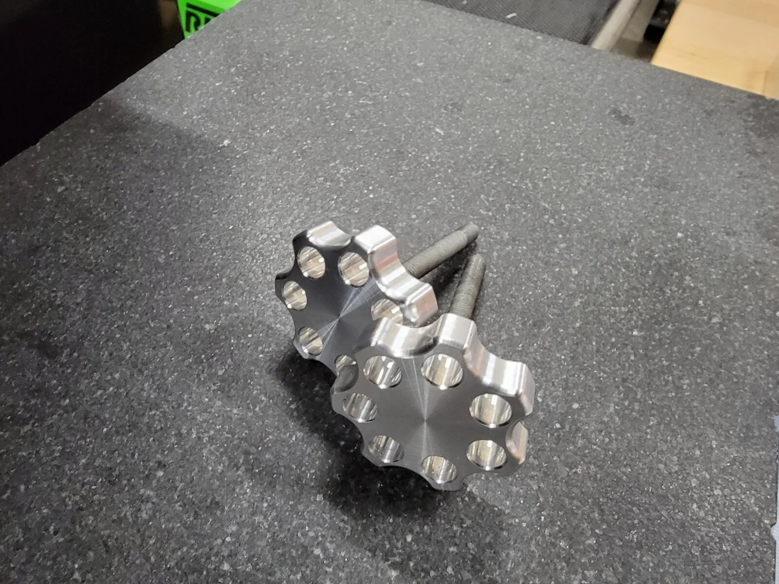

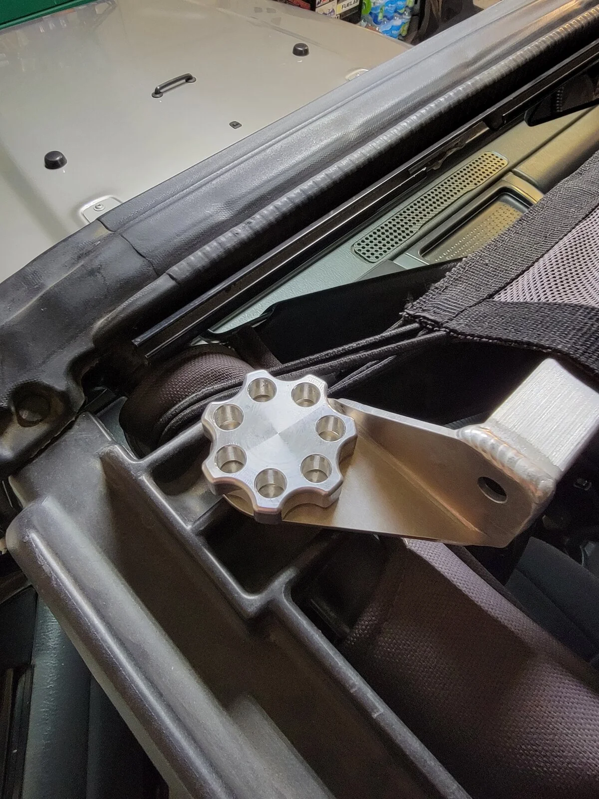

I was working on the radio mount bar I made today and quickly realized that the stock hand screws that hold the door surrounds on weren't long enough to go through the radio mount and still grab threads. Also when I tried to tighten one of them the plastic head popped off. I decided to cut some new knobs out of aluminum and use some all-thread to make custom length screws. I think they turned out pretty good and they definitely hold a lot tighter than the plastic ones.
