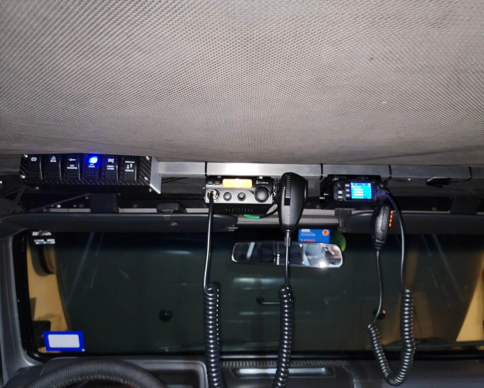

Still hoping for pics of the DC10 cockpit 🙂

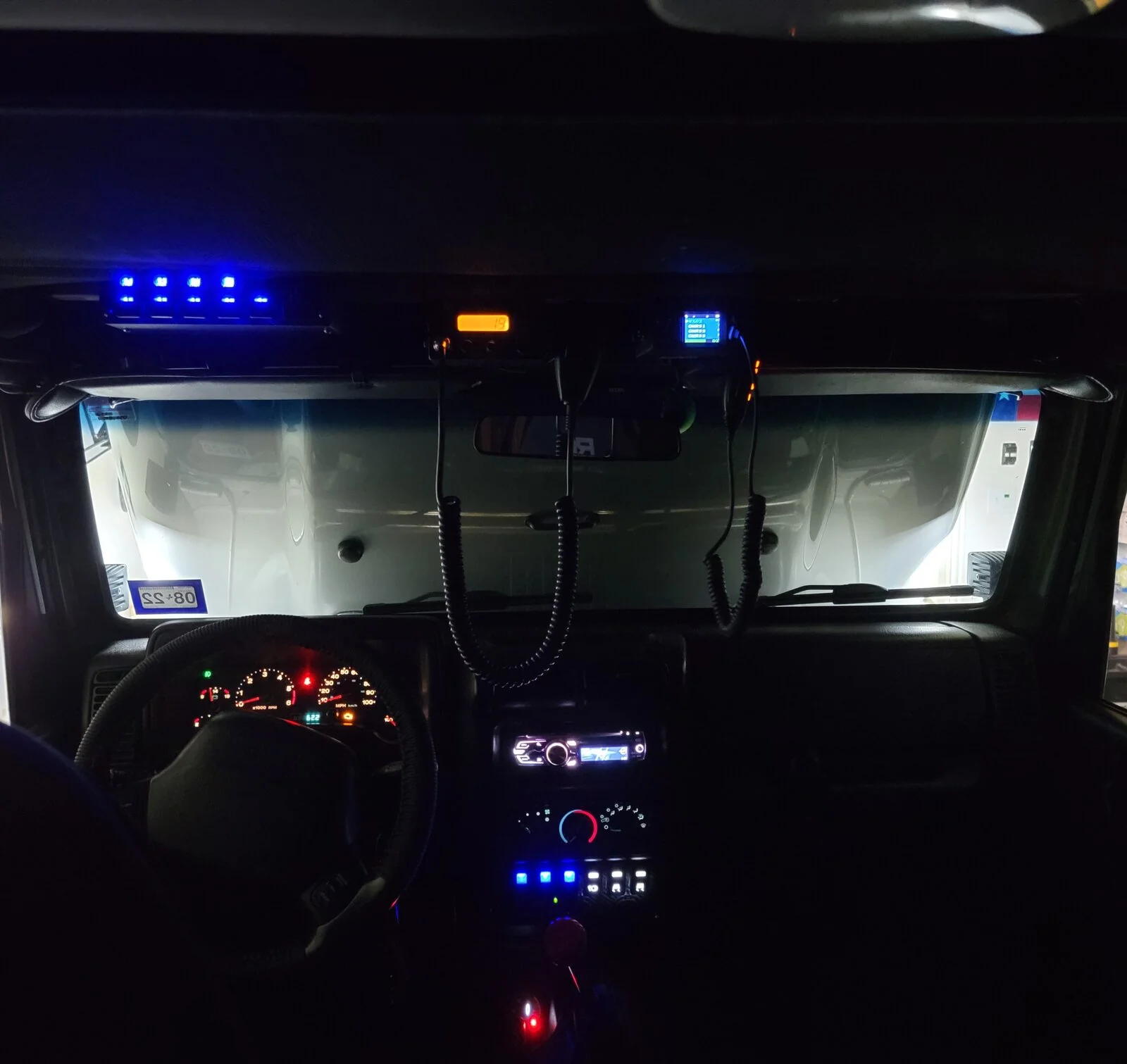

You asked for it 🤣🤣

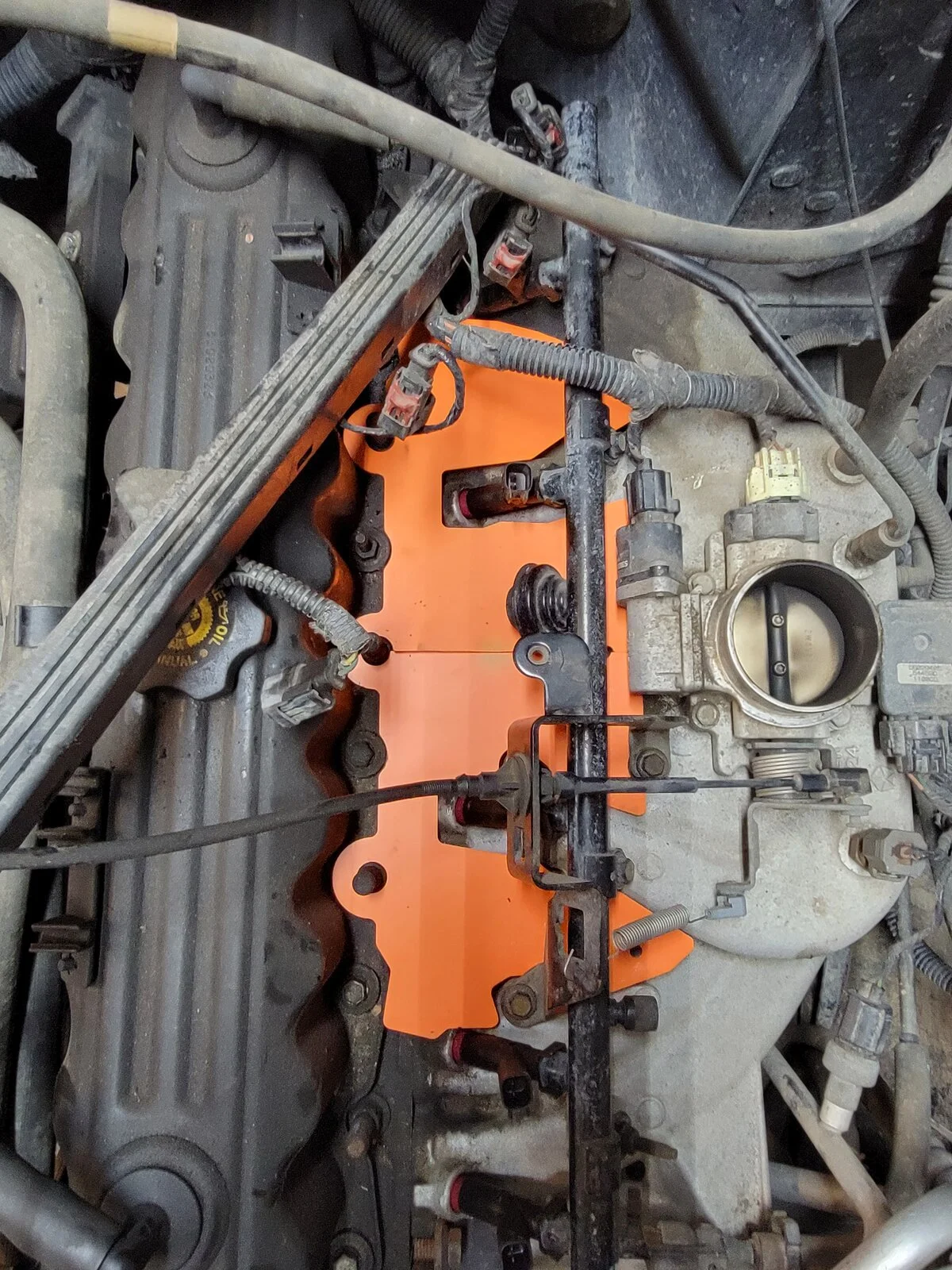

Spent some time yesterday working on a heatshield for the intake. I'm planning on wrapping the header as well, but I'm trying to cut down on some under- hood temps and heatsoak. I'm probably going to cut a finished one out of 1/8" carbon fiber. It's nice having a spare Jeep to mock things up on.

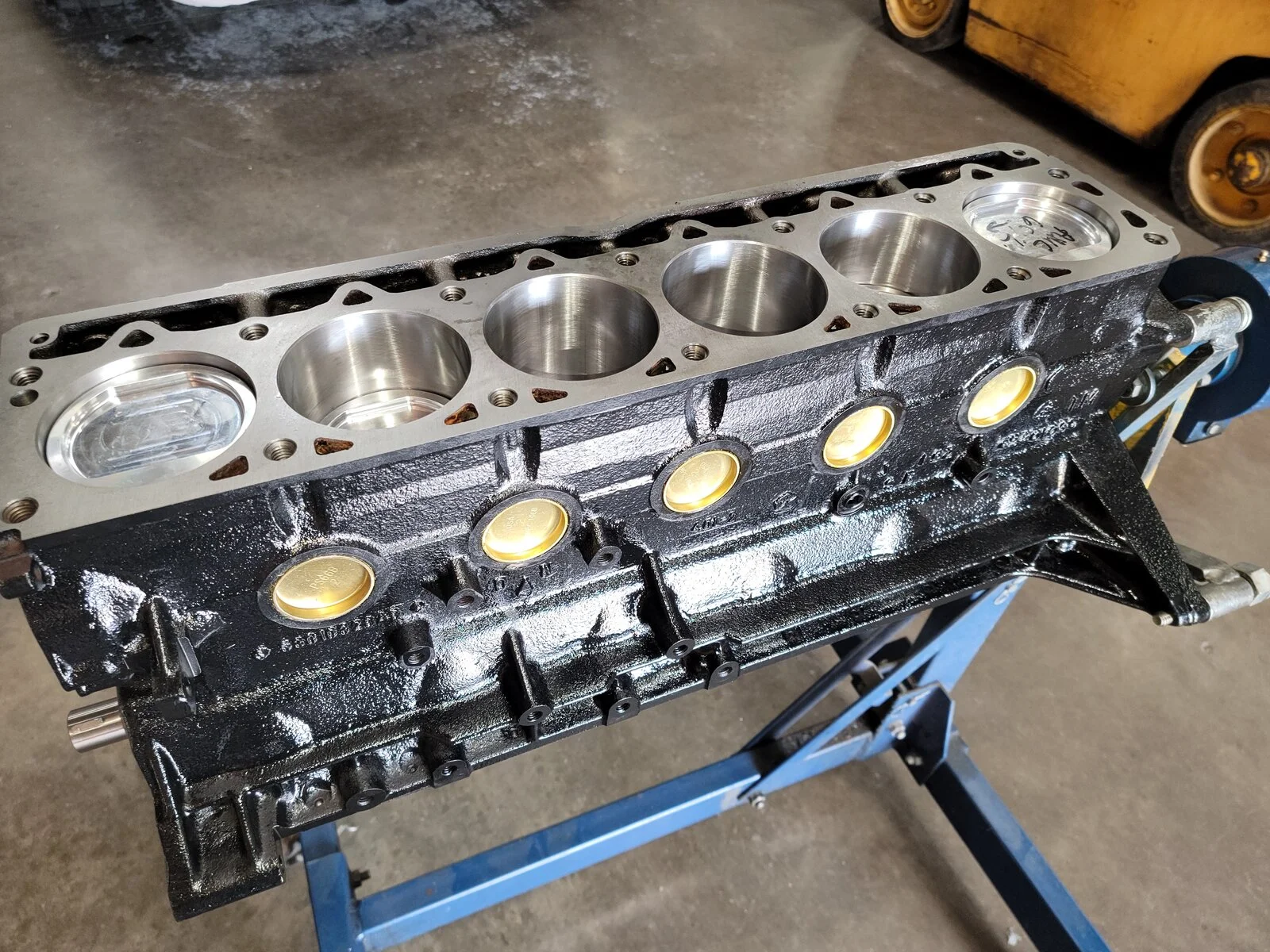

I picked up the engine from the machine shop today. I think that I have everything else I need to get it put in, but I'm going to wait until after a trip I have planned in a month before swapping it out.

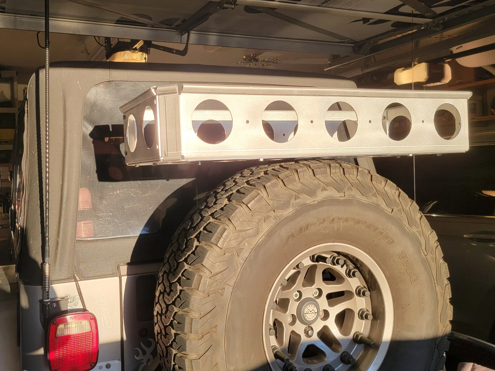

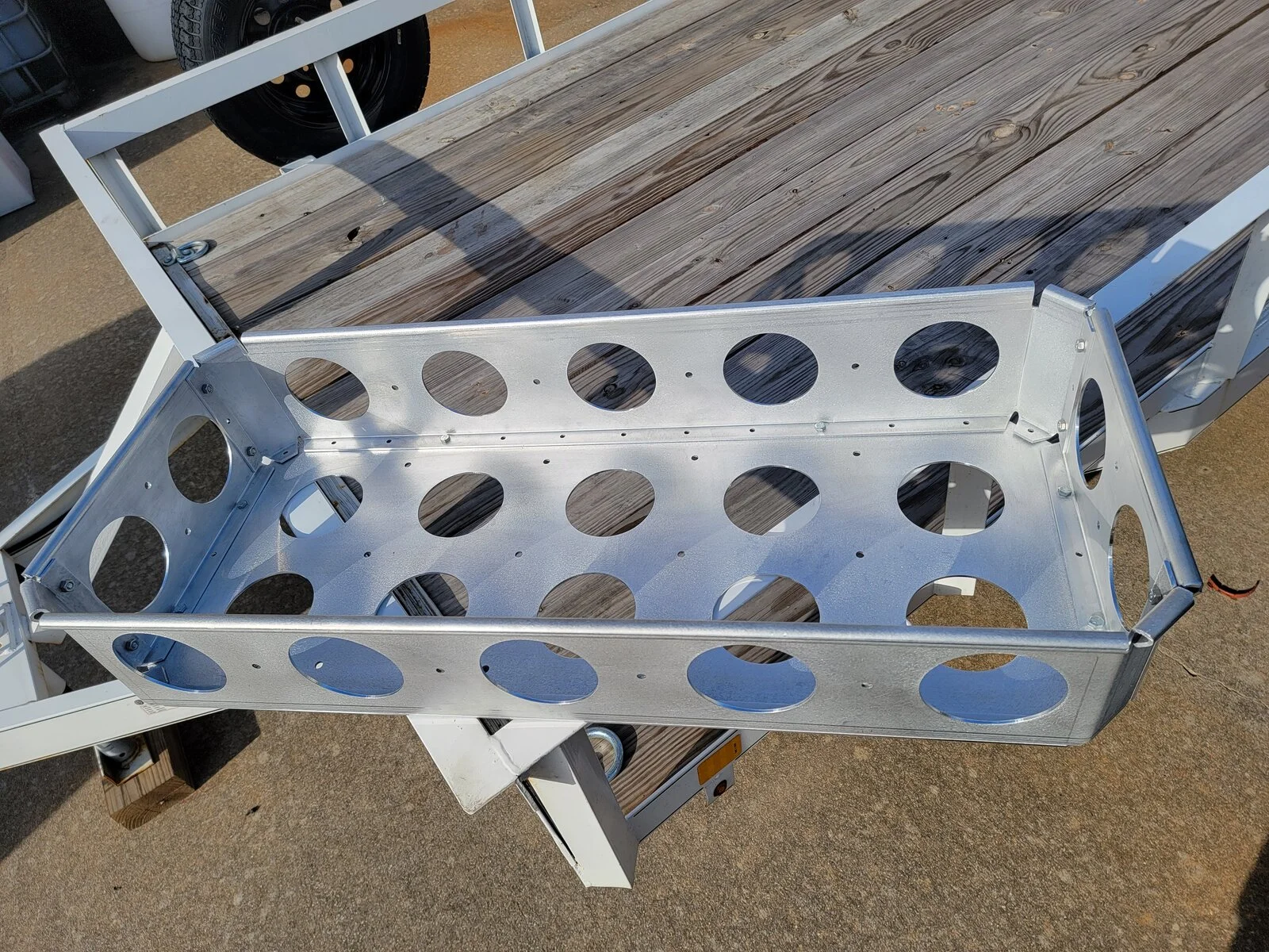

One of our metal suppliers screwed up and sent us some non-conforming 1/8" aluminum sheets. They didn't want them back so I decided to cut some up and make a cargo basket for the Jeep. The basket turned out pretty good, now I just need to fab up some brackets and maybe a Jerry can mount.

How will it mount and how much time will it take to make mine? TAKE MY MOONEEZ!!!! 😆 Seriously though, I would love something lightweight and easily removable. Just something capable of handling a Dometic cooler that I only need half an excuse to buy ☺️ I have a Savvy bumper with integrated receiver but we've been warned over and over by Blaine not to tow or use a cargo basket with them because of metal fatigue.

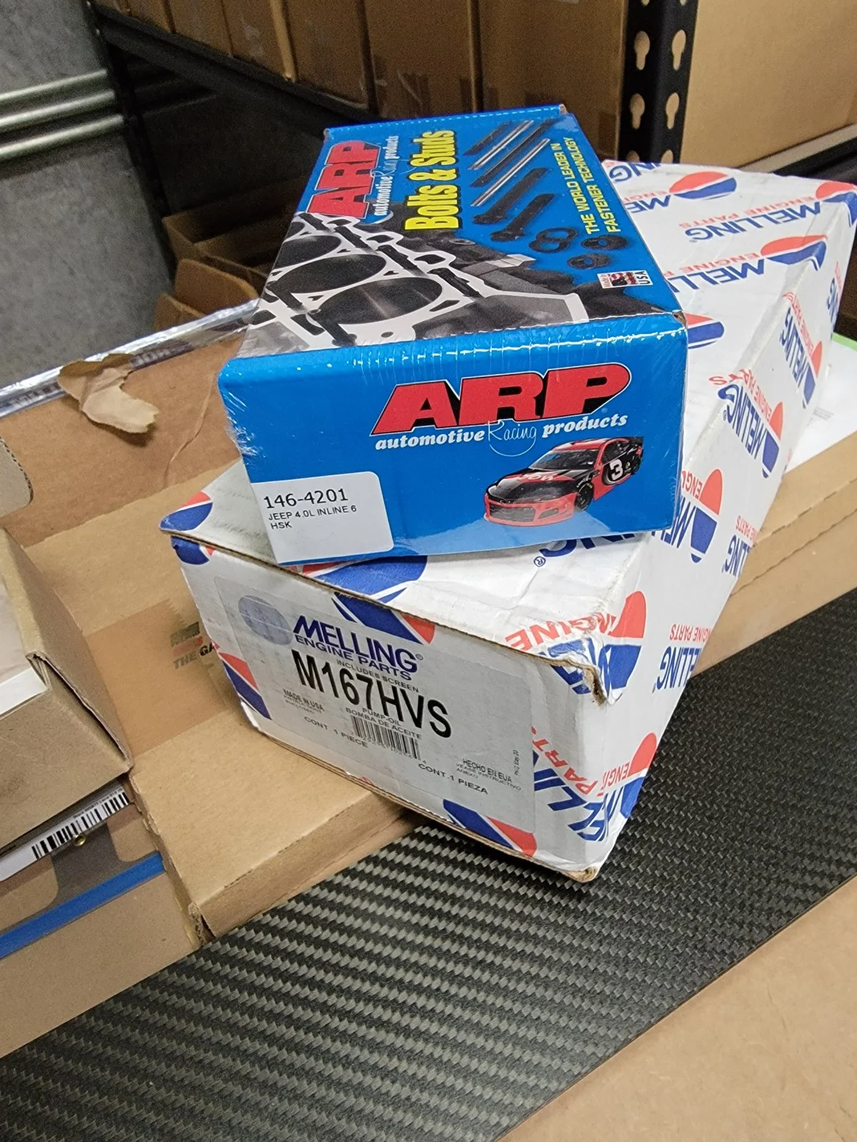

I think the Jeep universe is trying to tell me something. These head studs just showed up today after being on order from ARP since last fall. I think it's time to finish assembling the stroker.

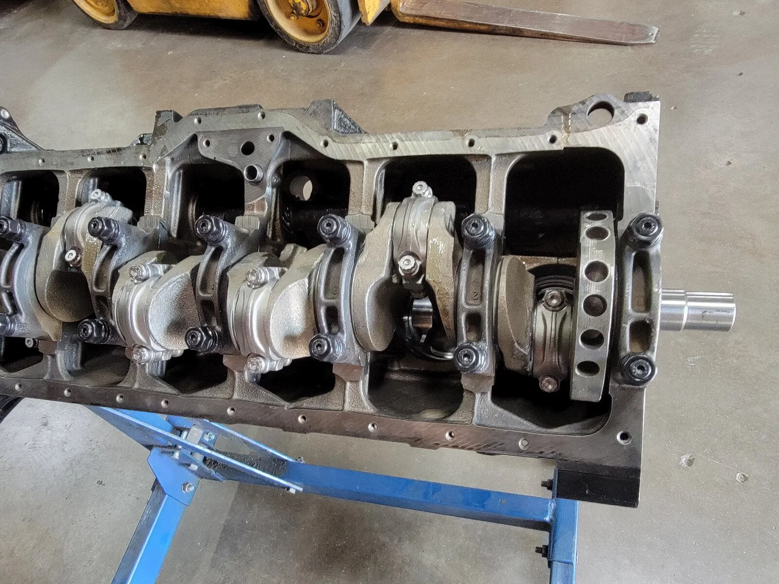

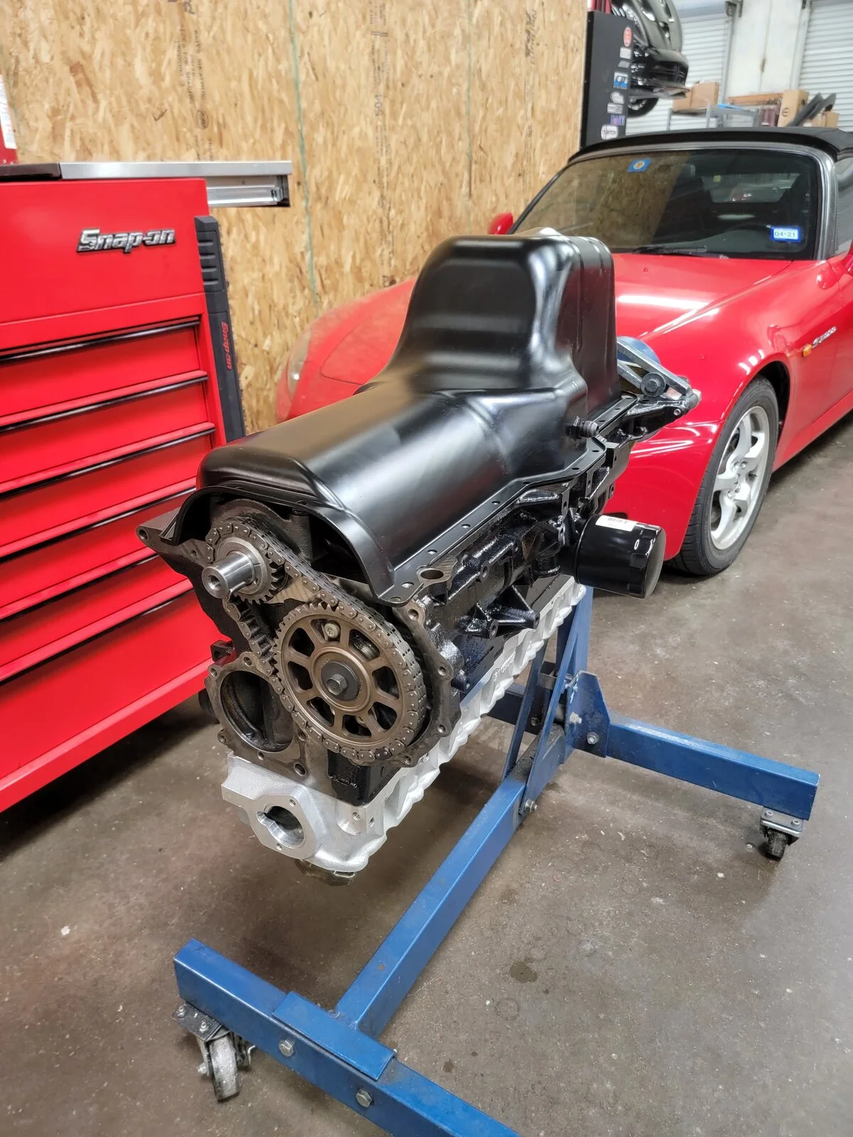

Small amounts of progress. The head is on with the new cam, lifters and head studs. I degreed the cam and finish assembled the timing chain. Now I am waiting on some longer main studs. The 4.0 studs were too short to work with the girdle and the stroker crank. I got with ARP and they are sending me some longer studs.

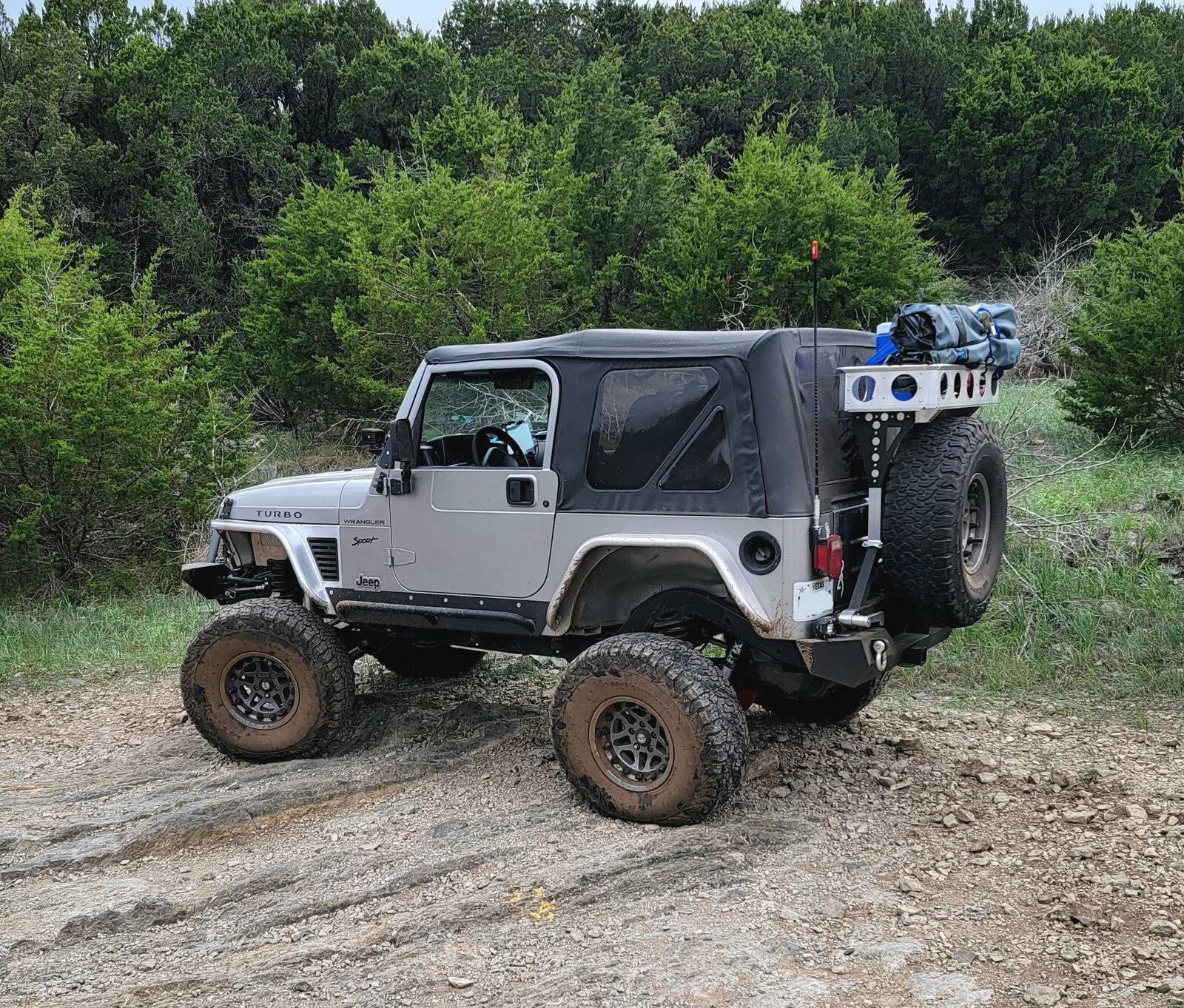

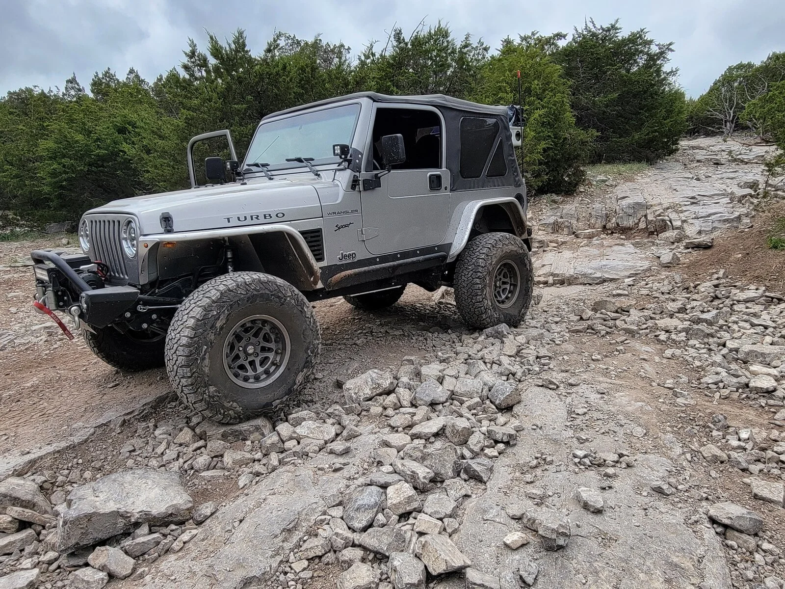

I took it out to Crossbar Ranch in Davis Oklahoma yesterday. We had a pretty good day overall. The weather was perfect, no breakdowns in our group, minimal damage (except for some rock rash on my wheels) and the place wasn't super busy. The Jeep ran good overall, but there were obvious areas for improvement. Hydro assist steering, better tires and lower transfer case gears are definitely on the list for future mods.

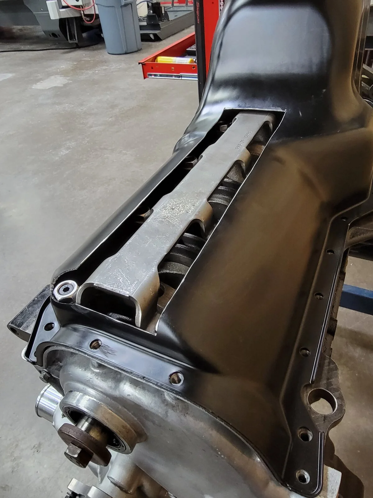

Weight reduction!!!
You extending the sump and clearancing the spaced out brace at the same time? I just used a precision BFH on mine 😆
It can't leak if there is no oil.
The girdle was hitting all the way down the front of the pan. I'm going to sump that strip where the girdle hits.
