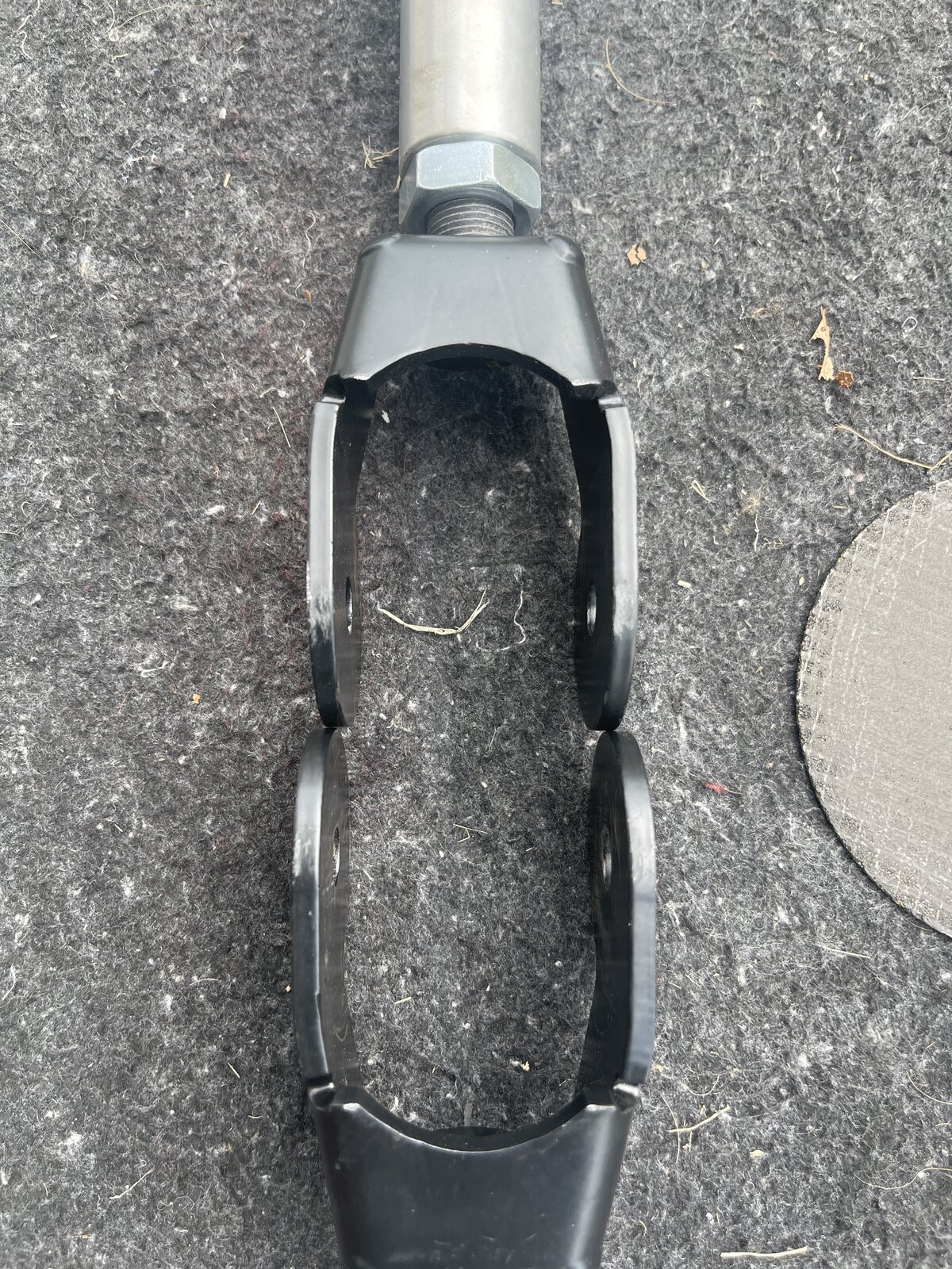

Here’s why. They are definitely different sizes.

I generally work on Jeep a few hours a day (before work, lunch break if I can) and spent the last two days saying no way I have to grind this, I’m definitely doing something wrong.
@rasband says grind it. And 5 min later the arm is installed lol

Some things you just make work. Who knows, the box could have been dropped during shipping bending that up!

not thrilled with how the bushing looks after I took some of the edge off, but Im rebuilding a separate dana 30 to swap in and will most likely bend the link out a bit on the narrow one. This will work for now at least.
