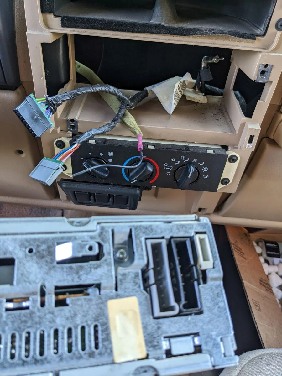

The back of your "RAZ" cd player had three hookups - two 7 pin and a 2 pin. I am in the same boat with my 98 TJ, trying to go to stock. Did you end up using the 2 pin port on the back of your RAZ radio? I have installed mine but it's acting up. I don't have the two pin connector on my wiring harness, just the two 7 pin and the antenna.
I actually don't even remember the 2-pin plug. What is that for? I use the two 7-pin plugs, and of course the antenna plug.
What is yours doing when it acts up? Did you also ground it?
Edit: This thread calls it a CCD (around post 10 or so). Sounds like it did not come on all RAZ stereos. Can't remember whether mine has it or not.
Edit: In a pic, I see the plug you're referring to. No, I didn't use it. I think it's either for an external multi-disc CD changer, or a security system, or something like that? I know I asked once on here, but now I can't remember.
Thanks. My setup here. The radio I am installing is acting up, not sure it's over the missing connector (I don't think it is). I'll try a secure ground but I have a feeling the radio is acting up. These are largely plug and play I am guessing.
Yes, I think that two-wire plug is for the multi-disc changer.
What is it doing when it acts up?
Can't get the display to come up, can hear some radio through speakers but volume doesn't seem to work. I did get the ground hooked up, still no change. Hopefully a bad unit. Thanks for the tips on the two wire plug.

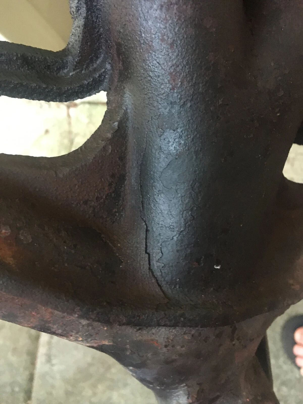

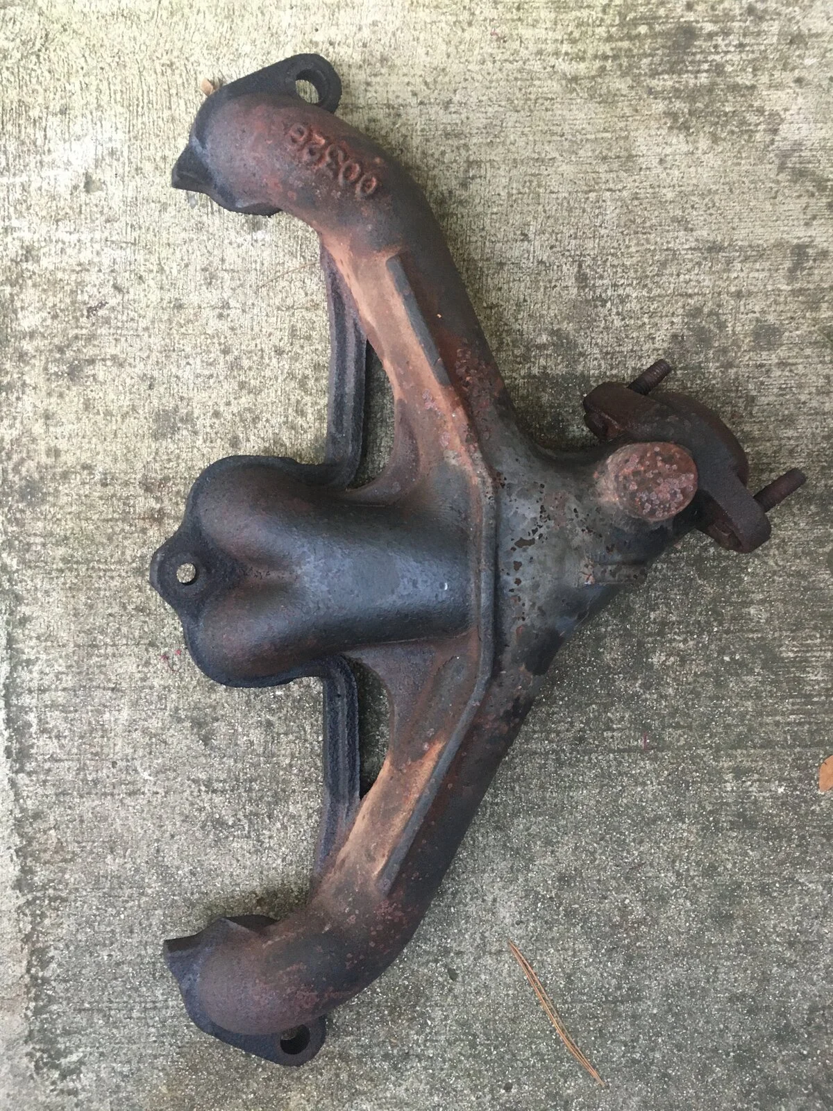

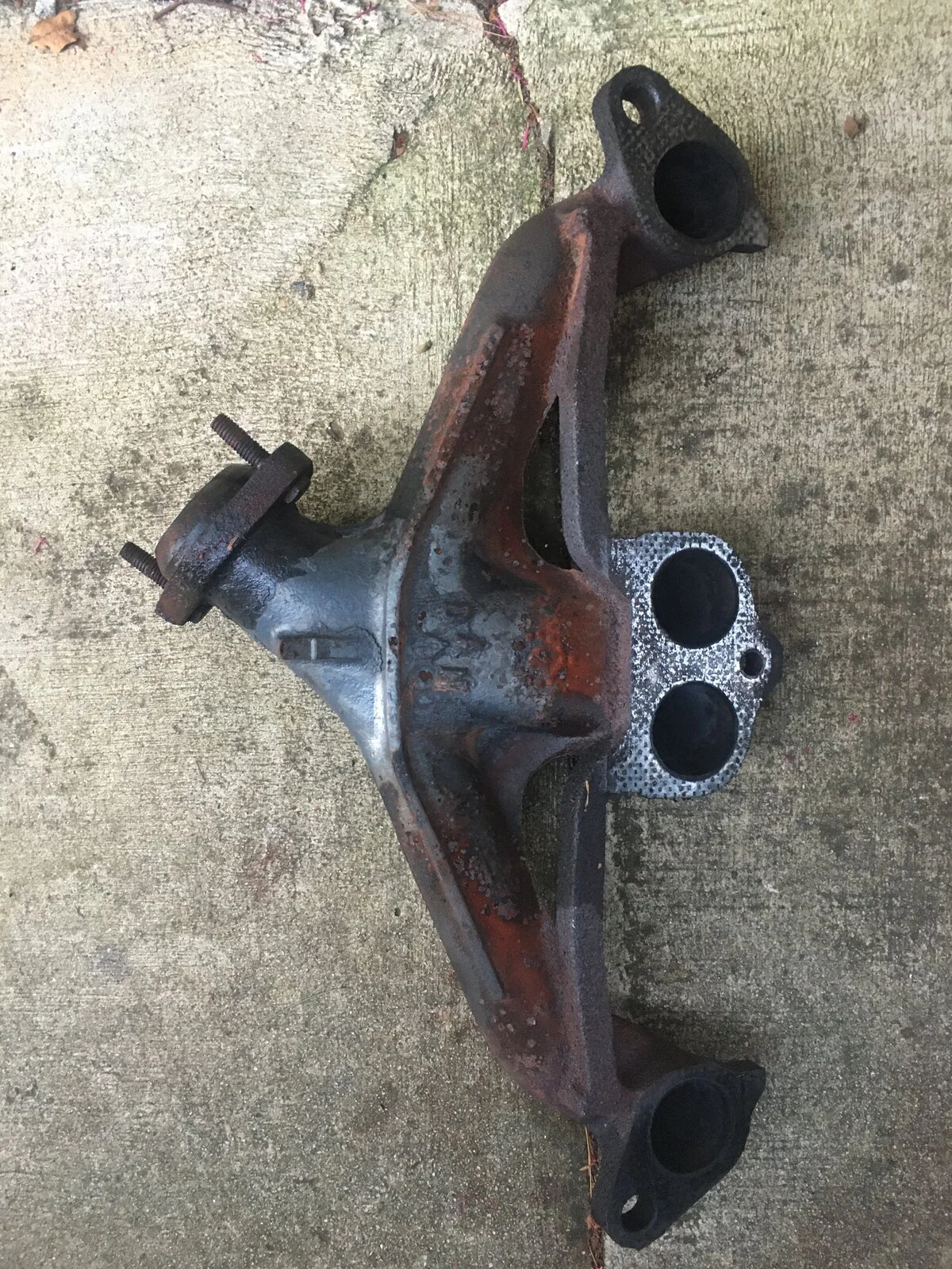

Exhaust Manifold and Gasket
  • Manifold cracked, and was welded, back in late 2000.
  • Recent signs of another crack:
    • 13.06 MPG and 14.86 MPG on two recent tanks.
    • Come-and-go fluttering/ticking sound.
    • Exhaust smells more strongly lately.
  • Read about replacement options here and here. Asked about others here.
    • No option of flex-bellows on the 2.5L engine.
    • Cheap Chinese manifolds (or headers) crack more quickly.
    • OEMs are no longer available. Can buy used, but hard to find low-mileage ones.
    • Some aftermarket ones have a blank O2 port (for YJ 2.5) that can cause trouble.
  • Read about replacement process here and here.
    • Updated second link with best tips.
    • Asked what else do to while I was at it, here.
  • Tried and failed to find a good-condition OEM. Decided to buy the Dorman.
  • Process went smoothly. Updated this post with lessons learned.

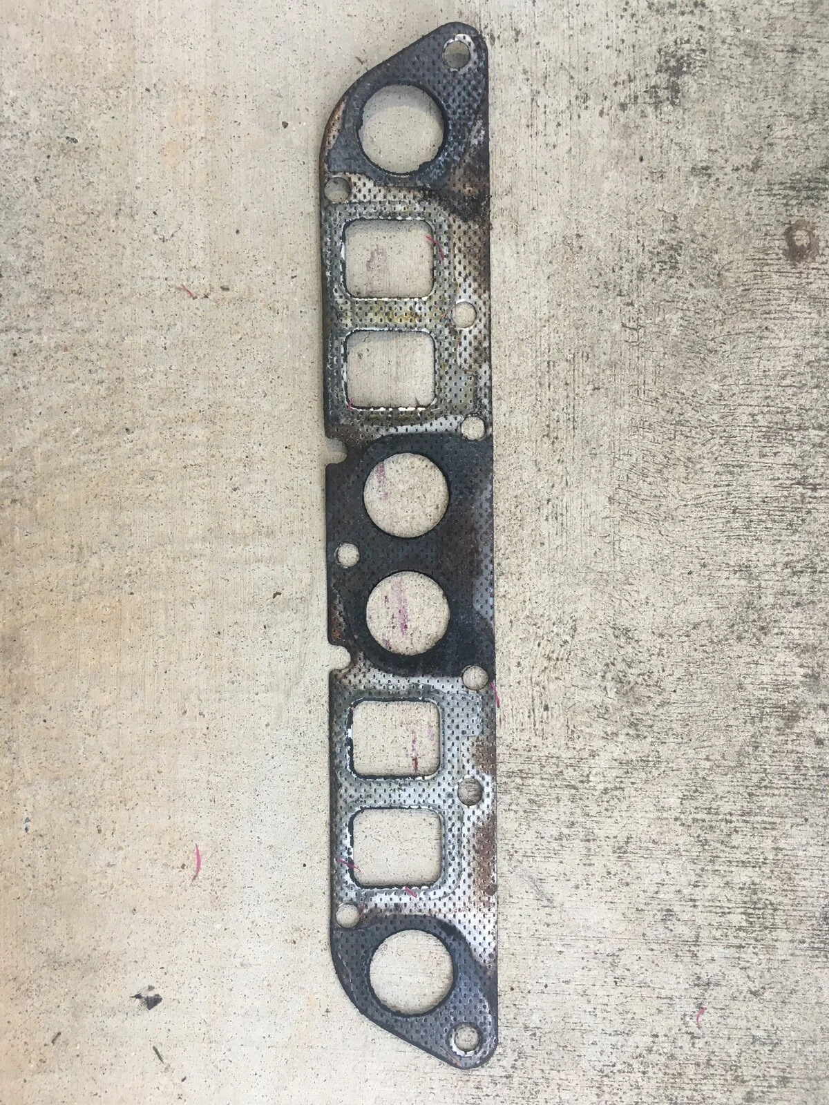

  • Engine ports were fairly clean. Cleaned mounting surface as described here.
  • Considered gasket options here. Used intake-and-exhaust that came with Dorman.
  • Discovered bolts where studs should be. Explored the pros and cons here.
  • Discovered broken stud fragments in threaded holes. Explored options here.
  • Some day, will remove fragments and replace studs. Exploring hardware options here.
  • Finally learned about a TSB on this, mentioned by @Blackjack, here.
